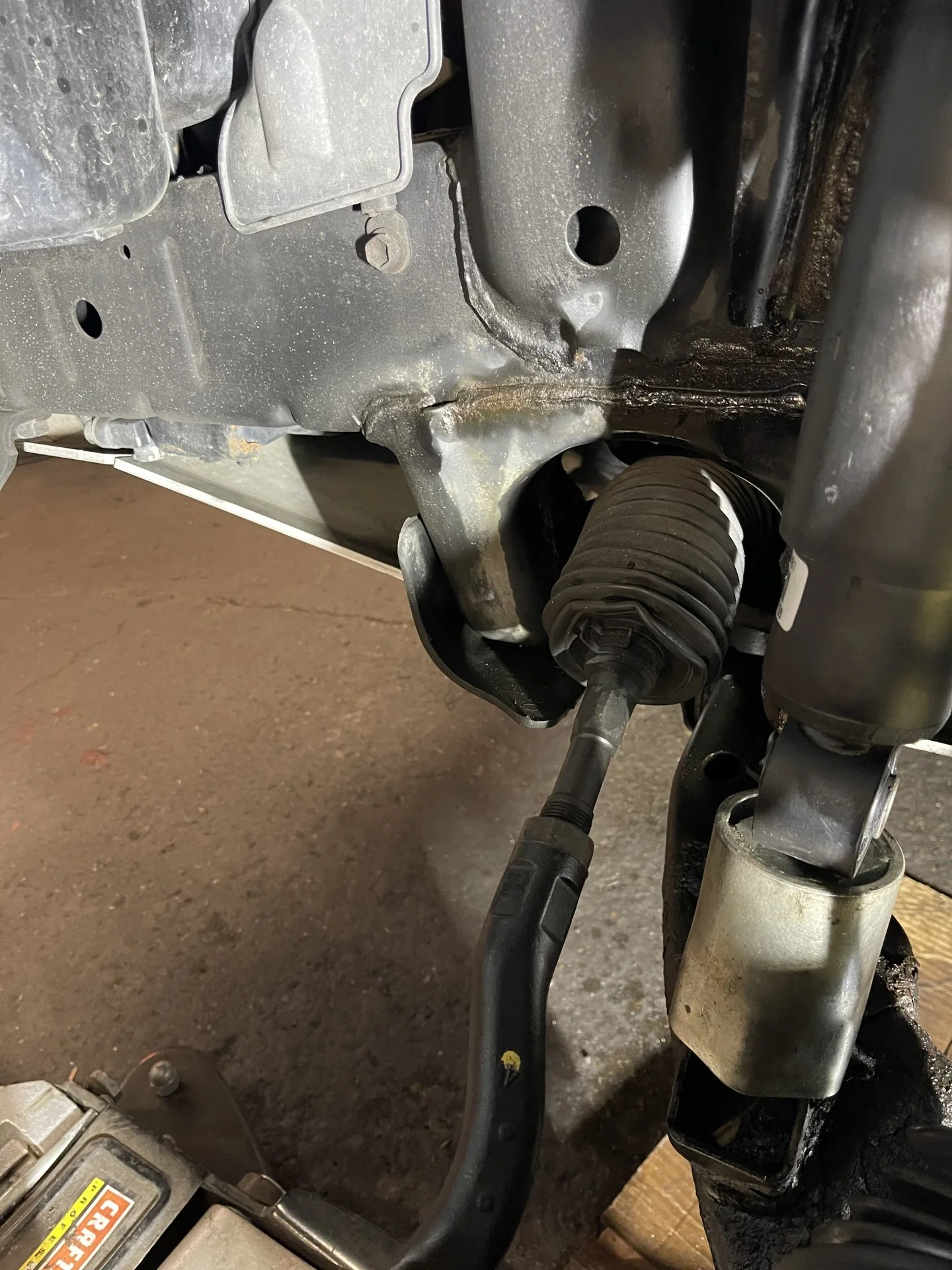

I didn't like the idea of $400 for extended sway bar links. so bought some $40 rockauto items and cut and welded some wheel studs in (1" in front, 1.5" in back according to my napkin geometry estimations).
Only installed the front ones so far (as the rear top nuts are sunk into the washers so going to be a PITA to remove), but the difference in ride quality and handling is night and day on my 2.5 slee OME / nitrocharger lift.
Honestly, those lift kits should come with sway bay drop link extensions as part of the lift kit. I've always thought it rode like crap, and had a horrible habit of lifting the front inside wheel over fast road undulations that I blamed on the nitros being over damped on the return stroke, but these extended links have transformed it and it rides like a different vehicle. Even though it looked like nothing, that incorrect angle on the sway must have caused quite a lot of stiffening/binding of the front independent arms.
Highly recommended.

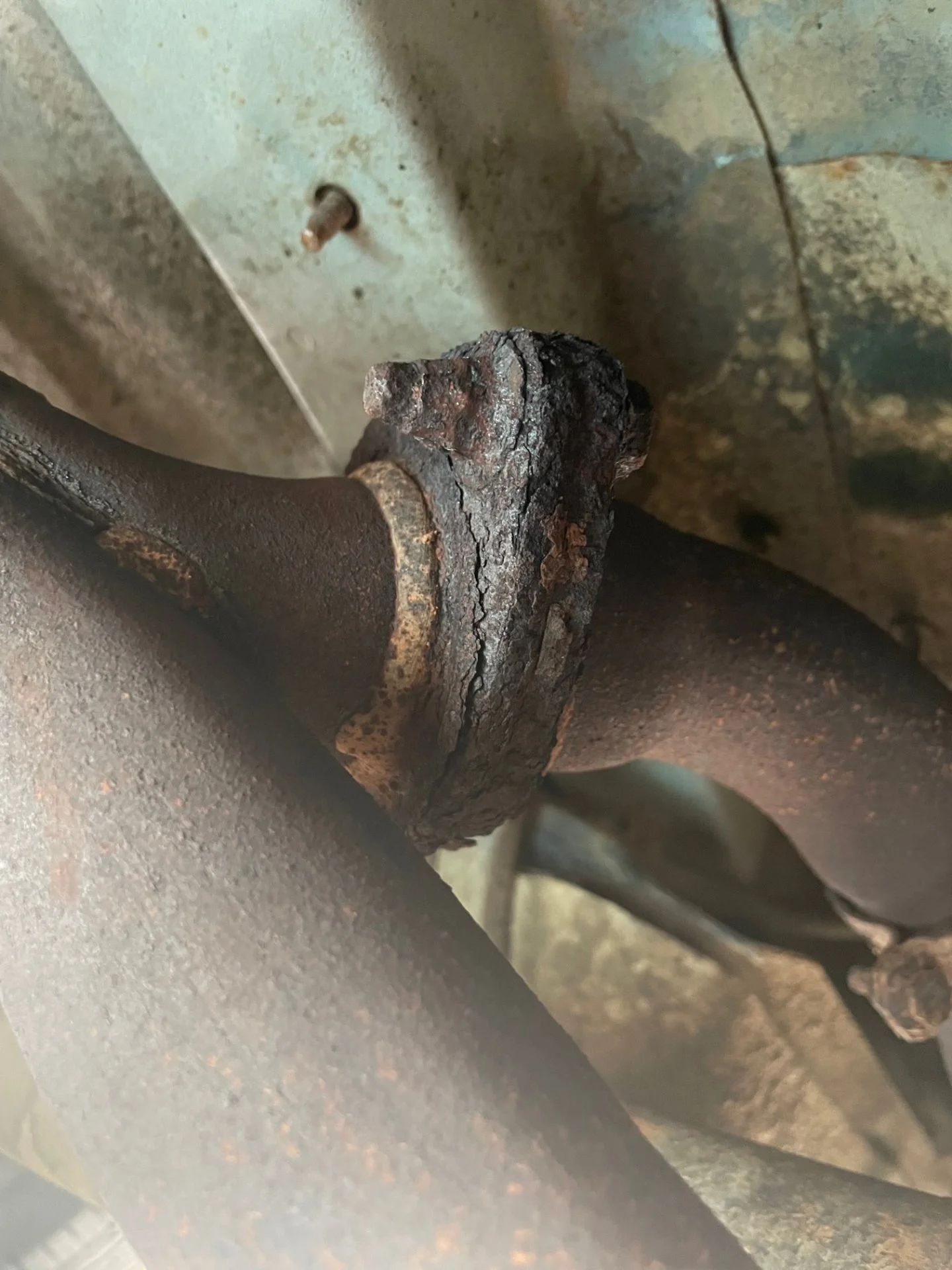

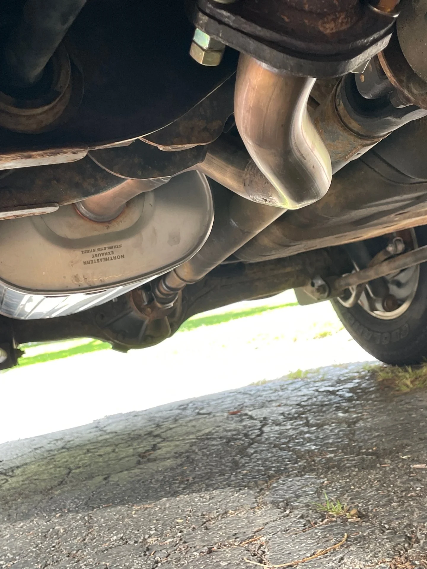

Might have made a mistake 😳. … had the truck for a year and 5k miles already and have really enjoyed that throaty V8 roar on start up. Much like a slow boiled frog, hadn’t really noticed that the roar was getting loader and throatier of late until the muffler’s cover plate started dragging and revealed the muffler’s true state … mainly rust being held together by more rust. 3 days later a rather well made replacement arrived, slightly more expensive than the cheapest that Amazon offered up, but not OEM league either.
Tried many tools to get off the original … Dremel, oscillating cutter, sawzall but the one that worked the best was a small angle grinder with a metal cutoff blade … cutting heated the bolt as well, which facilitated a fairly easy process to knock out the cutoff bolt with a hammer and punch. Reuse the vibration absorption thingy and install … half a banana job
… problem now is it sounds like the flapping wings of a bloody hummingbird… gone is the manly V8 roar … AND … I can hear the noise of the hullivator, tires, power steering pump, brake pump, diff and a thousand other things to start worrying about 😳
