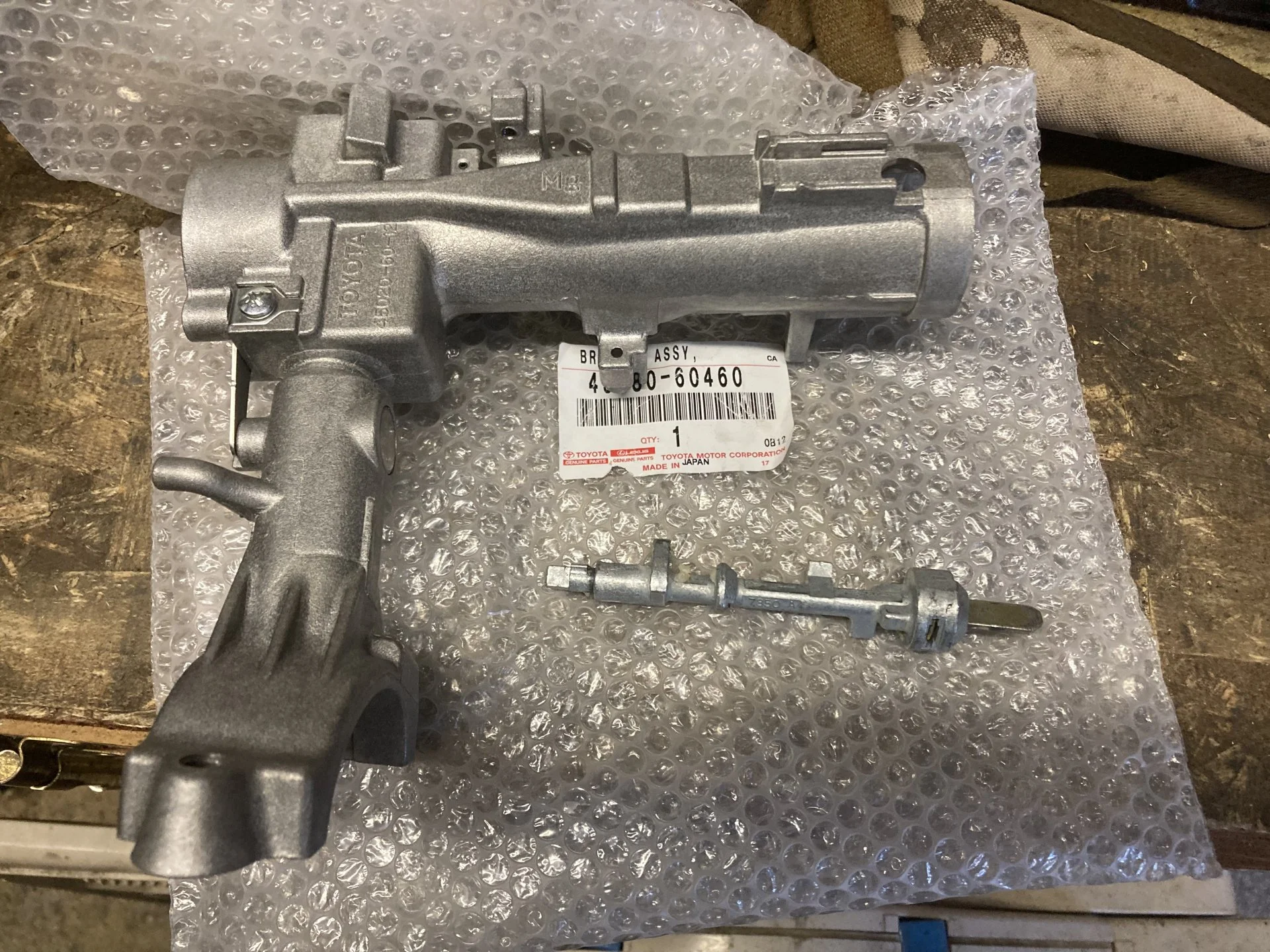

What’s the part number for the shaft? I was told to buy the whole assembly.
Note that there are 2 different part numbers. Which one you need depends on whether the truck has a tilting steering column or not.
My '99 UZJ100 does not have a tilting steering column. This is the part number I ordered and received from PartsSouk.
You receive the ignition shaft housing (they call it a "bracket") which has the shaft already inside (note in the photo that this is the old, original ignition shaft that I removed.) To install this entire assembly is more involved then just installing the ignition shaft itself.

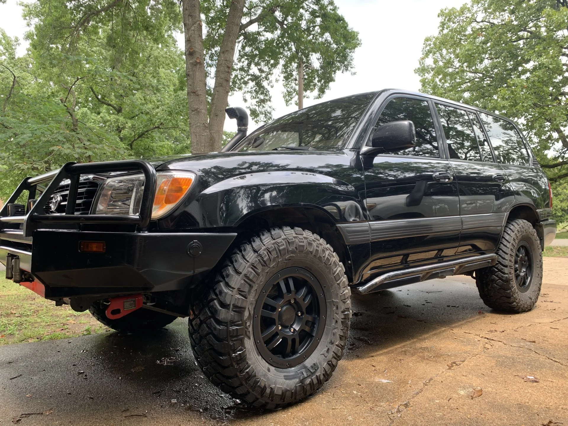

ARB Deluxe Bull Bar w/ Ironman 12k lb winch.
This is incredible! The paint looks flawless! We gotta get us Wisconsinites together for a ride!

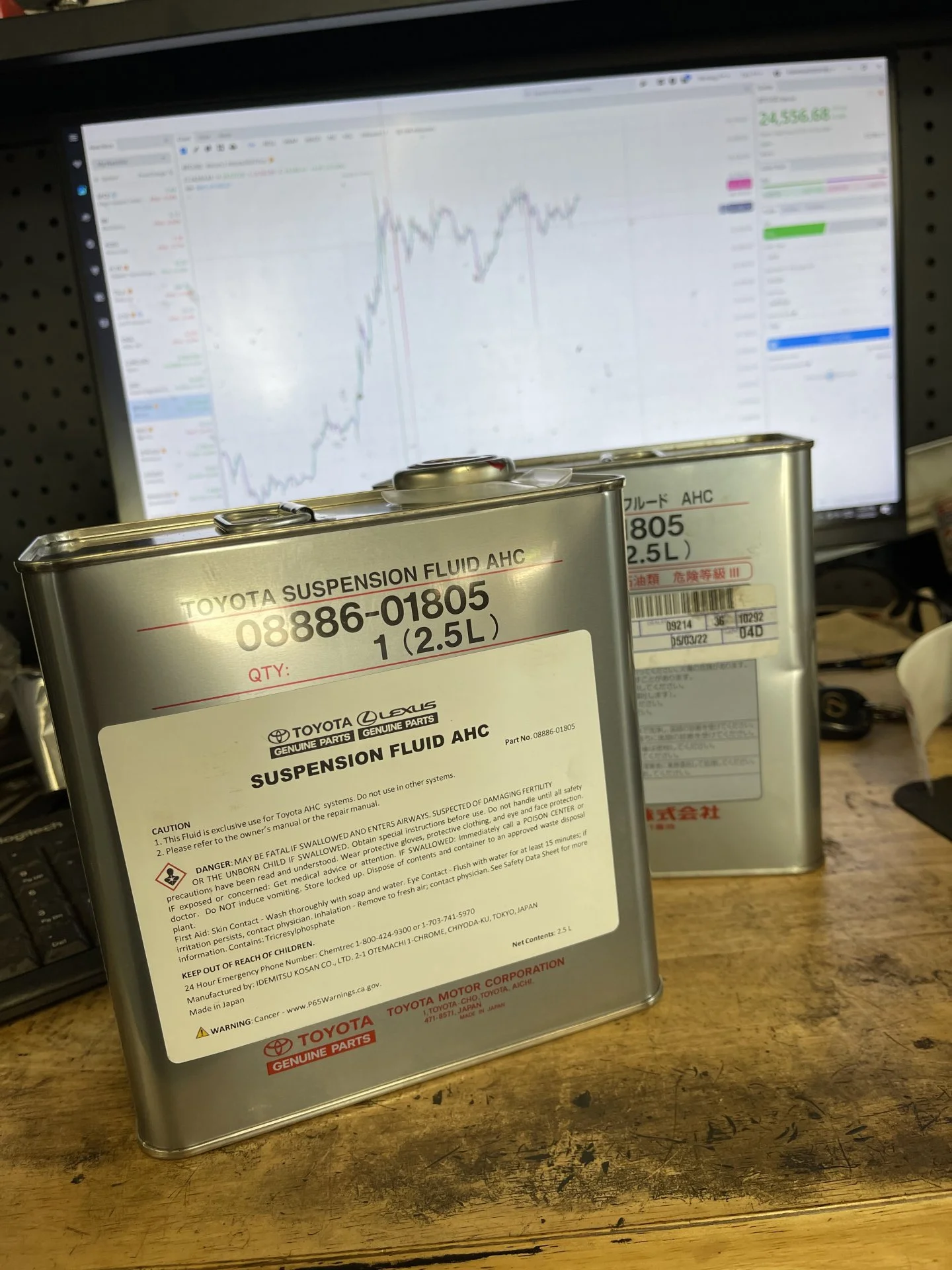

here we go, this oughta be enough to flush it out twice. Btw the next cushions that Toyota give you, it’s impossible to thread the nut on the shock. You gotta compress it with a vice beforehand and let it sit to squish down a bit, then I used a socket to push the shock up enough to flatten some more to get the top nut on. They don’t give you enough threads the oem shock 😡
Yes, even the non-AHC cushions are like that! In fact the last time I replaced the cushions on my front shocks, I had to put only the lower cushions on and crush them down with the top nut first and then put the top one!
Check your rear cushions too - mine are crushed to near total destruction and cause the rear to shake on small imperfections!

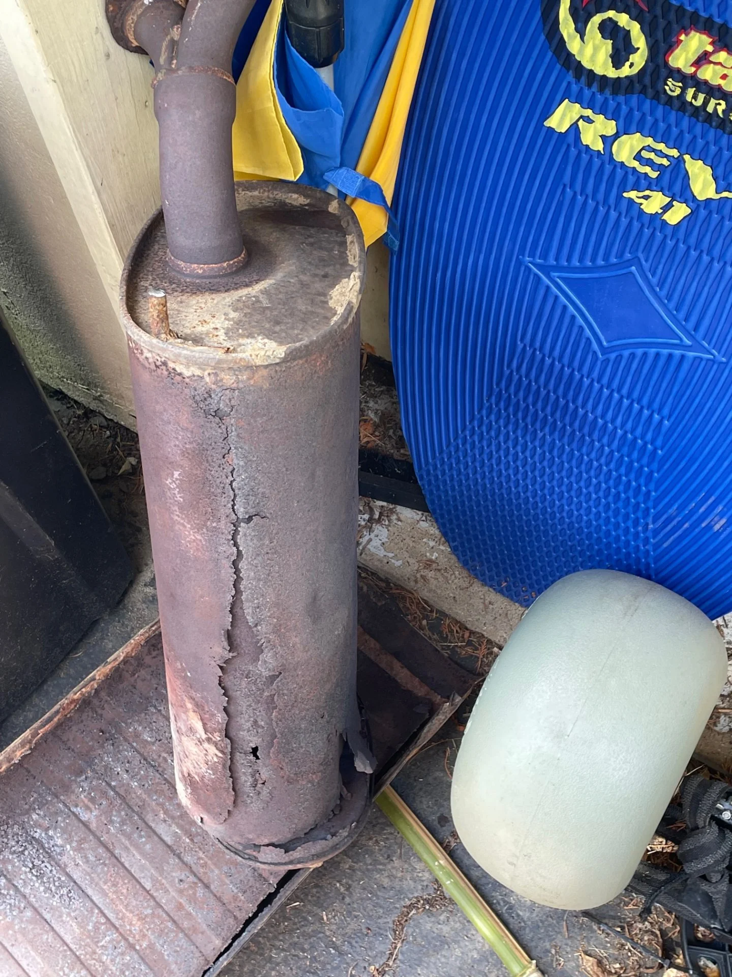

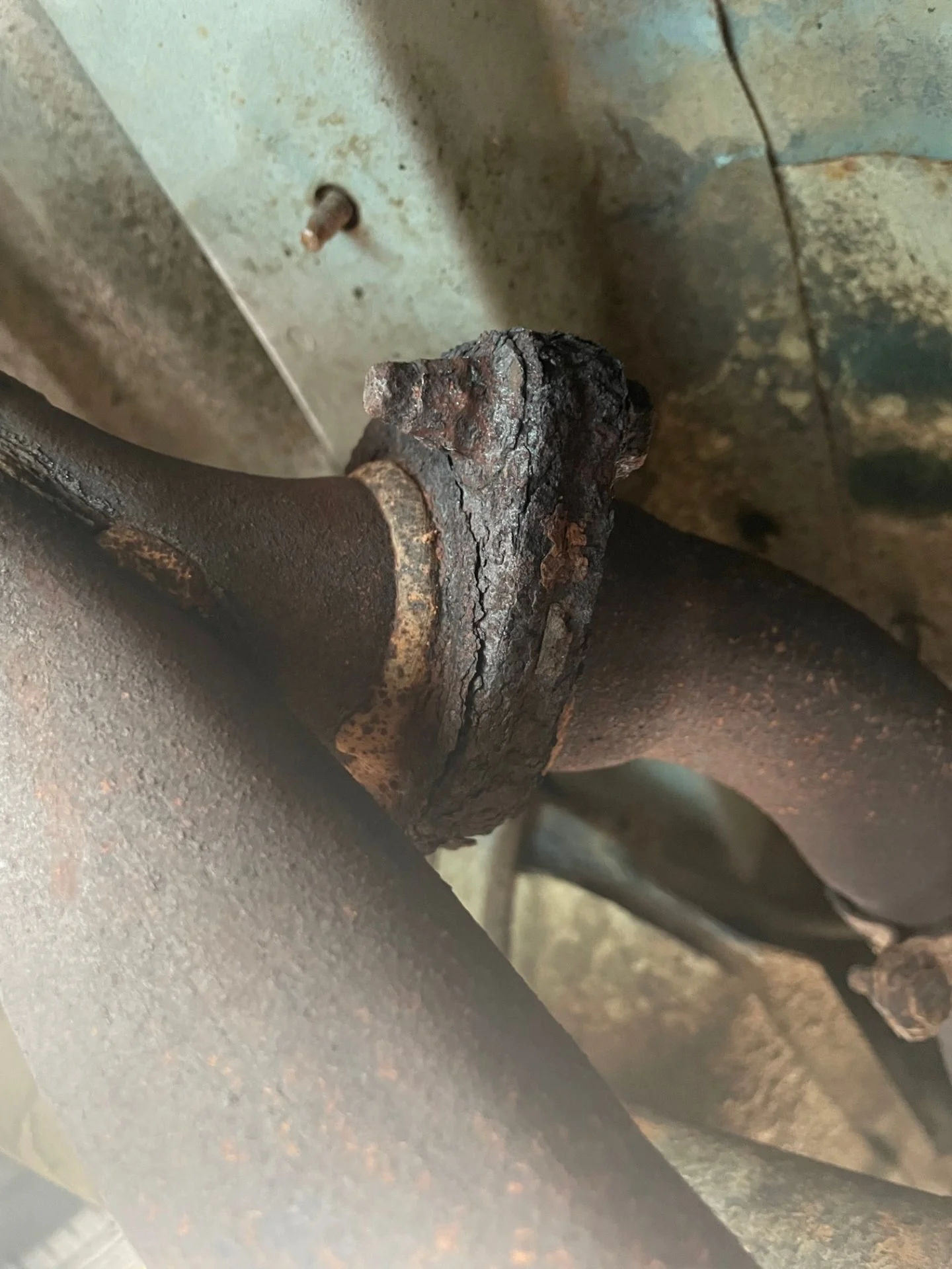

Might have made a mistake 😳. … had the truck for a year and 5k miles already and have really enjoyed that throaty V8 roar on start up. Much like a slow boiled frog, hadn’t really noticed that the roar was getting loader and throatier of late until the muffler’s cover plate started dragging and revealed the muffler’s true state … mainly rust being held together by more rust. 3 days later a rather well made replacement arrived, slightly more expensive than the cheapest that Amazon offered up, but not OEM league either.
Tried many tools to get off the original … Dremel, oscillating cutter, sawzall but the one that worked the best was a small angle grinder with a metal cutoff blade … cutting heated the bolt as well, which facilitated a fairly easy process to knock out the cutoff bolt with a hammer and punch. Reuse the vibration absorption thingy and install … half a banana job
… problem now is it sounds like the flapping wings of a bloody hummingbird… gone is the manly V8 roar … AND … I can hear the noise of the hullivator, tires, power steering pump, brake pump, diff and a thousand other things to start worrying about 😳
I just had them run a straight pipe when my muffler rusted. Resonater only 😉

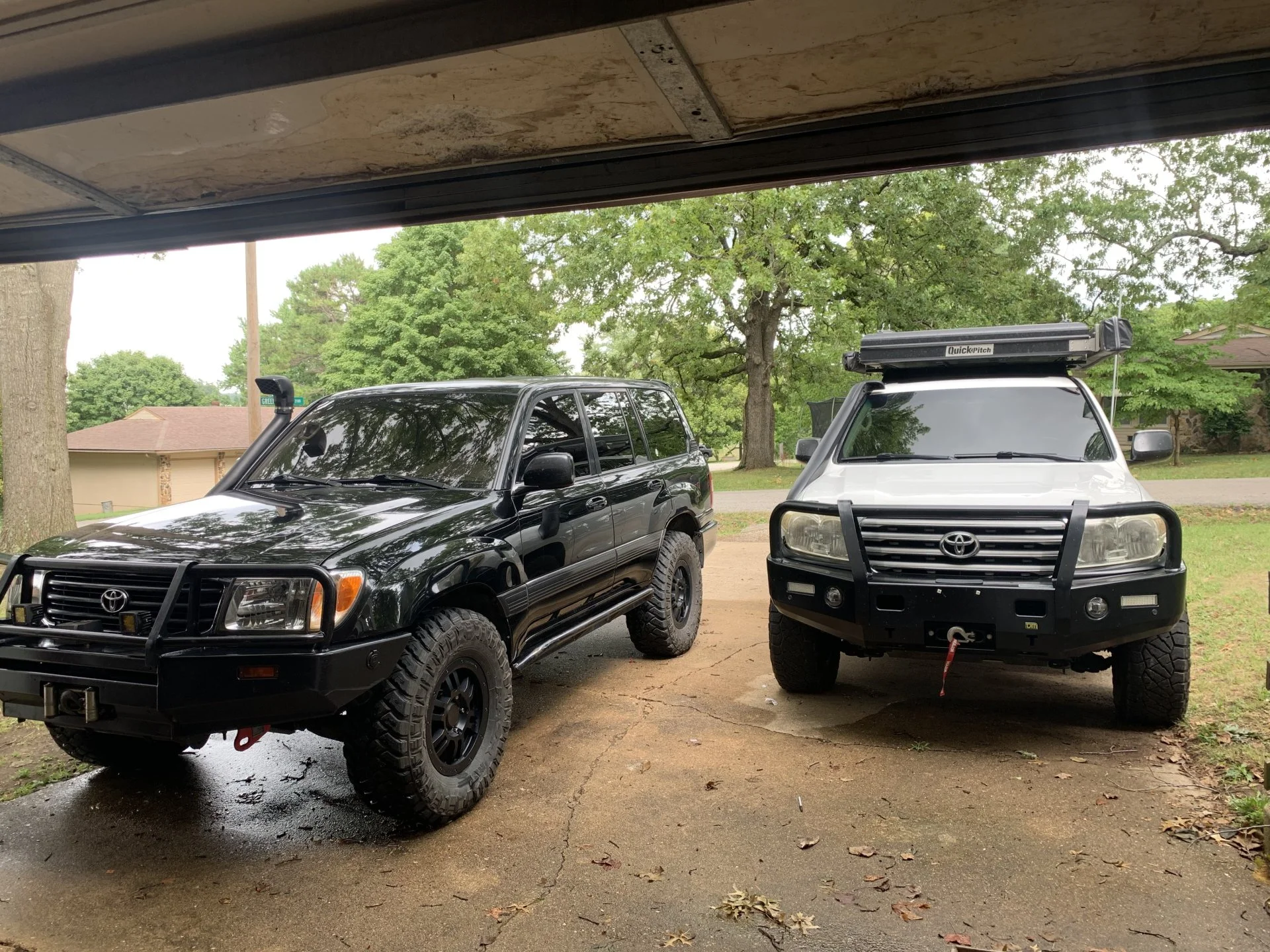

How do
How do you like the Maxxis Razor MT's? I'm alway keeping an eye out for my next tire once my KO2's wear out and I'm considering an MT.
Tire noise aside I love them. Phenomenal traction in the ozarks. Last trip I wheeled I didn’t even air down.
Also they are loud at 45 but quieter at 65.. still louder than an at.
We own an independent Goodyear so I rarely run the same tires twice. I’d buy these again if there weren’t new tires on the market to test.

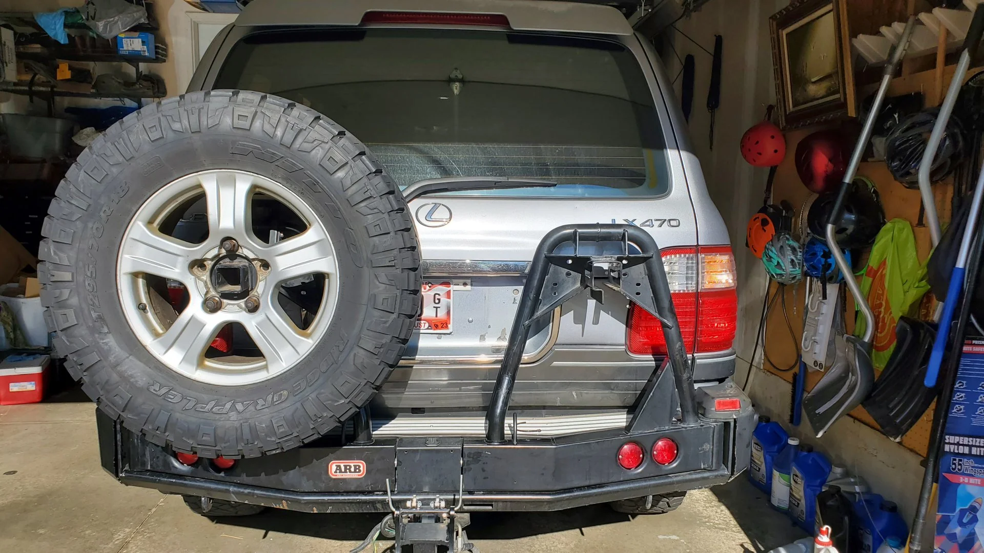

In other news I moved my spare wheel back to the left swingout. I have decided that I like it better on the left as it gives me better view out of the rear window!

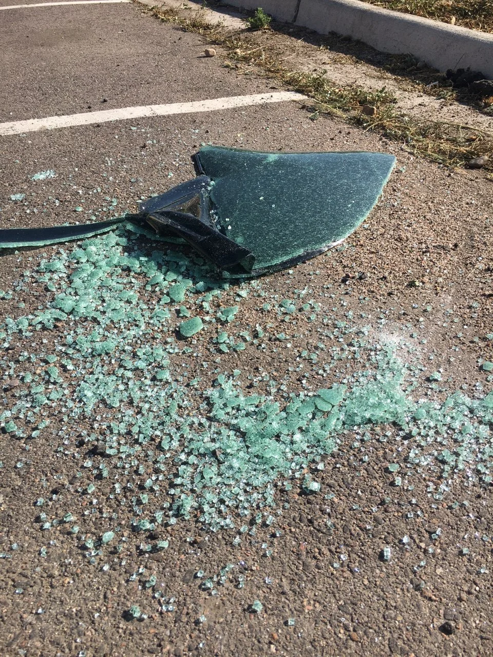

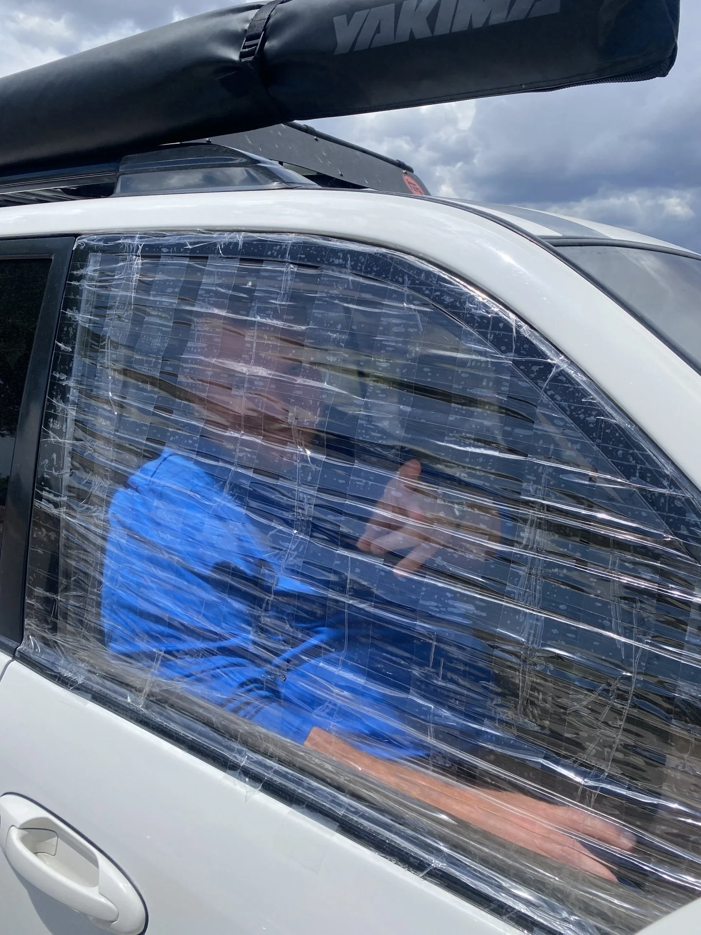

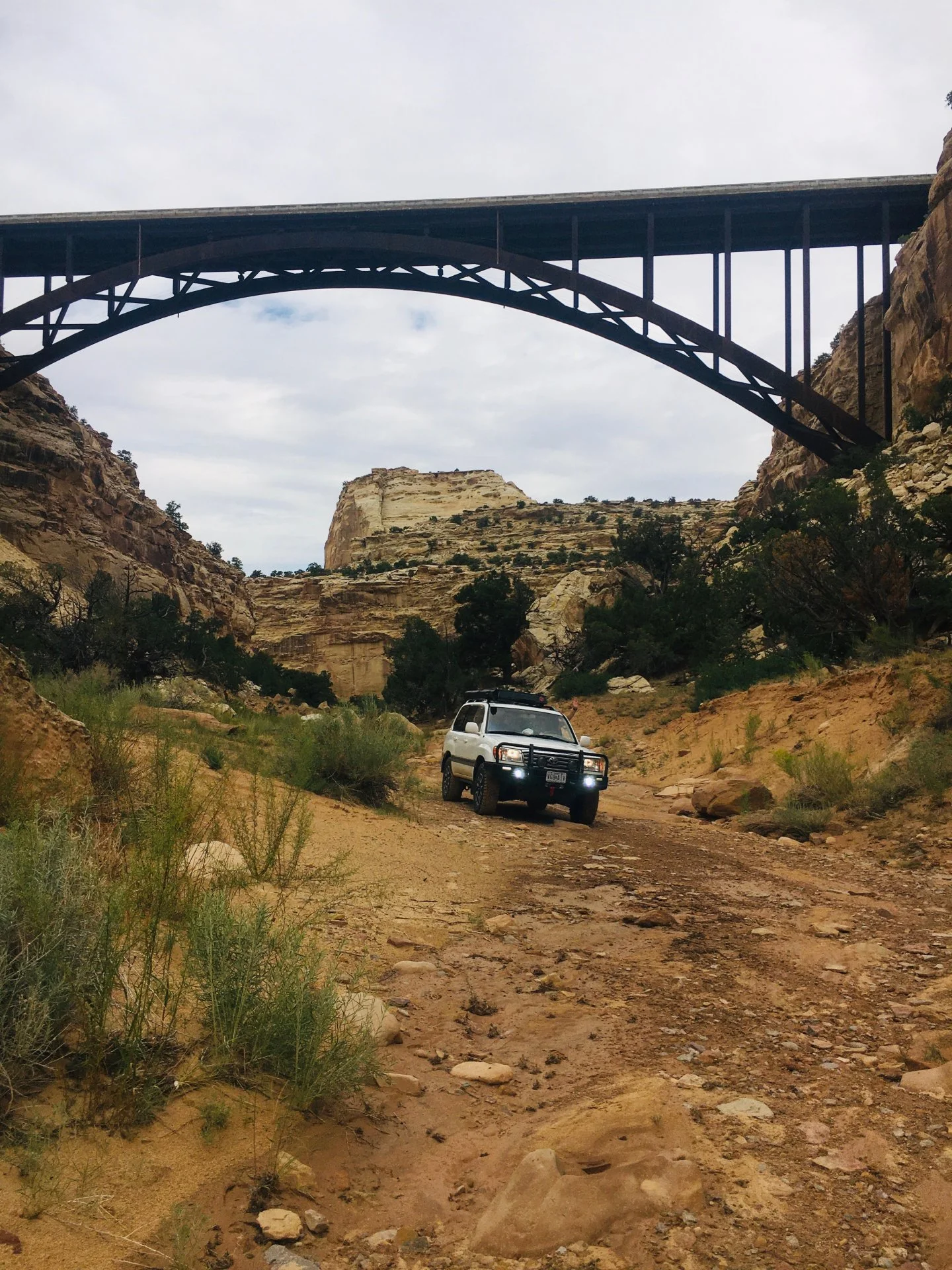

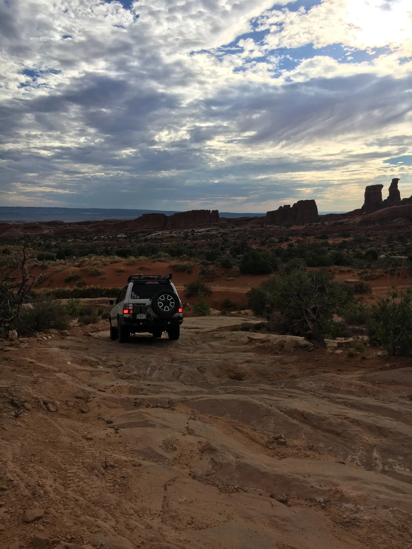

2nd Moab trip this summer. This one started off a little rough but we perservered. Gal tried to break into the 100 at a Denver hotel before we made the rest of the trip into Moab. She gave up but did shatter the glass so we went ahead and pushed it out and taped it up. Wasn't too bad. The window tint saved the day, really. $92 for aftermarket glass and I’ll put it in myself this week back home. She dropped her Costco Member card with name, Costco number and photo. PEOPLE SUCK.
Some photos of the trip. We did mainly blues but snuck in a nice red on the last day.
Eagle Canyon is a good one! Looks like you made the best of it, despite crap people doing crap things.
Costco Soccer Moms are dangerous creatures. Too bad Steve Irwin isn't around anymore to wrangle them into submission. Glad it worked out looks like a blast! #2020costcotoiletpaperbrawlsurvivor
Yep, that Eagle Canyon trail is fun. You've got mostly easy and then the rocky climb out north of I-70. Only concern were those rain clouds in the photos. It started raining and I remembered back to 2016 when we got stuck in a flash flood trying to get off of Willow Springs trail. Not fun!
