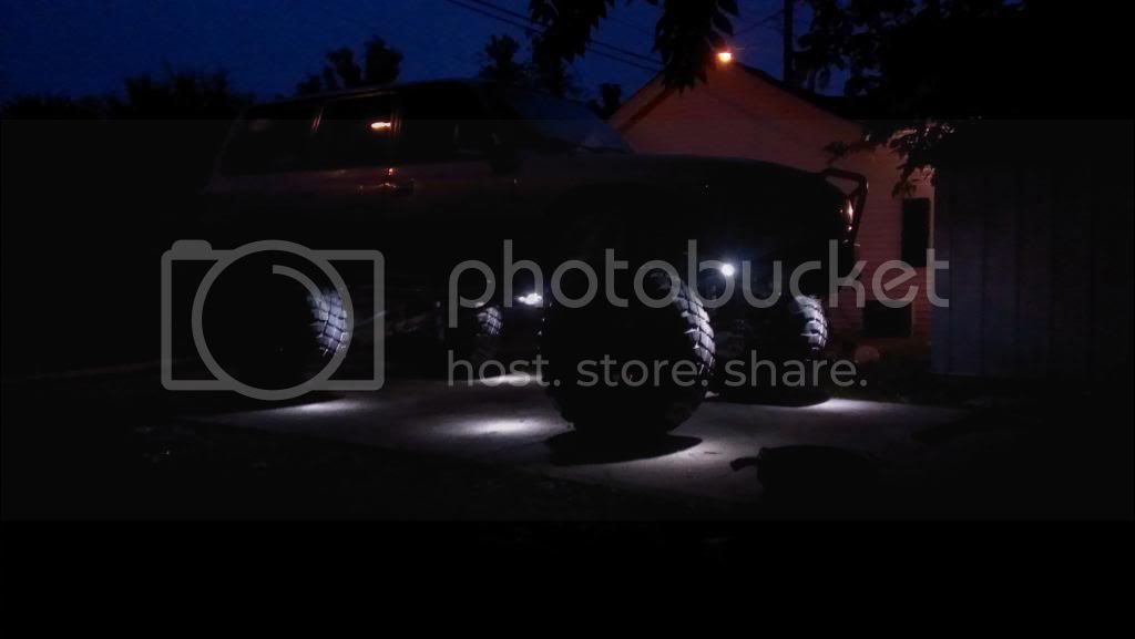

Added some rock lights a buddy gave me...
Your truck looks pretty serious...Any more daylight pics? Lights look sweet
