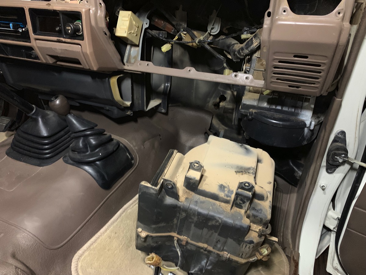

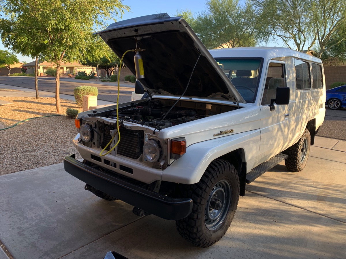

I've been tearing apart the Troopy's AC system to clean it, flush it, and convert it to R134a...
Was R12 still available in the Middle East? O see a couple of Tee fittings, does it have rear air?
R12 still available on a limited basis... similar to here. You gotta hunt for it, and pay a premium, but it's out there. Converting to R134a is not that challenging actually AND it makes it far more DIY friendly for future work on the truck.
It does have rear air. Not the factory version, though that was an option on this truck. They installed an aftermarket evaporator and blower assembly to blow into the back... as well as the t'd fittings to both high pressure and low pressure and an additional condensor and electric fan.

I put about $250 into equipment... a manifold gauge set, a vacuum pump, and a flushing apparatus. And I bought Mastercool brand stuff, not just cheapo. I've used the gauges and vacuum pump on my bro-in-laws AC and everything worked great.
Beyond that you'll need an expansion valve and new drier bottle. New oil and refrigerant is quite cheap.
It's been fun learning the ins and outs... and it's always fun learning to do things yourself.
