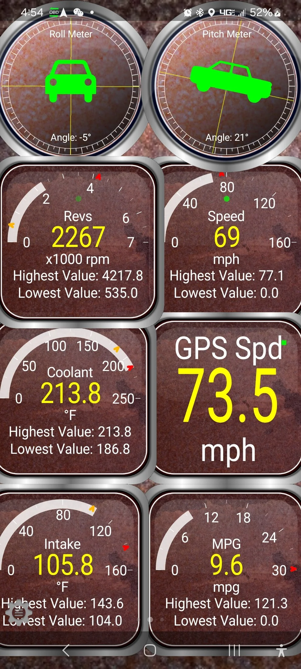

I was trying to figure out if it's normal for my coolant constantly run over 210F under Phoenix sun, no matter it's cruising at 70mph on highway. It's even higher at 220+ when climbing from Black Canyon City to Sunset Point.
My 04 LX470 has new fan clutch, new coolant (drained/filled with over 16 gallons of distilled water), new tees, new hoses, and almost new thermostat. I tried a brand new 3 rows all aluminum radiator and now the CSF radiator, but the temperature seems same. Thermostat doesn't matter as it's same high temperature even without thermostat installed.
Anything I miss to get the coolant back to range?

My 04 LC runs warm. Sitting on a hot day, I can easily go to 205-210. I've even seen hotter while wheeling. My normal operating temp on a regular day is 190-195. All that's based on my Torque Pro readings.

I also use Torque Pro. Just hope I could find the cause to lower down it :bang:

213 is hot but it’s not overheating. Your thermostat isn’t even fully open until 203, so a 10-20 degree overage likely is built into the design tolerance. 50/50 antifreeze has the added benefit of increasing your coolant boiling point by about 15 degrees over straight water, this is critical in my opinion (especially in the desert).
When you’re seeing 220 on i17, is that with your AC on or off?
Yes, AC is always on. Otherwise, myself will be overheated
This gives me some confident not to worry about the overheating or another head gasket. I have a feel that I may not be able to sort out the issue and may have to live with it for now.
So did some more test over the past days. Lowering the speed will help a little bit, but still won't keep it under 200. I can feel the cooling system is working hard to cool down but just beyond its capacity. That's why I suspect the new installed winch/bumper. Keeps trying anyway...
