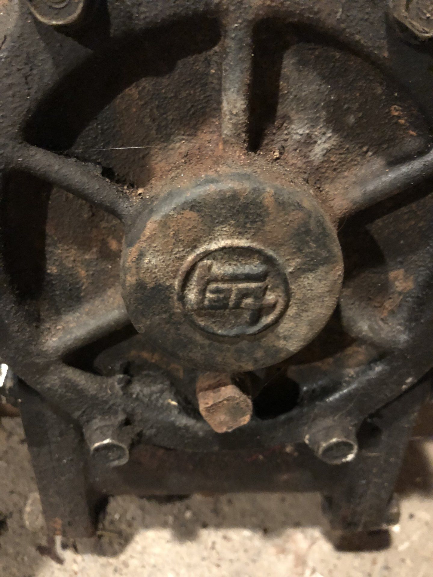

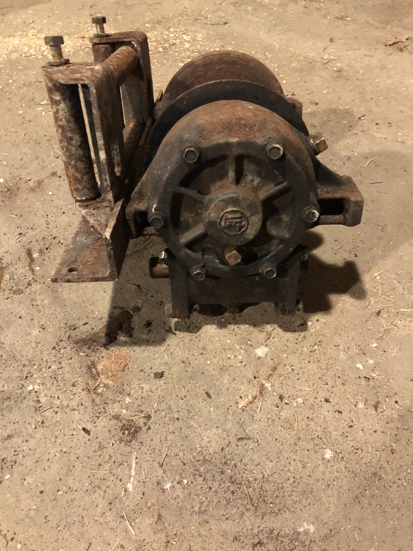

Picked up this tonight, along with most of the rest of the parts...
I hope your transfer case already has the gear that drives the PTO gearbox. Did you get the gearbox, shifter, and driveshaft? How about the support bearing for the driveshaft? These winches are pretty strong and you can make 'em as fast as you want with the throttle. Can't wait to see it mounted and working on your truck!
Thanks Gary I did not know about the gear in the transfer case. I did get the gearbox, shifter and driveshaft with a nice pillow block still in place. It was missing the spud shafts that connect to both the winch and gearbox. Guy said he got it in a barter from someone around Schoeneck, would that be one of the Merkey’s?
