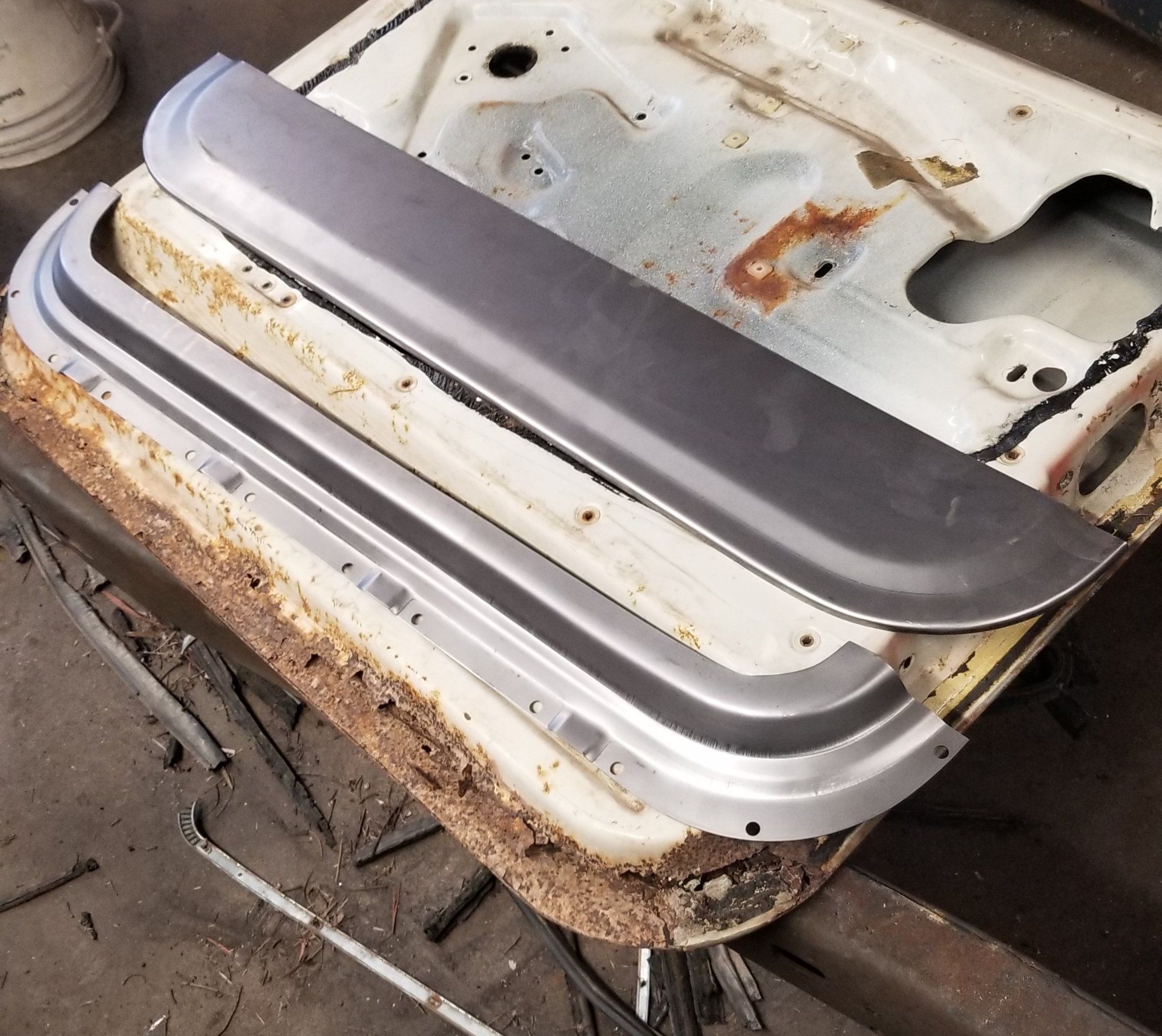

Couldnt stand it anymore.
Started working on the doors original to my 75.
The PS is hairy on the bottom, but there are panels for that. The ds is pretty clean.
A couple decades ago I found a 75 that had super clean doors and a nice floor mat....for 500 it was a steal, and easier to use those doors. Now I want the oes.

Both the front doors and the amby doors on my nephew's 40 were repaired with those patch panels. One of my doors was done the same, all the work by my body guy. He was happy with the way the patch pieces fit and we are happy with the finished results.

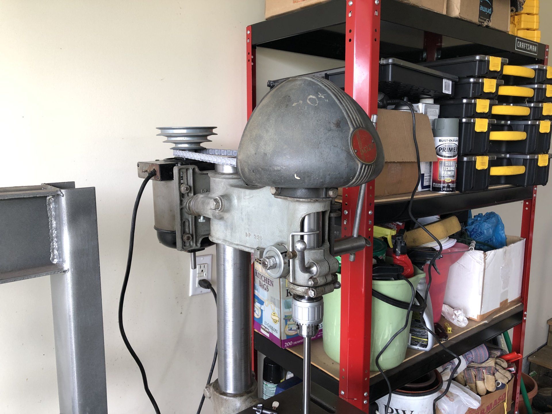

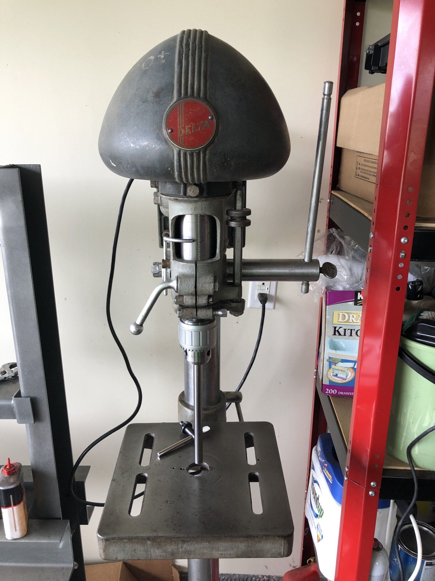

And bought an old, 1937 Delta high speed drill:
It didn’t take long to realize the bearings were about 30 years overdue to replacement and the runout was about .017 due to a badly worn chuck.
I tore it down put in new bearings and cleaned it up a bit. Put on a new chuck, and, most importantly, scored a low speed pulley and guard from a slightly newer (early 1940’s) Delta press from a local guy in Oxford, PA. This should get the RPM’s down to “metal working” speeds.
New low speed pulleys, belts, and some scrubbing later:
A bit of a mismatched “hat” for the pulley and a new chuck:
With the new chuck and bearings, I’ve got about 0.003 runout. The old repulsion-induction motor hums along great and I’m getting nice, clean holes.
I scored an extra motor pulley in the deal that I may use to build myself a custom idler attachment for even lower drill speeds. With that, I should be able to get just below 200RPM which should be plenty slow to drill some decent size holes in steel.

This is coming up next for me - if you happen to take some more pictures of how you go about cutting those up and welding in the new metal, and wouldn’t mind sharing, I’d appreciate it. I’ve never done bodywork and the prospect is intimidating.
I will put some in here but there will probably be more in the 40s section.
Not sure I'm terribly pleased with the panels. I went real steel parts this time and while nice, I think ccot panels may have been nicer.
I went Real Steel as well so, if nothing else, it will be a good direct comparison to what I’ll be dealing with.
Out of curiosity - what didn’t you like? These are the only ones I’ve seen so I have no real basis of comparison.

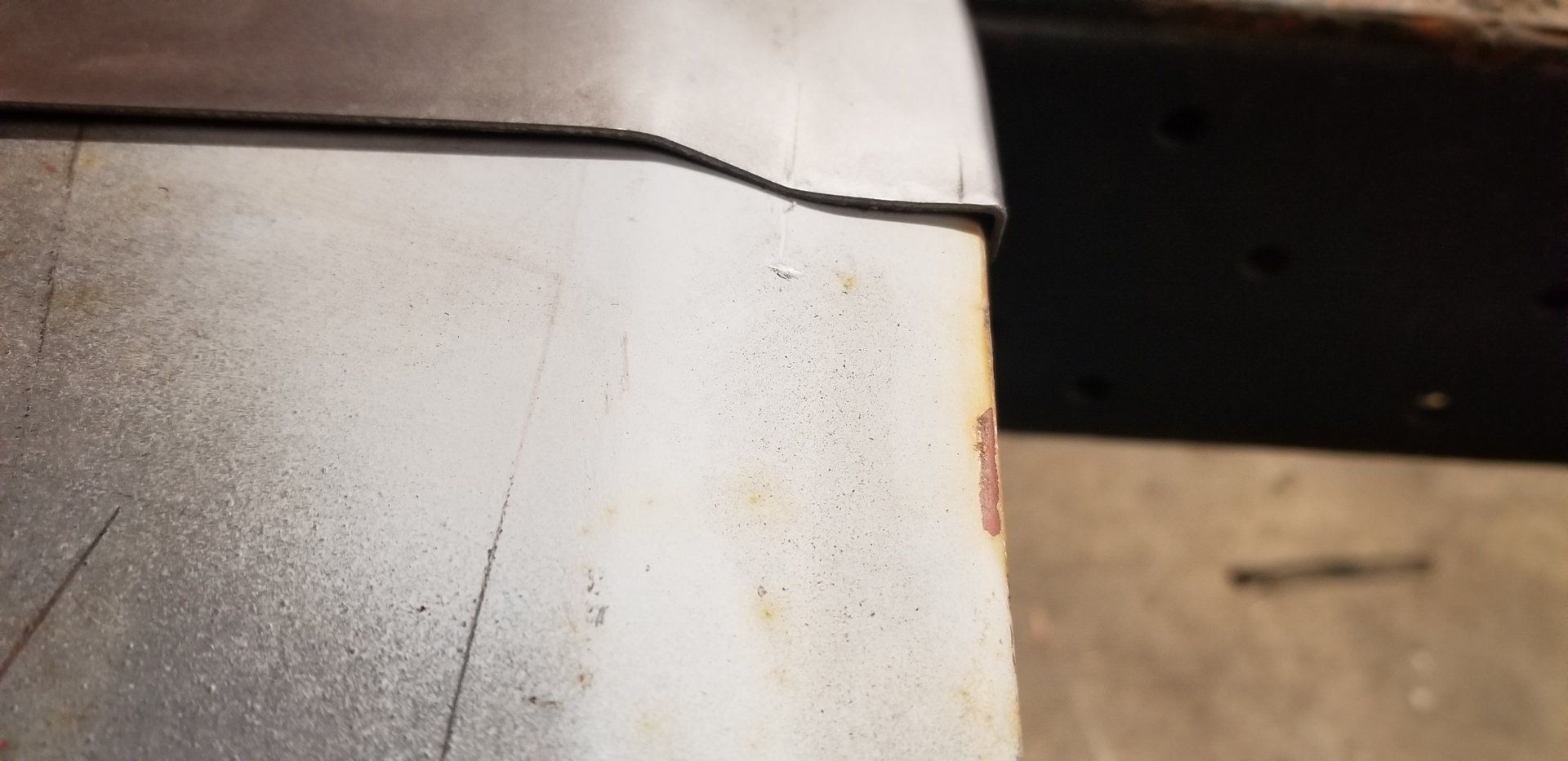

The outer panel is wide enough to over lay the door as is.
And the bend lines do not match up. So some game playing is going to be needed.
Ccot stuff is top shelf.
I have used some of real steel items and been happy, not sure I'm feeling it this time.
Going to have them blasted and start cutting on it. Once I can see what I actually have to work with I'll decide if I'm using them or going with ccot.
Yeah mine overlays a bit too but figured that was pretty normal. What’s the recourse there? Just cut/grind a kerf out of the middle of the patch until the edges line up? The only other thing I noticed were some corners (mostly on the rear ambulance doors) where the weather stripping would ride seemed hand-peened to get the contour/shape but not all that well. I think they’ll be useable though.

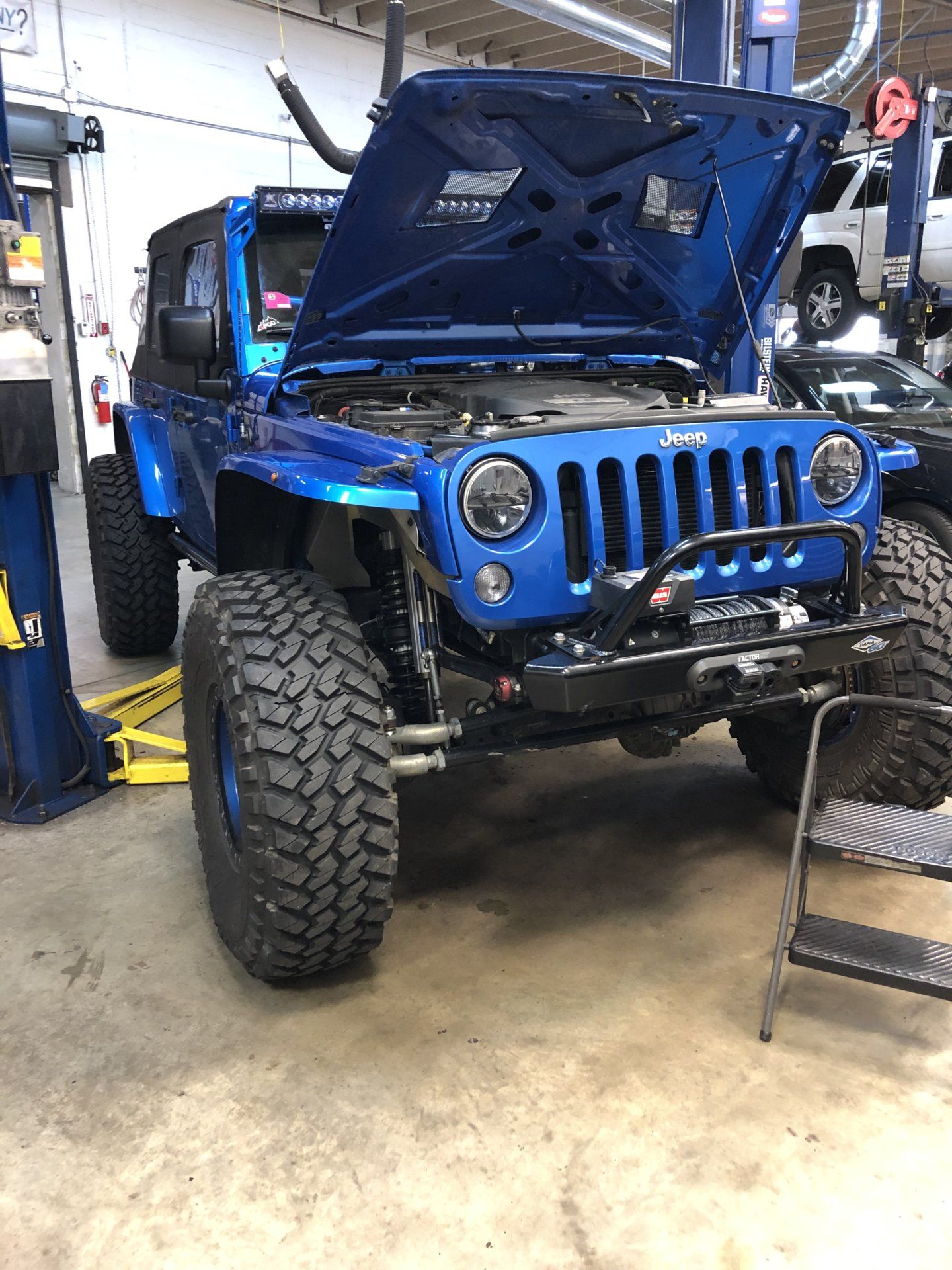

I can’t remember if I posted this in here before, so if I did I apologize. This is my buddies Jeep, he picked it up over the summer. I’m not a fan of jeeps, much less working on them but this thing is pretty wild. 40” tires and Dana 60s is pretty bad ass regardless of vehicle.

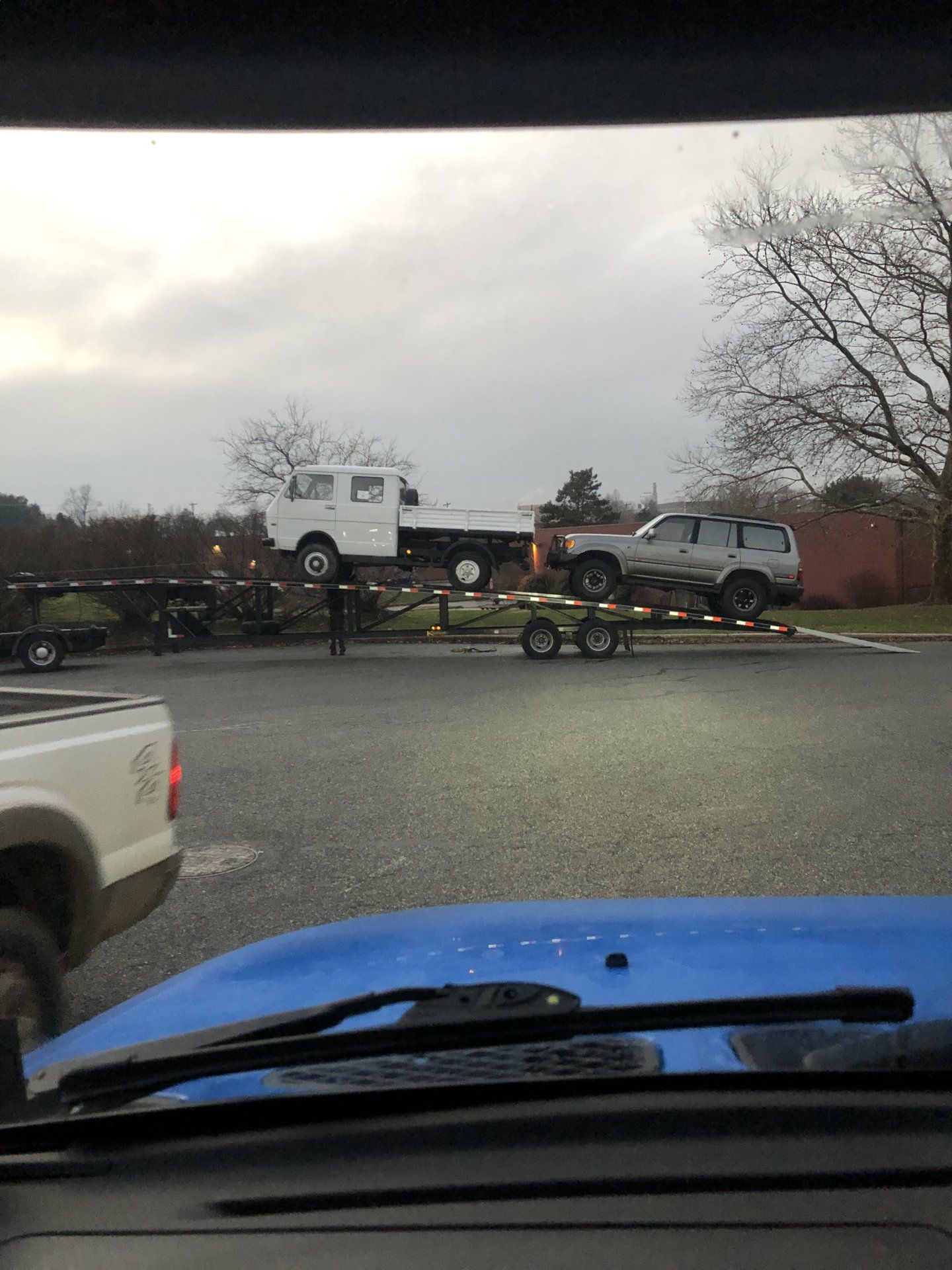

Also I had serviced this 80 series for a mud member that purchased it from a local guy but lives in CT. The transpost vehicle came by with this diesel 4x4 vw (that has air lockers). As I found out said vw was purchased over seas (belongs to a friend of a friend) and was making its way from the port of Baltimore also to CT.

Dana 60 in the front too?
Did he buy it built?
I've seen these VWs before... It's a larger body than a vanagon?
Yep, 60s front and rear. Bought it built. It was Rock Krawlers demo vehicle. He drove it in Utah (he works for quadratec) and told the owner if he ever sells it let him know.
Yes, those are slightly bigger than vanagon body vehicles. Lots of neat stuff showing up in the us lately as that 25 year law is getting into the mid 90s.

hows that thing pass inspection with that much tire hanging out?
