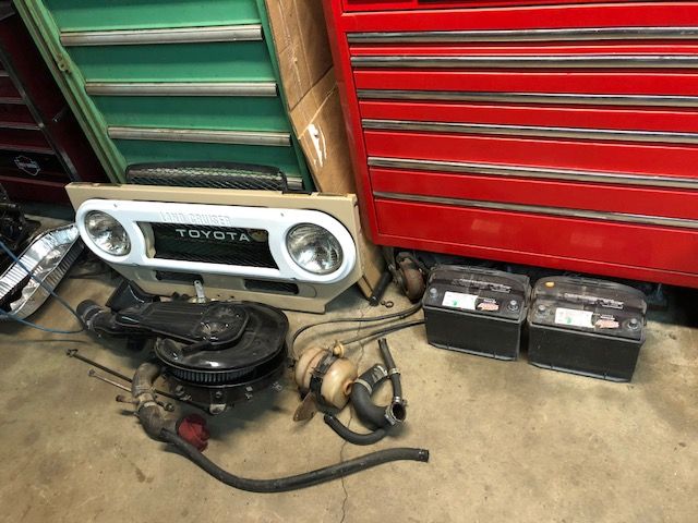

@shmukster - since you have that grille and bib sitting there separate, any chance you could send me (PAToyota AT verizon DOT net) a high resolution photo of it straight on with a yardstick or tape measure below it for scale? I am working on a project and have been looking for a good, clear photo.

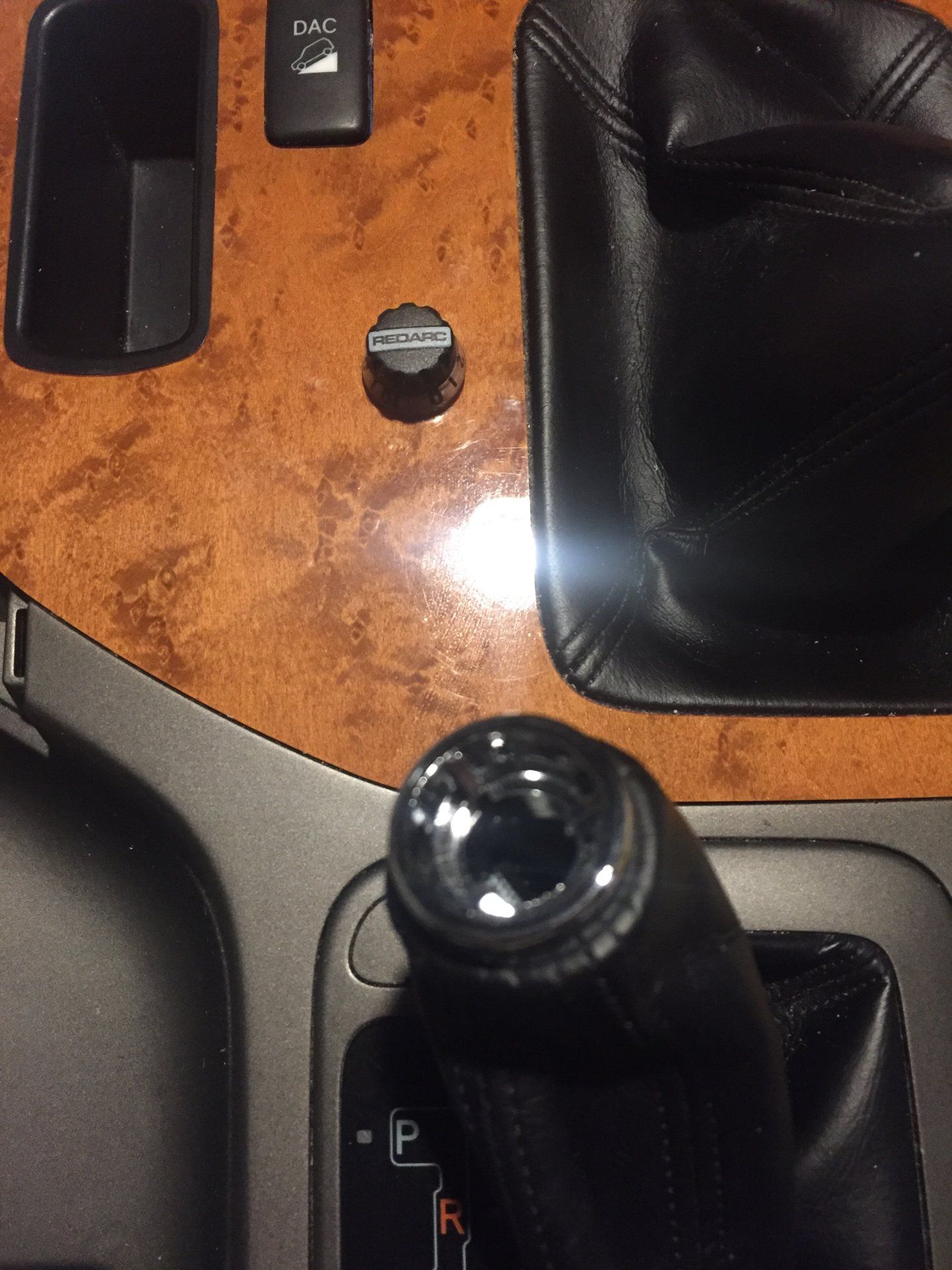

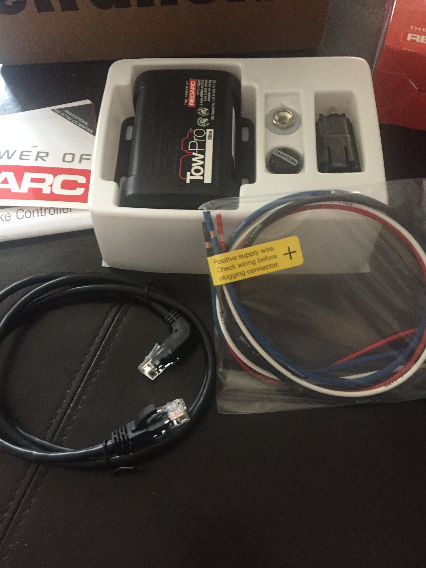

Nice job! Those are supposed to be really nice! I like how they mount out of the away. I was going to get one for the Tundra but got a good deal on a Tekonsha P3.
I can see that. More room in the Tundra to mount a controller. Wanted to mount the REDARC on the dash but the blank that I was going to use had metal reinforcement behind it and didn’t want to get into fighting with it. I had looked at the Tekonsha and was going that originally until I read about the REDARC user-control mode. Seemed like a good option for pulling our small trailer.
