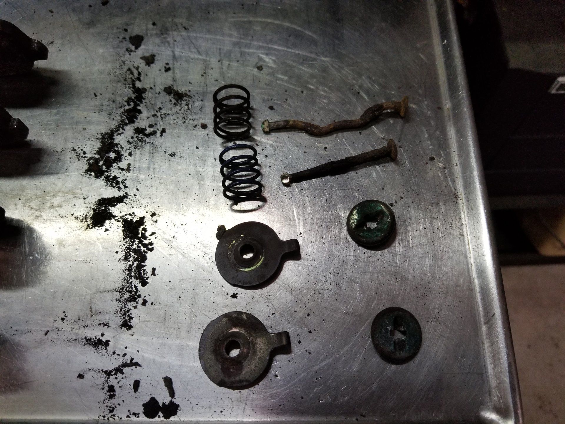

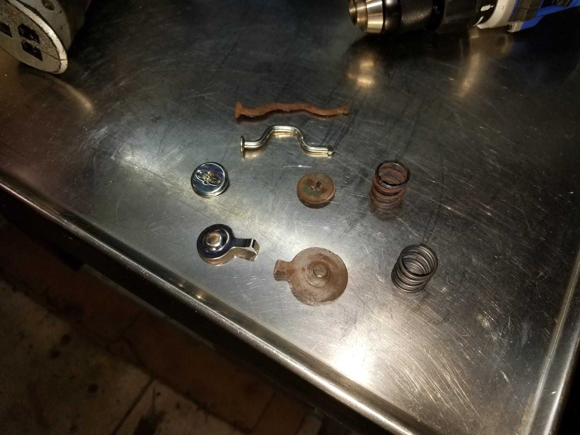

Parking brake on drivers side was mangled. I knew that, finally decided to repair. You can see where it's missing a piece. Top 2 are DS, bottom 2 PS.
Realized while I was in this process that the DS caliper was sticking and PS was leaking ... balls. DS pads up top, PS on bottom PS pads were soaking wet.
Installed new parking brake hardware. Not fun, but just a little swearing. Old DS components were beat.

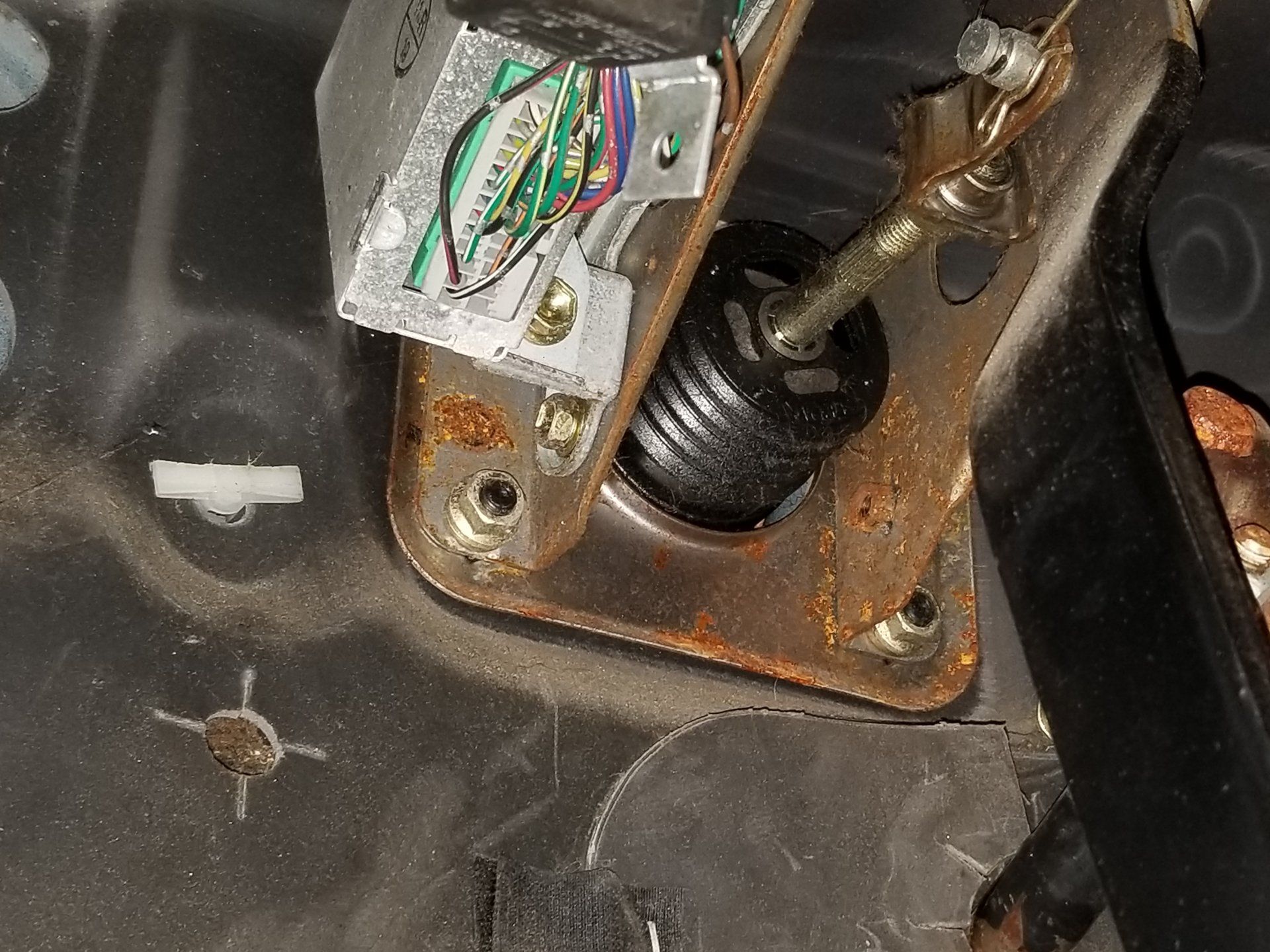

Can anyone say if this little box and wiring is stock? It's on the Cammo cruiser and squeaking constantly as I drive. It did have an aftermarket alarm installed, wondering if this is part of it.
It's on there with Toyota hardware, I'd say it's stock.

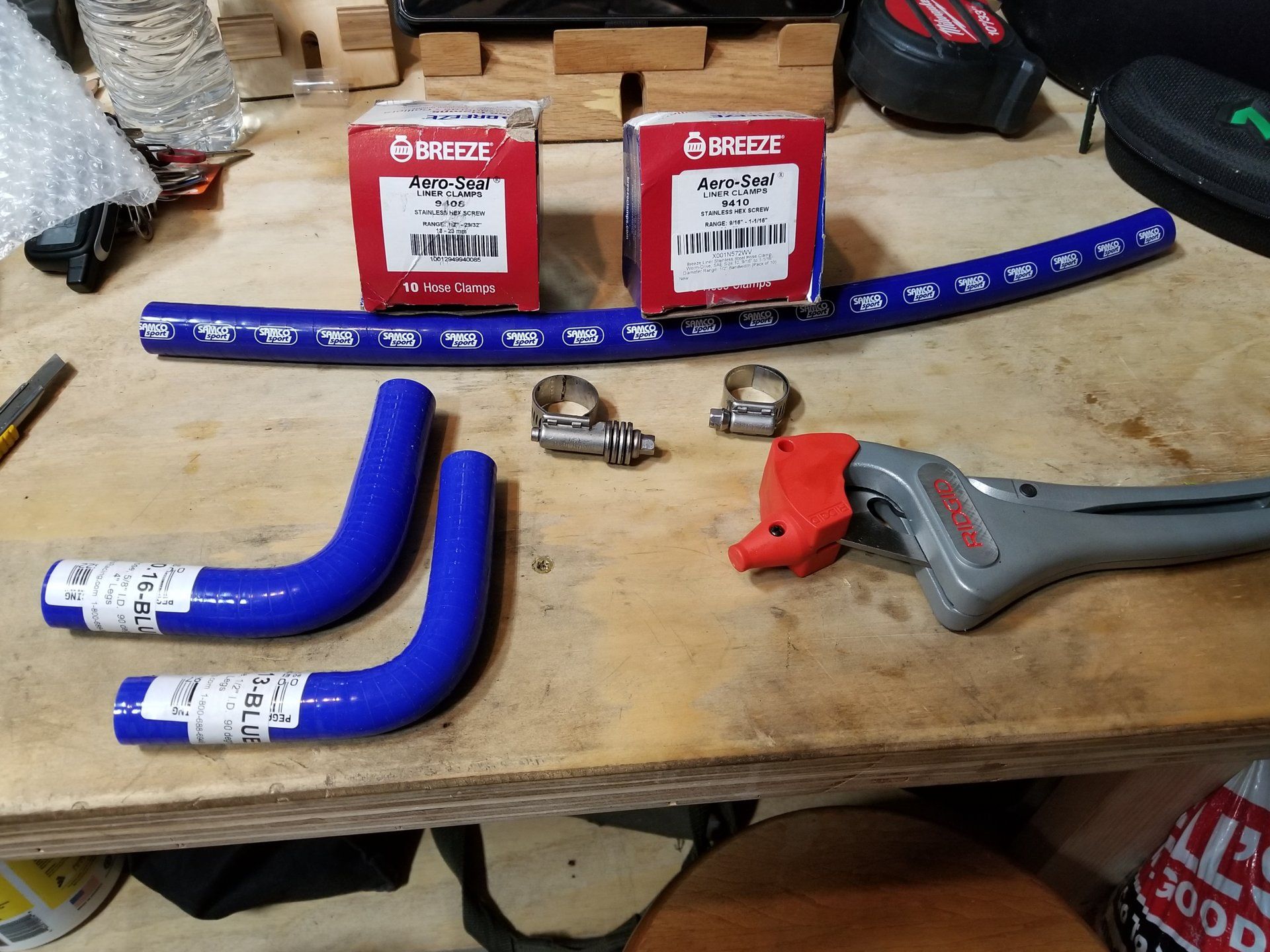

I finally had some time to do the psky heater hose and heater control valve replacement on the 80. I went with silicone heater hoses and breeze constant tension hose clamps. I purchased some really nice 90 ° 1/2" & 5/8" silicone hoses from Pegasus Racing.
You may want to do the hose just to the left of it as well while you are there. Mine went less than a month after I did the PHH.
Thanks for letting me know! Do you know what size tubing you used and do you know where that hose connects to.
I believe it's the same size and similar length to the PHH. It's in the pic of the PHH you posted just to the left. After having my feelings hurt by the PHH I had Toyota do the other hose for me ... cause I'm soft like that.
Also, I have the same constant torque clapms you have and have seen them constantly become loose and need to be re-torqued. Go back over things after a few days and check. Mine may also be caused by the Gates hoses, it's super beefy, so it may be that it just doesn't compress fully on the first try.
So is it as hard as the psky heater hose and do I have to remove the upper intake plenum to get access to the hose.

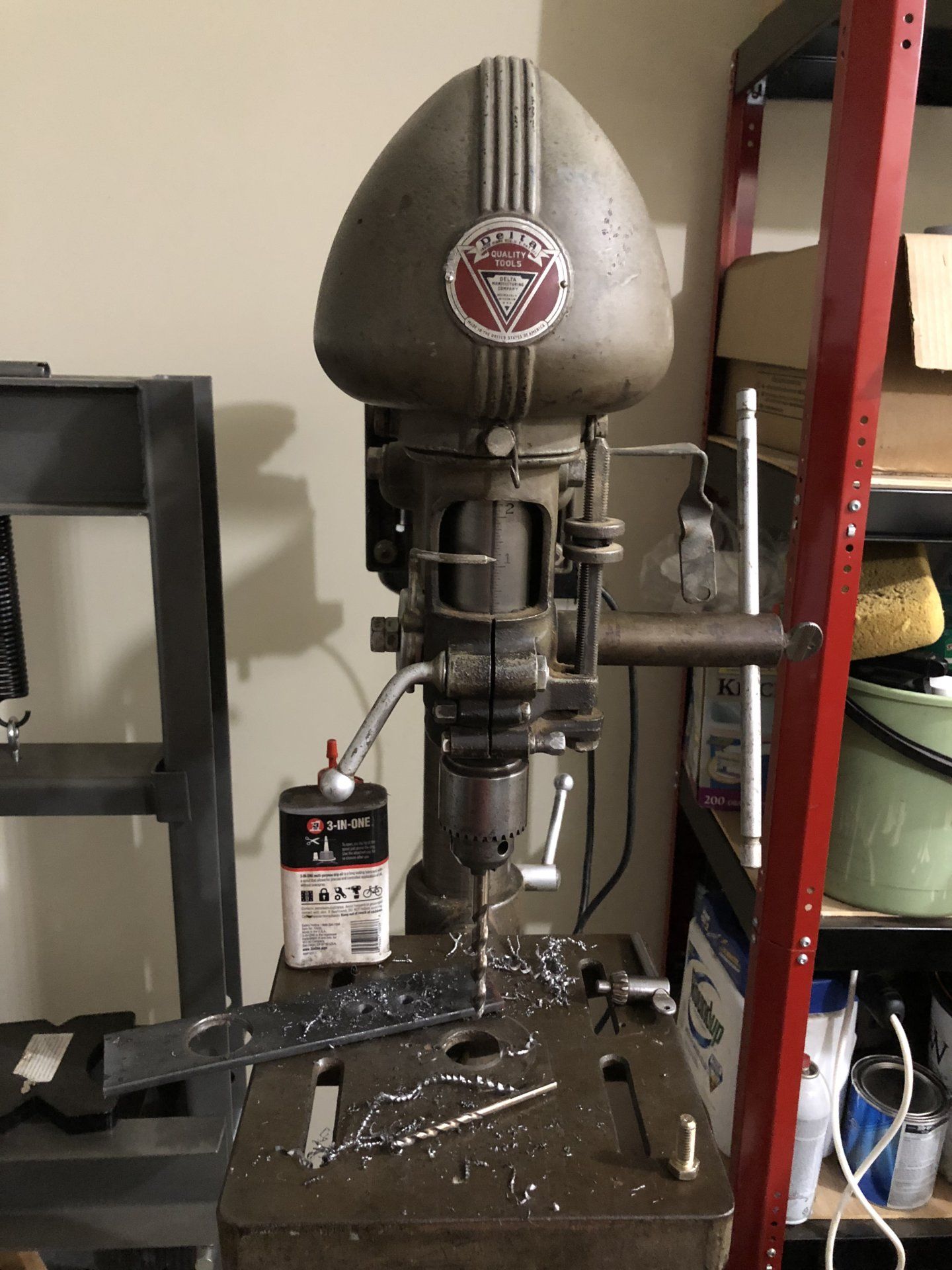

Picture worthy project - I’ve also been working on cleaning up this old piece of American Iron.
It’s pretty complete. The run-out is pretty bad because the chuck is shot and it could probably use new spindle bearings. After all - it was built in 1937. Original motor hums along like its brand new though. The worst is a cracked head housing at one of the belt tensioner bolts, but there’s enough meat left to hold a scew and tension. I figured for $50 it was worth taking a chance on, and I’ve been pleasantly surprised so far.
I’m going to throw bearings, a belt, and a new chuck at it, and it will probably run for another 80 years.

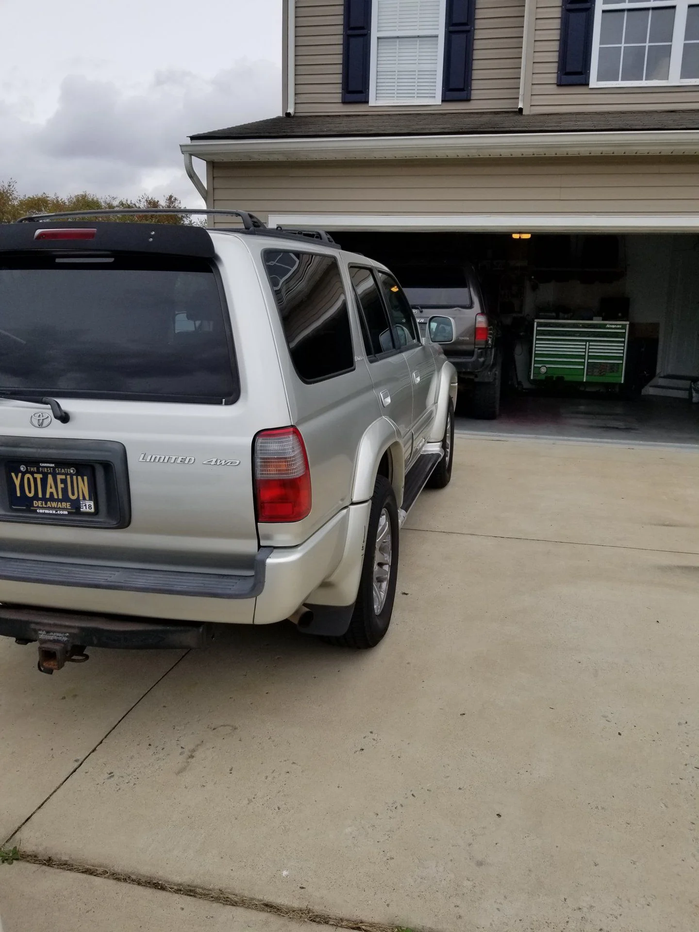

It was also time to pass on the name from the Brown 4Runner to the Silver 4Runner:

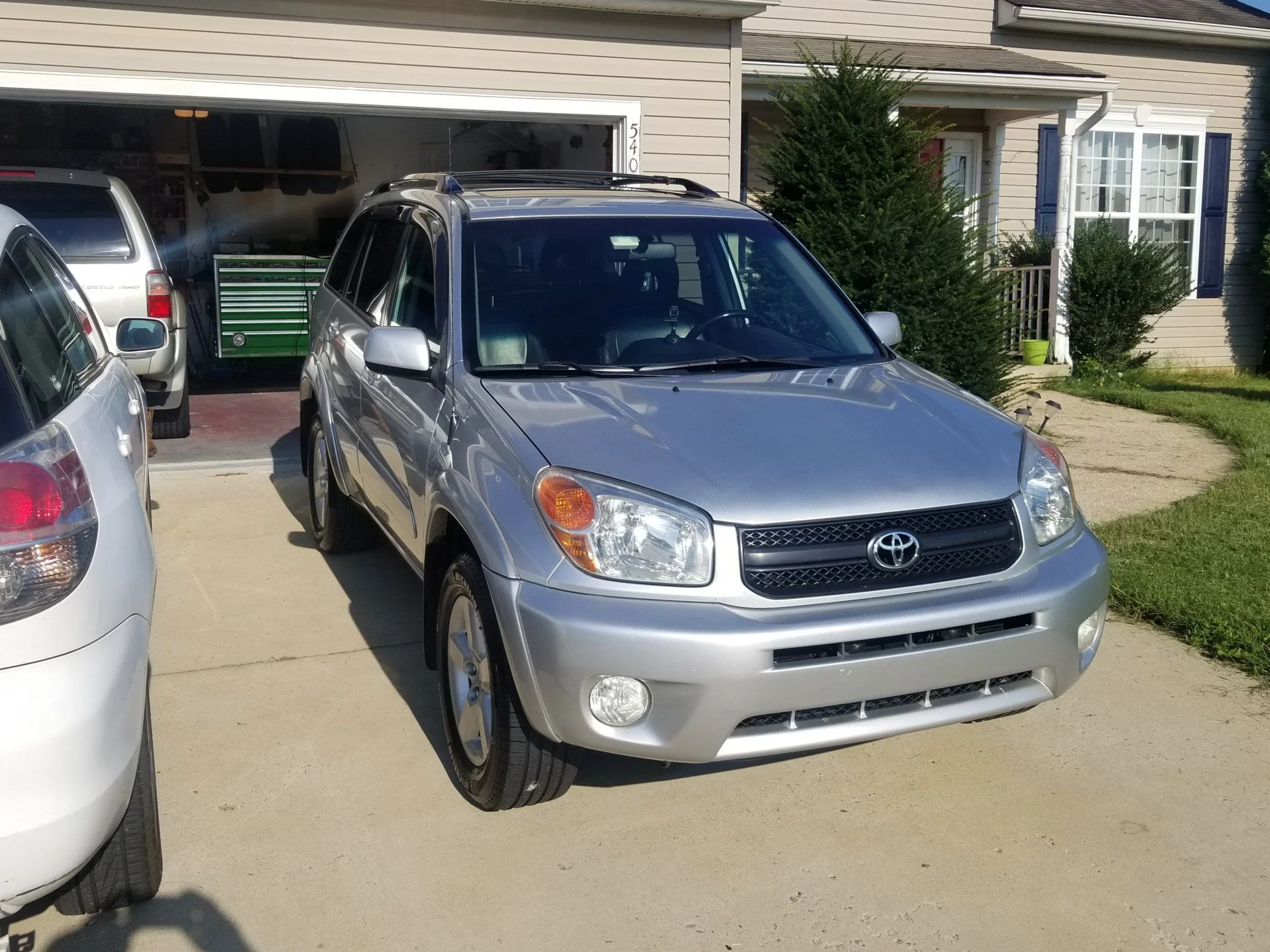

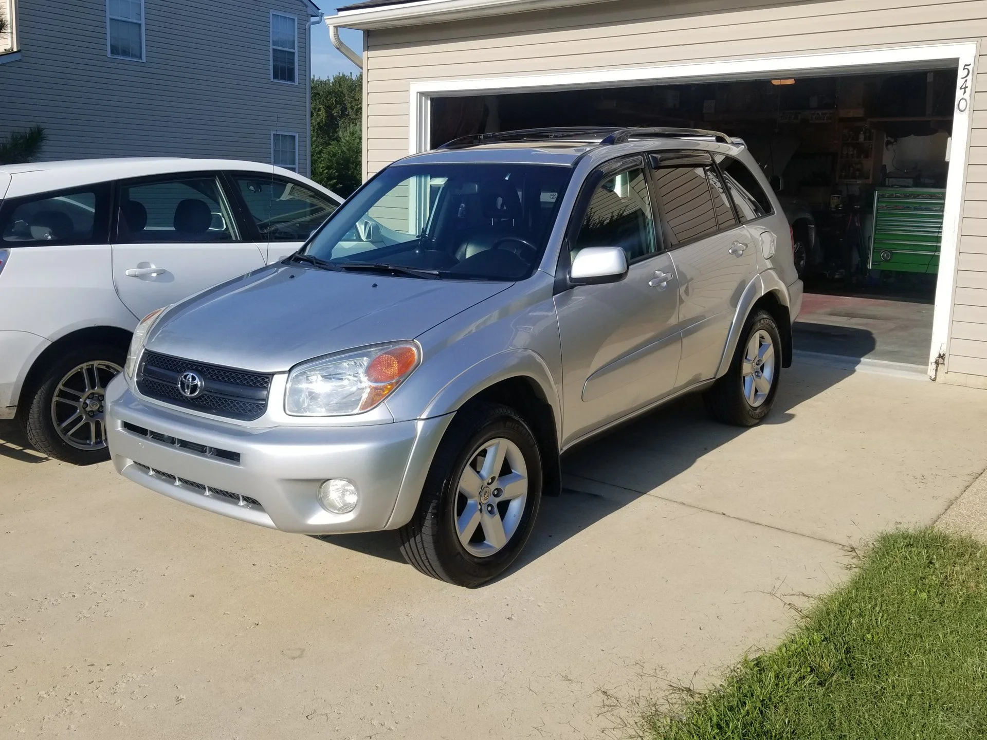

Then about a week after we came back from vacation, we got a new to us 05' Rav4 w/135k Fully loaded, leather, heated seats, and sunroof:
It popped up in our wholesale lot, and a deal I couldn't pass up, plus since I was taking the Stock 4Runner and making it the wheeling rig, I needed my husband in a 4WD I can trust, while the AWD matrix he had is great, it just wasn't big enough for my liking in case of an impact from and idiot in the snow, plus he's always wanted a Rav4 and I get my AWD daily our of the Matrix.

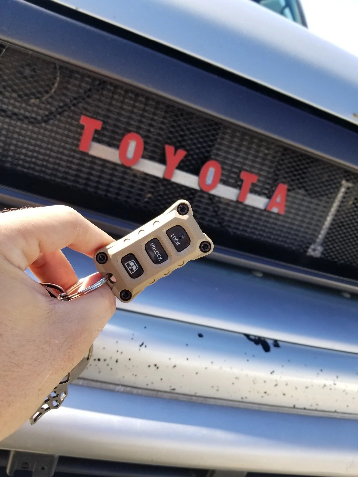

I also did some upgrade to the silver 4Runner, I moved over the grill from the brown truck and installed a powder coated FJ40 emblem I had and also got this cool key fob case for AJT design:

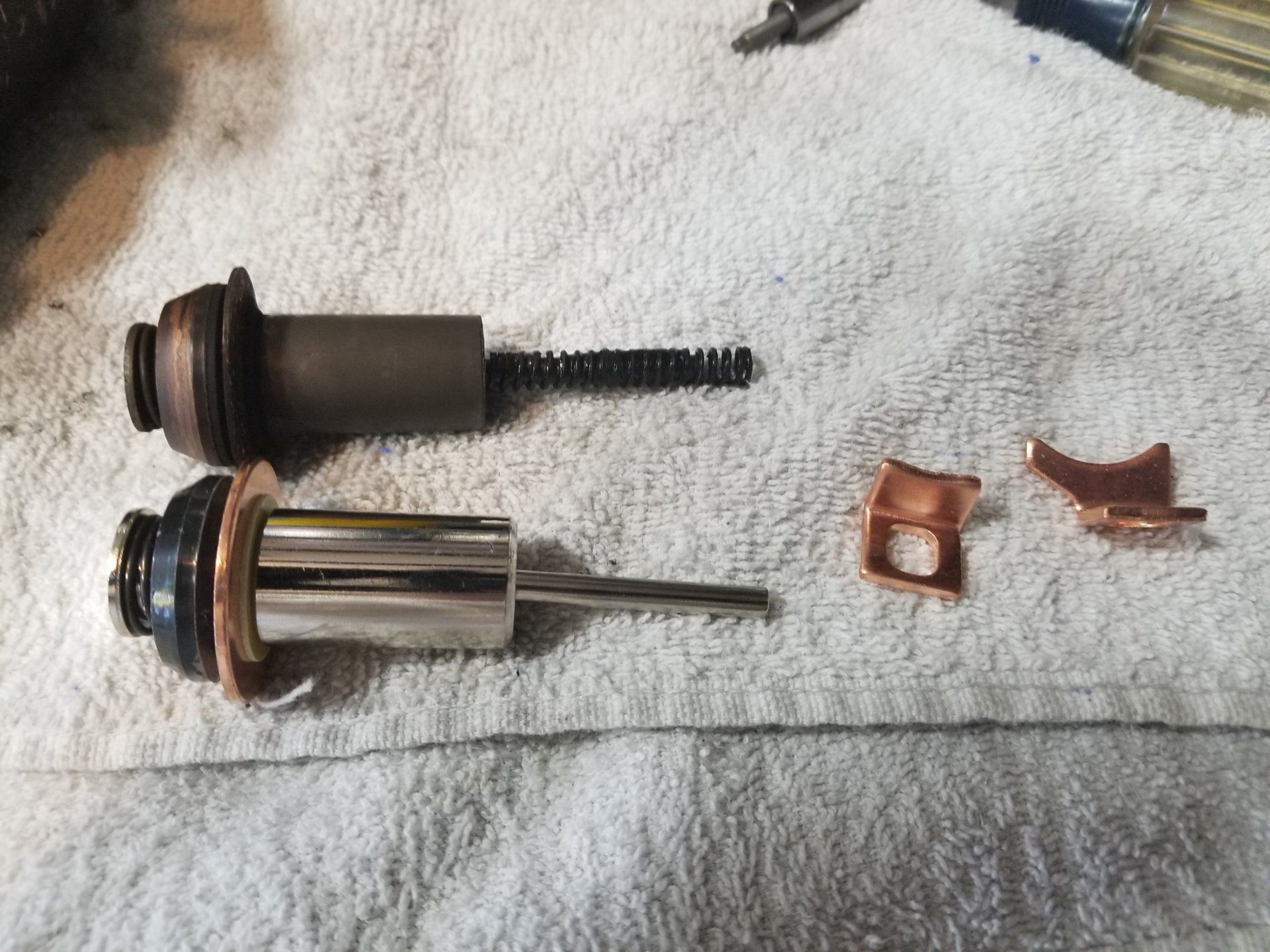

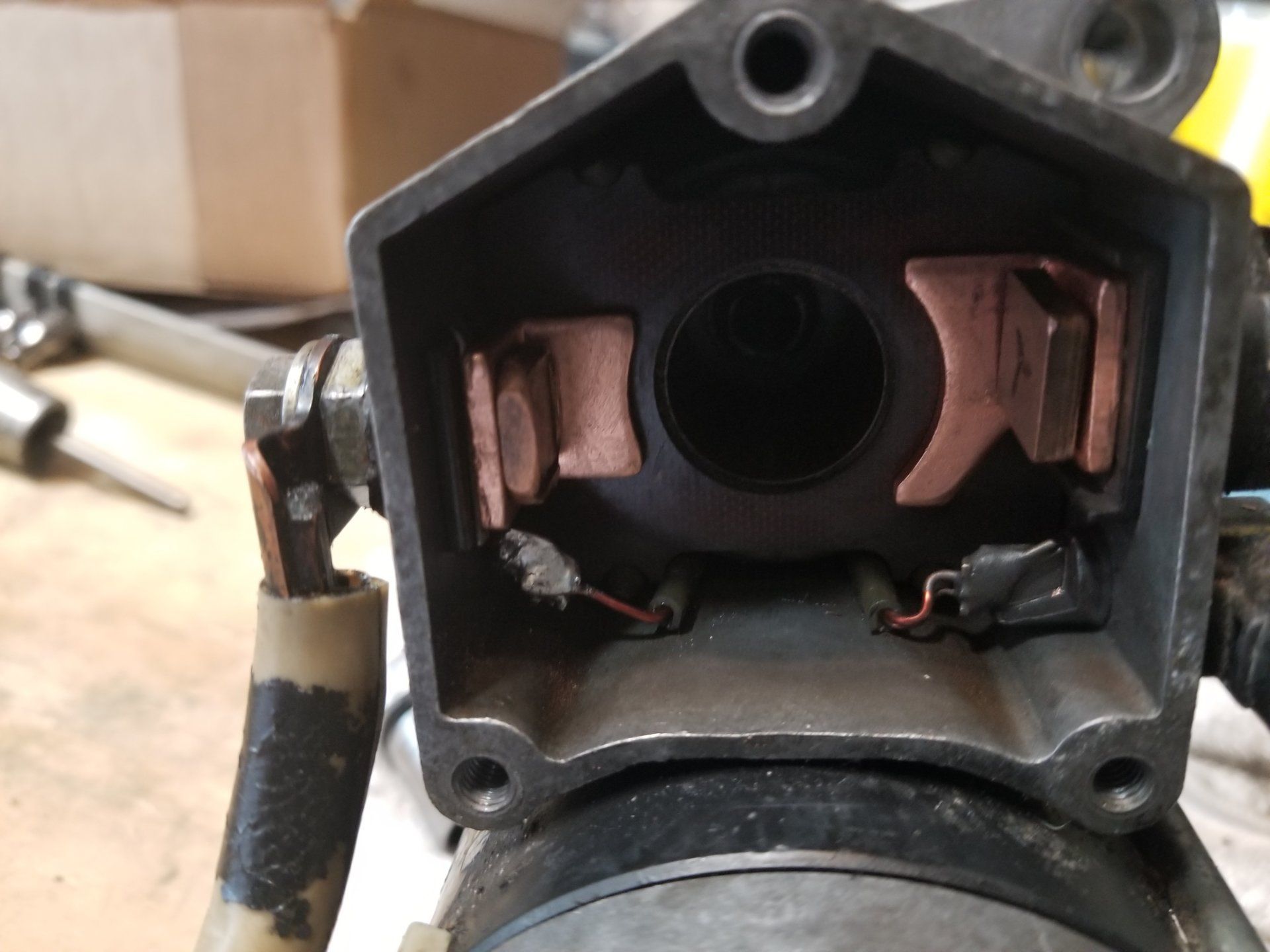

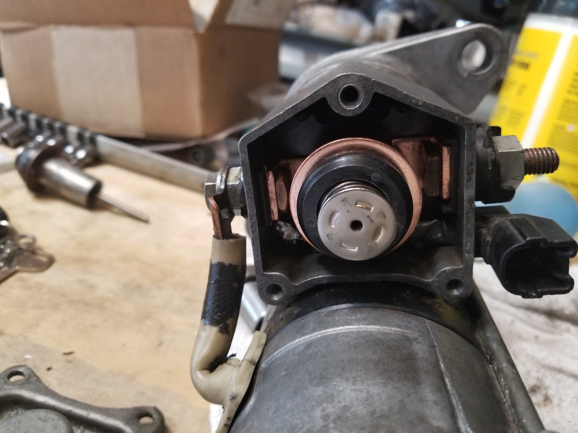

The upside to this is fortune, the starter took a dump, So I got a rebuild kit and freshened it up since there is so much room for activities with the cat out of the way:
At 230K I would say it was about time..
Still working on extracting the bolts in the cross over pipe to get the cat reinstalled...
Looks familiar on the starter contacts. I just done the 80 this weekend.
