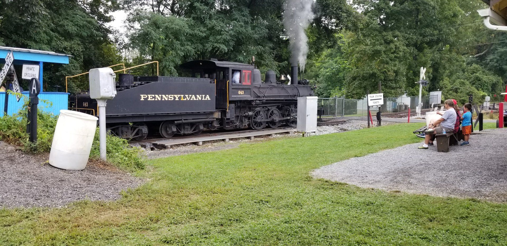

@brian i never got the full story on this - is restoring old trains a job? Side gig? Hobby? Looks awesome!
Very blurry line that covers all three.
Part of my paying job is taking care of any NB code work that comes in.
The shop doesnt advertise the R stamp we carry...so its sorta a side thing.
Also being a qualified welder I volunteer my skill set to help keep this one running.
I as well as the shop started off getting paid to replace the boiler tubes in it a few years ago. During that job it was pretty obvious that they would need addentional attention in the code department if they wished to keep all their repairs on the up and up....I like steam and steam powered equipment. My office job keeps me on the outside of welding hoods these days. This old girl gives me a chance to burn some rods and the occasional shirts on the weekends.
The payoff is being to bring the wife and daughter over when it's running and just ride all day.
At some point I may take one of their engineer or fireman classes. But for now I just busy myself with whatever metal work needs addressed.
There is a steam powered locomotive crane in the wayback that needs help...lots of help...its calling my name...so far I have ignored it, but the time is coming.

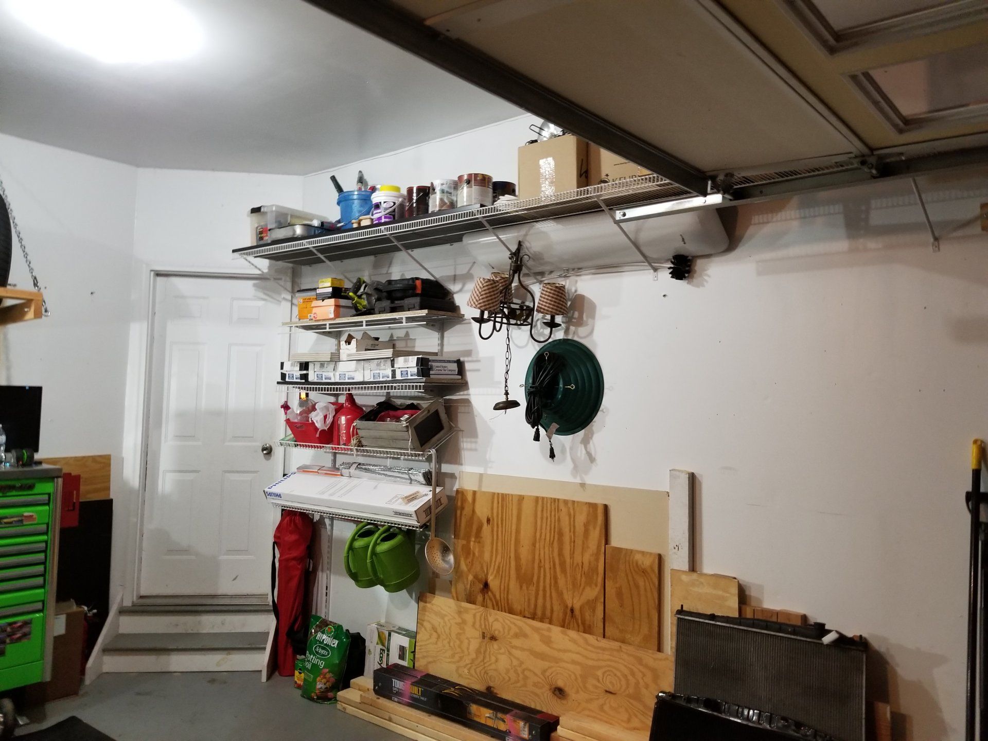

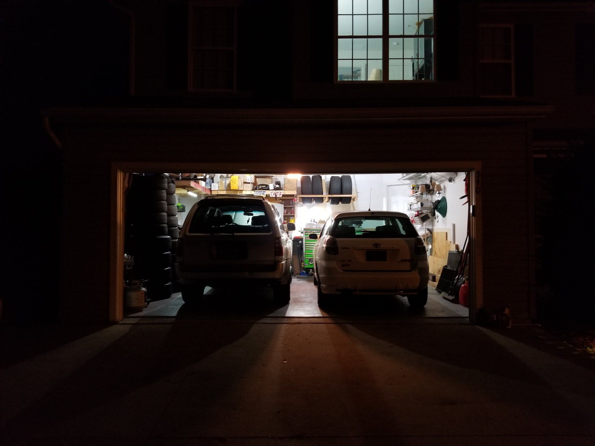

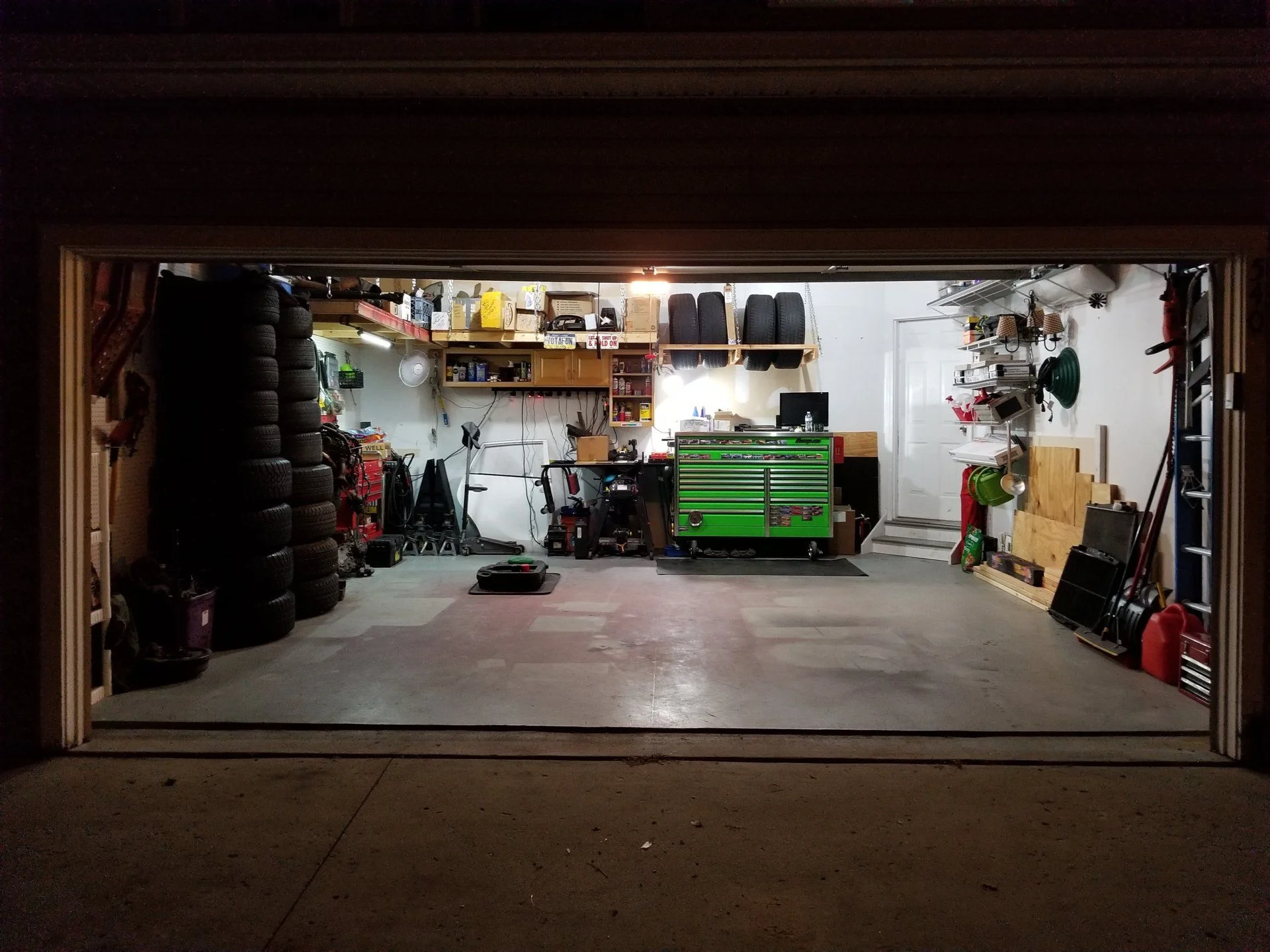

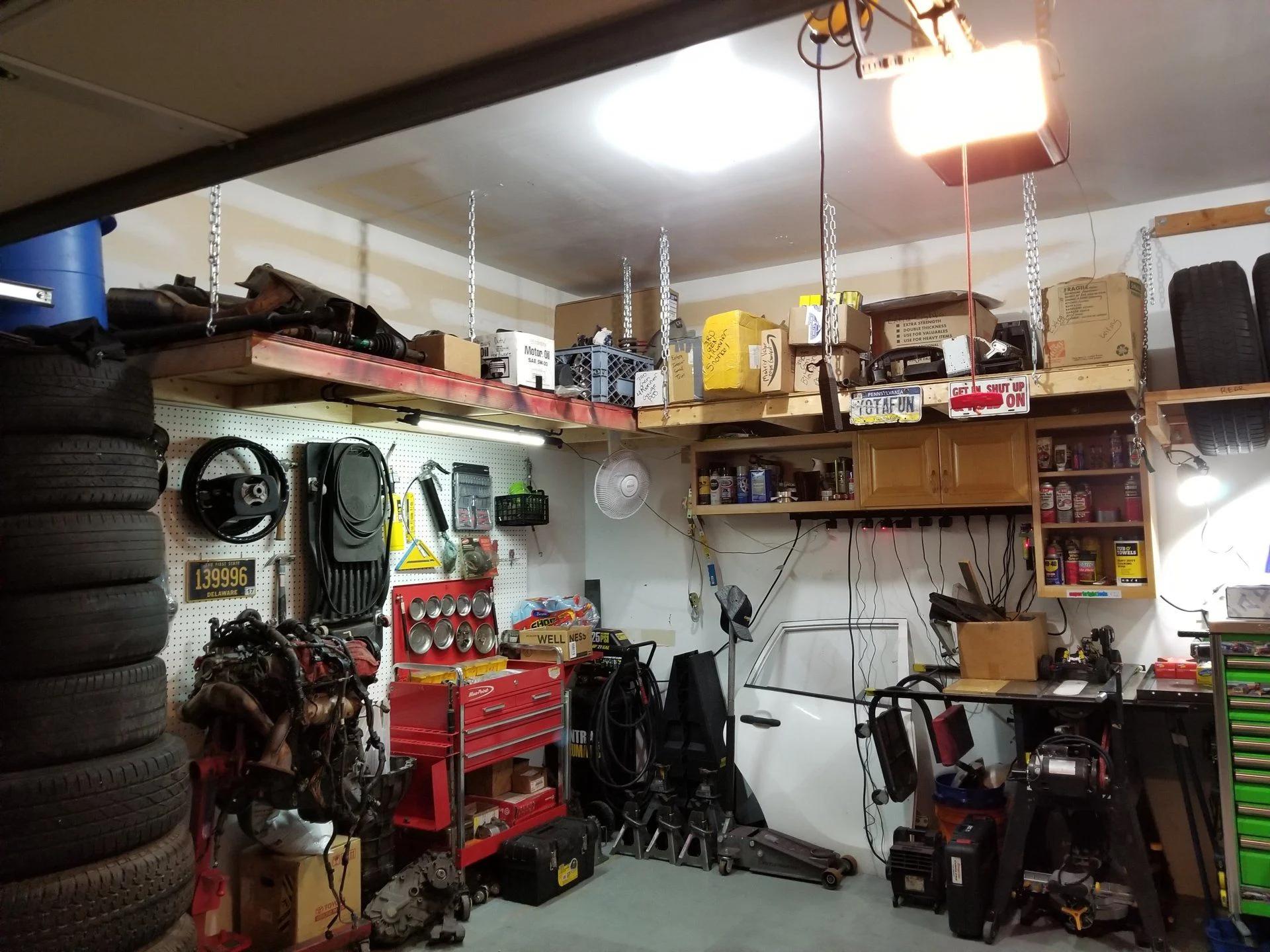

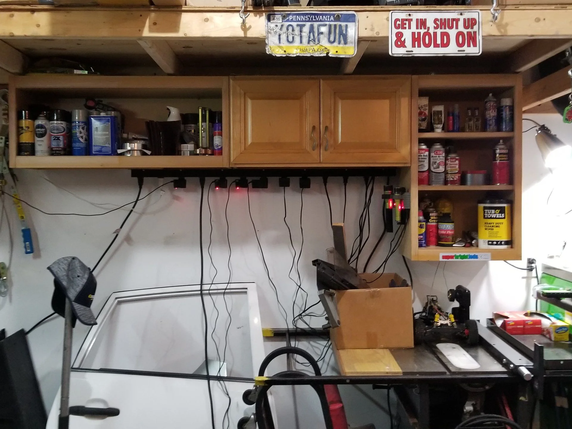

I found some motivation this weekend to get the garage is some kind of order, got to the point where I couldn't reach anything and it was very annoying.
Made some new shelves, added some cabinets, fixed some existing shelves (previous owner didn't have anything tied into a stud...)
Goal was to get a 4Runner and a car in, mission accomplished.
Yes there are a lot of tires, that will be next once I am back from vacation.
Also need to clean up the wires and find a better place for the table saw, thinking a hoist system of some sort....
^^^ Nice garage !!
