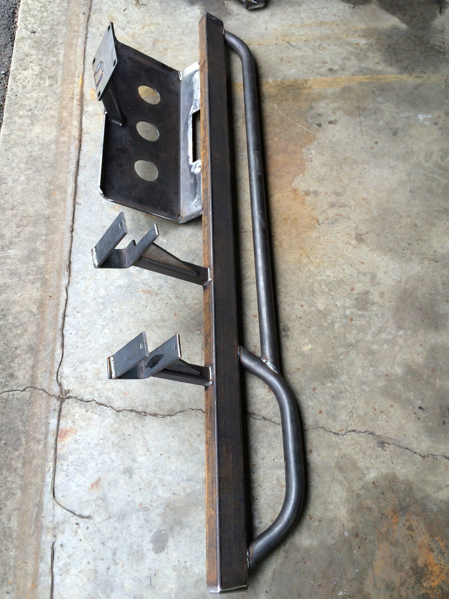

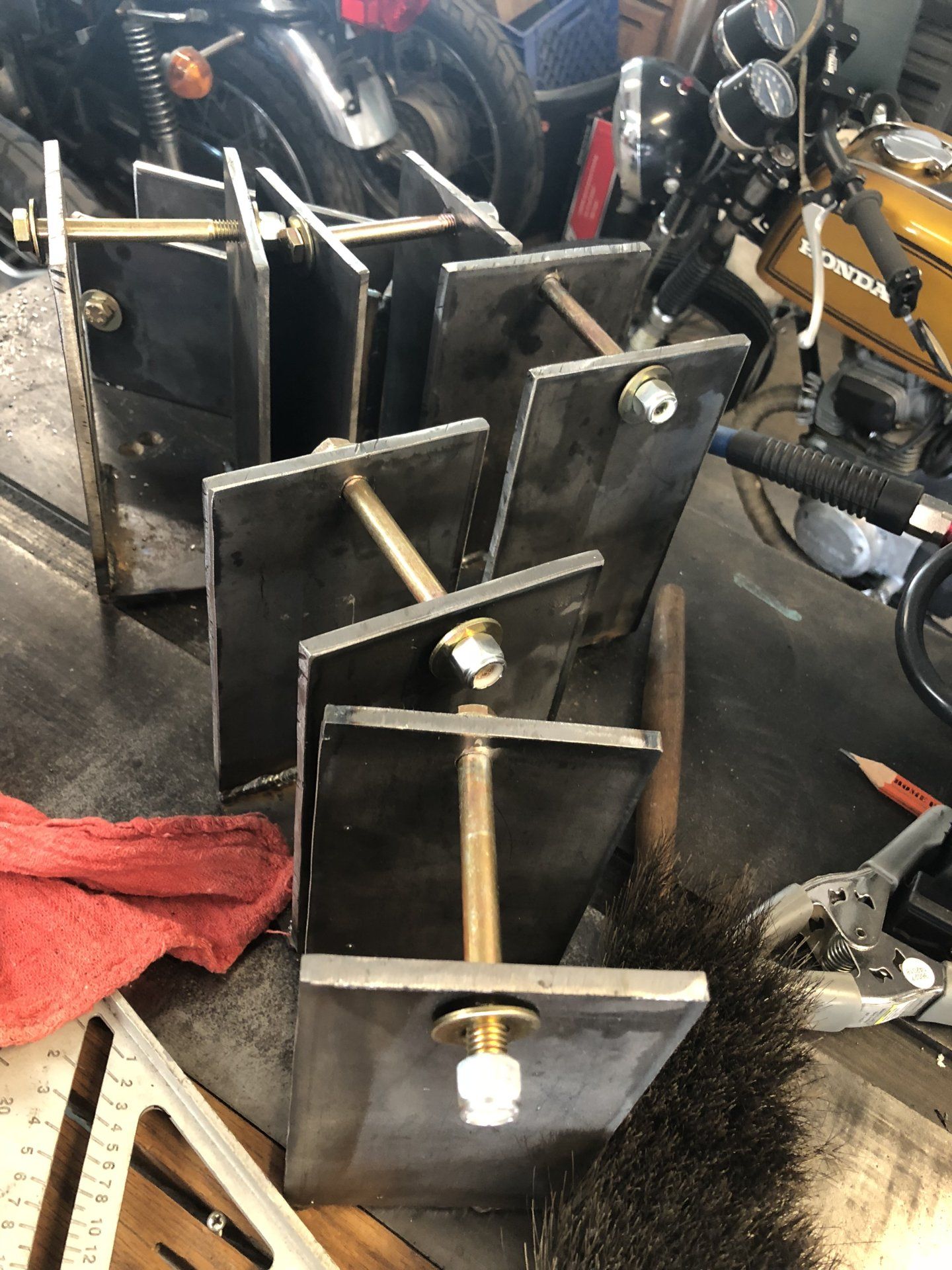

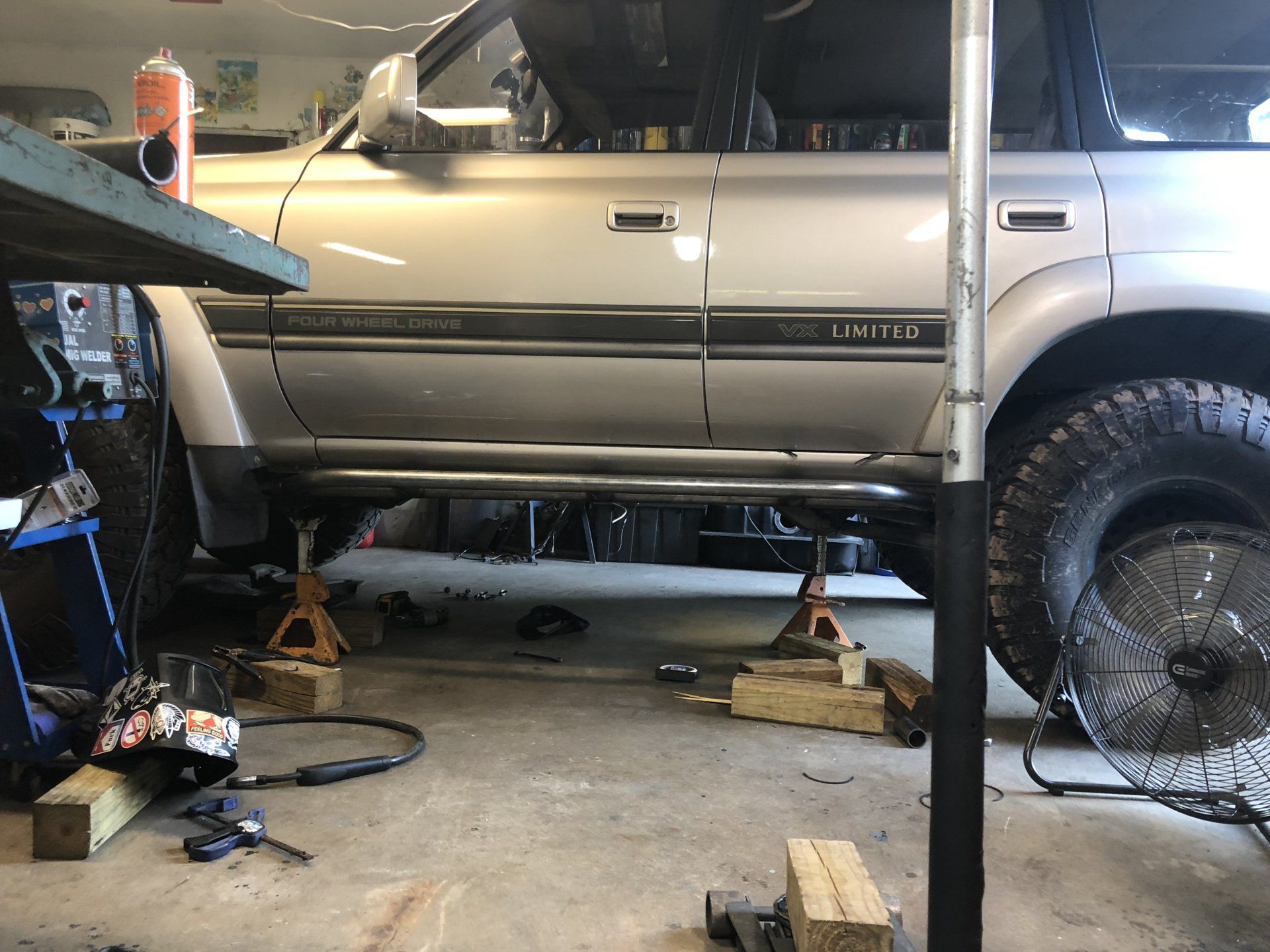

Finally getting around to building some sliders, ended up using the trail gear 67” taco sliders and made U brackets to go around the frame Instead of welding directly to the frame. Still need to add gussets and bracing, fully weld everything then off to powder coating.

Budget wise these were a great option. all in I’m at around 300 bucks and around 10hrs of fab time.

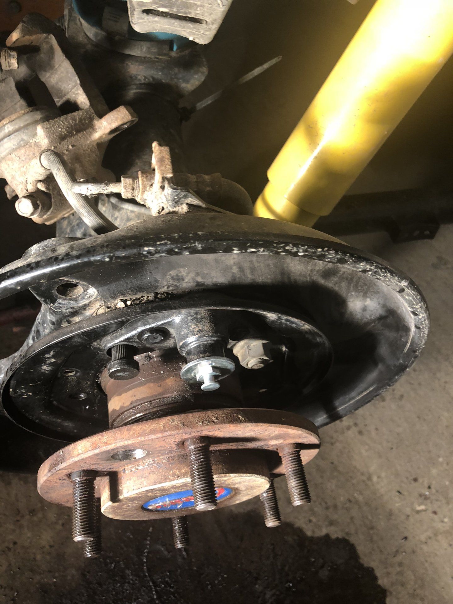

@Cass007 your sure the nut for the wheel bearings is tight? I know you re torqued it but maybe check again.
Andy - I would see wobble when I lift the wheel with a jack. At least I did the first time when I followed the cheat sheet and only torqued to 10 ft-lbs.

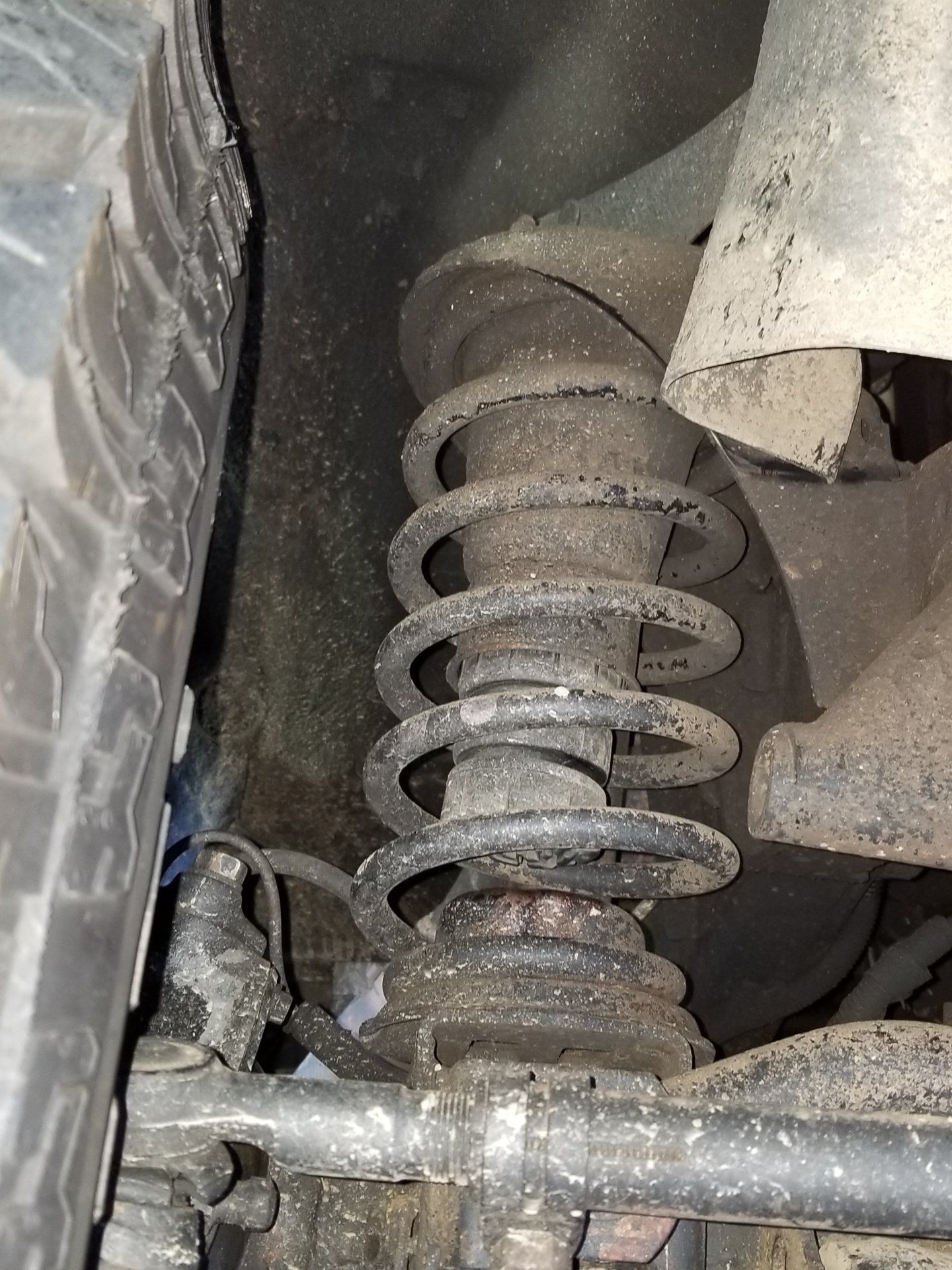

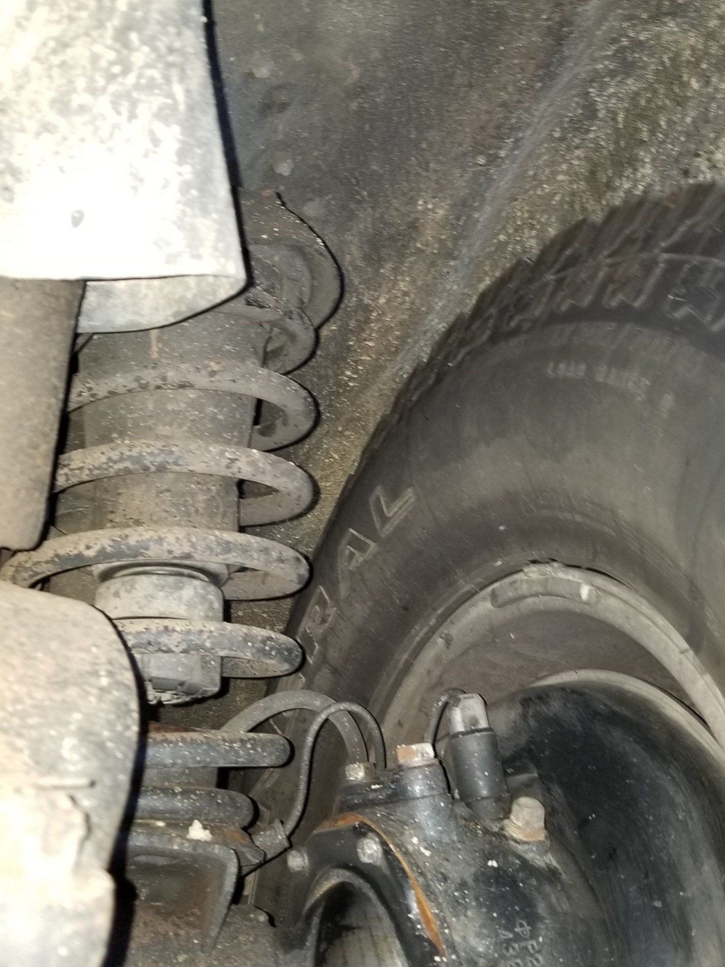

Looking at things, it seems I'm driving on the inside of the tires pretty hard and the knuckles seem a bit splayed out on the bottoms on both sides. Is that a normal angle?
Will try and get a pic of the shocks, but the are hard to see and man it's HOT out. In the back of the last pic you can see the cat so close to the slider.

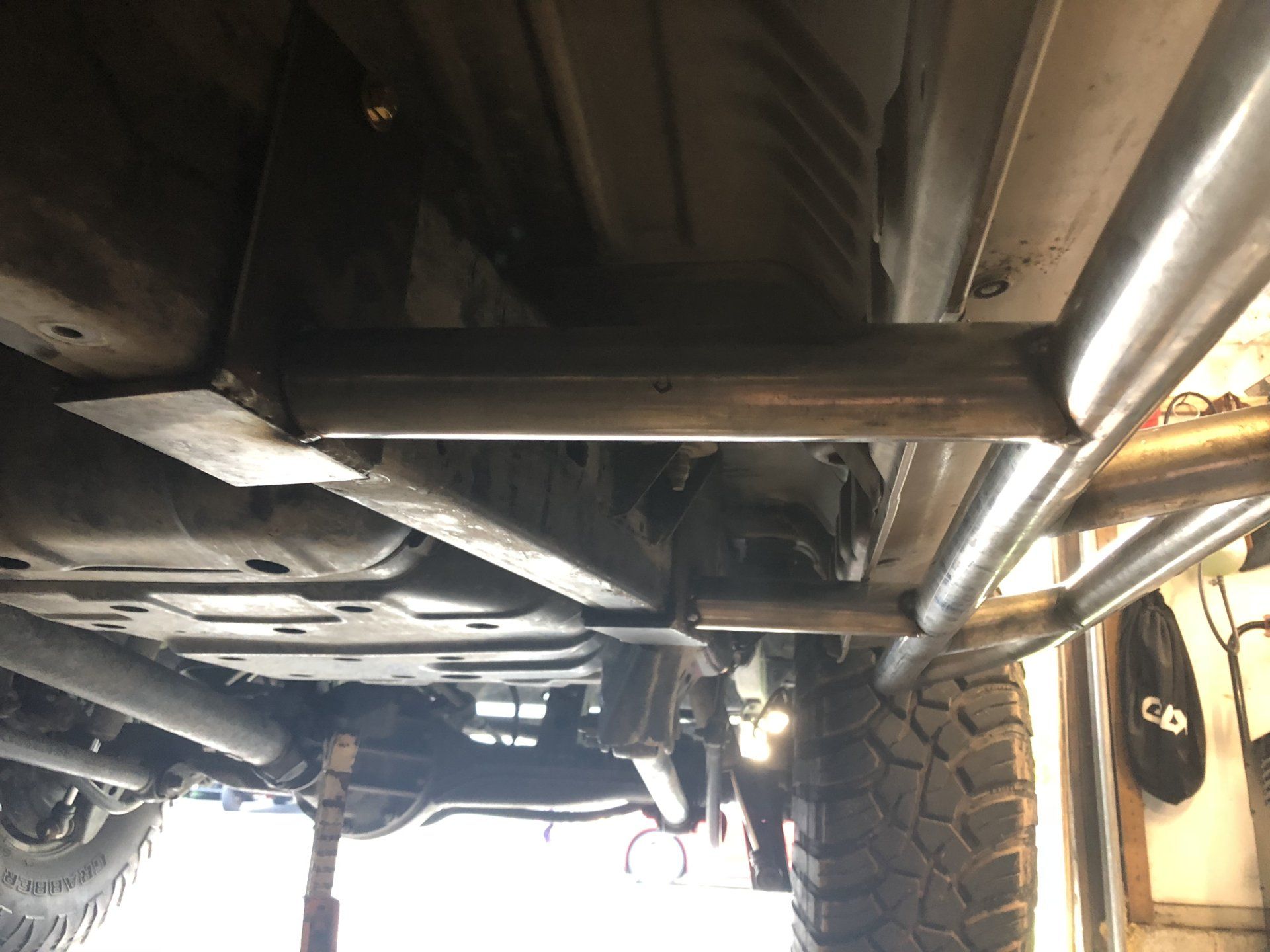

@Bobby Williams the sliders look nice but I see a few problems.
1. You didn't allow for body movement or slider flex. Your going to want around 1" clearence for the body. It looks like you notched the rockers for the stand offs.
2. Your stand off modified for the exahust is not near strong enough.
3. You used a taco kit so I would recommend a 4th stand off for a heavy cruiser.
Thanks man! there's much more going into the sliders to beef them up. this was just the inital fitment and tacked them together.
The only part where I don't have 1" clearance is the bottom rocker seam and that I will let clearance its self, it has almost 2" from the tube to the actual rocker.
Each leg is going to get a tube gusset and should be pretty stout when alls said and done. the exhaust leg is 4 x 3/8's plate and 1/4 wall 2x2 and will also get reinforcement similar to what @fireball posted.
Once its all welded together I'll test them out with the fork lift to see how she holds up before i powder coat. I've seem a few guys on mud build with taco sliders with only 3 legs and they seem to hold up pretty well.

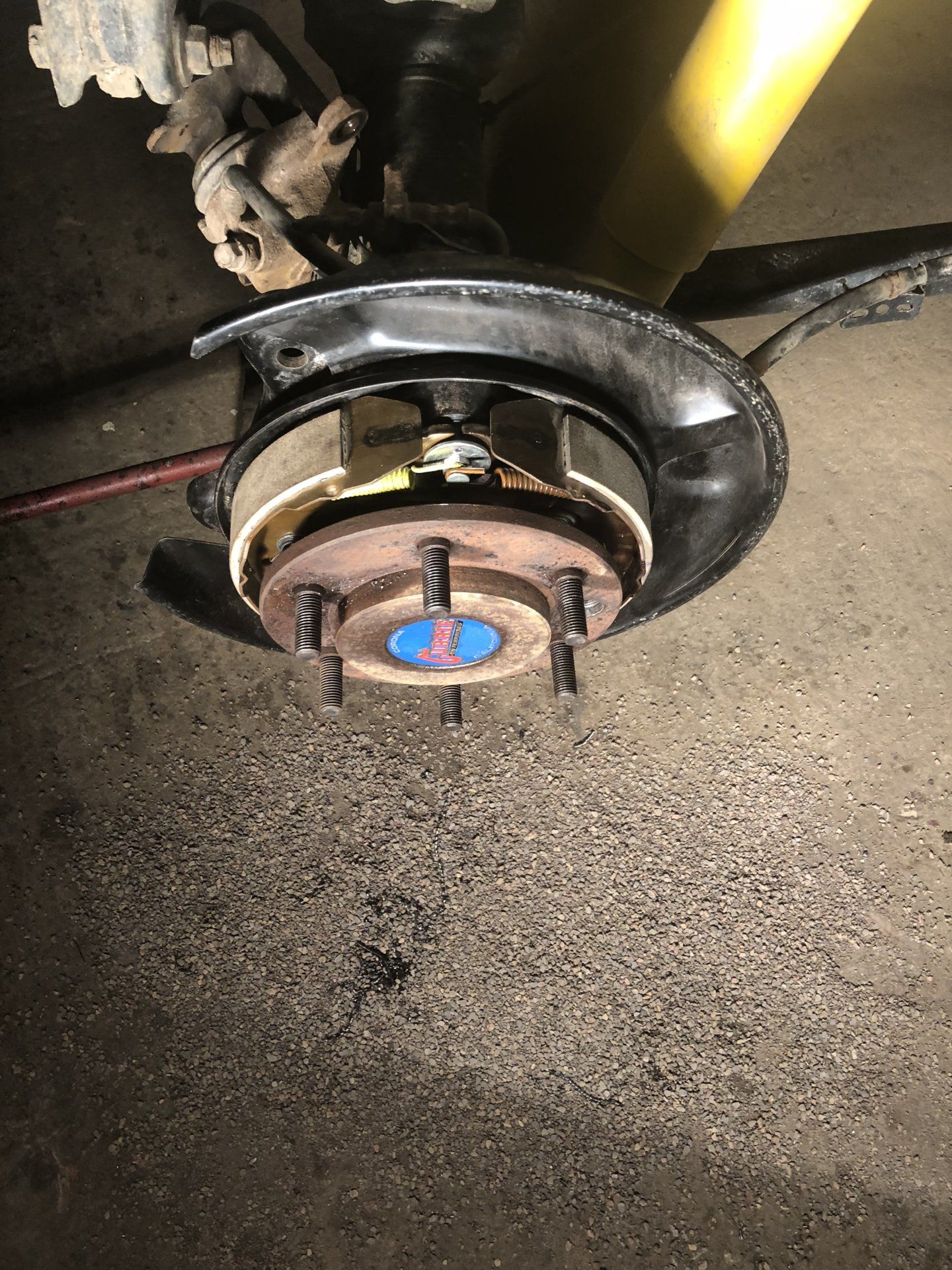

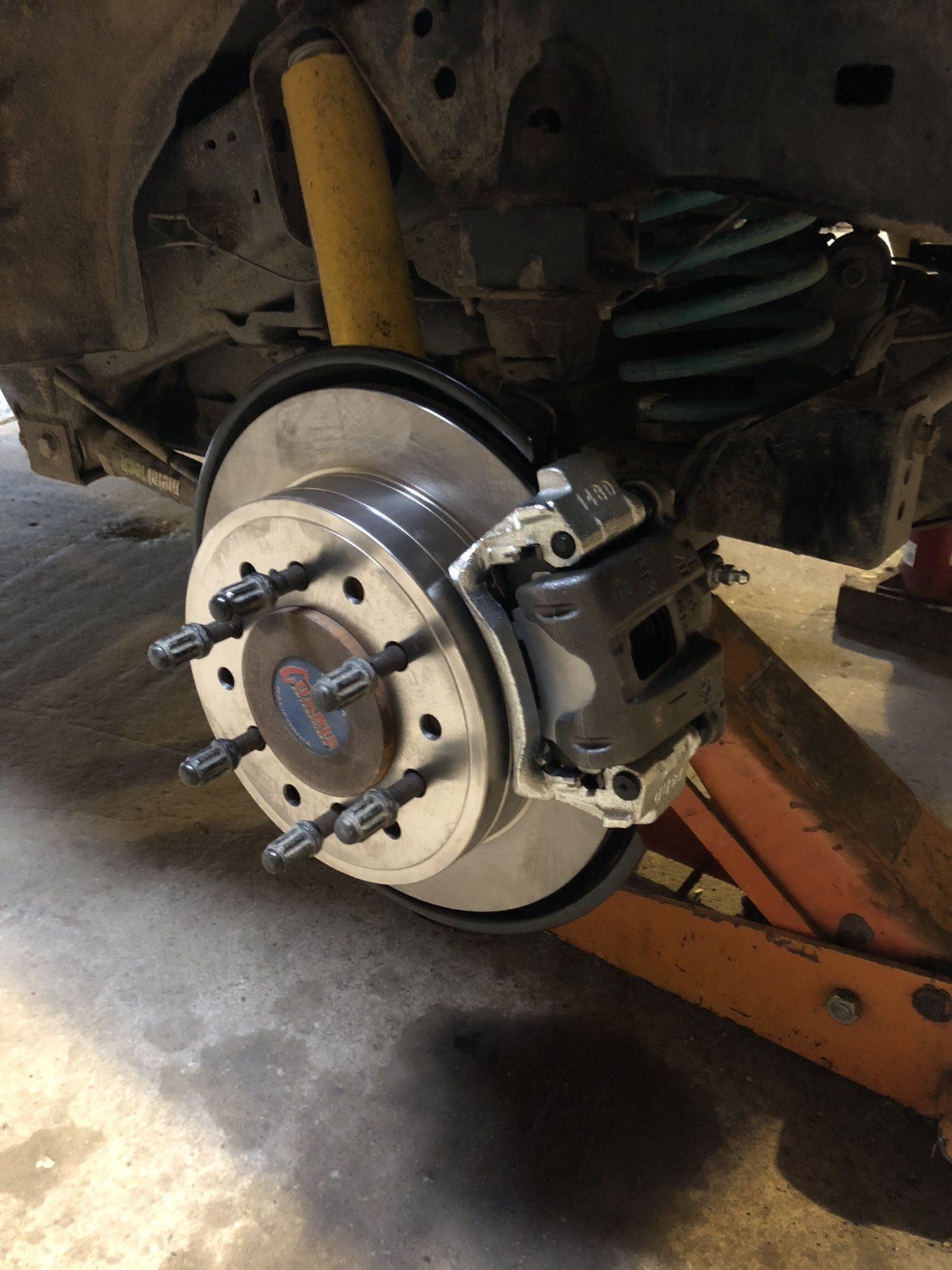

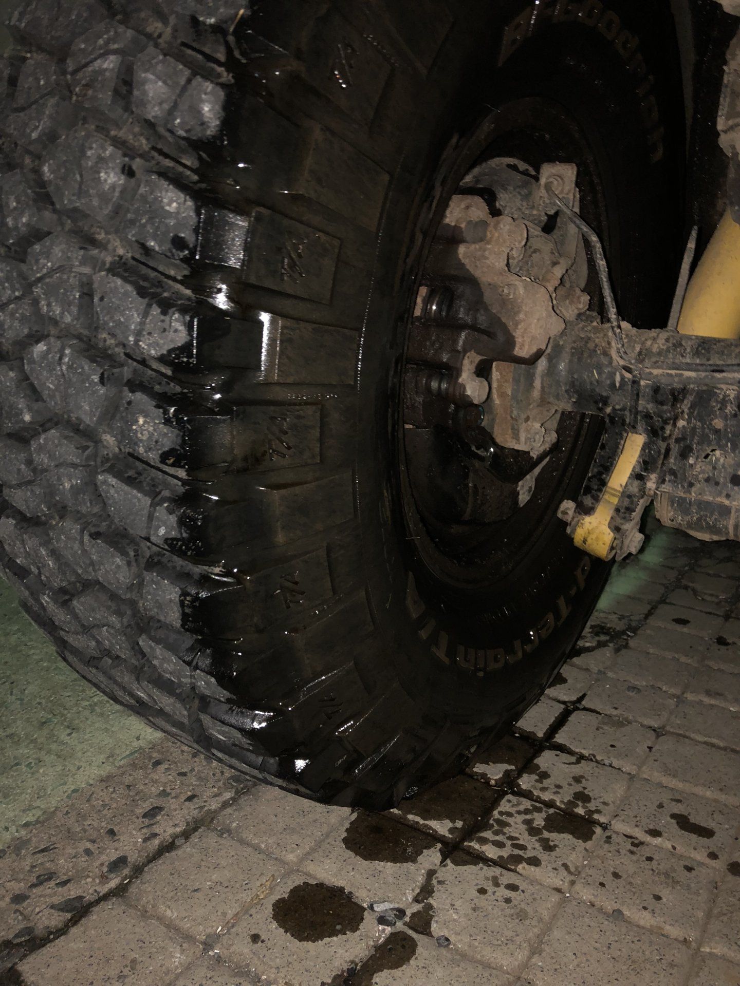

Truck is back on all fours. Installed the new pads and rotor on the right side. I'll get to the left side some other time. Added some gear oil, but the gallon jug I had on the self only had a quart in it. Checked the vent line, and found the cause of the seal leaks. The nipple was bent over 90*. Looked factory. But it was pinched off. Fortunately I have a set of spare axles, which confirmed it was bent, and supplied an unbent nipple. The cap on the hose was also plugged, but that cleaned up easily.
So tomorrow I will pick up another gallon of gear oil and top it off. Looks like a go for the club run on Sat.

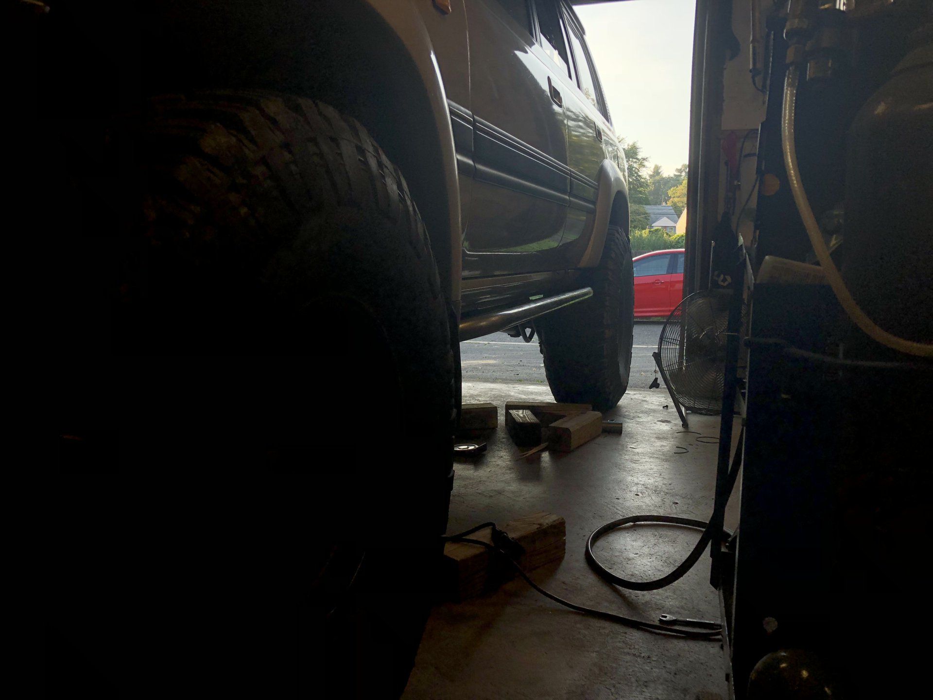

Back from my friend's wedding at Spring Lake in NJ ... nice place, but a bit like a retirement village. Anyway, here are pics of the slider issue with the cat and the shocks.
Just a poor angle on the cat makes it keep hitting the slider. I will try to push it up vertical one more time, but when it flexes it seems to break free and return to this state.
Drivers side
Pass side
