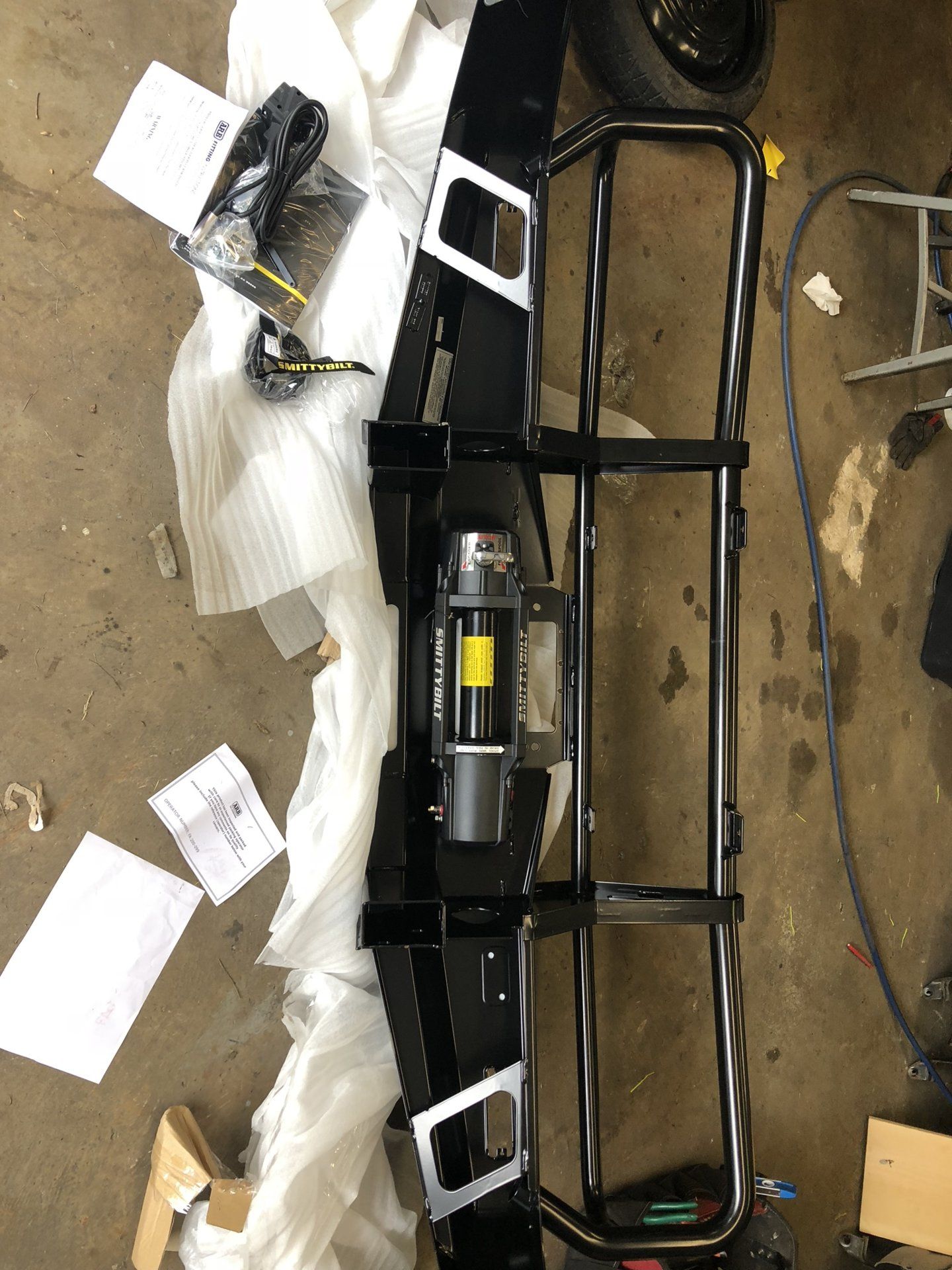

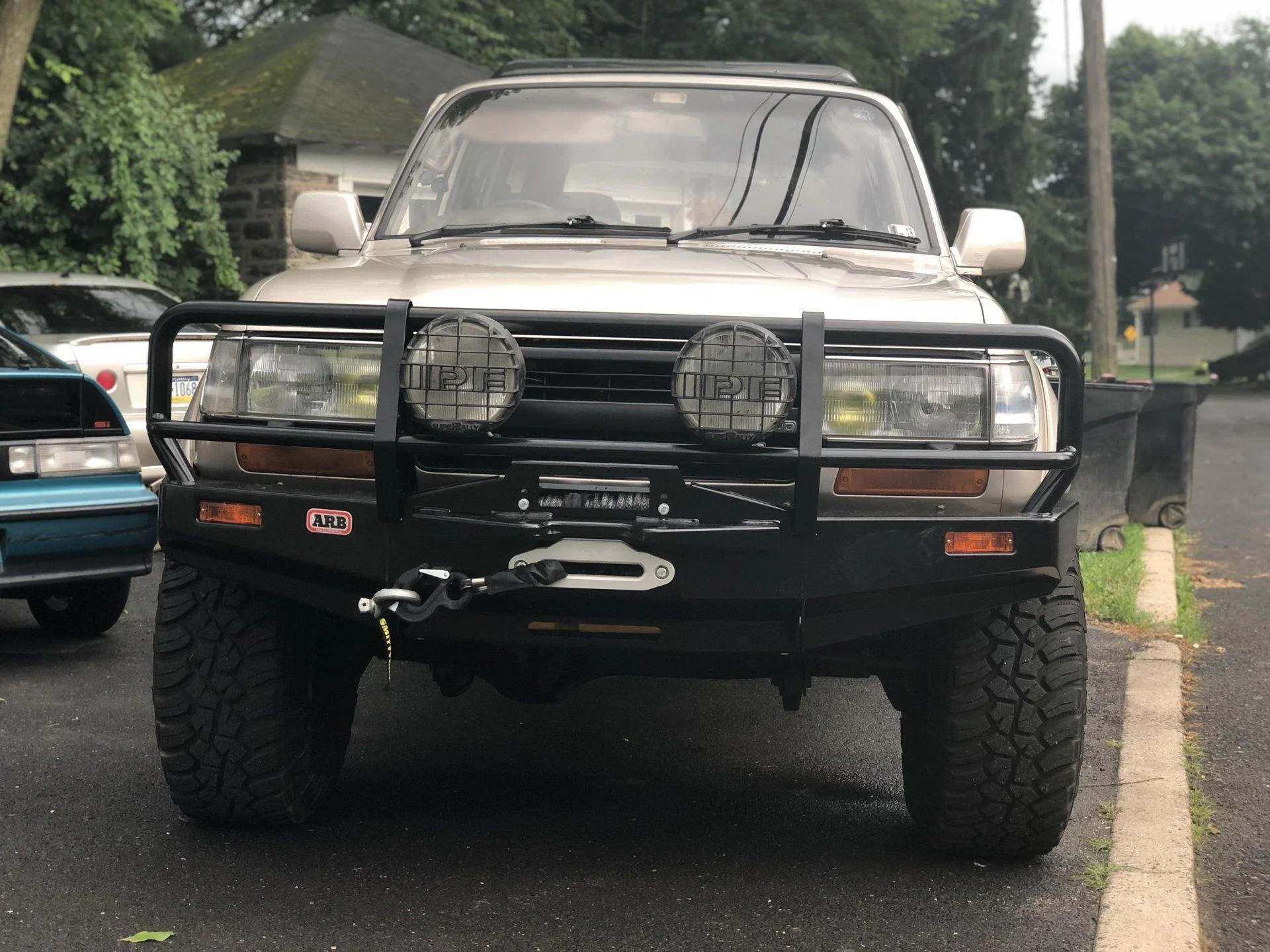

Finally got some protection.
Fabing up some sliders in the next few weeks.
fun fact the Smittybilt x20 series doesn't exactly fit the ARB bumpers. You need 1/2 inch spacers to allow for clearance.
