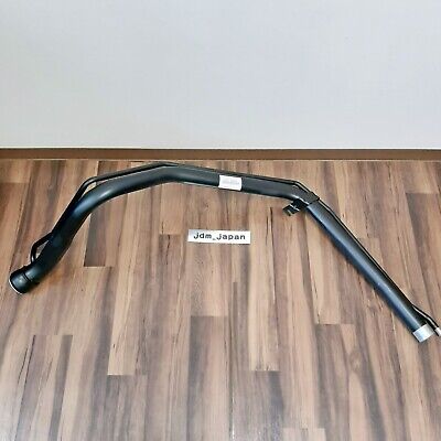

Bought from this fella in Japan (no affiliation).
I know that buying from sellers on Eghey can be sketchy, but this one came through for me.

Will this fit a 97? It says 93-94
Mine is a 95 and it seems to be the same as the OEM one. I believe the only difference is the lack of the little flapper inside that keeps you from being able to stick a full size diesel nozzle into the filler.
To clarify, this neck is indeed a diesel neck and does not have the unleaded fuel nozzle restrictor. This can be an issue in a gas truck where emissions testing is taken seriously. Obviously that doesn't happen everywhere but it is important to consider.
Note #2, the restrictor is not there to prevent diesel from being dispensed into a gas truck. It is there to prevent leaded gasoline from being dispensed into a gas truck.
