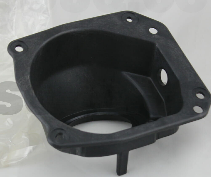

Is this the part you're referring to? 77290-

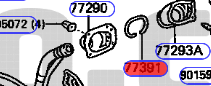

There is a PITA ring, 77391, that connects the inner and outer "sleeves", 77290 and 77293A
I remember having trouble with this when I replaced the rubber lines on my '95 fuel tank a couple of years ago. I don't remember exactly what I did, but I didn't have to go to any extremes to get it off, or I would have left it in place.

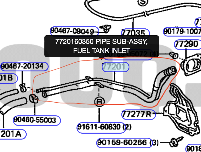

No, I have that off. I'm talking about the pipe that goes from there down to the gas tank.

That just takes elbow grease. Give it a good pull; it'll come off.
Hi OP, I just did a filler neck replacement on my truck this summer. You have to lift the body off the frame 5 or 6 inches to get it out. Seperating the body from the truck is actually very easy, on a rust free truck its maybe 30 minutes to 1 hour. Instructions for replacing the body mounts here: https://www.energysuspensionparts.com/installation_instructions/energy_suspension/8.4113.pdf
AKA also a good opportunity to replace body mounts.
Once the body is lifted off the frame it takes some wiggling since its a bit of a puzzle, but not hard. Maybe took me about 15 minutes of trying to to wiggle it out and wiggle in. I remeber start with a bend or the tip of the filler and just pushing up on the pipe into different corners to make room for other areas.
Thank you! Not what I was hoping to hear but glad the hard way still doesn't sound TOO hard! Thanks for the link!
It's been posted before, you have to lift the body or cut the tube.
2nd on lift the body, it's not that hard. After undoing the body to frame, I used the bottle jack the truck came with against a 4x4 under the body just forward of the rear bumper. I put the jack on a pile of solid concrete pavers.
If you cut the old one off with a grinder the body and frame will separate on their own...🙄
