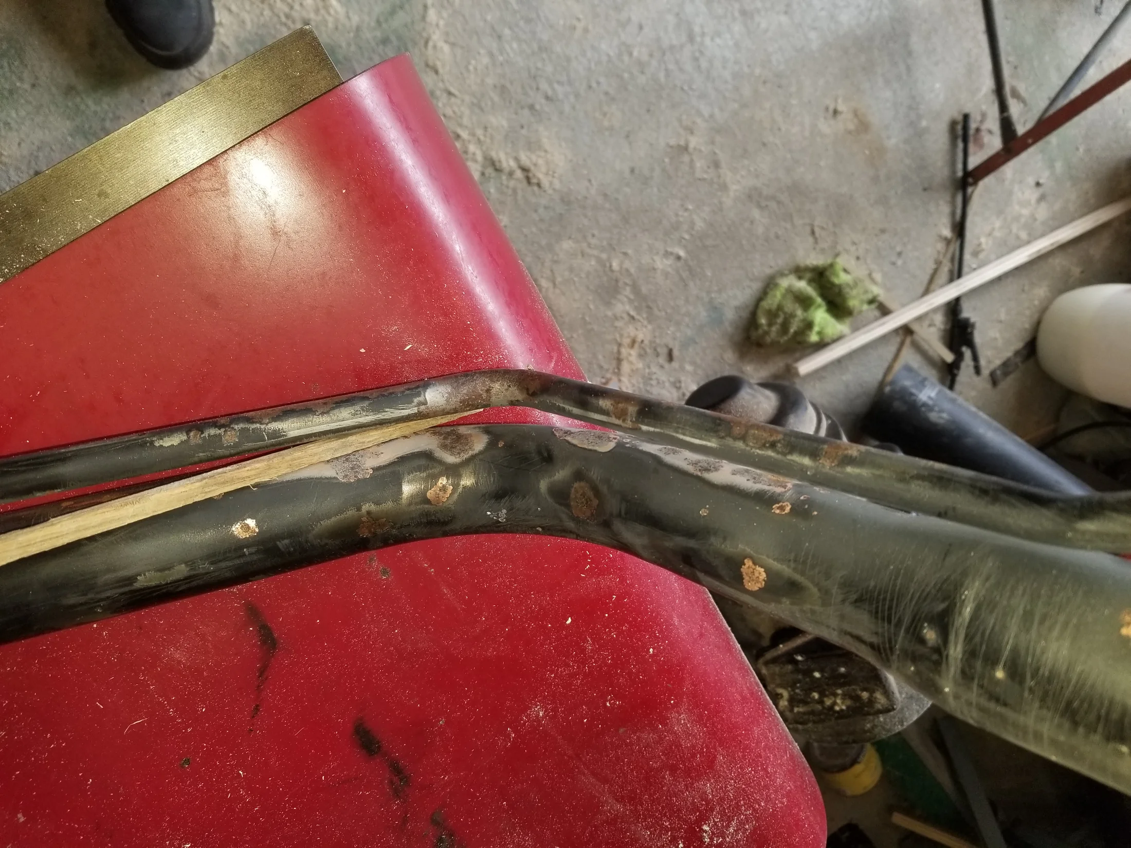

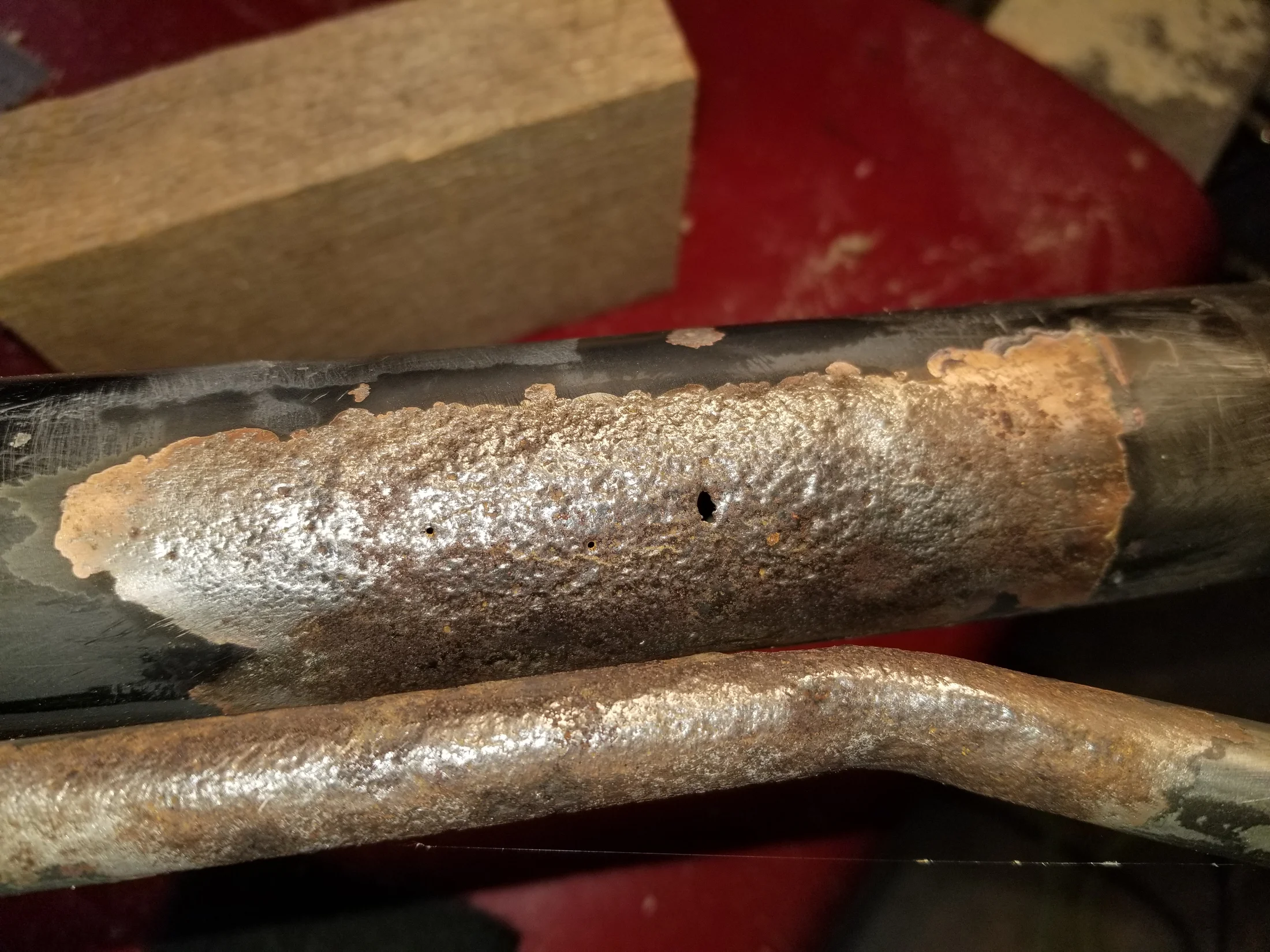

@Kernal
OK, so at this point it has been spot bead blasted (not a very good gun or media,), a little sanding here a little wire wheel there. I have applied phosphoric acid / treatment but need one more application.
Here are pics. Large area pic has a little flash / re rusting as I had to walk away for a few days.
I believe that an epoxy type rattle can primer and top coast should work for the lesser damaged areas.(advice please?)
I would prep the filler by de greasing with a solvent (xylene, acetone, denatured alcohol, Lacquer thinner,a)nd then 400grit.
For the large trouble area I am not sure what to use.
I was thinking about Fuel resistant JB weld or epoxy, possibly with glass mat infusion.
If I go that route should I prime the filler neck and then apply patch. Or apply patch then primer and top coat.
Do to the low pressure nature of the system I was also thinking that I could prime and paint the filler as it is then use 3M weather strip adhesive or fuel resistant gasket maker with possibly clamp and rubber sleeve.
Third thought is to solider the pin holes a solder and patch the larger hole as I can patch from the inside but I am not sure if solider will stick and flow well enough. v Also I do not know if the heat of soldering will further cause rusting in those areas.(?)
At the end of whatever process is decided I can, If there is positive consensus, Red Kote the inside of the fuel tank end of the filler easily.
Please let me know if I am reaching too far, am totally off base or if there is a product that I can simply apply and epoxy paint over.
Thanks
Jeremy
Buy a new one or a good used one.
We’re talking gas here not worth trying to fix that it’s a time bomb !!
Ditto: I would try to find a better used pipe or even a new pipe (diesel version is still available last I checked).
Is that the original pipe or a replacement from a salvage yard? Either way it's in rough shape.
But if you must get it back on the road as you mentioned there are a few ways to try to fix the worst area, depends on your skills (welding/solder/braze). You could then sand, clean with acetone well, then slather with a fuel tolerant two part epoxy followed by primer and paint. I would call JB Weld to ask which of the their products is best for that location ie: Tank Weld, Steel Stick, etc
OR, after sealing the holes coat the exterior of the pipe with KBS Rust Seal or their Tank Sealer (call the company to ask which is better to apply to the exterior of the pipe).
Any of those fixes might buy you a few years.
Thank you for your concerns about safety.
At the top of the pipe there are no holes or unreasonable pitting that concerns me about eminent failure. I will spray it with 2 stage epoxy primer/sealer if need be. That will stop the rust especially after this round of phosphoric. I just didn't want to get the guns out, set up the dehumidifier rig and go buy a cup of sealer. If the vent pipe is not repairable I will replace it with fuel line.
As far as the bad area is concerned, i believe that it is the result of the brazing from the factory. I'm not sure why this happens but it just does cause a weak spot that is attacked. If the bad area was "free floating" I would worry that the pipe was compromised. This location is right outside of the fuel hose to the tank. What are your opinions on simply cutting the pipe past the trouble and placing a longer coupler to the tank. There is very low mechanical stress at this location so a longer "coupling" hose should be fine.
Please note that I am going to inspect the interior of the filler with my bore scope.
Please note that If a better filler that is affordable is found it will be used.
Where would I look for one?
This repair is being done at lowest safe cost.
This vehicle is not being restored.
I will be under the vehicle often to tidy things up and repair other things. (or just check repair.)
There is active searching going on for this vehicles replacement.
There are a few people who've cut the filler pipe (to remove the rusted area) then used a section of thick fuel resistant rubber hose to fit between the two sections along with some good clamps. FWIW Fuel Tank Filler Neck Hoses - Free Shipping on Orders Over $109 at Summit Racing - https://www.summitracing.com/search/part-type/fuel-tank-filler-neck-hoses
Or, FWIW, after primer/paint clamp a section of hose/pipe sliced lengthwise around the OD of the rusted pipe, add a couple of clamps and a fuel resistant sealant??
I was considering this but with a full sleeve. To think about it further I could simply run the coupling hose to the tank all the way past the bad area.(new longer hose) I would maintain the original clamp location and add a clamp up high. (3 clamps)
