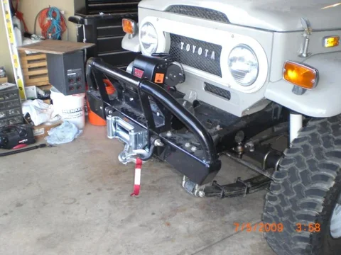

Here is a Man A Free bumper which I just installed a warn 8274-50....four bolts to the back of the plate on the bumper and feed your cables under the bib to your battery.
That looks awesome. Thanks for the pic!
Here is a picture of the bumper Jim has installed courtesy of another MUD member....
The 8274 is quite heavy. If you are installing it by yourself, you might want to use a lift to help you. I used my floor jack positioned directly under the bumper and raised the winch into position. I believe I had a small piece of plywood under the winch on the cradle to help level the load on the lift. Good luck.
