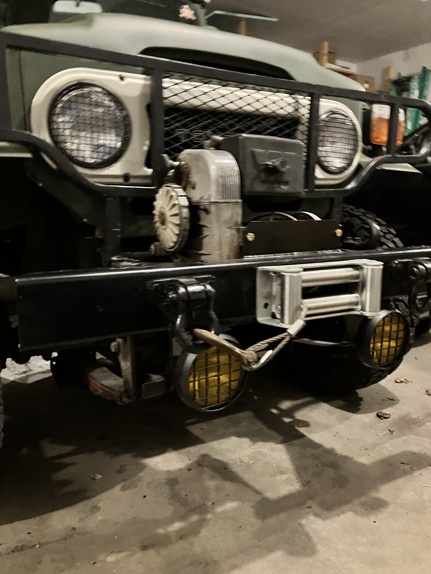

Normal Hawse fairleads as the one pictured are perfectly fine for synthetic line. Not sure where you got your info but I have been running a regular steel hawse fairlead for years with synthetic line. No issues whatsoever.

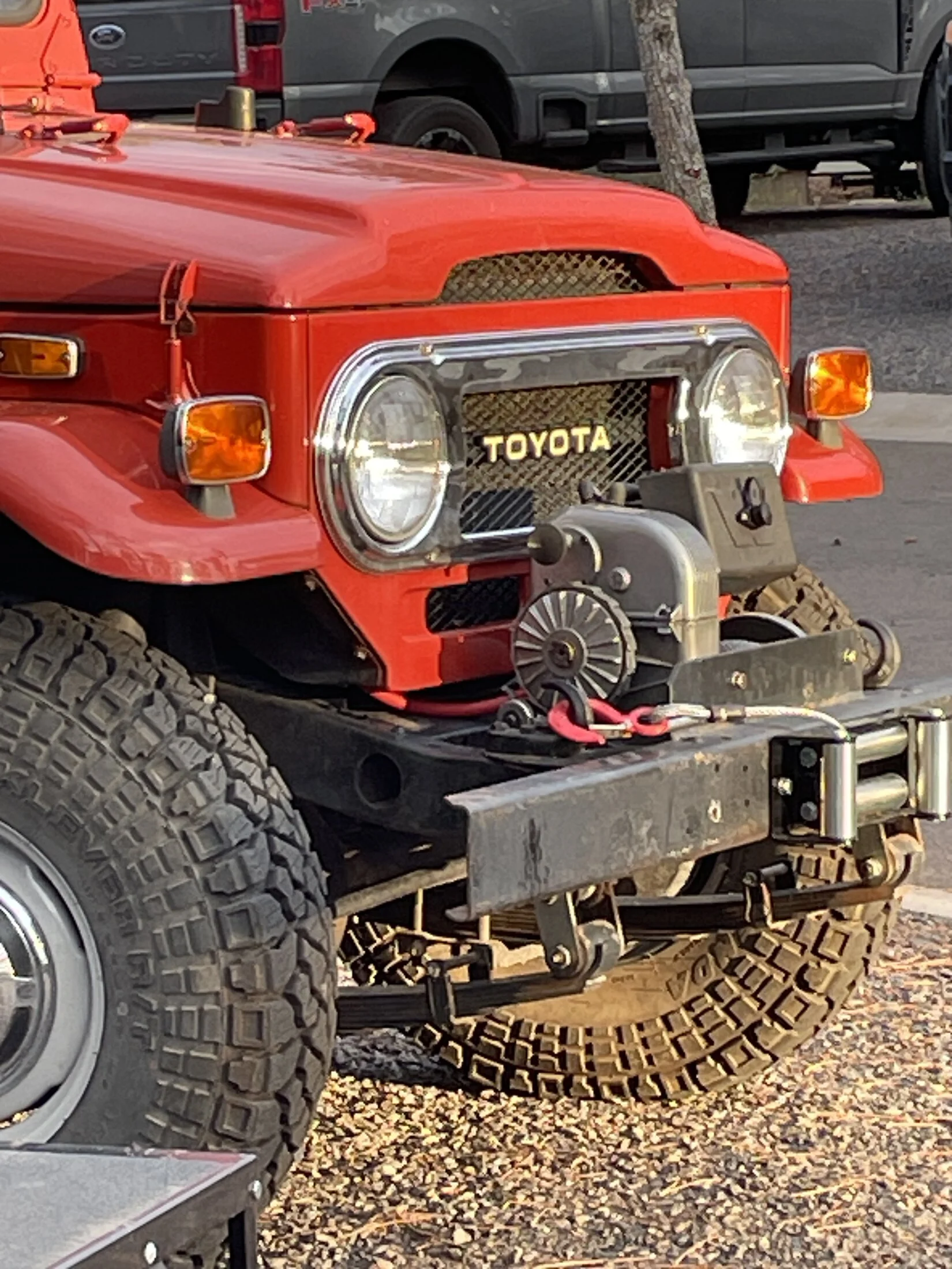

FWIW, I installed my rebuilt 8274 with ROLLER FAIRLEADS and 150' of 5/16" wire cable. Weight no problem with the med duty OME springs and primarily "wheel" in sandy, rocky environs out West here. Chose cable for the environment. Considered synthetic due to ease of use and safety... But went old skool.

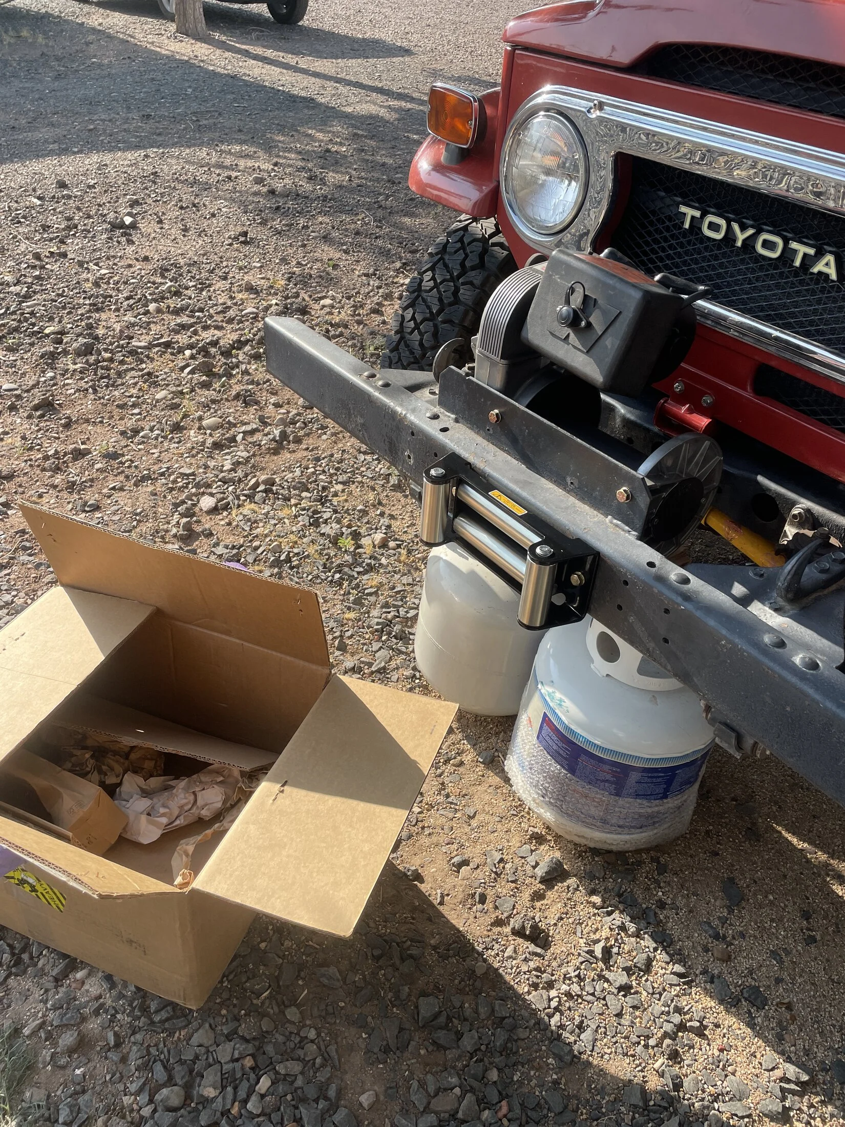

I put a piece of wood across 2 propane tanks and set the winch on there NO LINE. I DO have a 2.5" lift. I ordered custom cables from BatteryCablesUSA, methinks. I'm a rough 58 -yrs-old with lots of city miles on the chassis. It wasn't too bad lifting it in place without the line. CAbles are super nice, choose your guage/length/ends/coating/etc. Winch was rebuilt and working when I rec'd it.
If you have a couple of ladders and a 4x4 you can create a small gantry to lift it into position. Even a 2x4 would probably work, without a steel cable the winch isn't that heavy especially if you take the motor off first. But if you can find a friend to hold it in place for 5 minutes that's a lot easier.
Thanks for your suggestion! I bought a second 6' step ladder from Temu cheap. I sistered two 2x4's together for a cross beam and hung my manual chain hoist. It was much easier than building two 6' tall sawhorses as my brother-in-law the engineer suggested. It worked out very well and the 8274 is on my truck now and looking bad ass. I am going to just clean up the old congealed grease here and there and try to preserve the patina. I need to take the slack off of the
