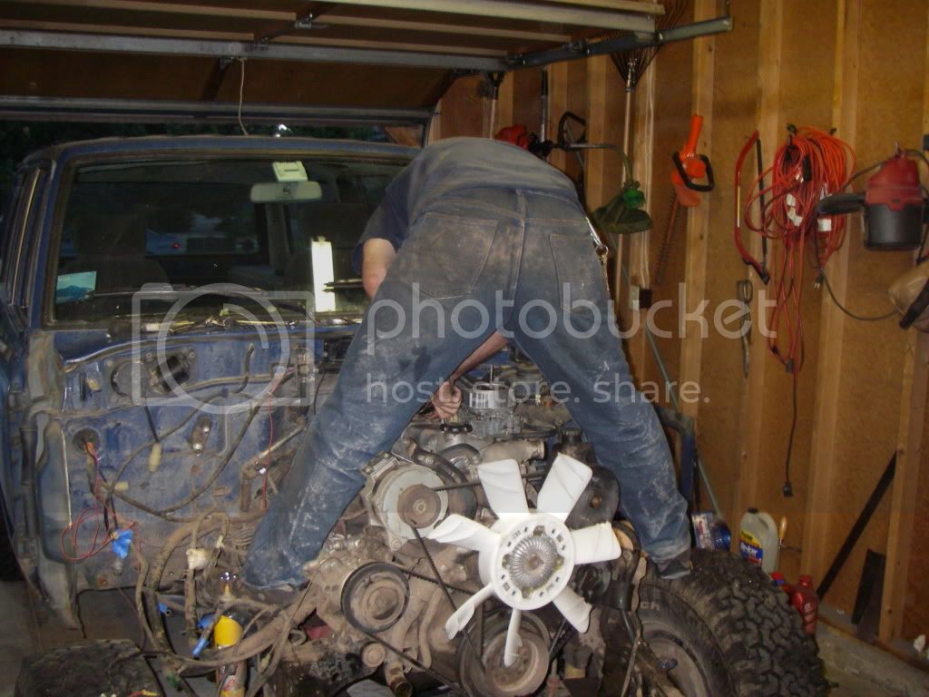

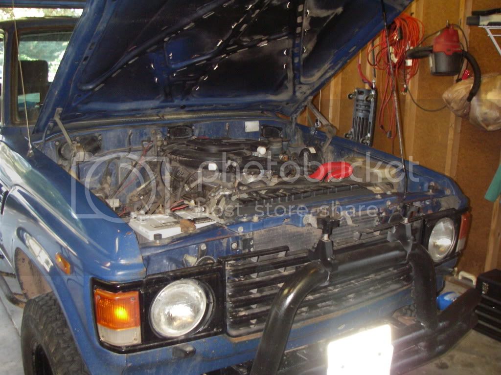

Alright, got the three projects I had going on friends' cars done and cleared out of my garage and got the She-Beast into the garage yesterday and started teardown :cool:
Last time it will be all together with the I-6

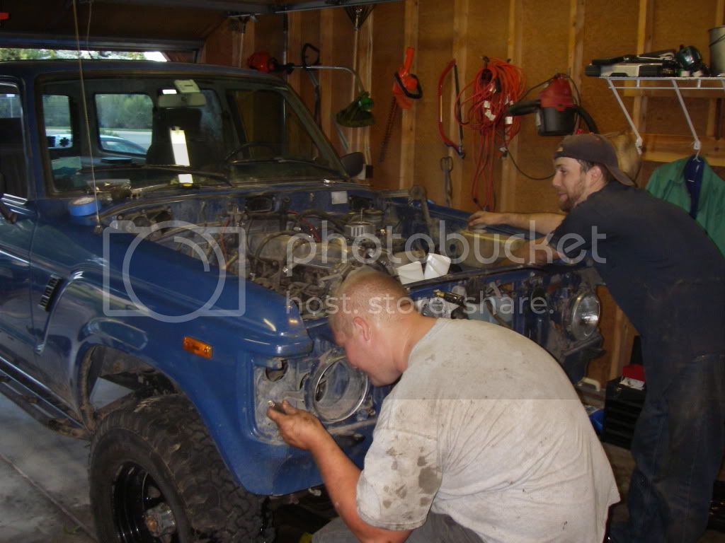

Hood, grill and inner fenders starting to come off, starting to work on the core support (probably would have been easier to do the outer fenders before the core support but this worked too).
Had to pull my sliders to get the outer fenders off, fortunately they are bolt-on. We're being really careful through all of this to keep hadware and wires organized. The best way I've found for this is 1. Zip-loc baggies for all hardware and 2. Blue painters' tape for wires. ALWAYS label the bags and wires with a sharpie. On a project like this, some of the wires will get re-used, others won't and some will be spliced into new harnesses so actually labeling them with a name and not just a number is key!
Fenders and core support off. Not really sure what my friend was doing but I'll leave it up for interpretation... ;) Notice my brand-new radiator fan...

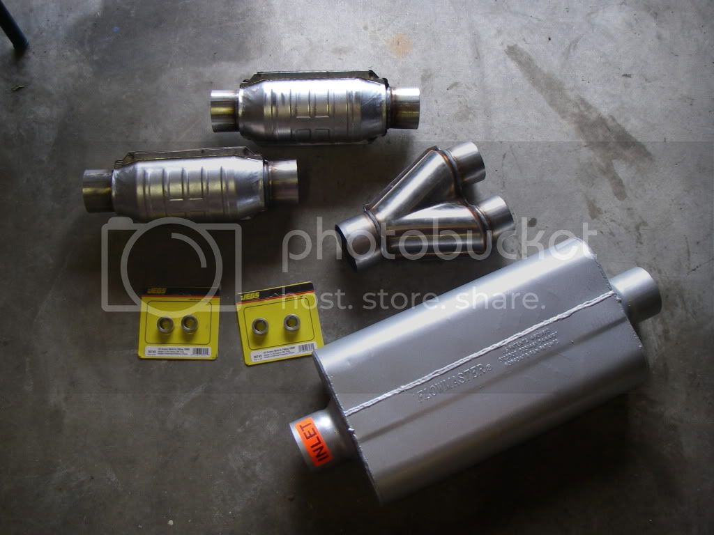

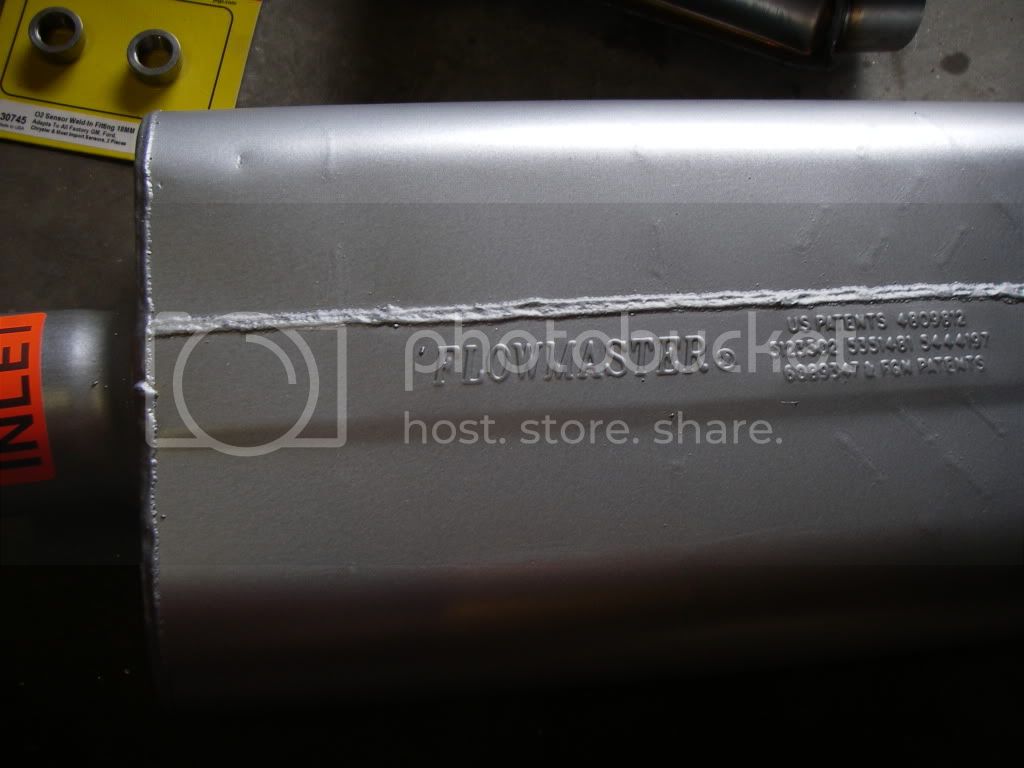

Exhaust stuff: 2.5" Magnaflow catalytic converters, 2.5"-3" Y-pipe, O2 sensor ports, 3" in/out Flowmaster 50-series muffler.
Close up on muffler. Note the bright orange sticker denoting which end is the inlet. The Flowmaster design does not work properly in reverse and can cause some serious flow restrictions.
O2 ports. Pretty universal domestic and import-brand ports. I need to buy my O2 sensors and make sure these will work but they are supposed to fit the sensors for this engine.
The inside of the cats. The honeycomb catalyst can be easily seen.

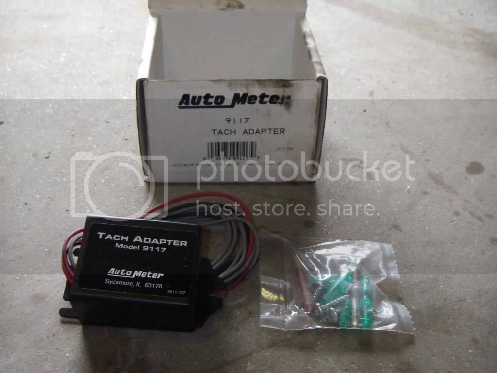

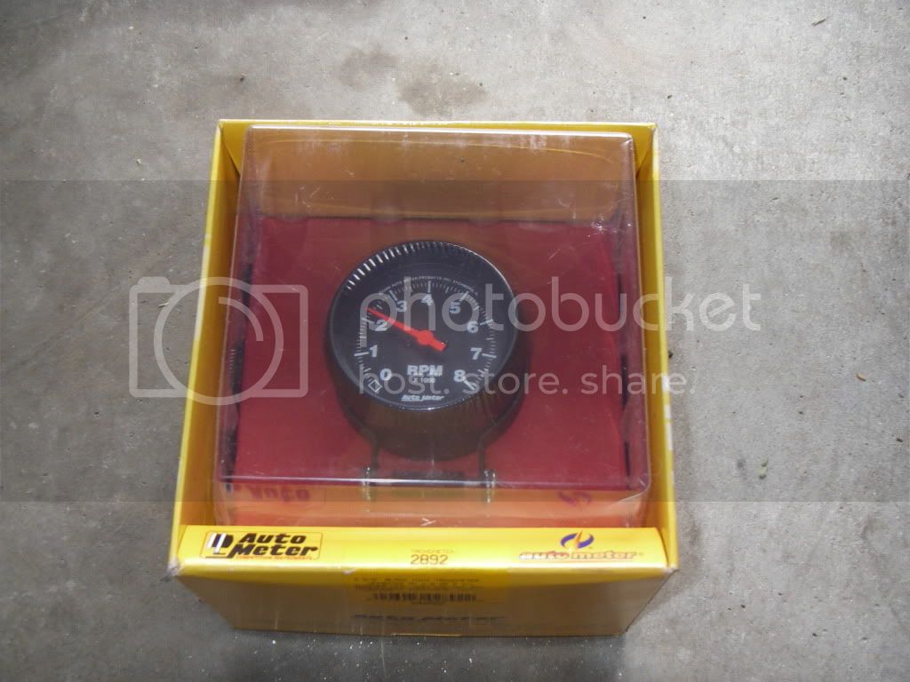

Tach. This is the same one phishincruisin used in his swap and I plan to set it up the same way by mounting it in the stock tach location in the dash.
I can follow wiring diagrams and make good connections but designing things is not my strong suit so I decided to pay the cash and buy the AutoMeter tach adapter. This is designed to splice into the Vortec wiring harness on the #1 coil and convert that signal to one that is usable by the tach. Supposedly makes the tach fully fluid at all RPMs and avoids any bouncing. For those interested, the instructions can be found on HERE or on Autometer's website.

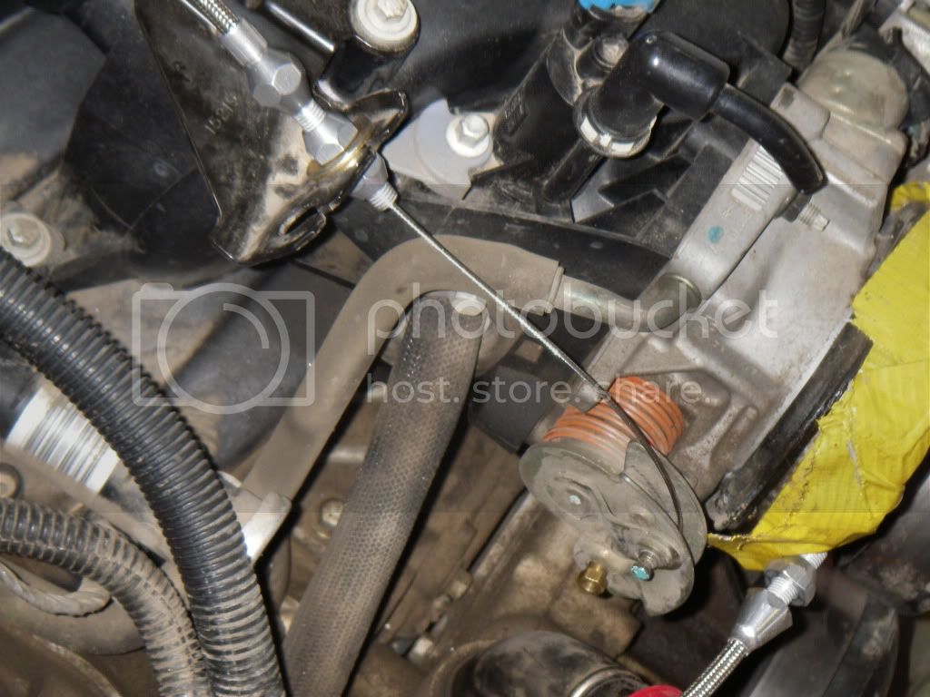

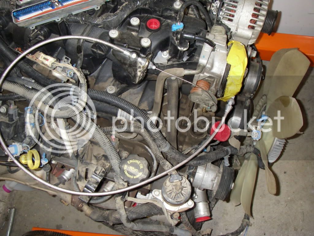

I also got the Lokar Throttle Cable attached to the engine. I had to add a couple washers on either side of the throttle cable mount to keep it from pulling through the mount but the installation of this is super-simple. I'll have to come back once the engine is in the bay and adjust the cable length as needed. The first picture just gives you an idea of the overall length of the cable, the second is a close-up of the mount and the attachment to the throttle body.

A hint with the tach.. you will pretty much destroy the Autometer housing to get to the inners. I tried to take it apart without damaging it much and it was a waste of time. But, it isn't too hard to make it fit perfectly. The hardest part is positioning the gap between the face and the front of the stock housing so that the lighting is the same as the other gauges.
