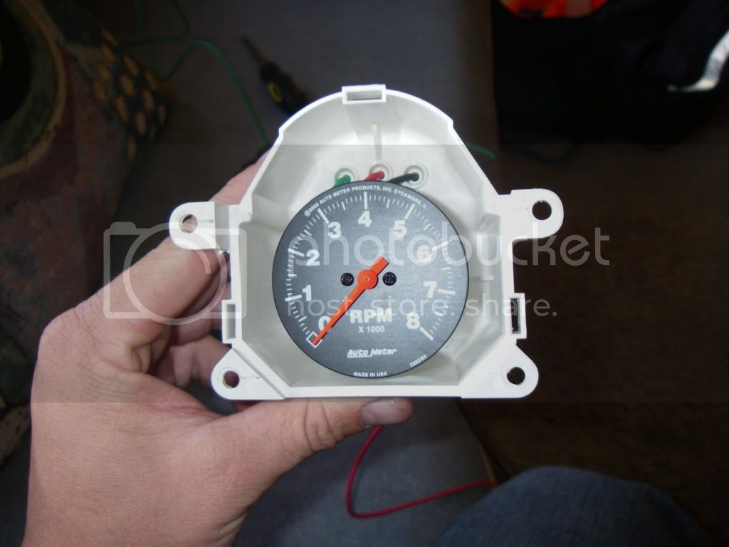

A hint with the tach.. you will pretty much destroy the Autometer housing to get to the inners. I tried to take it apart without damaging it much and it was a waste of time. But, it isn't too hard to make it fit perfectly. The hardest part is positioning the gap between the face and the front of the stock housing so that the lighting is the same as the other gauges.
Thanks for the tip on the gauge. I kinda figured it would boil down to completely demolishing it... pity it isn't a cheaper gauge... The tach in my tuck has always been dimmer at night then everything else so this seems like the perfect chance to remedy that.

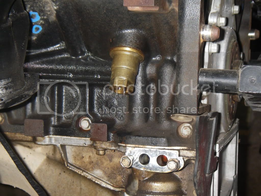

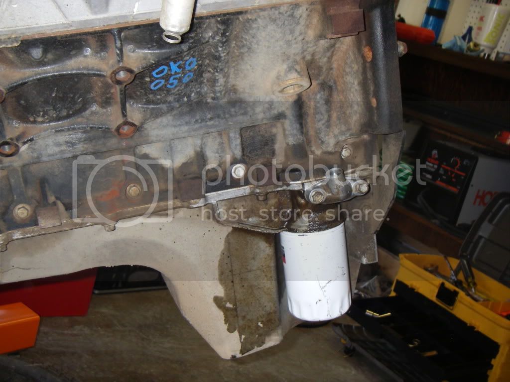

Also got the stock motor mounts off the V8. You can see in this picture the location where the Toyota oil pressure switch for the stock gauge will come to live. The oval fitting directly above the oil filter. See some pictures below for more details on the actual piece. Directly above that is the "frost plug" I need to remove to install the block heater I picked up at NAPA today. I need to come up with either a 17mm Allen wrench or a heavy-duty bolt and a couple nuts with a 17mm head to get it out though...
This is the piece that will be drilled and tapped for the oil pressure switch.
Some of the Vortec equipped trucks had a factory oil cooler that attached at this point to the oil system but on the rest, it's just this odd little cap that lends itself well to becoming an oil pressure port.

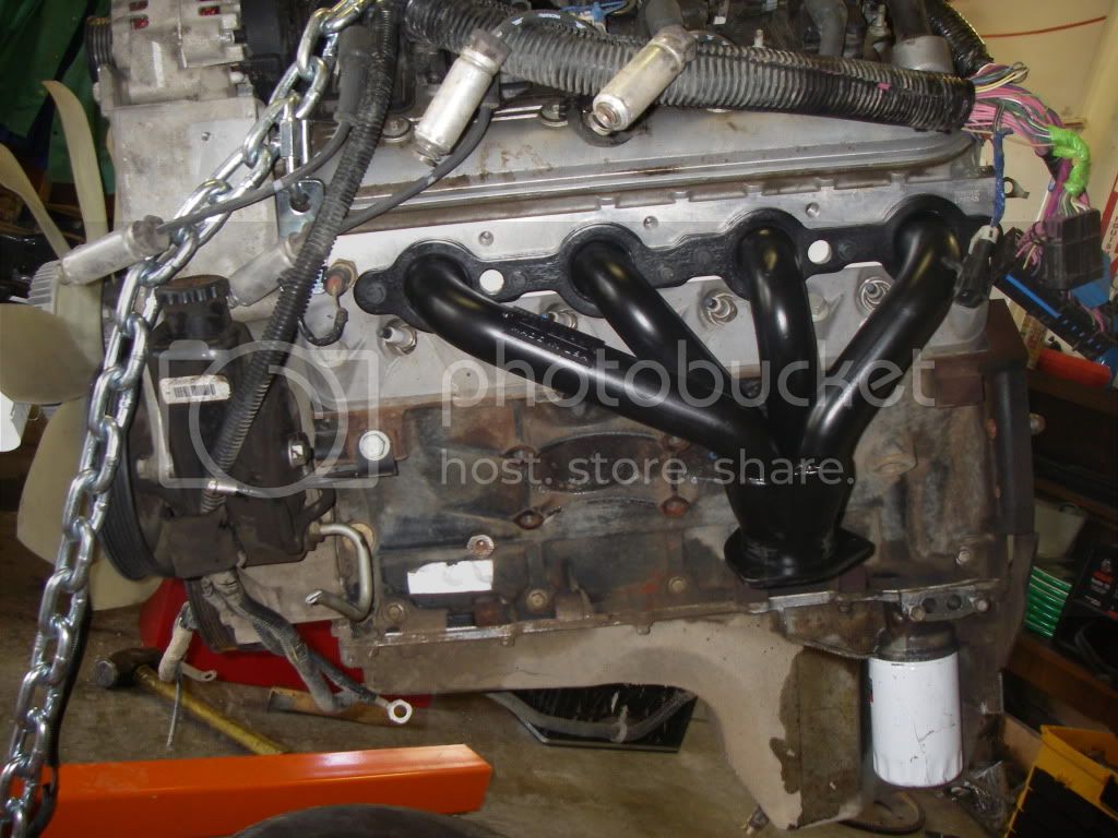

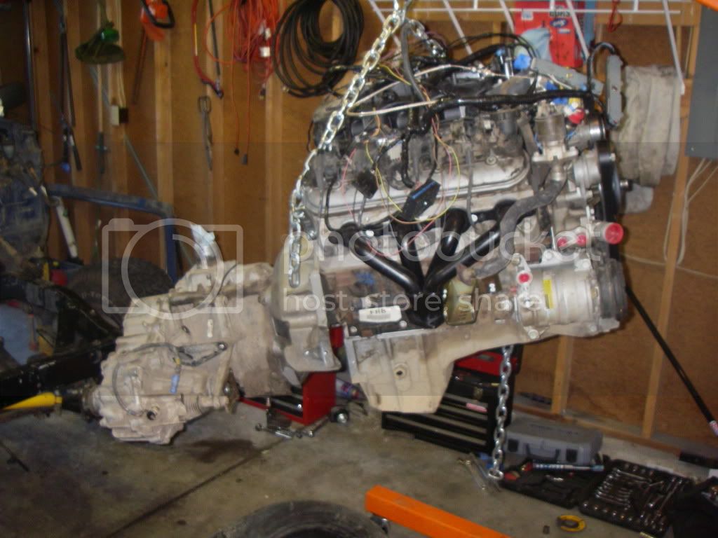

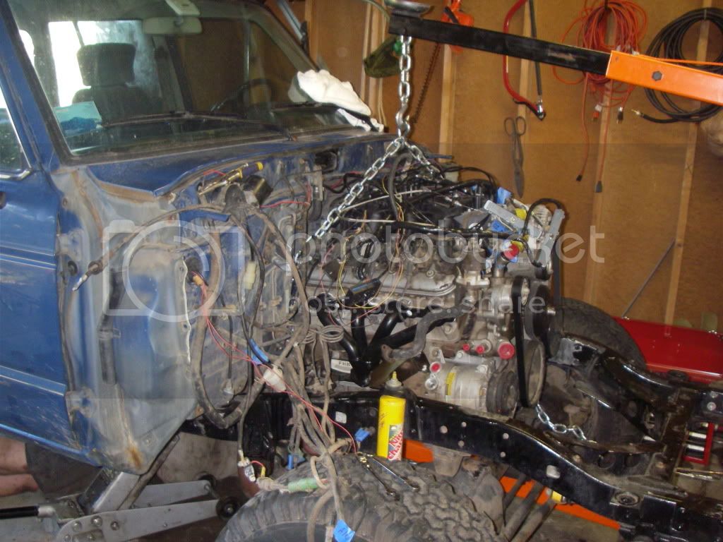

Test fit the headers. I do have some concerns with motor mount clearance on the right side of the engine around the header but I won't know for sure until Thursday when the motor mounts are delivered. I could always fab up my own if needed but I was hoping to save myself a little extra work in that department.
You can see the clearance concern in this picture.
Plenty of room between the header and the block though.

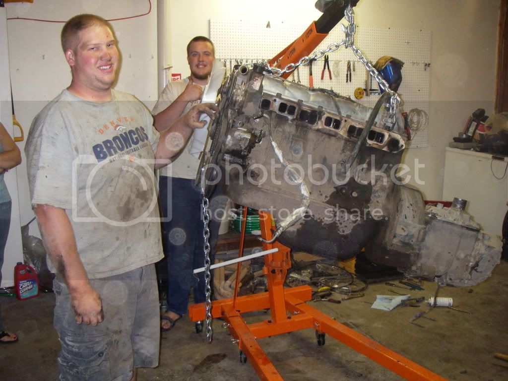

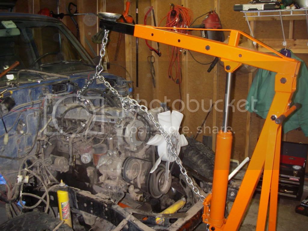

Got the driveshafts out and disconnected the shifters, all the remaining fluid lines, electrical connectors etc.

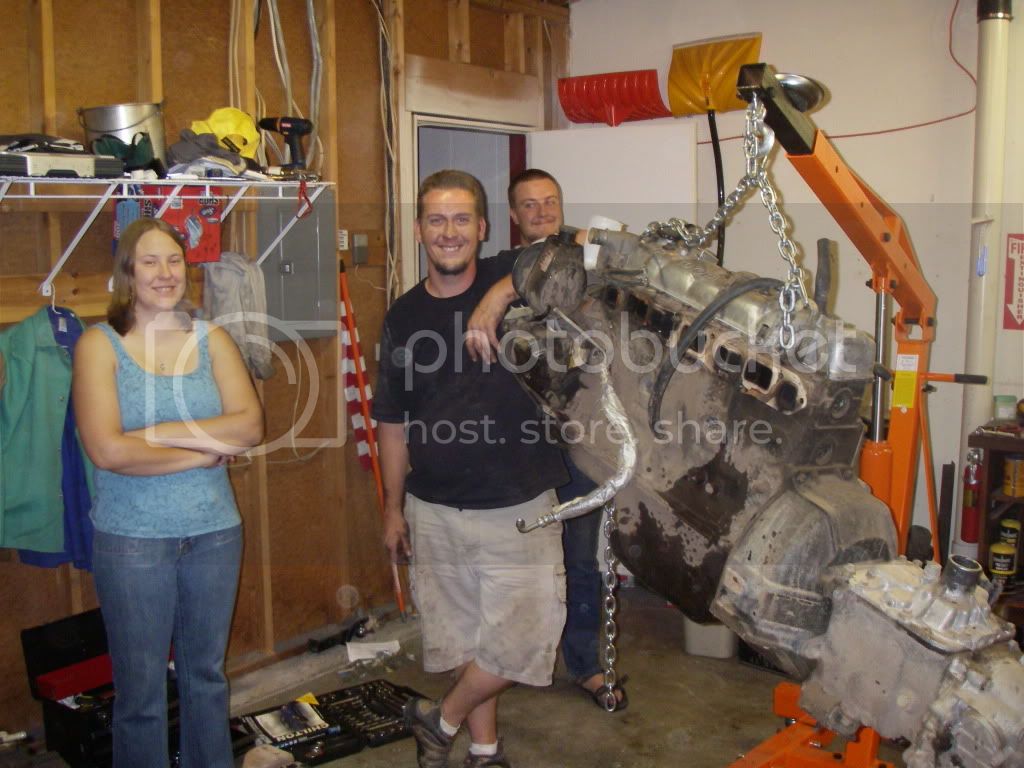

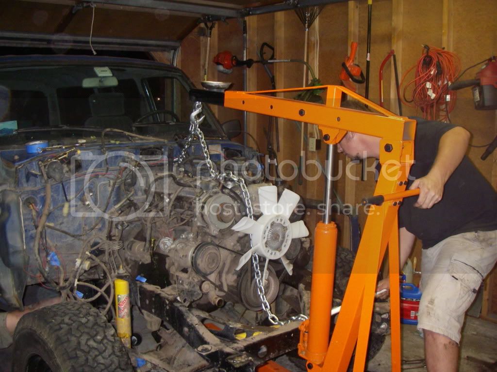

By late this evening it was time to drop the v8 back onto it's tire and move the cherry picker over to the truck.
Some finesse, brute force and swearing at missed electrical connectors...
Bingo! No more 2F! (Notice how my brother in law manages to be "that guy" in every picture...)
Now there is a very dirty gaping hole in my truck just begging for the new power :cool:

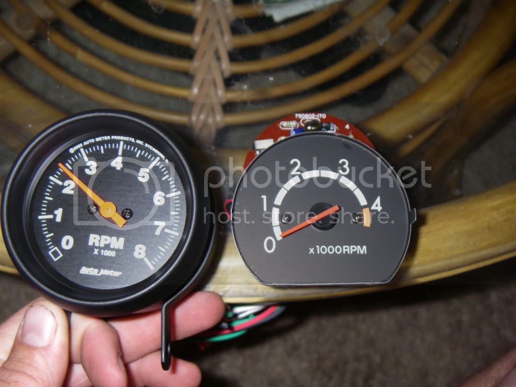

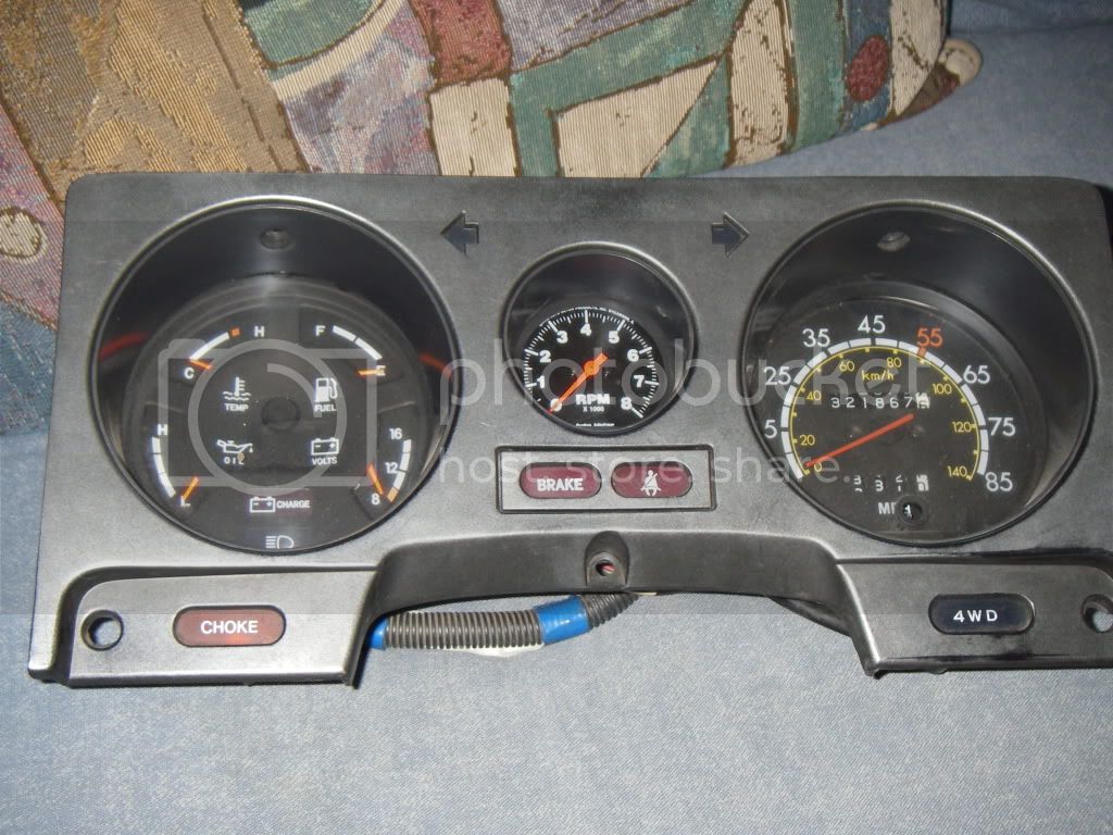

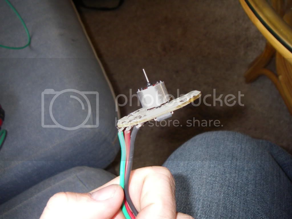

Took care of the tach while I was confined to the house late last week.
Got the old tach and cup removed and removed the tach from the cup. Here is a side-by-side comparison with the new tach.
After disassembling the new tach pod and some careful cutting of the pod bezel with a Dremel, I got the new tach out and stripped down so I could reassemble it in the stock pod. The bezel you can see above is pressed on very tightly and I didn't want to potentially break anything critical by prying so four even cuts around it with the dremel made it all come apart rather nicely.
This is how far down I had to strip it.
Put in some longer screws.
The screws to mount the new tach are about 1/4" wider than the stock holes so you do have to open up the stock holes a bit to make it work.
Mounted in the stock cup using some 1/2" nylon spacers and a couple washers.
From the back.
And mounted back in the gauge cluster.

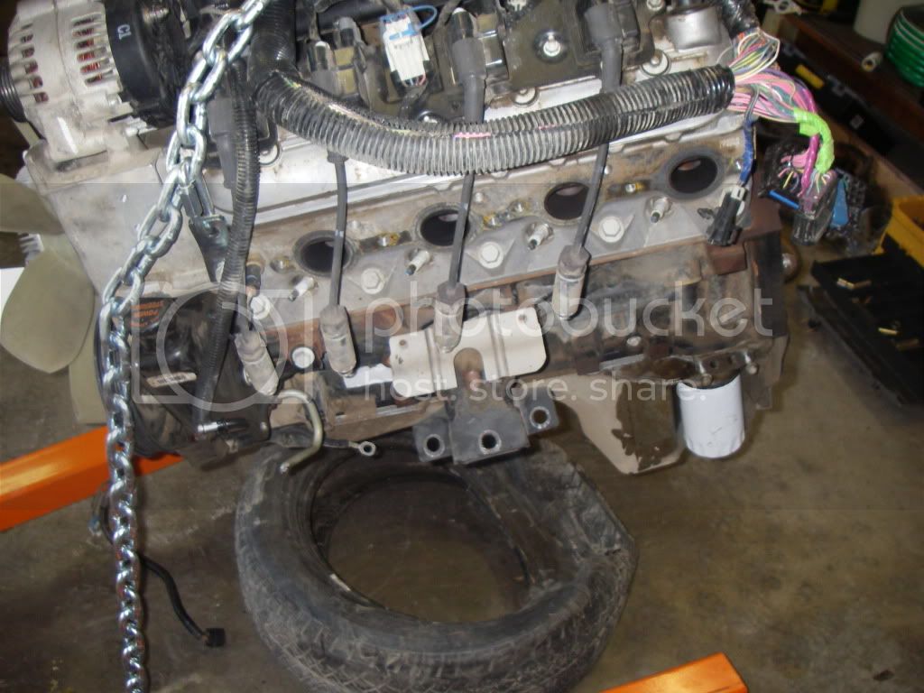

Got the V8 up on a friend's engine stand to do some more work.

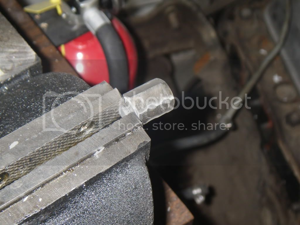

Took a bolt and two nuts and welded them together to make a 17mm allen wrench to get the frost plug out for the block heater.
Block heater installed.
My friend taking care of the old motor mounts.
Put the new motor mounts on the engine, bought a serpentine belt and got the mechanical fan removed.
Then the caster on the engine stand failed...
Frantically got it back on the engine crane before any more of the stand collapsed and there was no catastrophic damage to the engine.

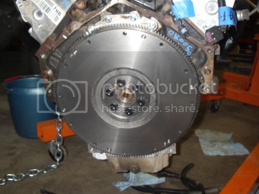

The flywheel I ordered from AA doesn't fit. The bolt pattern on the crank is slightly different. I missed where I was supposed to get a stock LS1 flywheel to work with this engine. :doh:
Oh well, got an aftermarket stock flywheel on order from Jegs and will be returning the one from AA. The one from Jegs is about half the price too. :)

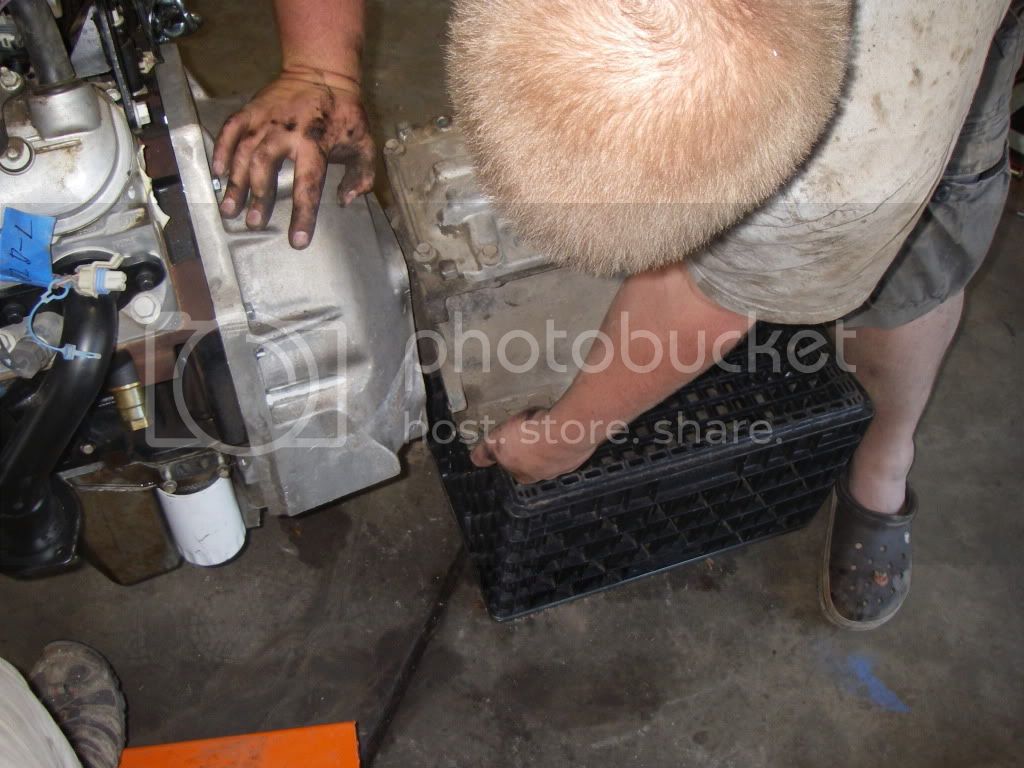

Mating up the transmission/t-case. This is when having big firefighter friends is useful :cool:

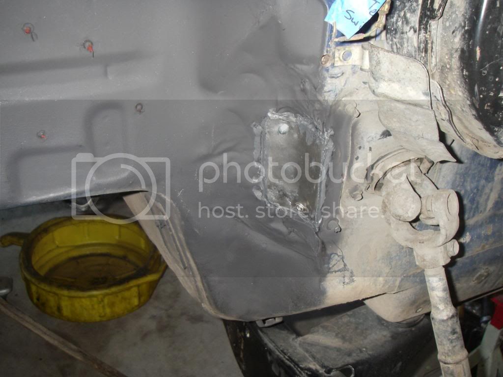

The other thing big firefighter friends are good for is bashing on things with a hammer... like the firewall...right up until your gas pedal ends up at a 45 degree angle because he went a little too crazy with the hammer...
That's going to be fun to fix. On the plus side, I have a lot of clearance for the v8 on that side now :bang:
Did the first few test fits and made some measurements for the transmission crossmember. The engine will be slightly further forward than what is pictured below but I wanted to get at least one shot of the Vortec in the engine bay :bounce:
Got the engine and trans back out and did a little more work on the crossmember.

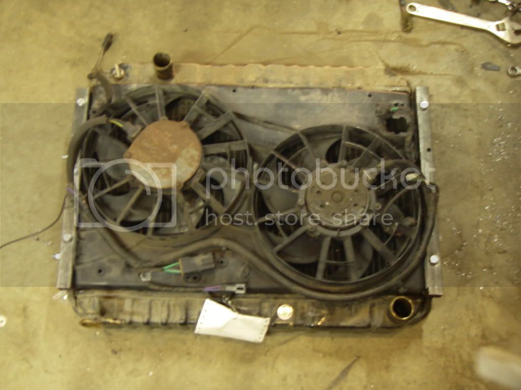

Also picked up a Contour fan from Loveland Auto Salvage for fairly cheap. Even has the Bosch motors :D. Got that mounted up using some 1" square tubing in a method borrowed from Spook50.
As I said earlier, I'm going to run it off the PCM controls so I need to get my PCM back with the pin locations before I deal with the wiring.

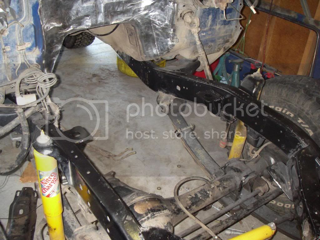

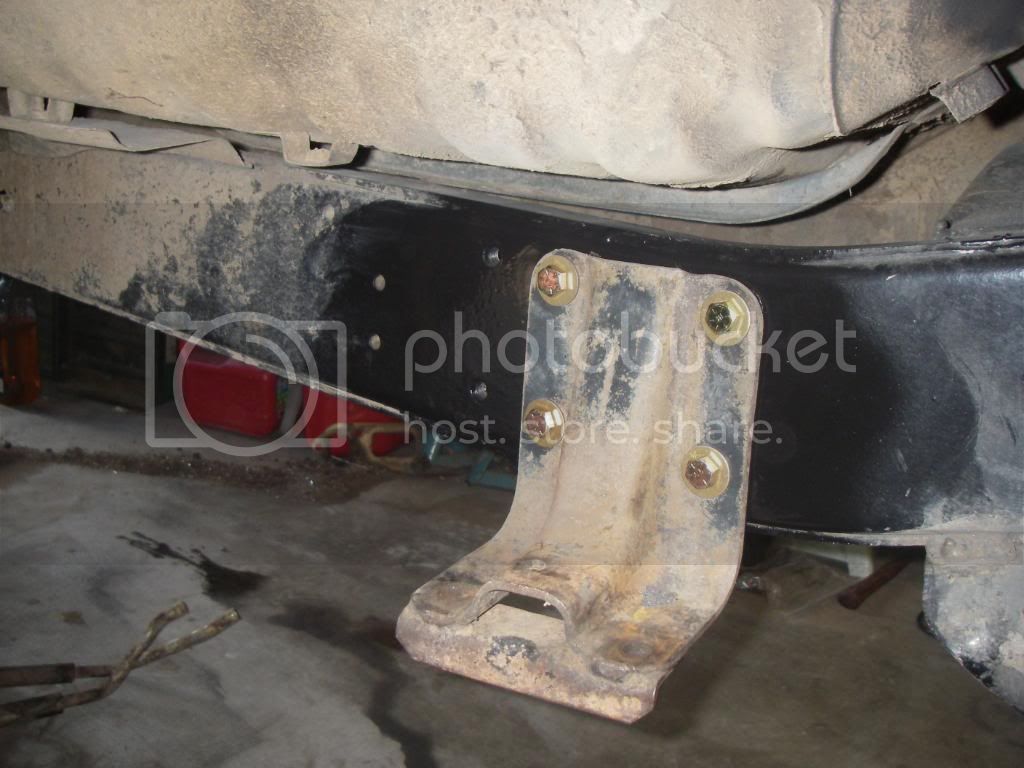

Decided to re-use the factory transmission crossmember. Moved the holes forward 2" on the frame rails, drilled new holes and welded in some 3/16" walled 3/4" tubing to sleeve the frame and prevent crushing. Used some 3" long grade-8 bolts to attach the "horns" to the sleeved frame rails. You can see one pair of the factory holes in the first pictures. Factory used captured nuts in the rails on this style crossmember.
Disconnected the transmission from the vortec so I could assemble the clutch now that I have the correct parts. While the bellhousing was out, I transferred the ball joint for the clutch release fork. The two studs had previously been transferred to align everything correctly.
The LS1 flywheel from JEGS bolted in great with the ARP hardware.

Did some final test-fitting with the assembled drivetrain and the repositioned transmission mount.
Marked the location for the motor mounts and pulled the drivetrain one last time and welded in the motor mounts. I've just been using a gloss rust-olium heavy-duty enamel paint on all of the frame work. It blends in very well with the paint my body shop used over the galvanizing.
