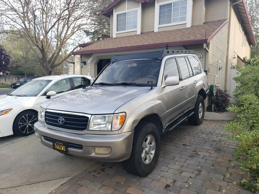

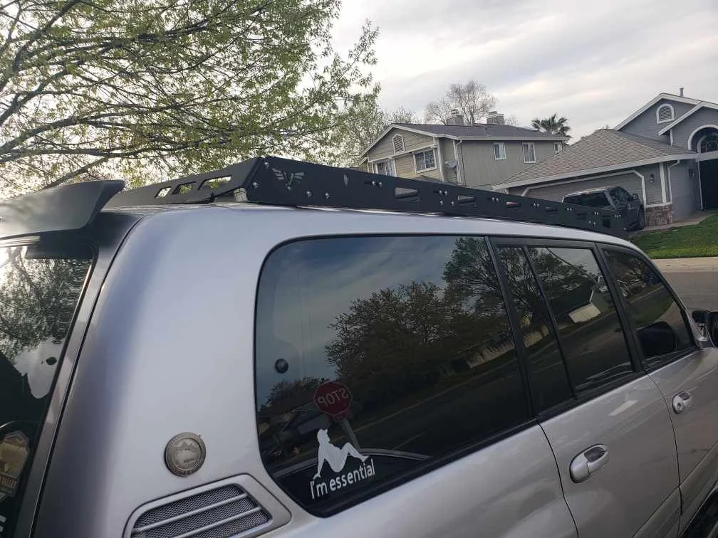

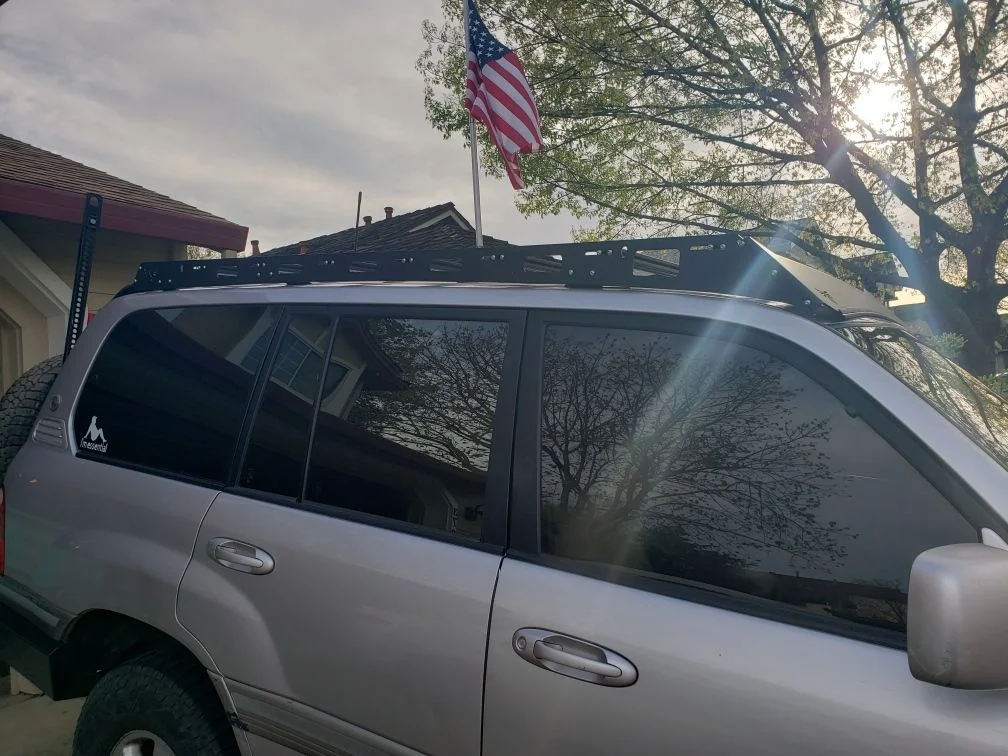

Finally got around to installing my new Victory 4x4 roof rack this last weekend. Overall, very happy with it. The install is relatively simple and the fit/finish is fantastic.
Mounting looks identical to the Prinsu, L shaped bracket that picks up the stock rack holes.
Unless I've hit my head recently (which i may have), the prinsu has the spacers and uses longer bolts and puts more moment on the nutserts.
This one mounts flat on the holes, less moment.

Does the trim on the front wind fairing touch the paint? If so could you adjust it up to keep it off of the paint?
Thanks,
GB
