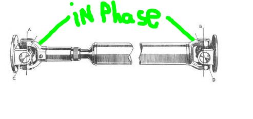

I had this happen to a local customer(letting off the gas resulted in a loud rumble).. Turns out the the driveshaft slipped apart and was pushed back together out of phase.
Now even if you get them back in phase there is still the possibilty of the balance being 180 degrees out. In that case, re-spline it another 180 degrees. The clue is do the zerks all line up along the driveshaft.

  • phasing.pdf
Thank everyone especially @gearinstalls.com for the pdf info and diagrams. This may be the problem. A friend told me he had the same problem and it was the driveshaft.
