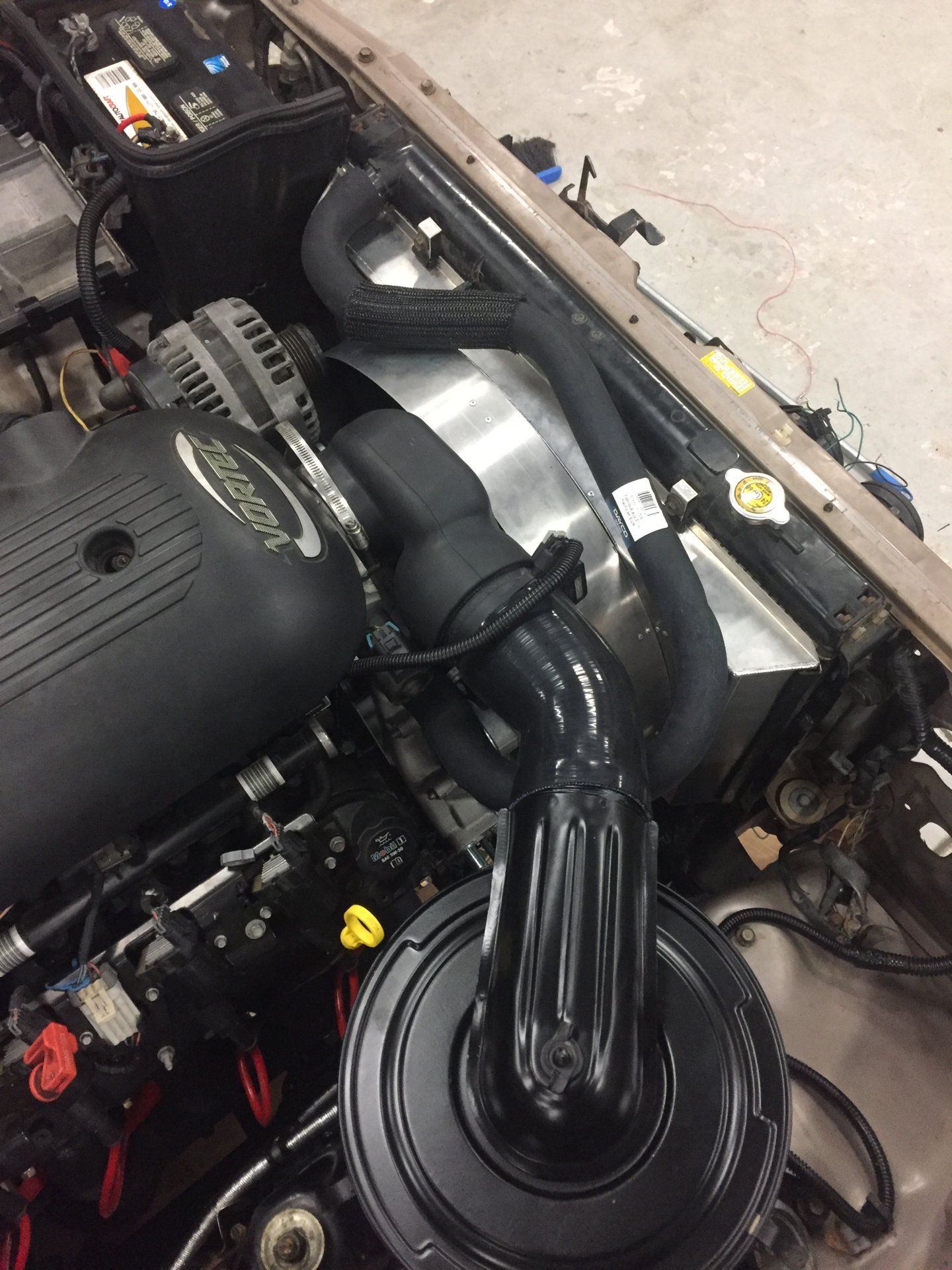

I would do the "rope trick" to replace the valves without removing the head. But it would probably be smart to do the head gasket at that mileage. And as long as you have it out of service, pull the engine and have the bores honed and new rings. And as long as the engine's out, you might as well do an LS swap...
Also, stop making your wife live in a camper. It's mean and takes up important garage space.
