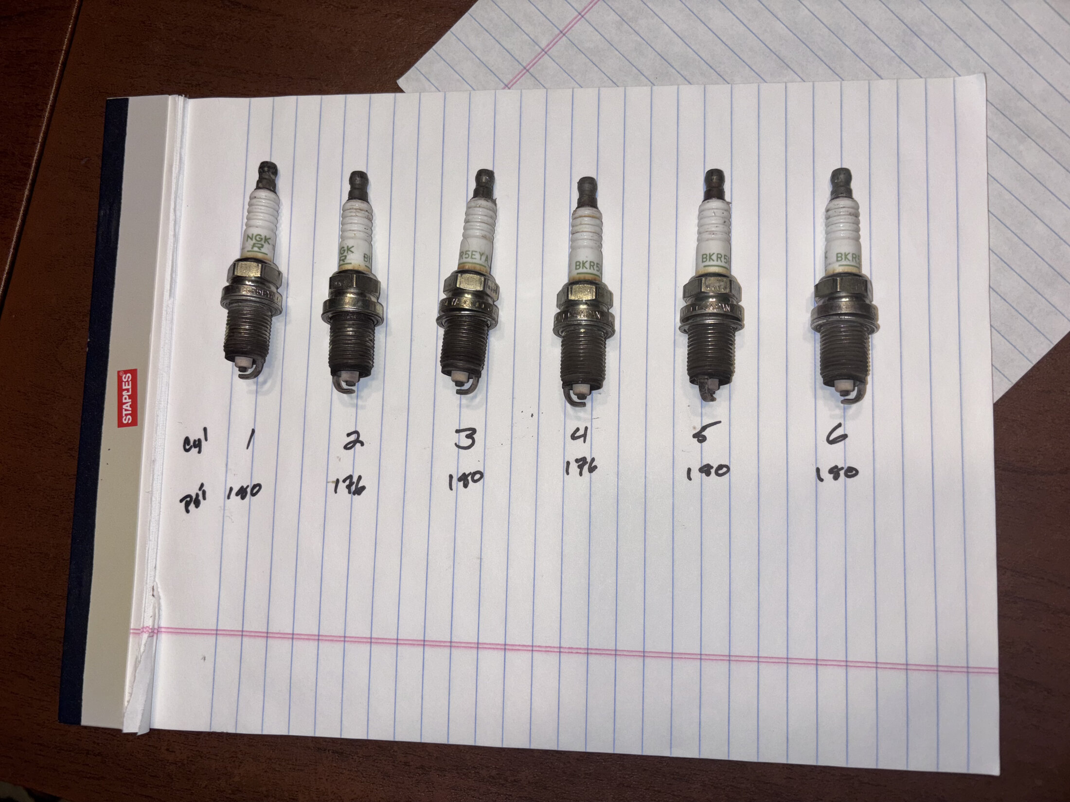

My compression readings are similar to yours: four @180 psi, two @176. I am not burning any significant oil and after 20,000 miles, these are the plugs. Unless you have something very different going on I would leave the seals alone for now.
My compression readings are similar to yours: four @180 psi, two @176. I am not burning any significant oil and after 20,000 miles, these are the plugs. Unless you have something very different going on I would leave the seals alone for now.View attachment 3783354
