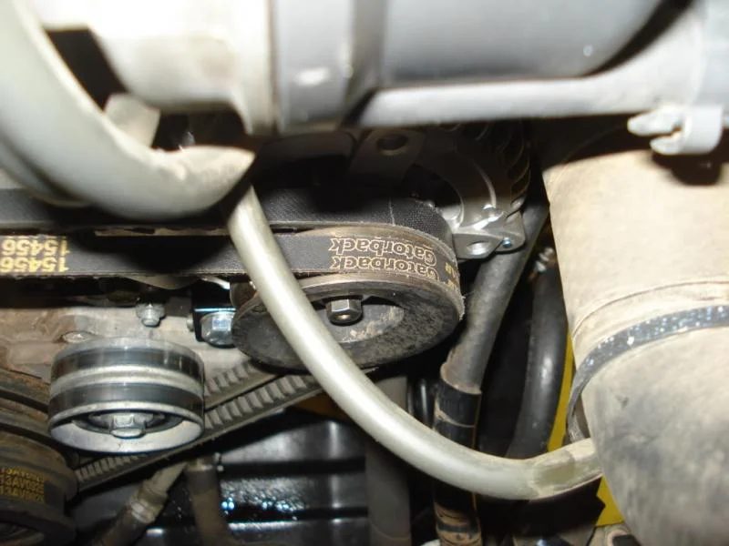

Alternator Idler pulley.
I bought my truck without the alternator idler pulley.
This weekend I installed it after buying it new from cdan.
Alas the belts don't reach it.
For those who made the 150amp mod, does you idler pulley do anything?
Does it reach the belts?
everything should fit fine! It is tight, but if you tilt the alternator in as described in the instructions you should be fine.
Everything does fit and is working for a month or two.
I just added the pulley because it wasn't there :-)
alas, when every think is tight and snag, the belt hardly thouch the pulley and it makes rattling noise because there is not tension on it.
Can someone post a picture detailing where that idler pulley suppose to be installed? Is it possible I stuck it into the wrong place?
Alternator idler pulley
Just found this picture. This is where I installed the pulley. But mine hardly touches the belts.
