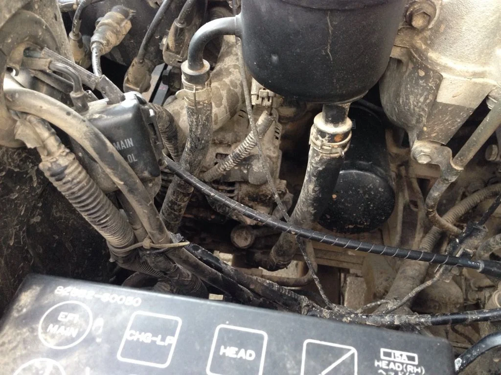

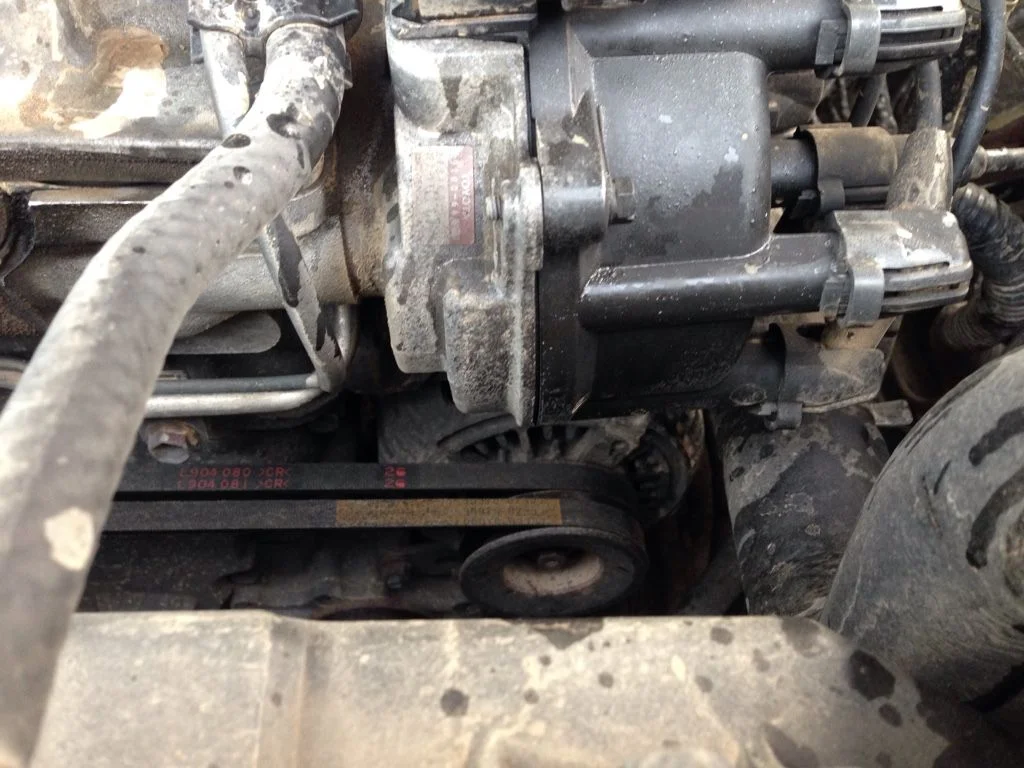

Hi, looking to do this upgrade on a Japanese import 94FZJ80 here in the UK, has anybody tried this before? Any problems with the size of the 150amp alternators? The truck is RHD and I have added some really rubbish photos!!
Cheers
i don't think it matters.... all should work the same. No issues with the 150amp size... many successful installs including mine
