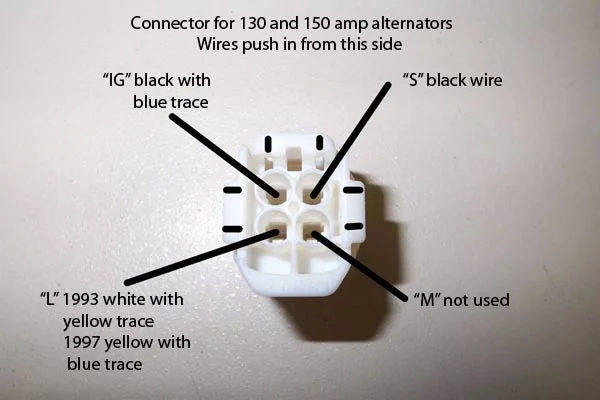

I would start with how you rewired the alternator plug. Double check you have the wires in the correct position....

I triple checked that. That was actually my first thought. Maybe my ECU was not telling the alternator to charge. I will check again but I am confident it is correct.
I suppose I could have buggered up one of the pins. I had a hard time getting the first one out, before I realized I needed to pull that white tab out first. Looks like Toyota has a pigtail available. So I may go that route.

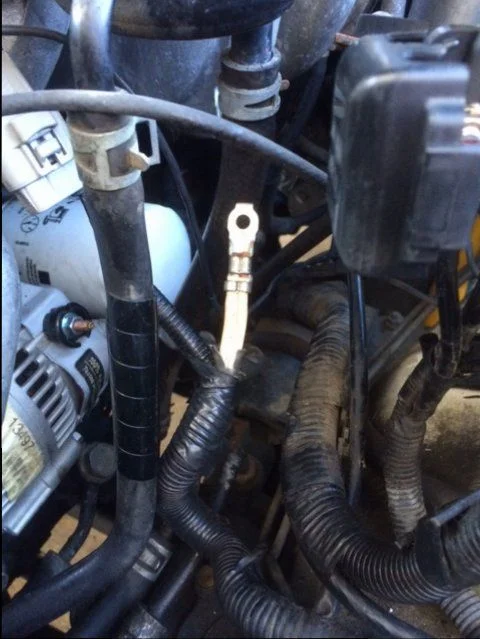

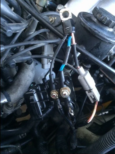

Ok, hoping someone can clarify the wiring. I read and read this thread but am still completely unsure of exactly what I should do. I want to make the wiring as clean as possible. Please tell me if the below is correct based on the pics.
Pic 1, large wire with dots on it and smaller wire that go to B + post on Alt., Larger wire is cut and shrink wrapped, taped up with electrical tape back to harness. Then the smaller wire is connected ALONG with the new larger 4 guage wire and connected to the alt post, the 4 guage wire goes to the batt with a 150 amp fuse in between. with 150 amp fuse between alt b post and batt +, smaller white goes into the harness it's it's oem configuration.
pic 2, black box, am1 box, 3 wires here, 2 in the box and one with a connector, fusible link wire is cut (blue) and removed and tied into harness with tape, other 2 wires (one with connector and black wire) are connected to a 10 guage wire and sent to batt +.

Just put the original wire terminal back on "B" at the alternator (I.E. both white wires) along with the new 4 gauge wire. Then just unbolt the blue fusible link in the AM1 box and tape its ring terminal end. Done.

Yes, through the fusible links. The new 4 gauge wire you said you had will go from the alternator "B" post to a new 150 amp fuse holder, then from the new fuse holder to battery positive (a new larger charging wire). The old stock charging wire will be reconnected at the alternator "B" so the other wire that is crimped in the stock wire terminal will still have power to feed some circuits in the under hood and under dash fuse boxes. By unbolting or disconnecting the blue fusible link at the AM1 box the old charge circuit/wire is now open and will not charge. The blue fusible link wire ring terminal end that was in the AM1 box should be taped since the other end that is part of the fusible link bundle will be reconnected to battery positive and be hot. A sort of advantage to doing the install this way is if there is a circumstance where the 150 amp fuse blows and the cause is fixed but you don't have a spare fuse, the old fusible link can be reconnected in the AM1 box and could get you home.

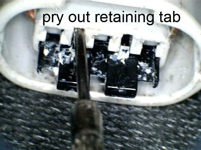

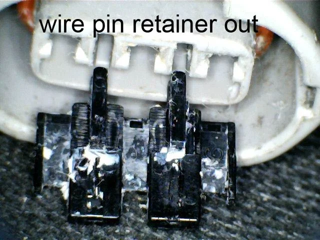

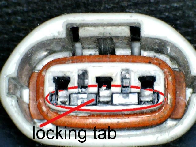

Here are a few pictures of how to remove the old wires from the stock alternator connector.
There is a locking or retaining tab in the connector that I just pry out with a small screwdriver by putting the screwdriver in one of the slots shown in the picture. Once the locking tab is popped out the wires are just pulled or pushed out through the back of the connector.

A few things to check. The "S" wire (black) at the alternator should have 12 volts power at all times. The "ig" (black with blue trace) should have 12 volts power with key on. Hopefully the pins from these wires are making contact when plugged in to the alternator. Up at the AM1 jump the black fusible link from the bolt to battery positive. This is from the "S" sense wire. If the black "S" fusible link is making intermittent contact it could cause voltage fluctuations. Could try to jump the other fusible link too. Since this is still running through the stock wiring the fusible links could have gotten partially broken when doing the install. An alternator going to 17 volts is almost full field which makes the voltage regulator suspect.
