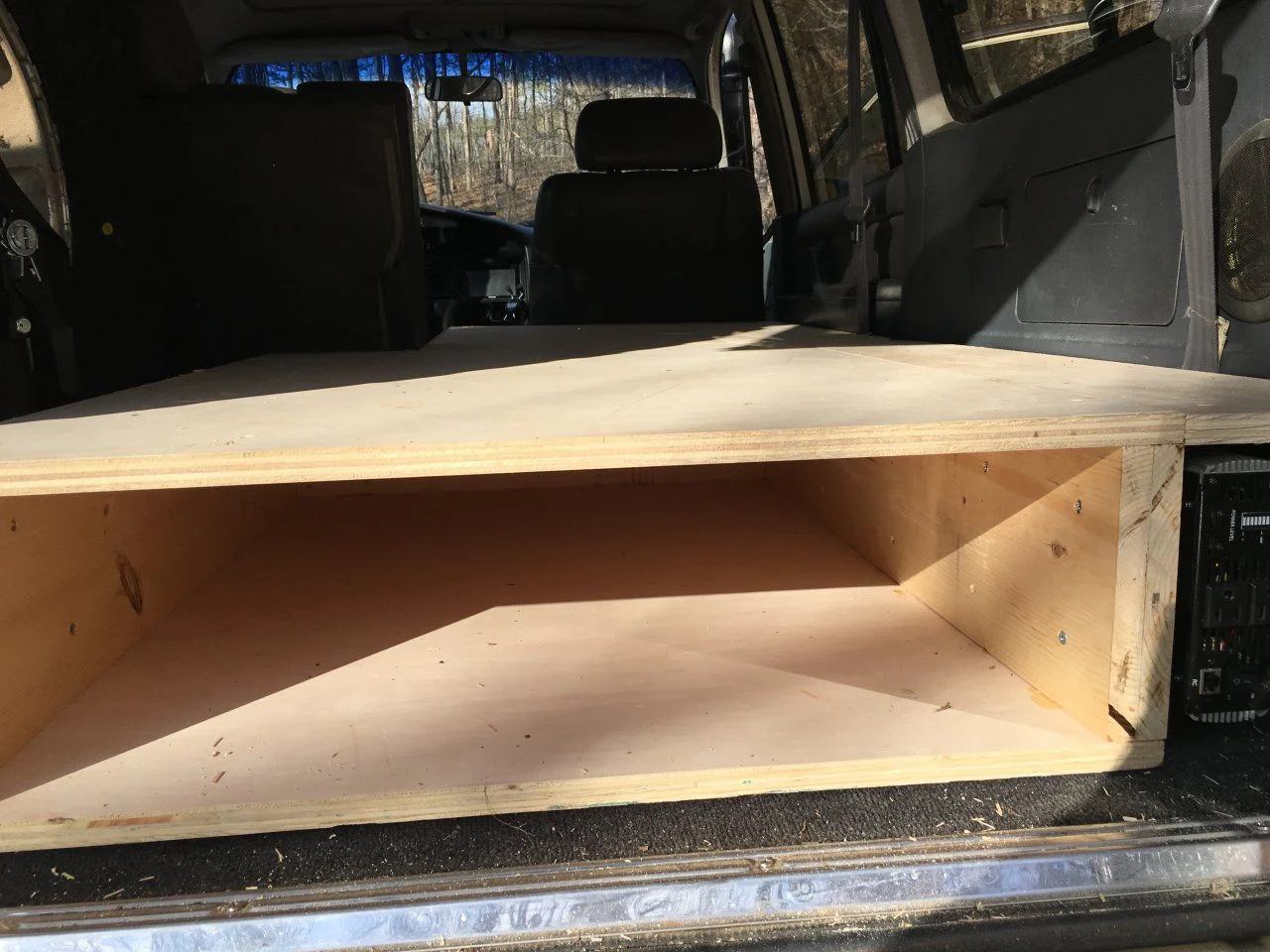

I've given up for now trying to find an affordable tire carrier/bumper. I went back to my original plan. Goal was to have a drawer, single sleeping platform, still access the panel in the back on the passenger side, and be able to fit two Plano totes on top. Used 3/4" maple veneer plywood for tyhe top and bottom. 1x8 pine boards doubled up for the sides. I got the sleeping platform and box for the drawer built. Drawer, carpet, etc in the coming weeks

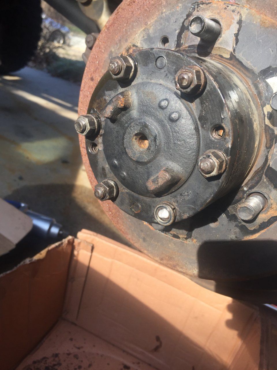

Started rear brakes and figured I'd take a look at the rear axle since it's a 2 minute removal. Looks good so I put it back and tighten gently with a 3/8" socket and the last one does this.
So I'm off to a good start on the rear brakes!
Well, the good news is that's an easy fix.
BTW .... FSM specs for rear axle studs are to only tighten to 25 ft lb. :D
On the subject of alarms, I would like to yank out the one in our '94 80. One fob is not working and the other has broken so will not stay on keychain. If you honk the horn for any reason then the system chirps at you when you shut off the engine and you cannot restart unless you have a fob or you cycle/reset the toggle switch "hidden" in the kick panel. Any reason to not have it taken out?
So yeah let's talk offline on what the easiest way to fix is. I had envisioned cutting a groove in it and turning it out with a screwdriver.

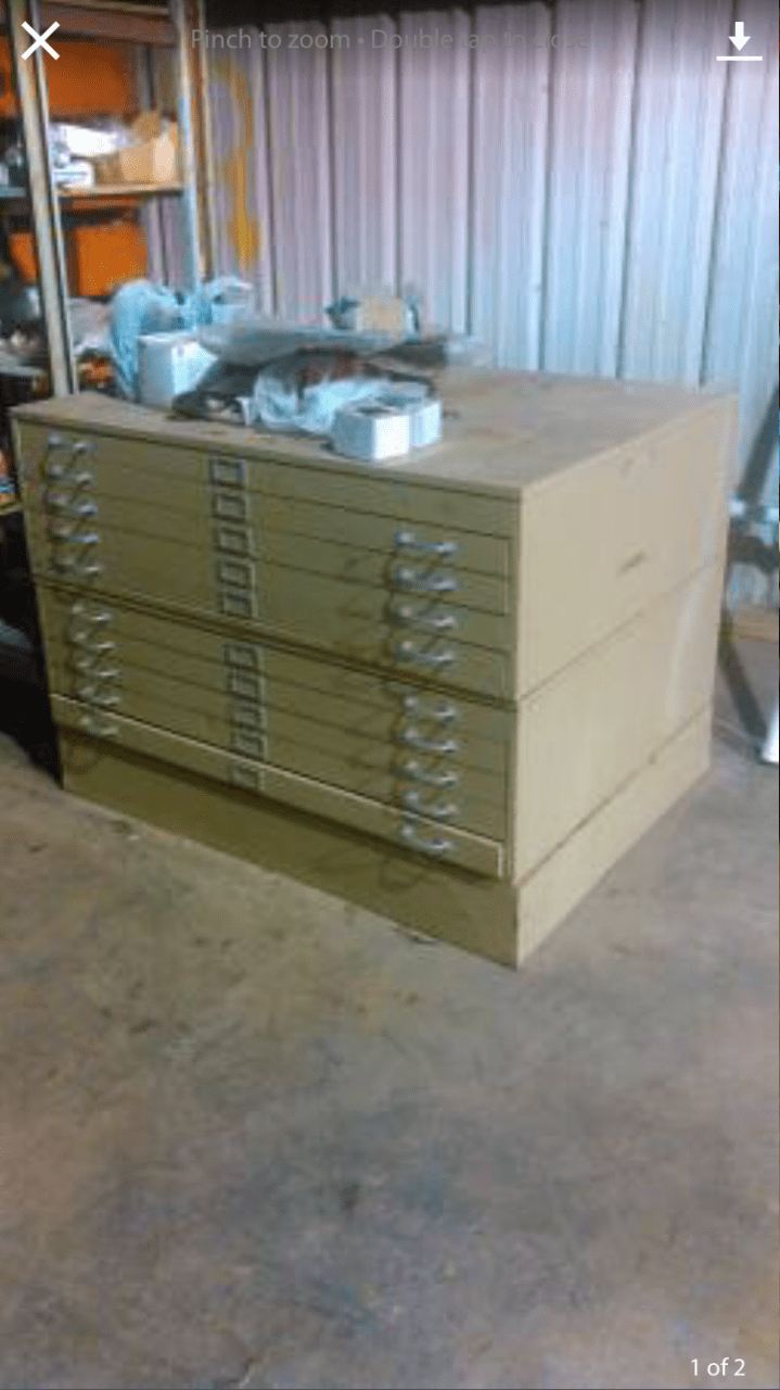

At any rate I had to stop and pick up these in Mebene.

Nice cabinets!!!!
