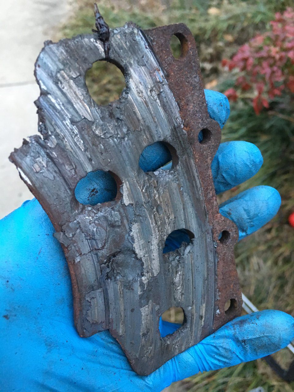

Turns out James was all the way down to squeal/wear indicator #2 ...... the backing plate :eek:
I wish we hd a pic of the culprit caliper. 3 out of 4 pistons were siezed on front driver side. To point it took pry bars and a hammer to get caliper off. Even then, could not get them to move with 6" C clamp or my monster channel locks. That thing was toast. Two inside pistons were fully extended likely past the wear zone with the extra travel allowed by no pad. Bottom outboard piston had been functiong but not top one so pad was newish at top and gone on the bottom half.

Front wheel bearings, new ABS sensor on one side and new wheel pad sensor, new rotors and new pads.
