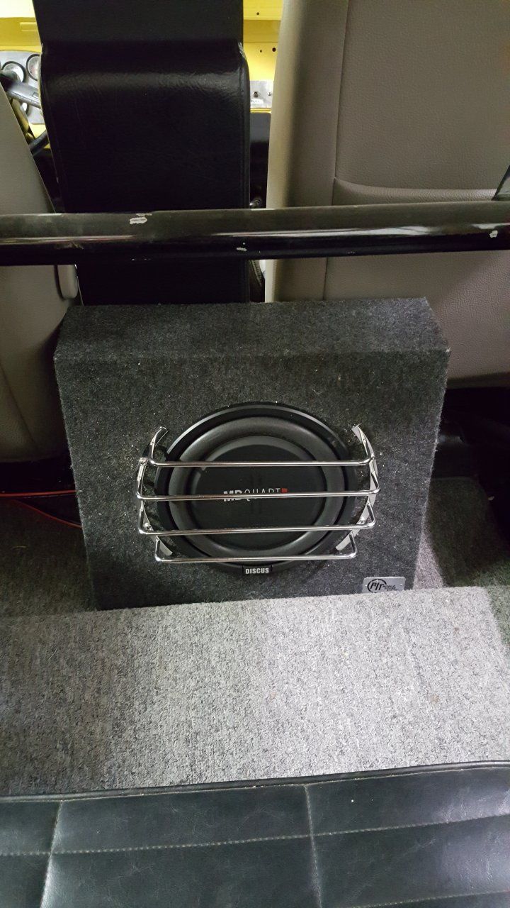

Time for some much needed recognition. A few months back @jamesurq was over in an attempt to rid his 40 of a nasty vibe (you may recall the brake drum that had been lathed in half). I had one on the bench so we bolted it on. James says "how much do I owe you?". I joked that I hated the sound system in Zippy and could use a sub woofer. A couple months cruise by and I've long forgotten about the sub until James sends a pic of sub, box, amp, and all the ancillaries along with a note telling me all the stereo parts have arrived. So now I'm running an amp for rear speakers along with another amp and sub supplied by James and it sounds great.
So James .... big thanks. Really awesome stuff.
