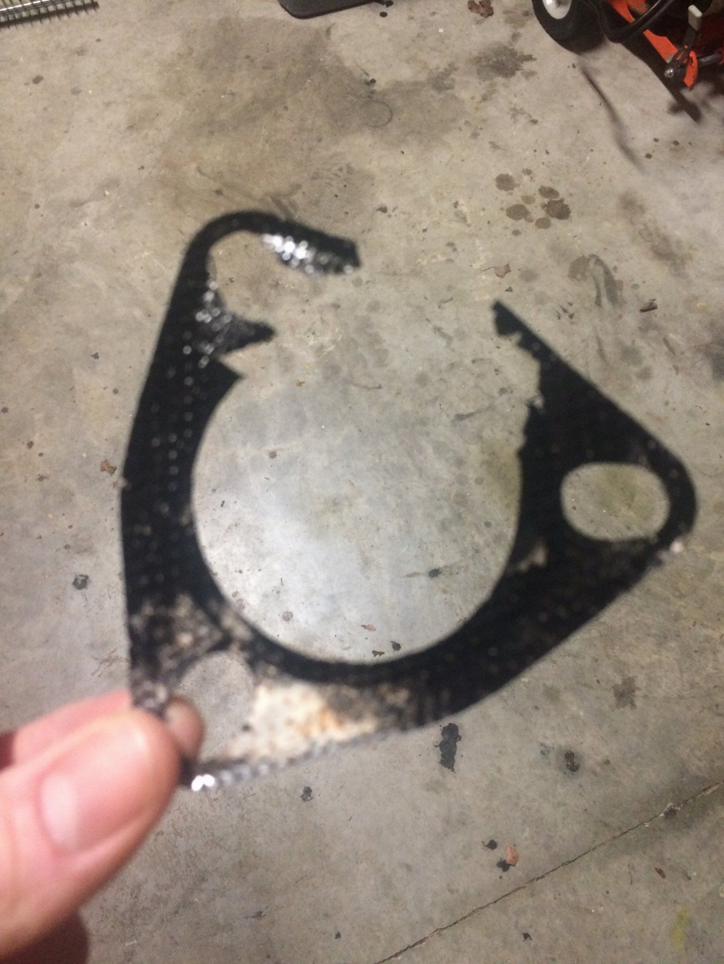

Well the 'ol Jalopy was living up the the new name @angerhater gave it: The Gas Chamber.
It had been getting loud too.
For some reason, no one ever wants to put the nut in the rear exhaust stud. It was missing when I got the truck, and now that it has a shiny new exhaust, it's missing again.
Anyway, this is the result, so I got a (another) new but and a factory gasket from Toyota. Should be good for a while now.

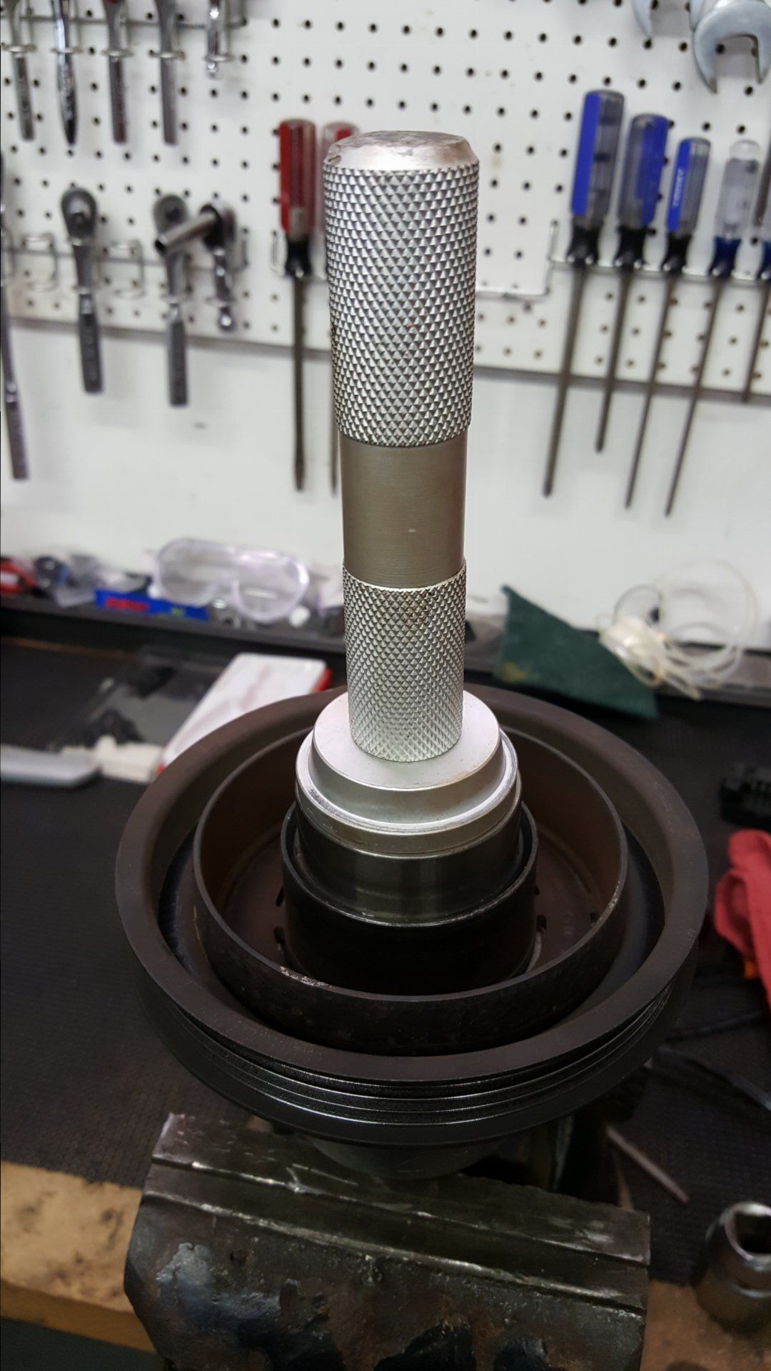

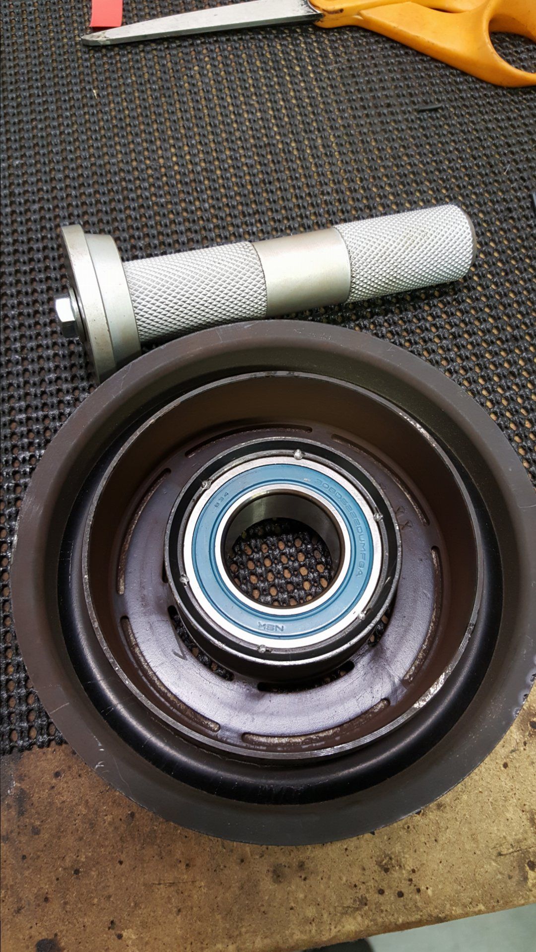

The odd thing about wrenching ... when in the moment it feels like you're in the throws of some major undertaking, but when reflecting on the finished project, ehh.
Thus was today's mini-wrench job. Replace an AC clutch bearing that was raising a fit in the 4runner along with idler bearing while I was in there.
Something I've never tried before ... surgery via phone camera. The snap ring holding the AC pulley was in a blind spot and too deep into the pulley to do by feel. Using the camera as my eyes worked great.
My goof for the day. All buttoned up, crank, and then check under the hood for a new rattle. Seems I left a flashlight in the fan shroud. :doh:
