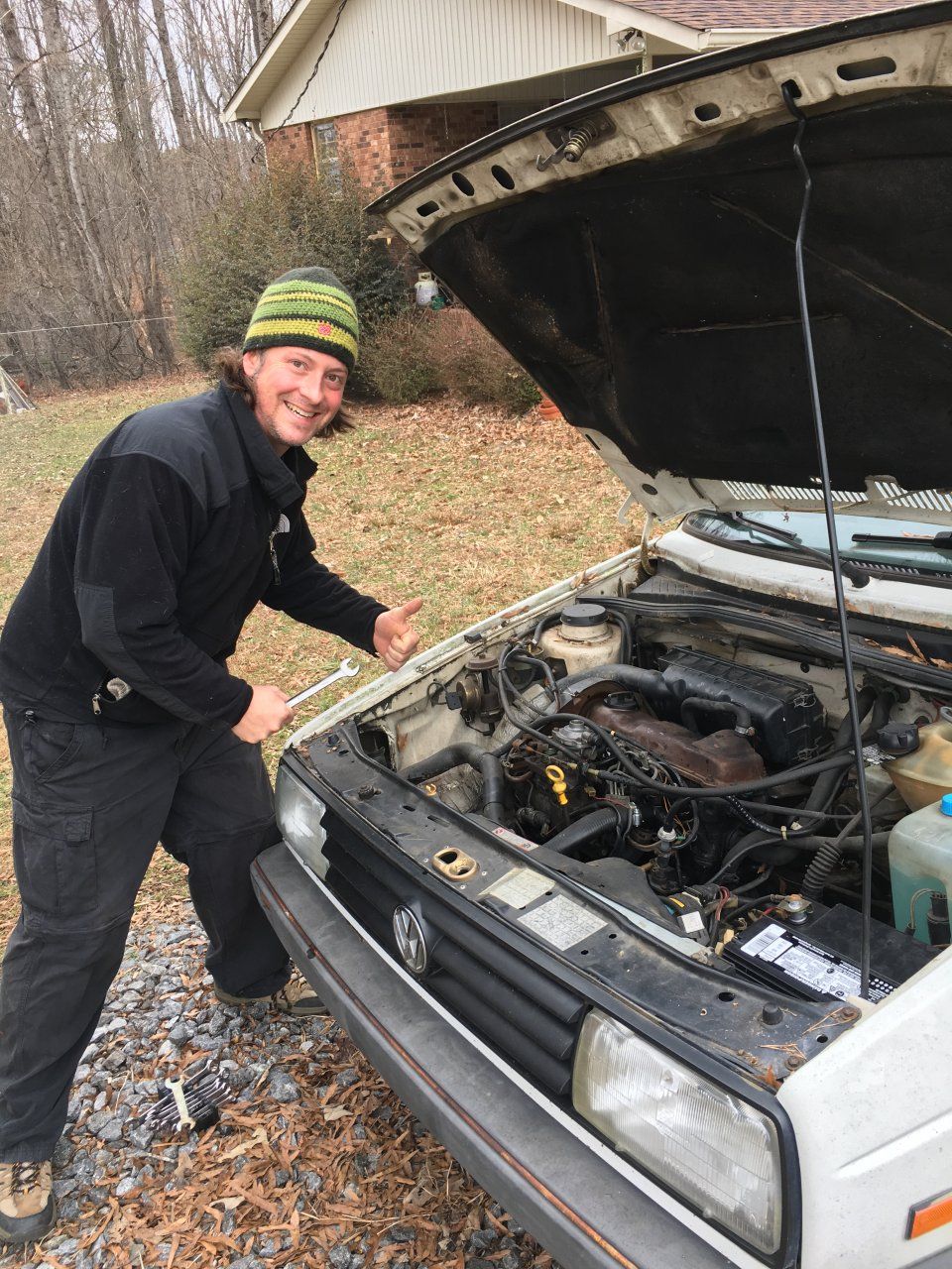

She lives!! After a year of sitting and several bleeds of the injectors the ol Jetta is on the road again! Still have a couple things to work on but just good to get her fired up after a year of being parked. Big thanks to @jfz80 for the help and @GLTHFJ60 for some solid diesel advice.
AWESOME. Good thing you tried that on a "warm" day.
