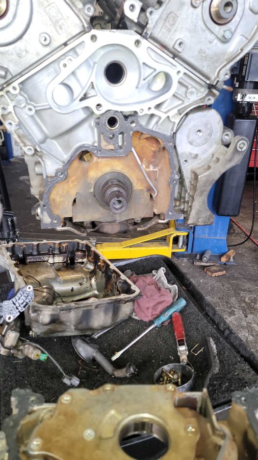

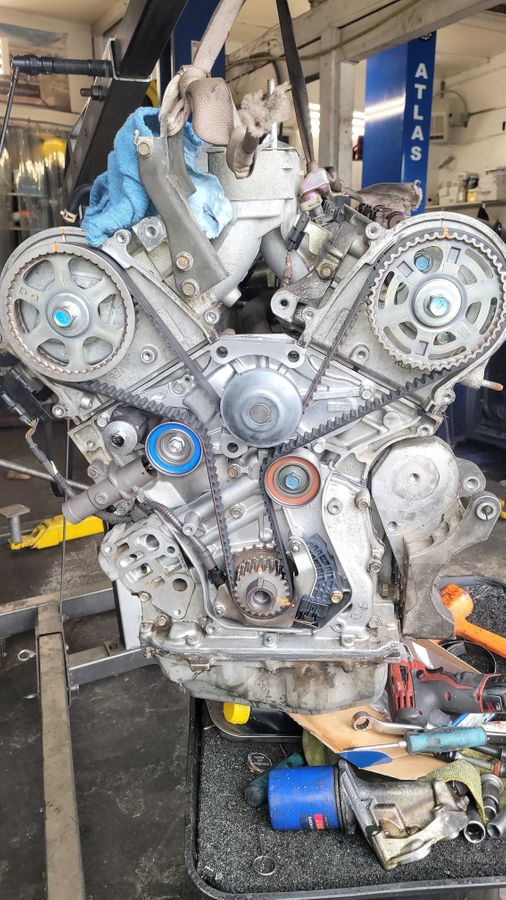

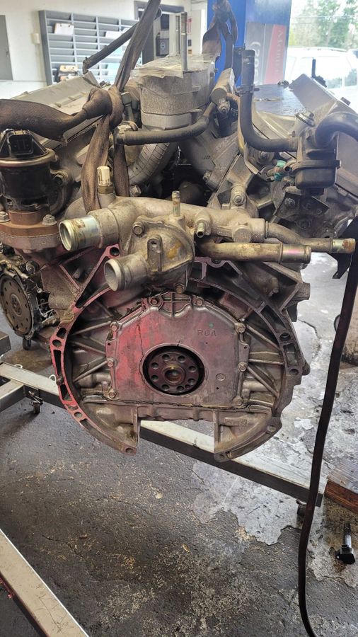

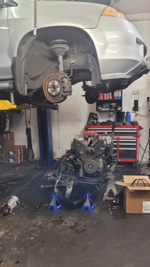

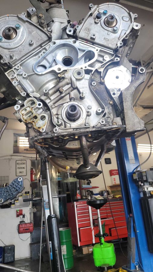

One giant pain in the ass out of the way. Been having great luck with cars recently. The VW died again. Done with it.
Idler went out on focus when Andrea was driving and she may have cooked the head gasket.
Motor on acura was completely buggered.
Got some time over the weekend, a used motor, a ton of parts and rented a bay for two days to put new motor in. Used motor had 100k on it. Replaced timing belt, water pump, all belts and tensioner. Rear main seal, front crank seal, oil pan seal, pulled oil pump and replaced its seal and seal on oil filter mounts. Replaced radiator, spark plugs all coils, pcv valve egr valve, rear motor mounts trans mounts radiator hoses, etc....
This an thing better last forever now. All oem parts or denso parts were used.
Worked on car during day, work work at night. Ran out of time on Sunday and had a mobil mechanic on call there finish up install g the subframe with engine and trans attached.
Now to get rid of jetta after pulling motor and trans, replace tensioner and belt on foxus to see if HG is ok and sell car. Acura is now andreas DD and subaru is mine (but I think head is lifting a bit under boost soo more fun there......) still have the benz until I pull the motor for build.

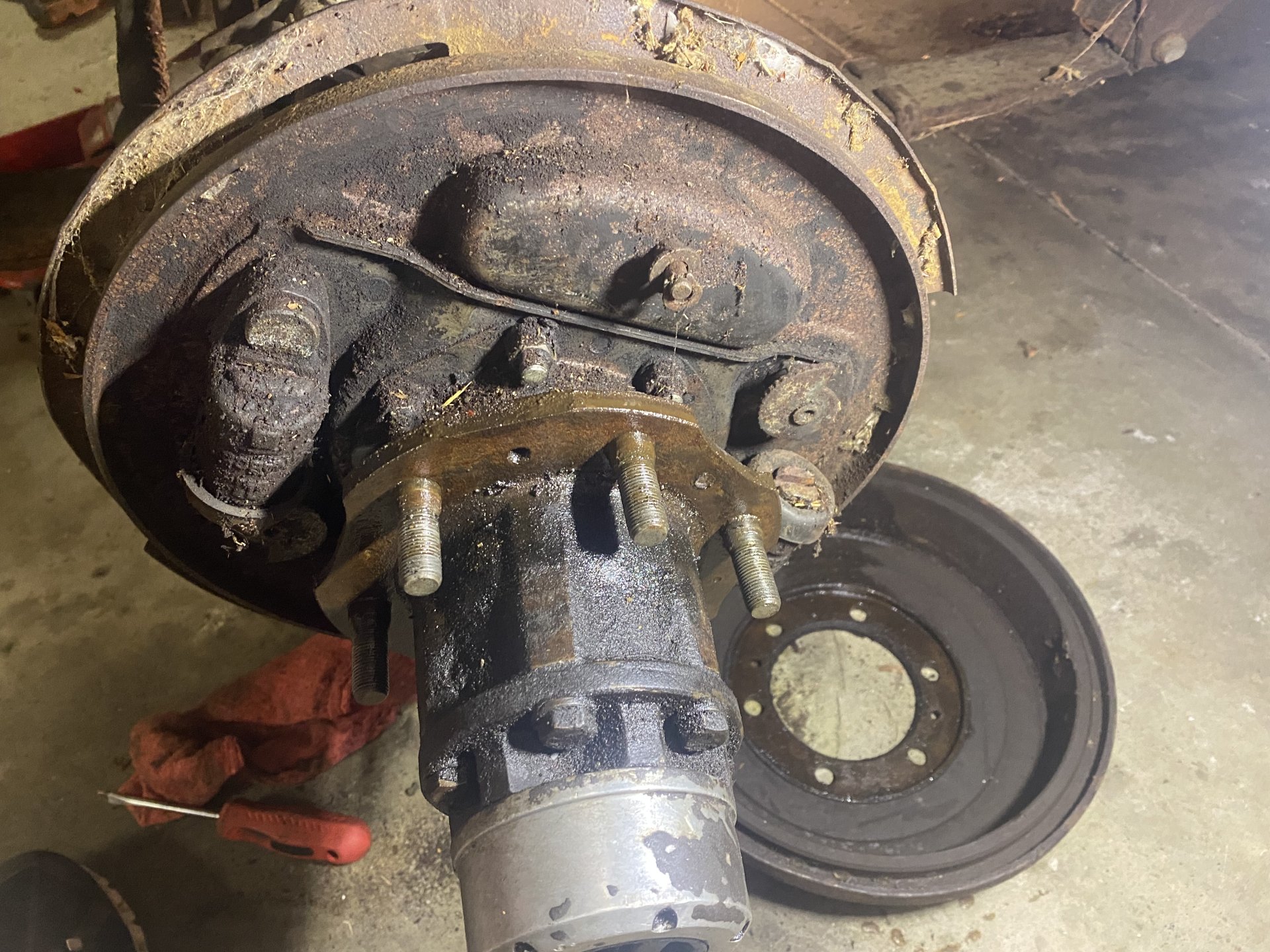

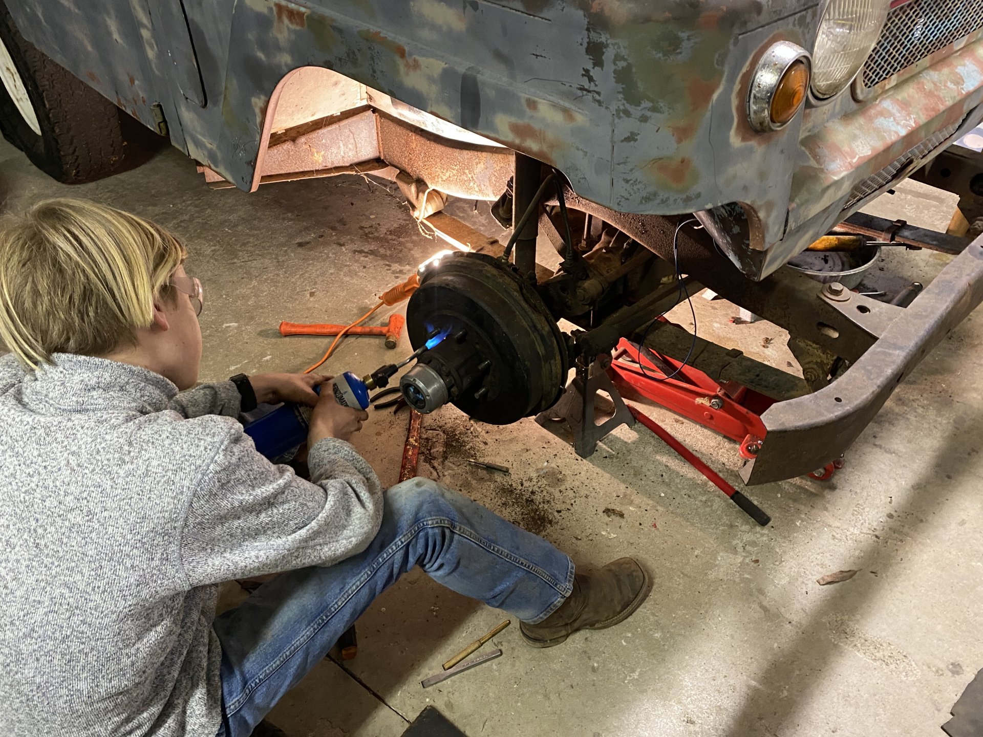

After 5 years of collecting dust, work has started on the Faux40. Brake rotors put up a good fight, only to reveal crusty brake cylinders and MIA brake pads. Learning why some folks throw 40 axles under these and call it a day.

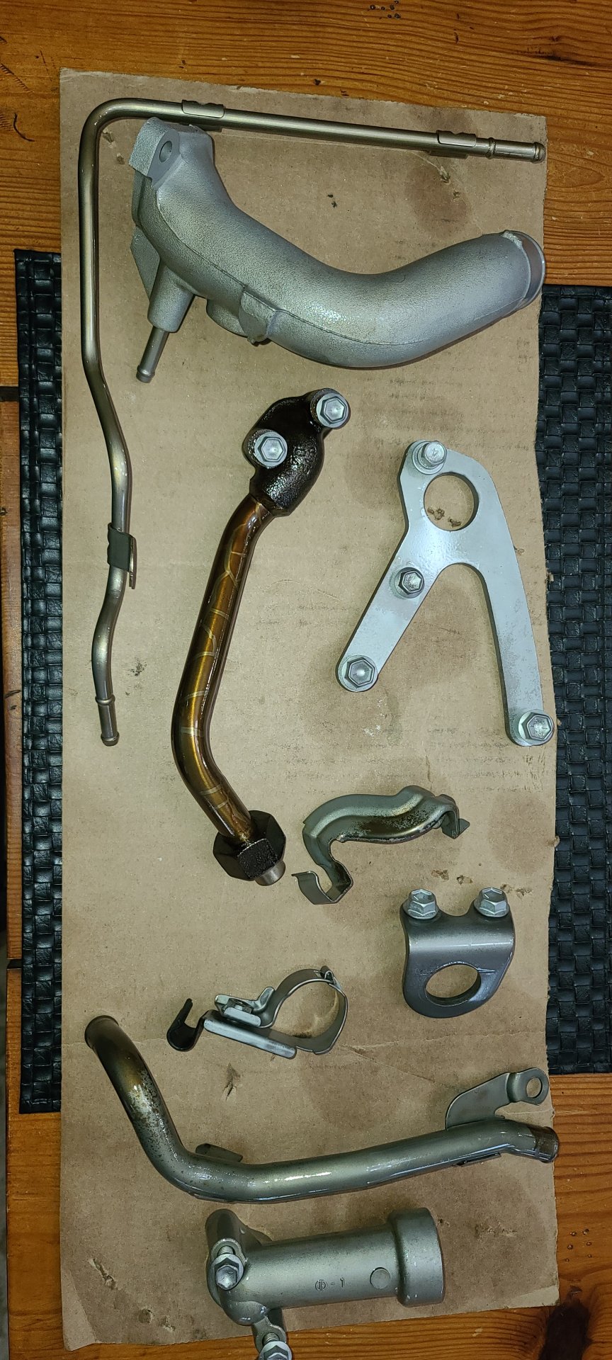

VHT Flameproof update:
The preliminary results are in. Here are a few bits and pieces, cleaned, bead blasted and coated (as per VHT's instructions):

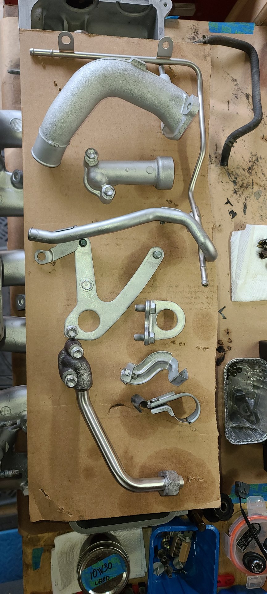

Here is the oven cured result:
Both water necks look like crap on the underside (you see them as I baked them). At 400°, the clearcoat ran and varnished badly. It doesn't look as fried as the EGR pipe, but it's unacceptable.
As a test, and because I really don't care about it, I cooked the EGR pipe first.
First, a few process notes:
1) I used my kitchen oven and propane barbeque. The oven temp gauge is wrong (what a surprise!); 200° is actually about 180° and 400° is actually about 380°. My barbeque will reach, but not exceed 550°. Those are the curing temps I used, along with the required 30 on, 30 off, as per the instructions.
2) The first and second cures (albeit at lower temperatures than prescribed) looked very good, no discoloration, drips or runs.
3) The remaining parts, I cooked at a measured 200° and 400°, but not a final 600°-ish.
My analysis: the only way to keep the clearcoat from melting and varnishing is to keep the curing temp below 400°.
Lest anyone doubt my ability to follow instructions, I spent many years as a process engineer (not to mention a dozen in uniform), writing them and browbeating farmhands into following them. I assure you I can follow directions. There is no way to get this product to perform as claimed.
I am not going to cook the intakes; they look too good. I'll take my chances with the engine bay temps. I'll cure the exhaust headers on the truck. I'm really not looking forward to my crisp white paint job turning the color of a 3-pack-a-day smoker's fingers.
I'm looking forward to Cerakote.

Yeah, I've not had good luck with VHT. Cerakote is much better.
I've heat cycled my exhaust parts a dozen or more times now to 1200* (internal gas temp), and all the coatings look like new still. VHT would have been discolored by now.
