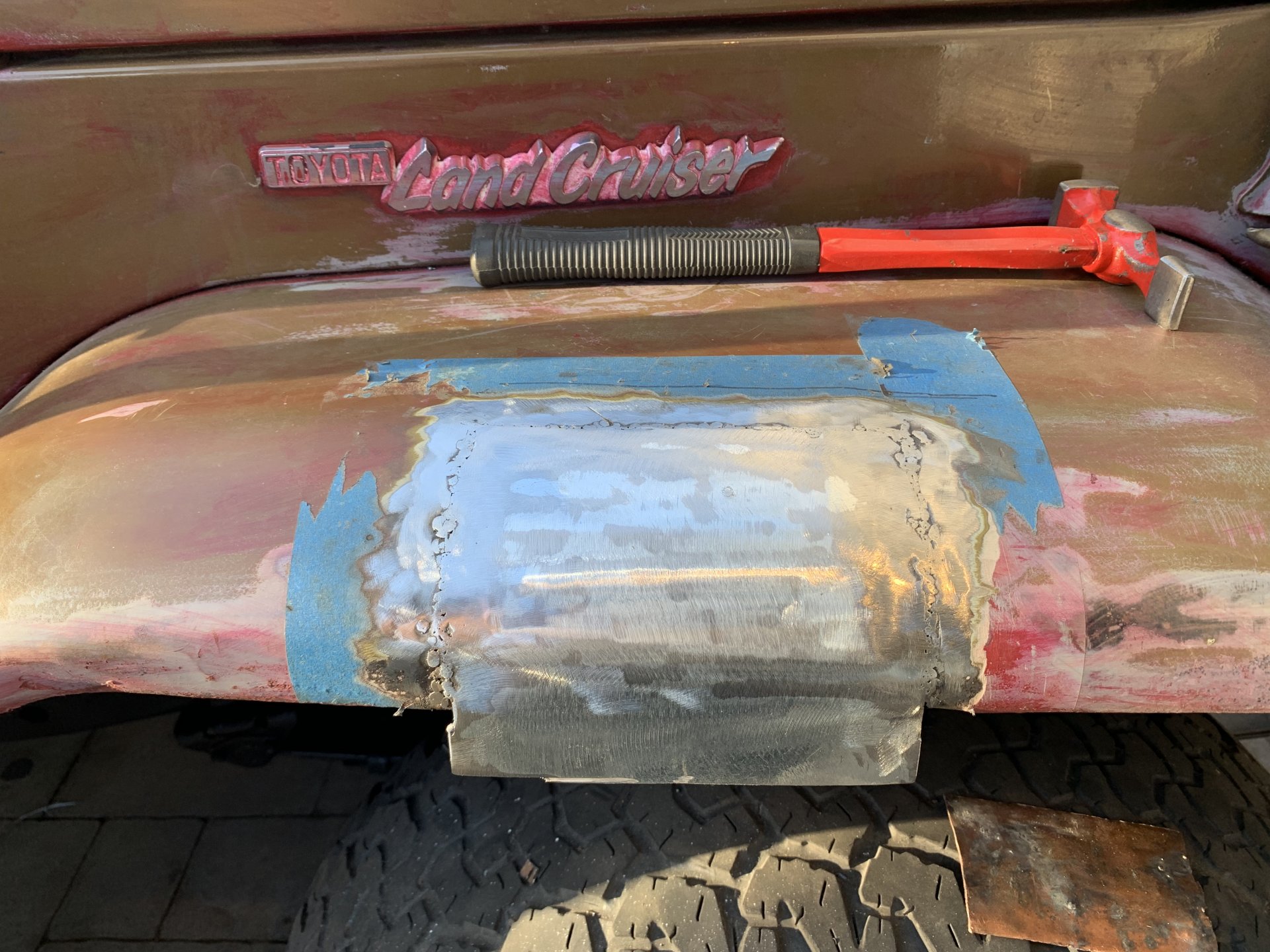

Well @JohnVee is back in town and wants to do lunch…. I realized my 40 has had cut-lines via blue painters tape on my front PS fender since he first saw it back in 2016…. I opted to use the avoidance of a good ribbing to get off my @ss and motivate today…
7 hrs of bending, cutting, converting, laying down metal boogers and then grinding…. Then repeat a few more times…

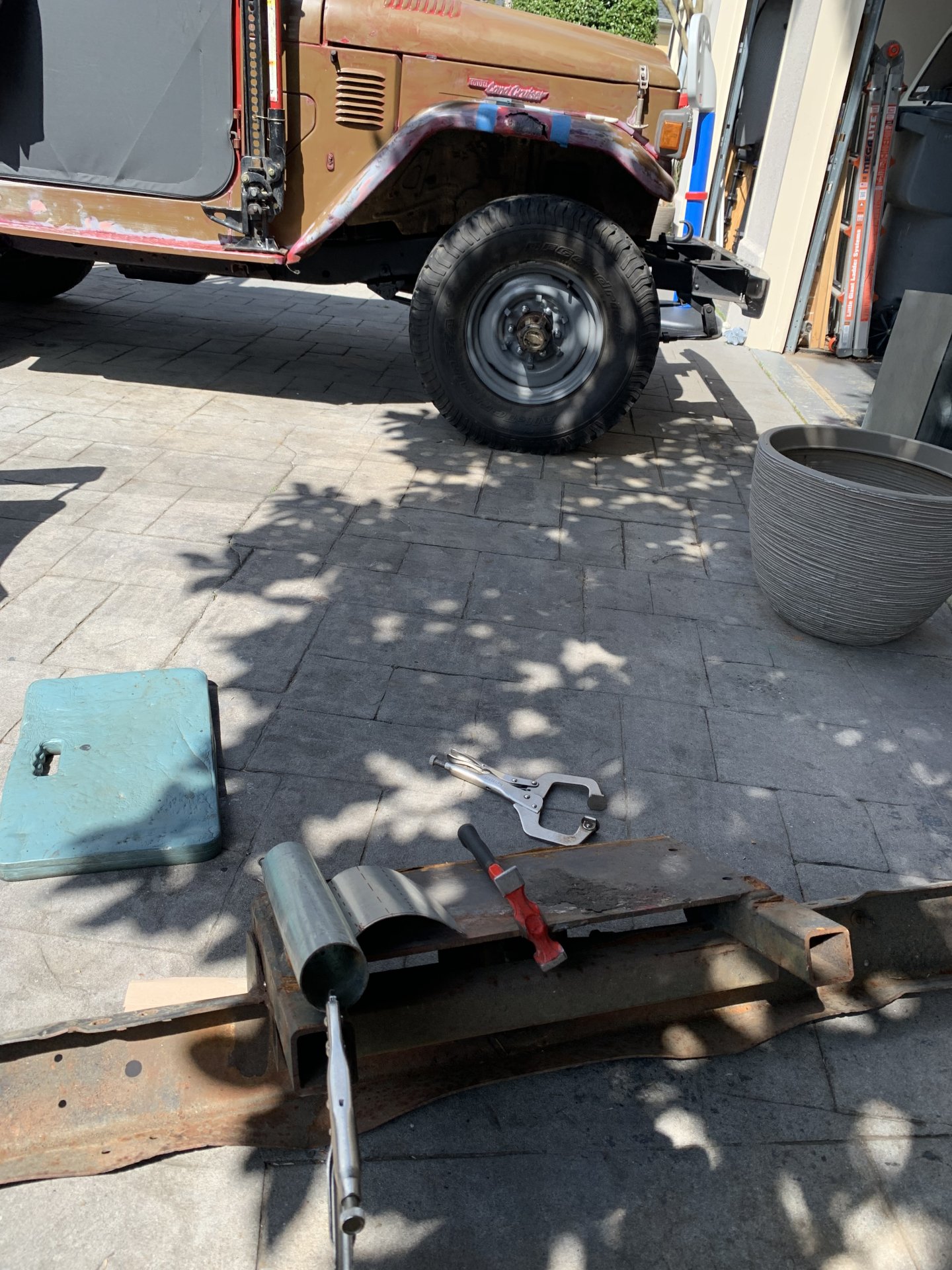

My make shift English wheel and bender combo
Opted to get the curve right and deal with bending the lip later…. Bad move in hindsight
Bending the lip proved to be a real PITA
Really proud of the curve…. Too bad the rest of the fender is even worse than my work with the metal glue stick

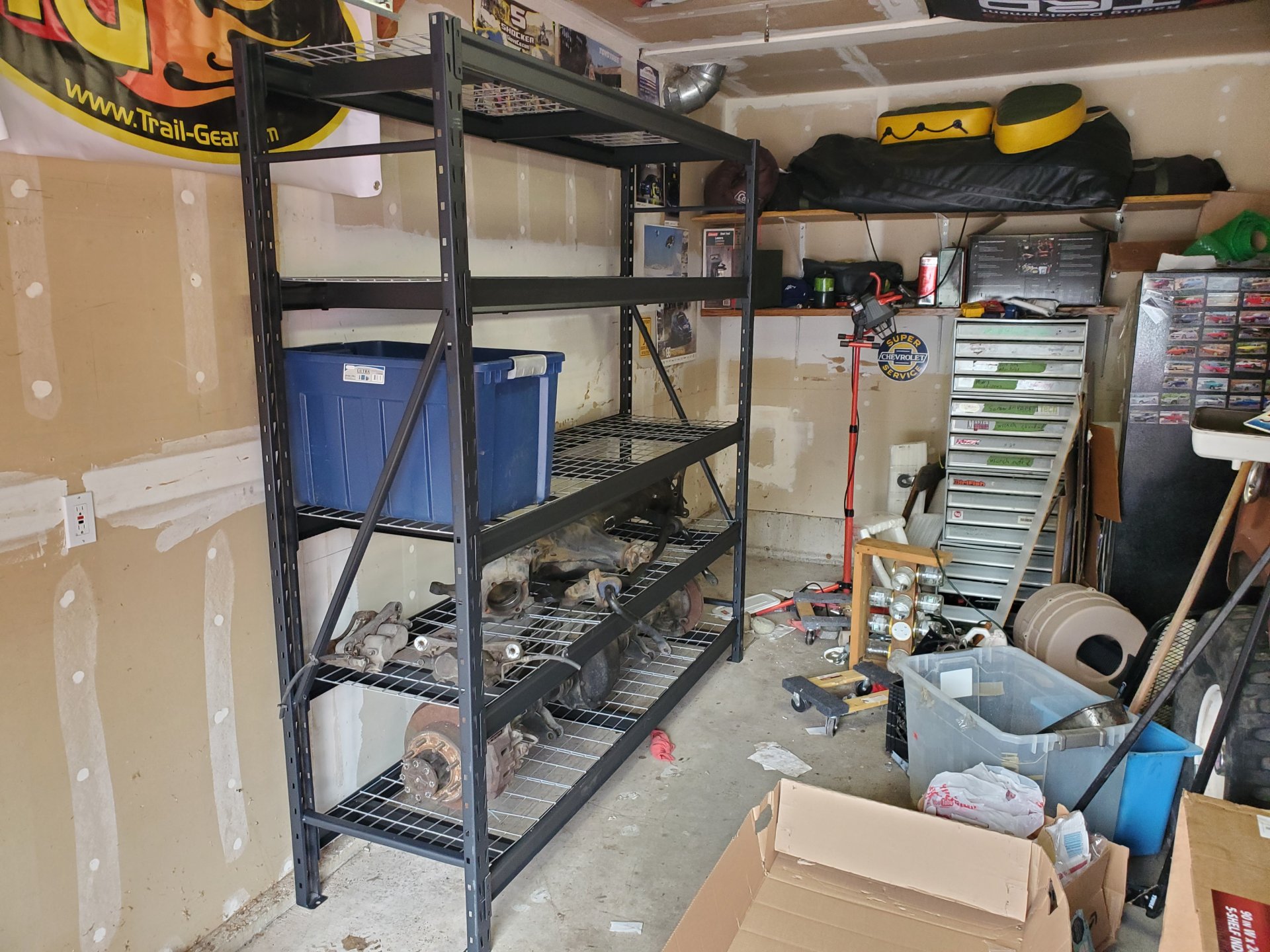

Not really wrenching but damn it was a work out. Decided to move a bunch of boxes out of storage and close it down. Got rid of things I don't need anymore.
Got a rack (don't like the metal wire grid shelves on the new racks depot and lowes sells but I needed done now)
My engine hoist is at my moms currently so I had to get the 10.5 sterling rear and HP D60 front axle on the first and second shelf by myself. Damn I do not remember them being that heavy. I need to look up the weight of each now as I take a small break lol.

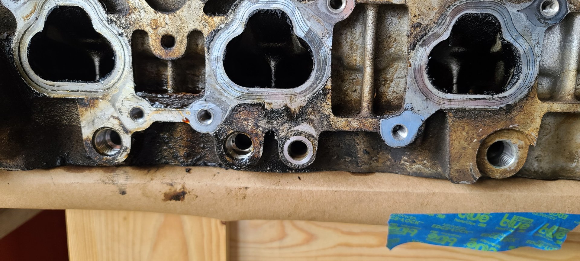

and this is what the head (intake side) looked like:
It all looked like a 10 year old barbeque grill hood, that had soaked in waste oil as a preservative.

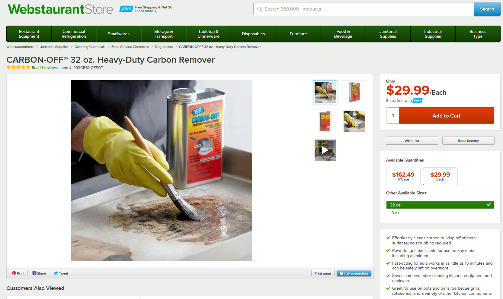

I was unhappy with the results, so, since I'm a professional searcher (I really am), I searched for something better. I found what I had hoped would be the answer:
Carbon-Off
