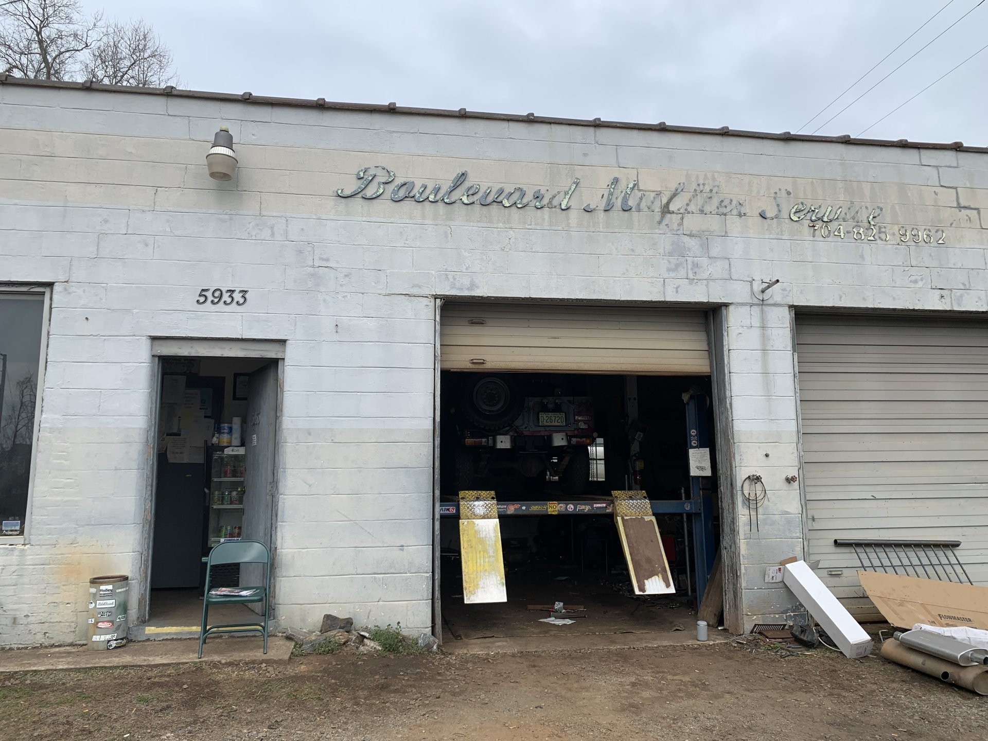

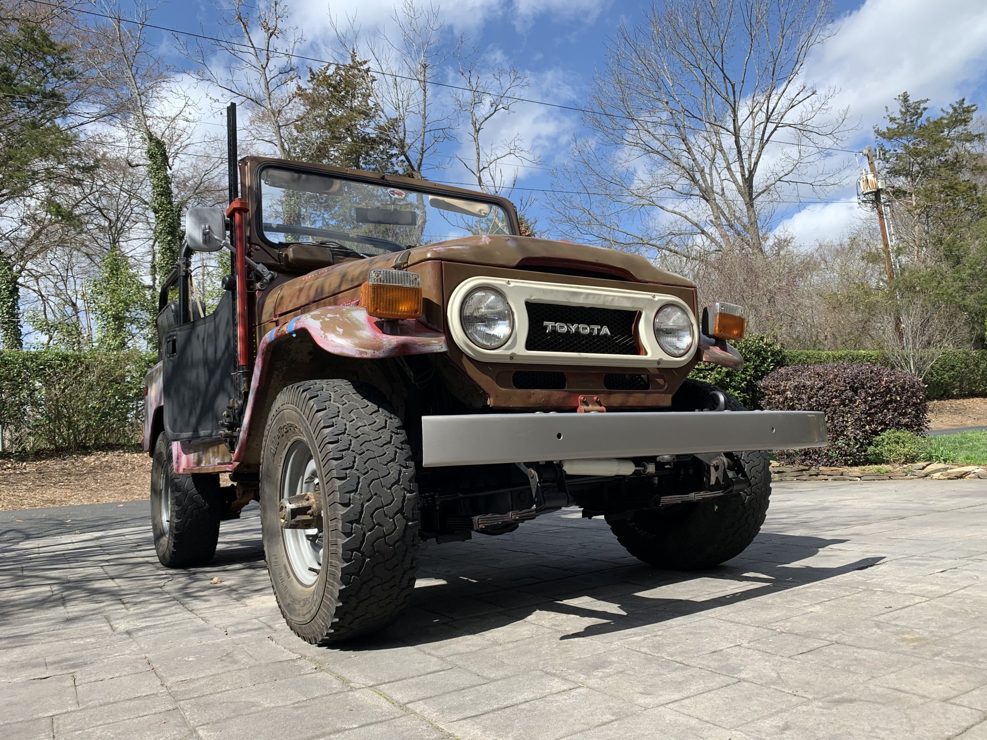

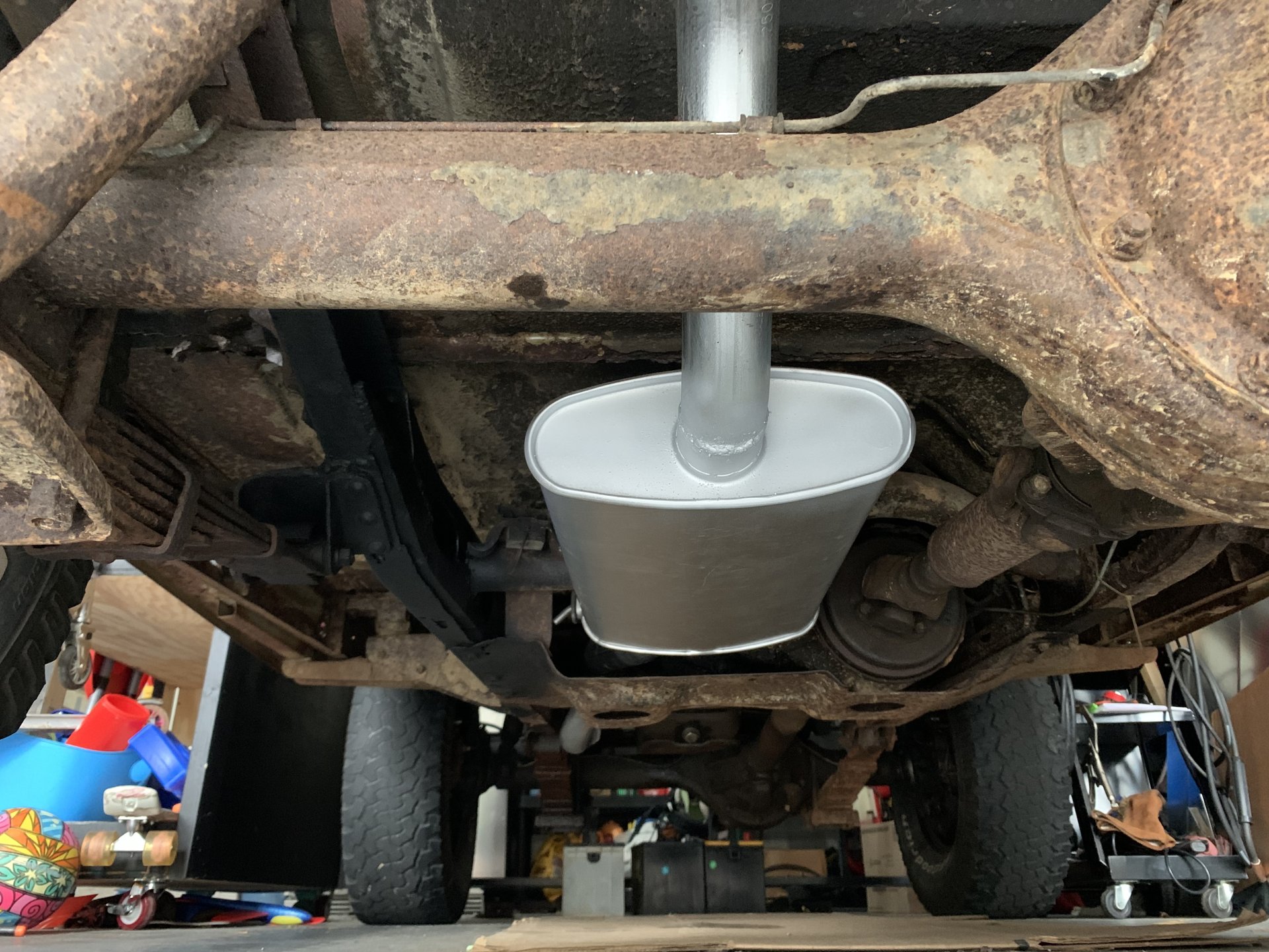

Finally took the 40 to see Buck at Boulevard Muffler in Belmont to finally get a muffler and exhaust installed. Much needed. He is an artist and a standup guy.

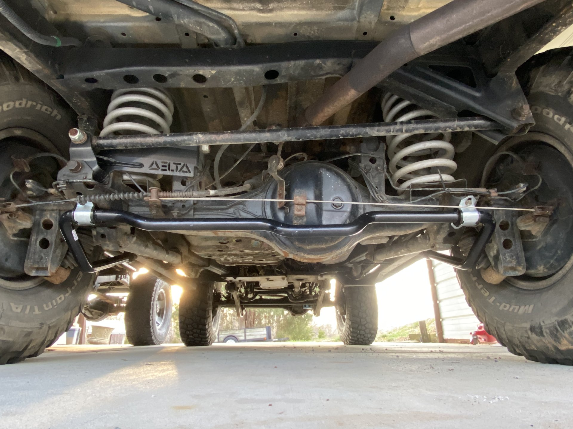

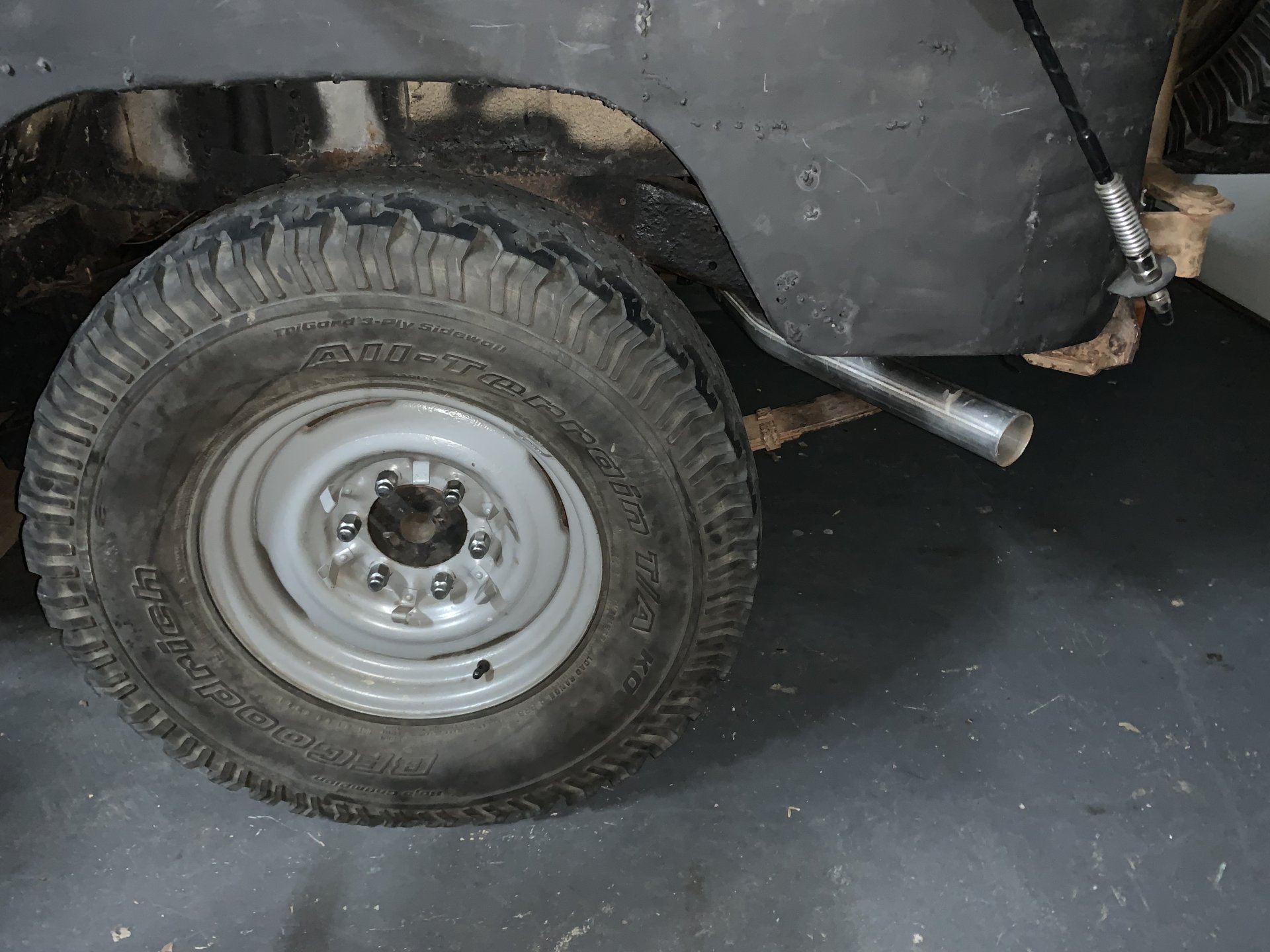

The OEM location is below the frame, so had him run it up inbetween the frame rails, even above the skid plates and out the DS rear corner…. Sadly a bit louder than my 60 he did, simply due to lack of real estate to fit the super long round muffler… so instead we went with the oval car one he had on hand.
Driving on rt 85 reminded me how terrifying the death wobble is…. So ordered some TREs after playing around with the excessive movement on the rods while it was up on the lift.

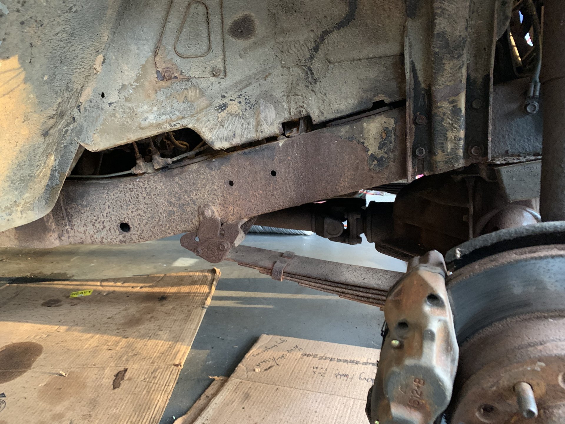

Btw I was pleasantly surprised after seeing the underside in all of its glory…. Yes lots of brown patina, but nothing scary and probably will clean up nicely with a wire wheel and some paint.

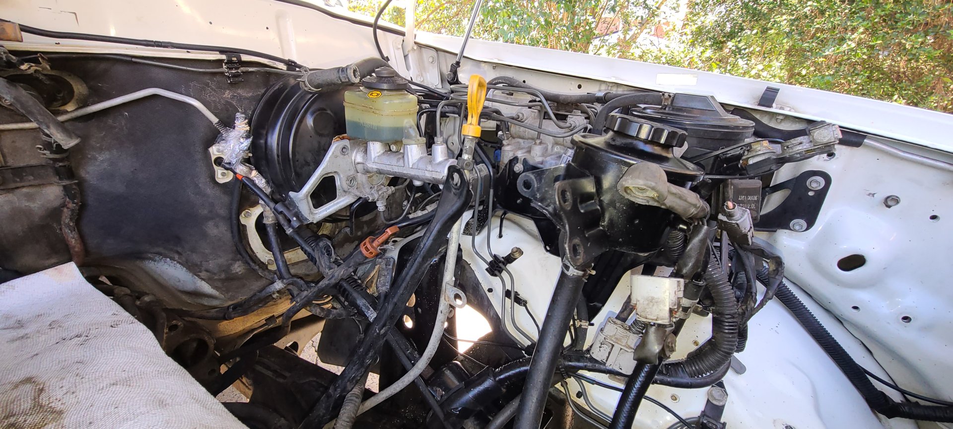

There was no way I was going to try this with the intake installed. So it increased the head job by many dollars.
There may be an easier way to do this, but I couldn't reach the top nut on the DS shock without unbolting the master cylinder and swinging it 1/4-in. There was no way it was coming off without impact persuasion.

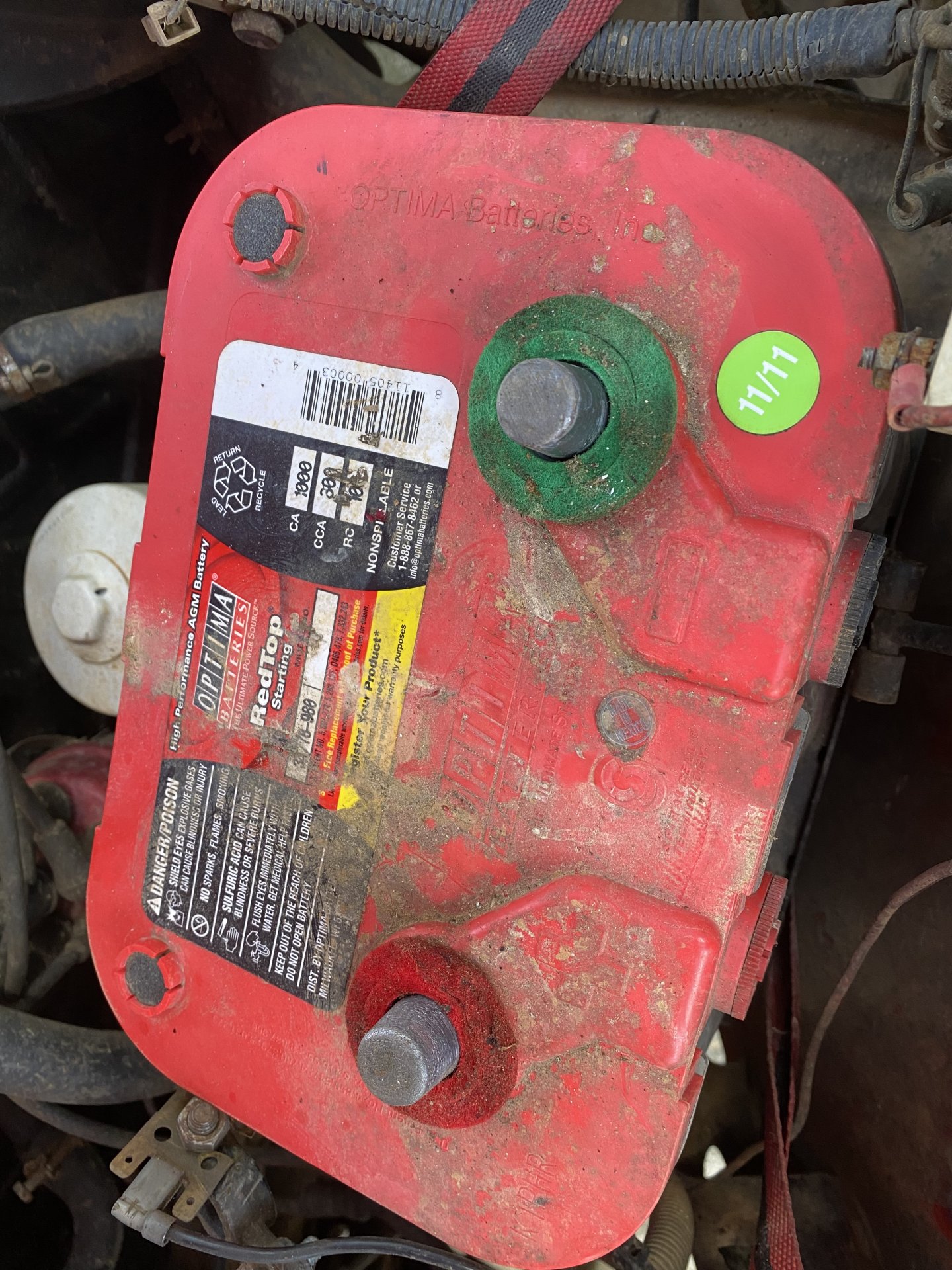

Praise due to the old Optima Red Tops. Needed a battery for another project and will put a new one in the 40. This battery is 11 years old and I don’t think ever been on a charger, never stumbled, and was worth the seemingly high amount paid back in 2011.

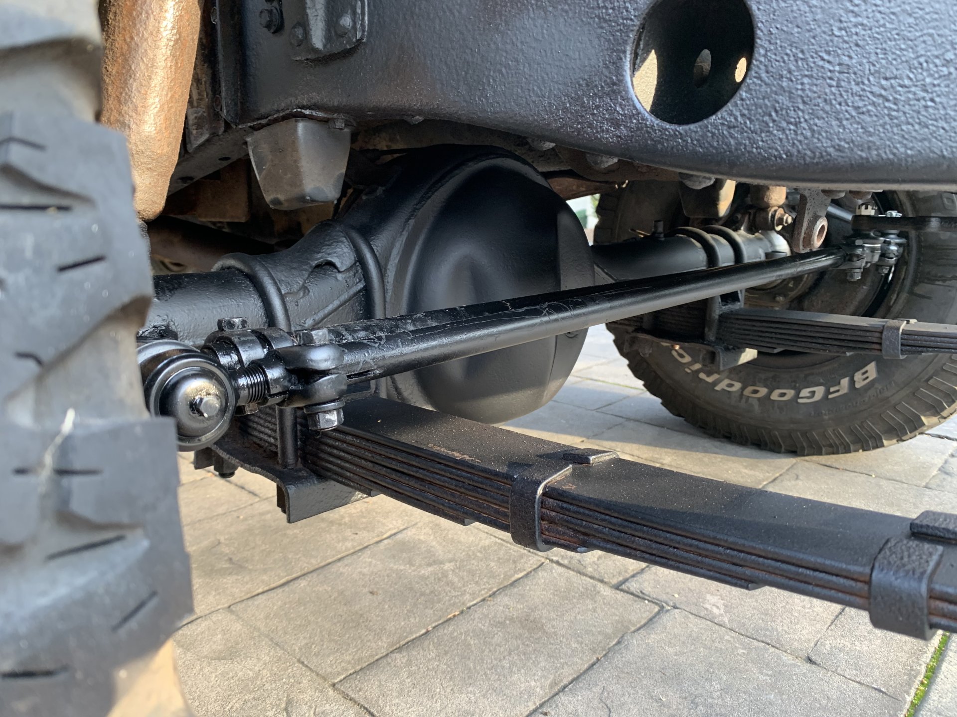

New Tie Rod Ends and lots of de-gunking and wire wheeling followed by rust coverter and then some flat black. Definitely improved the death wobble but didn’t fully cure it, maybe 65-70% better but based on the amount of gunk caked on my front end I’m fairly certain a knuckle rebuild is in order…. Hoping that will cure the final bit… and probably some shocks.
My steering stabilizer above was actually not yellow underneath all that gunk, quasi white…. And shockily still good-ish! It must be old cause it’s a Monroe that is made in America…anyone order a grease cake?
Decided to also clean up any brown glitter I could get to while I had everything accessible…. FDC Rust Converter Ultra is my new favorite tool…
After several evenings of getting messy and frustrated… sadly I got inpatient and installed the rods and ends before the paint cured so it got a bit messed up but nothing some sandpaper and another rattle rattle can’t cure
Loved seeing the brown turn to purple and then black to visually confirm the rust demons are dead…. Then some flat black to finish it off…
