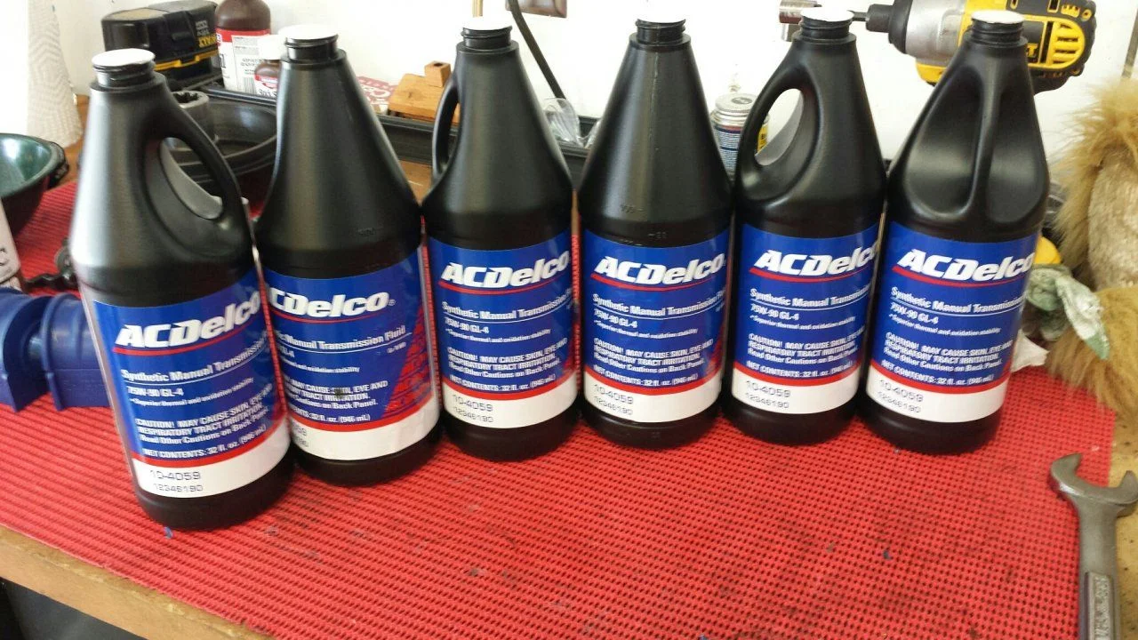

The "good call" was plan "B". I really was all gung-ho about just pulling out the T-case but she was having none of that. Came apart just fine but that tail shaft is long. In the end I can see it being the right move just because the install with the spud shaft is so easy, but :censor: I hated losing 4 quarts of oil that, even if I drained it into a clean container, I would not have reused.
It can't hurt to change the transmission fluid every couple of years, right?
IMO it's worth the sacrifice in oil to be able to work on a bench instead of under the truck.
Agree. So treated the 40 to a 6-pack today.

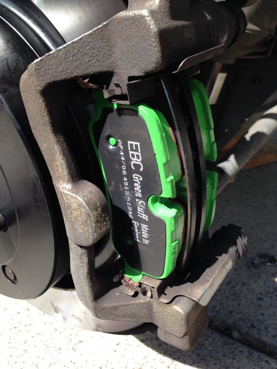

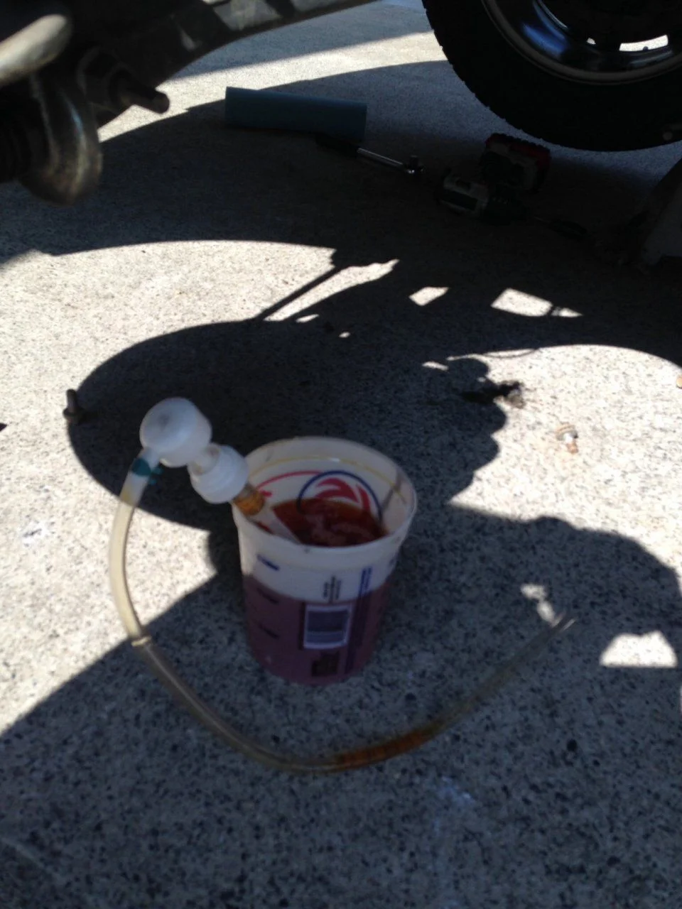

Oh man! Just finished and came in, saw the post. Anyway, this weekend was wife station wagon time, 4 rotors and pads yesterday, and differential fluids and transfer case fluid today. Land Rover transfer case was $50 for 2 liters with y AARP discount, damn! Redline for the rest since I had a case of it. These rovers don't use the fill hole as determinant, so had to engineer a measure/dispense strategy for the diffs. Next week will be tires and the wagon will be ready for the Fall. Has 57k miles.
Nice EBC pads all around and AC Delco disks
Differential fluid is captured and measured, same amount back in, no "fill until it comes out of fill hole" with these. I had this pitcher from same procedure with German double clutch transmissions work.
Using a small graduated container helped a lot, the a transfer pump to reach diff fill holes, easy as pie. So nice to work on a non rusty, clean, policed, well kept vehicle... Anyway, front diff gets 0.64 liters, rear 1.1 liters. No, no joke, overfill and die, under fill and die. And the transfer case oil is special, made from the horn of virgin unicorns, shot by American dentists. That's why is so expensive.

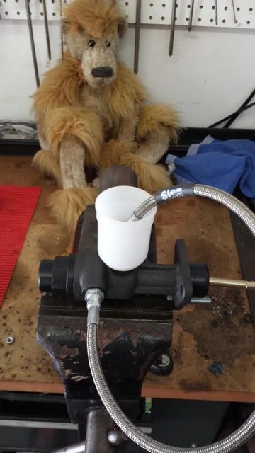

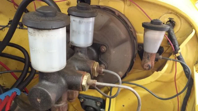

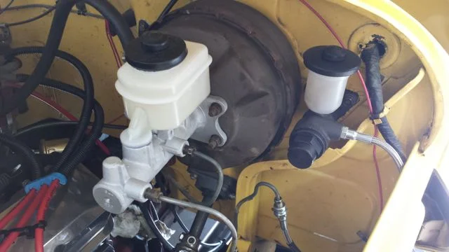

BOTH brake and clutch masters started leaking the same week. I caught the brake master early enough it didn't eat out the booster but the clutch master managed to eat some paint both inside and outside the firewall.
According to Beno no OEM option for me so had to go with Beck Arney. Just because it had the right specs (1 inch bore and residual valve for my rear drums) I went with an FJ80 brake master.
Old and leaky:
Don't forget to bench bleed.
All done and road tested.
I really like your bench supervisor ;)
