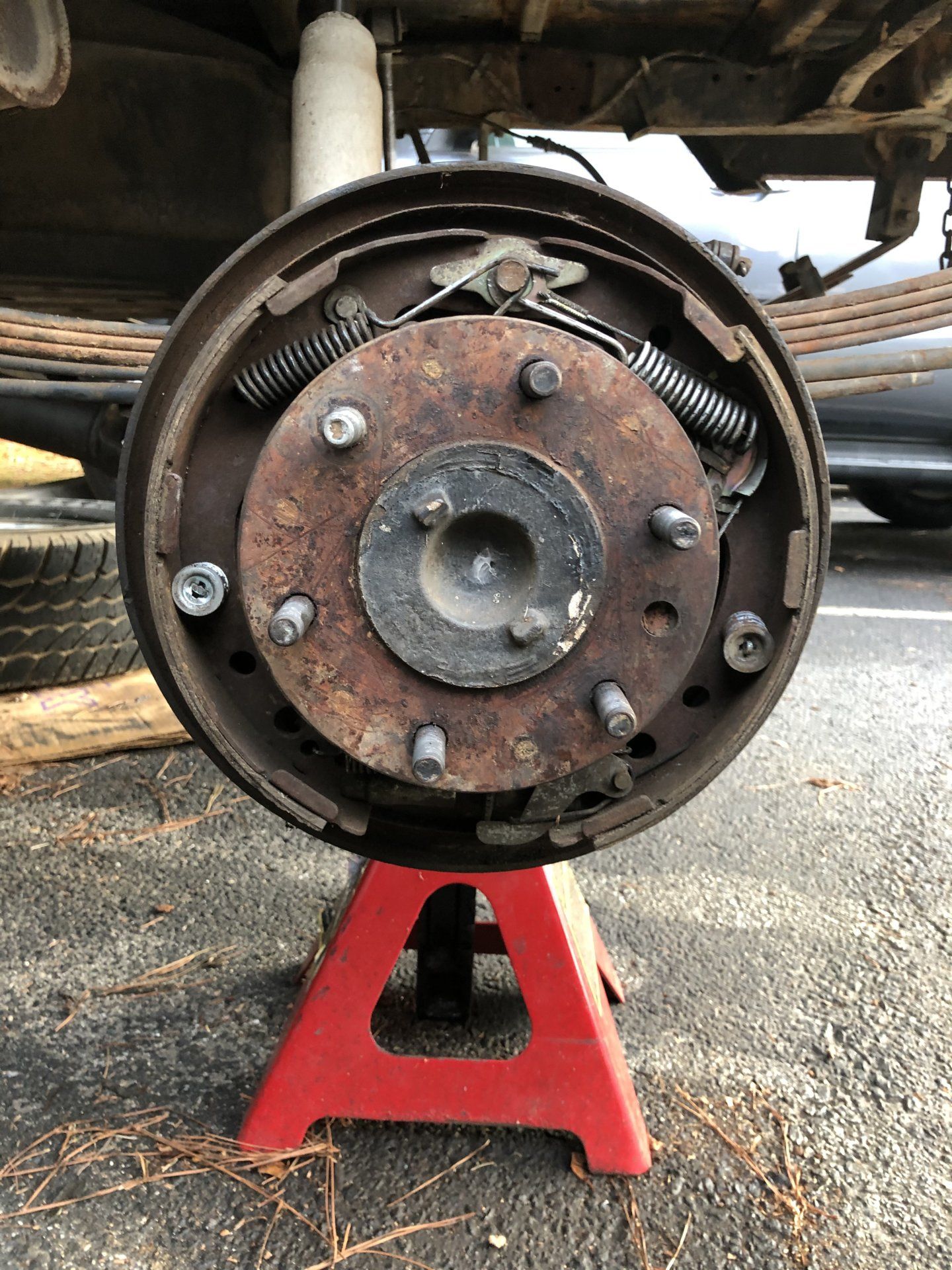

I got my brakes put back together in my truck. The brake bar in the driver side was all sorts of bent up. I found a local guy with a bunch of parts trucks and got a brand new used bar for $5. Bled them and changed gear oil while I was at it but now it won’t start, it won’t even try to turn over, tried jumpstarting but no luck, plan to check the solenoid tomorrow.

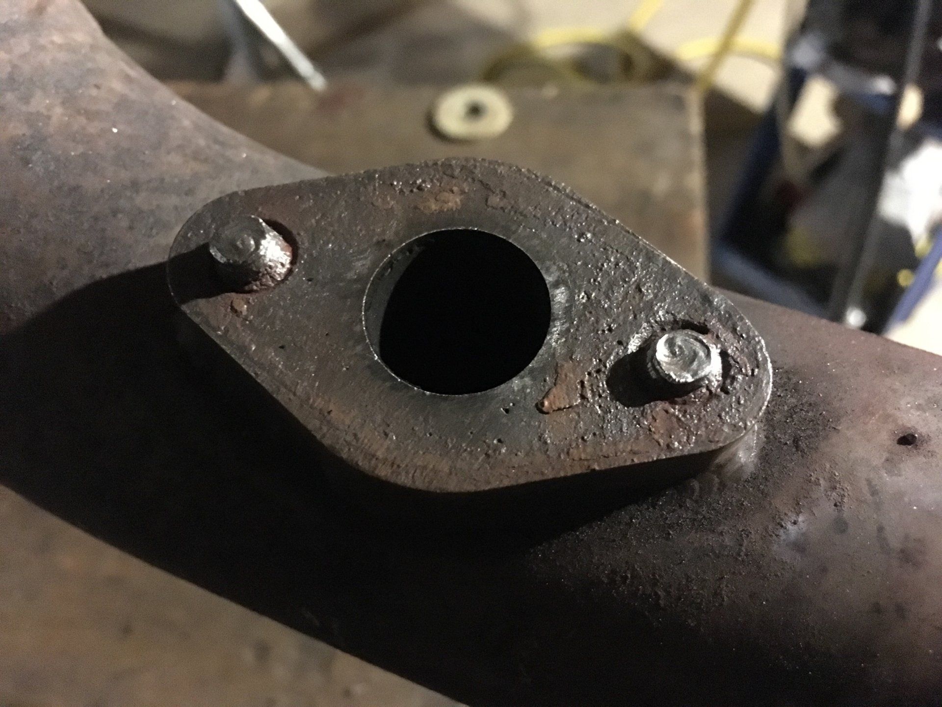

Worked over the exhaust over the last two weekends. Still have the resonator to add but stoked to get leak free with intact cat and seemingly code free. (Had been getting a PO125)
Many thanks to @GLTHFJ60 , @Rice, @rockdragster for the assistance.
New OEM exhaust manifold studs and nuts
Magnaflow y pipe into
Existing EMS with new flange
New O2’s
Time for resinator and exit bracing.

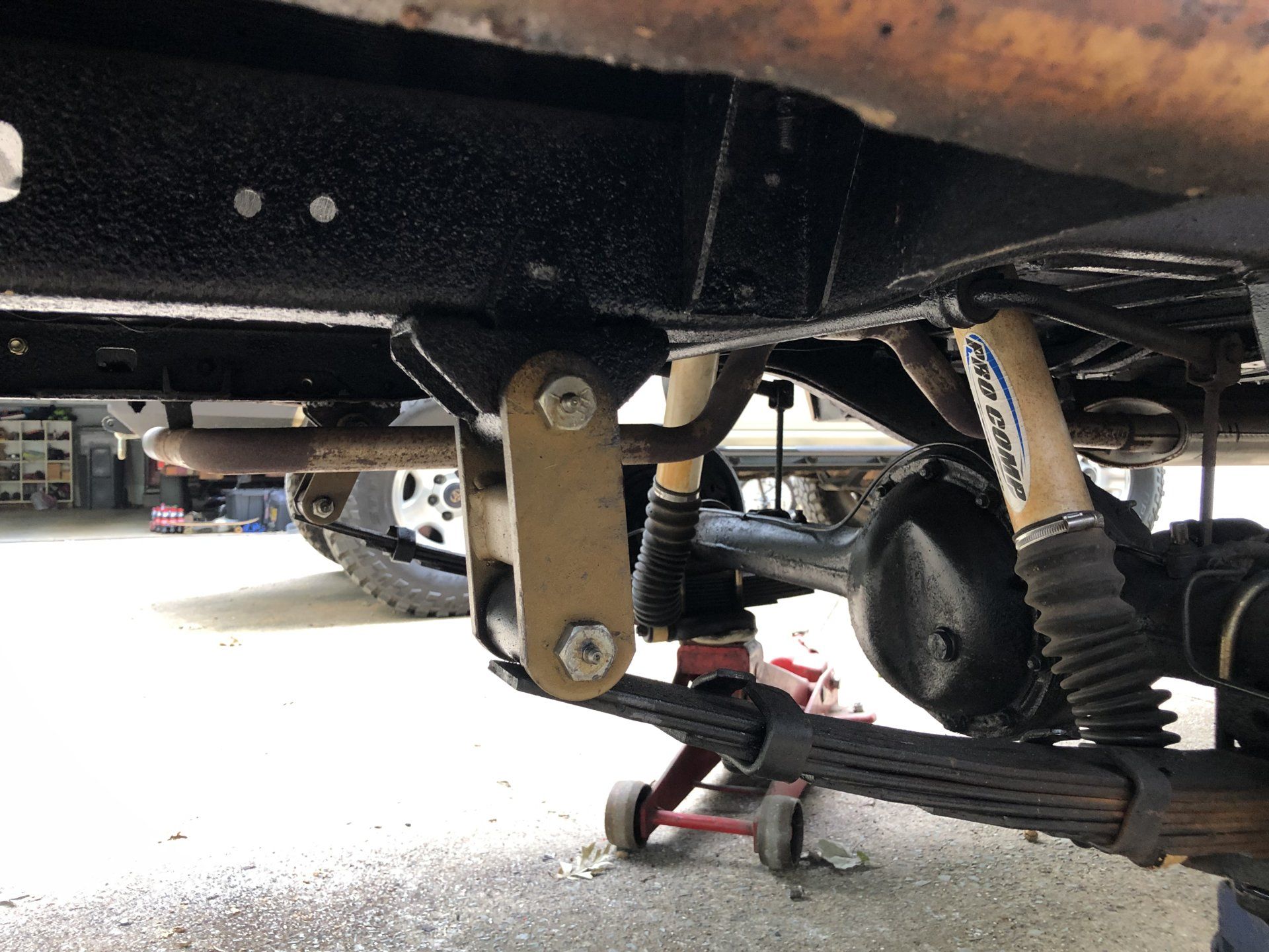

With the pig up on jack stands and tireless, I decided to do something about the horrible rear shackle angle. Apparently the Rough Country lift springs that a PO put on the truck are a little too short in the rear. The rear shackles were actually inverted by a couple of degrees, limiting flex and causing it to ride rough. I have had good luck in the past with removing a leaf from the spring pack to soften the ride and tweak the shackle angles, but this time I decided to knock off the shackle hangers and re-position. I think it will make a huge difference on the street and on the trail.
Shackle angle before:
...and after:

I’ve thought about pulling leafs out of the Rough country packs on my 40, which leaf would you recommend? I would move the shackle hanger but I have things in the way.
@40LandCruising I would pull the leaf just under the one that has the military wrap. I would assume that it would be the third leaf down from the top.
First leaf has spring eyes on both ends. Second leaf has military wrap on spring hanger side. Third leaf should be a flat leaf. It may have some clamps attached to it and you'll have to decide how to deal with those. Either cut them off or bend them back to allow the leaf to be freed from the pack.

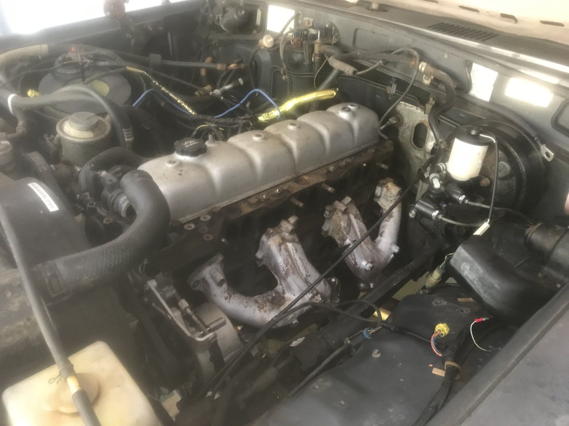

Now that I’ve Been in the new house 2 weeks its time to get to work. The night before I shipped the 62 it blew the HG on the way to @AJR to return some 3FE parts I had borrowed. Side note; if you need any 3FE goodness he’s your local go to.
I had the concrete floors sealed last week so I could wipe up oil coolant etc so Yesterday I finally started disassembly.

Pulled the 62 head last night. A local member stopped bye to give a hand pull the head. Even donated a HG.
