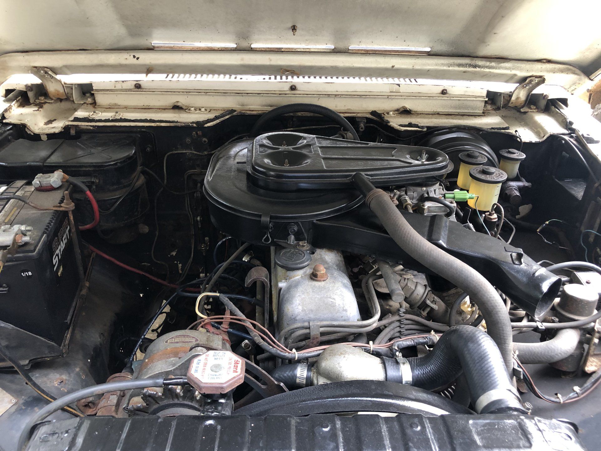

Well seems instead of anything being wrong with the 80 I’m just blind. Was looking around for vacuum leaks when I saw the bottom spark plug wire had come loose from the distributor cap. Plugged it back in and she’s running good as new.

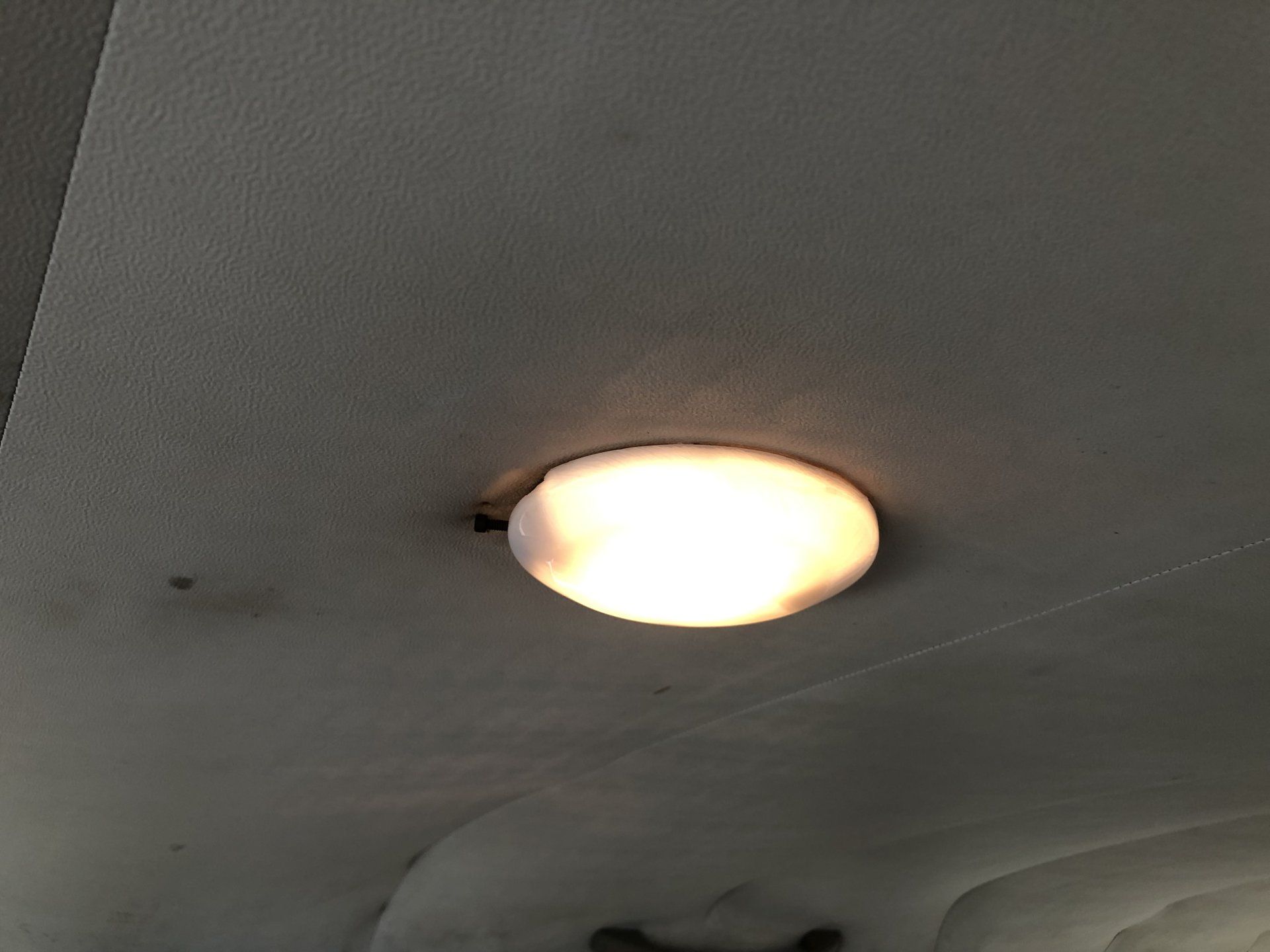

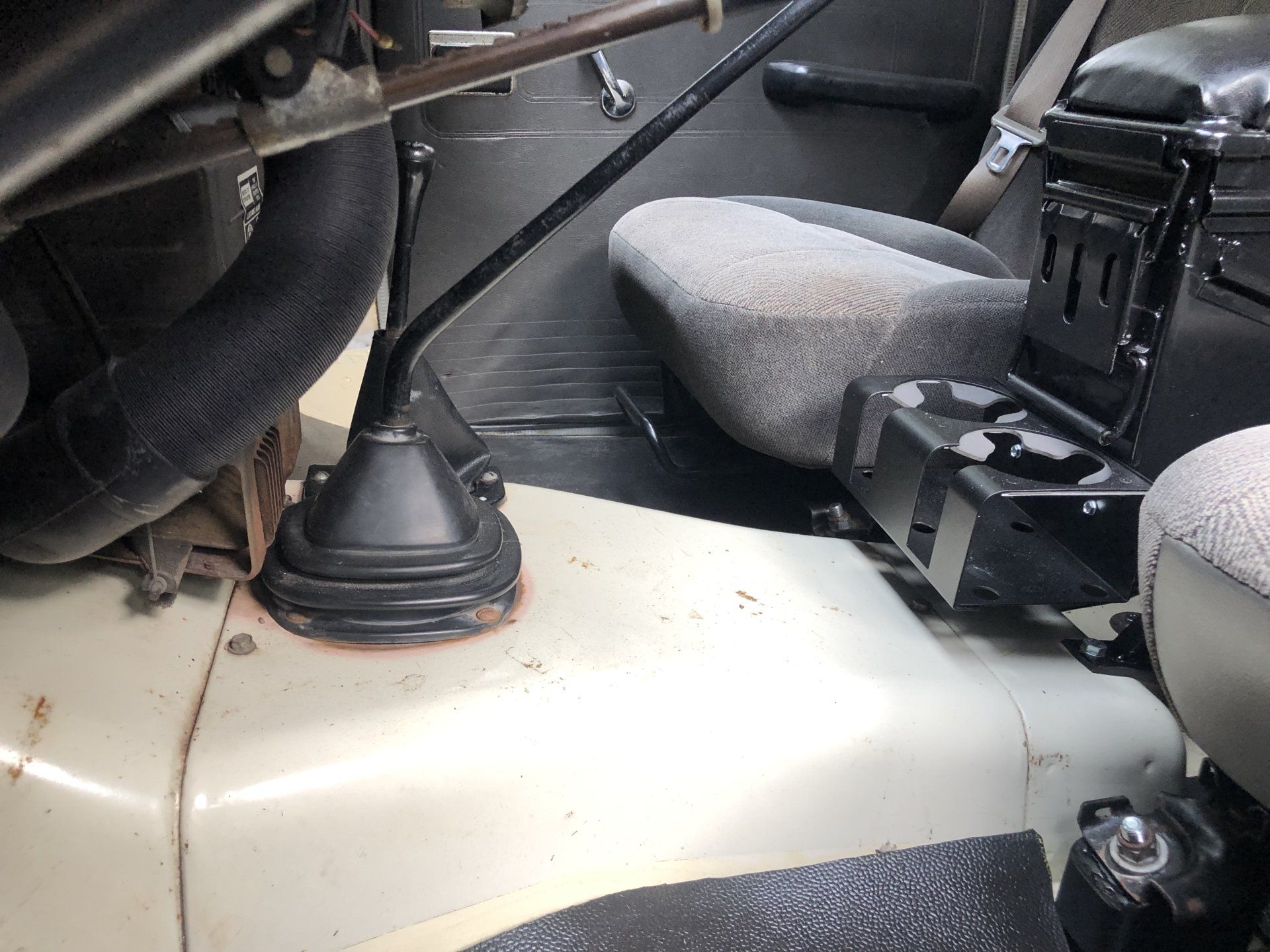

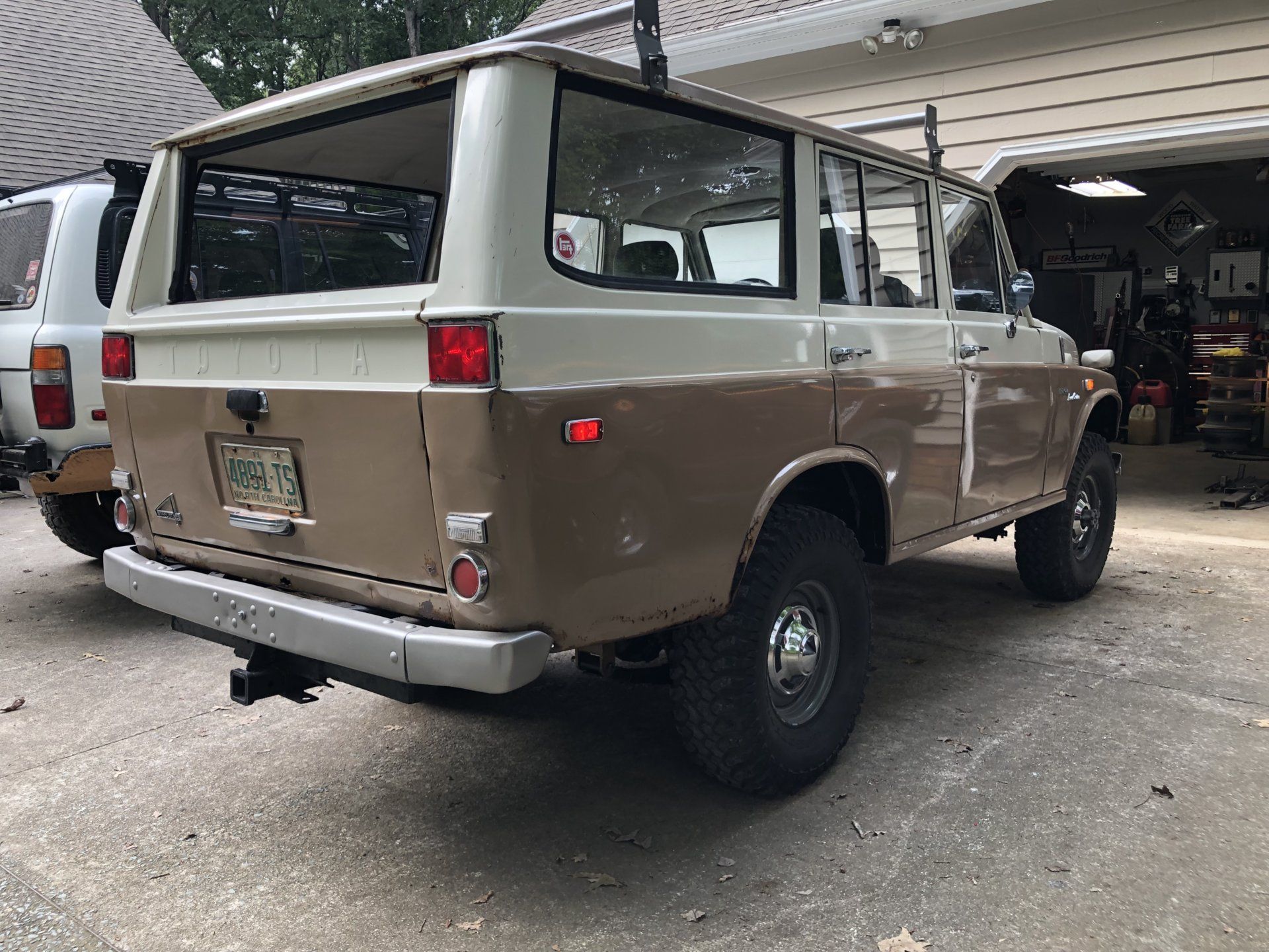

Bucky had an exciting weekend. I replaced all the coolant hoses, flushed radiator, fixed horns, got all the lights working (including the dome light), replaced fuel sender, new wiper blades and cup holders. Just got it tagged and insured. It has taken me a year to get to this point but I'm happy to say that Bucky is now a man about town!
View attachment 2056911View attachment 2056912View attachment 2056913View attachment 2056914View attachment 2056915

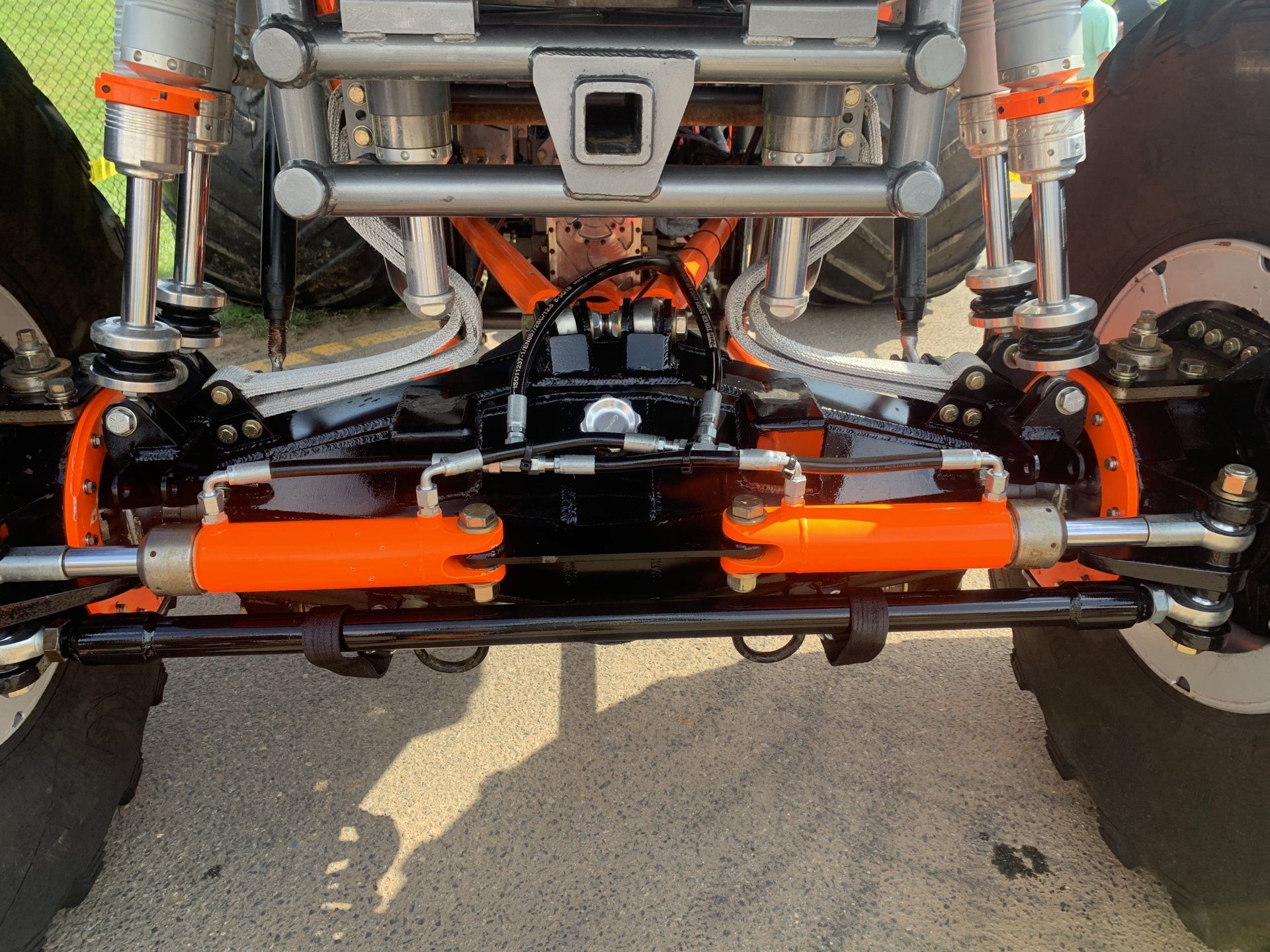

4 link too? What type of hi performance tractor you wrenching on ?!?
Doubled up limit straps? Smells a lot like like monster truck.
I was at the monster truck bash. I really wish i could drive one of this things. I don't know who has more fun if max or I.

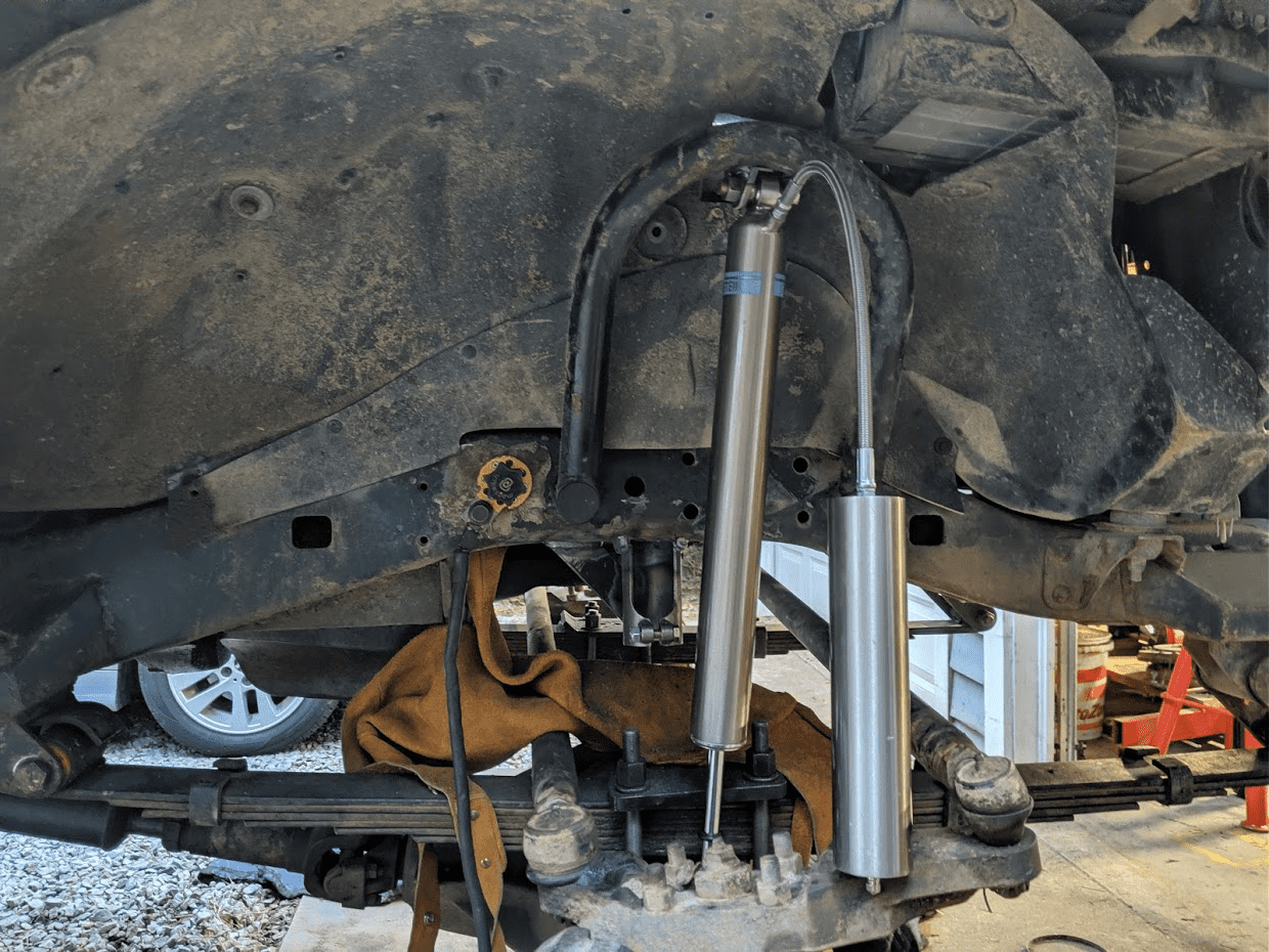

Time for fresh springs, shocks and bumps.
