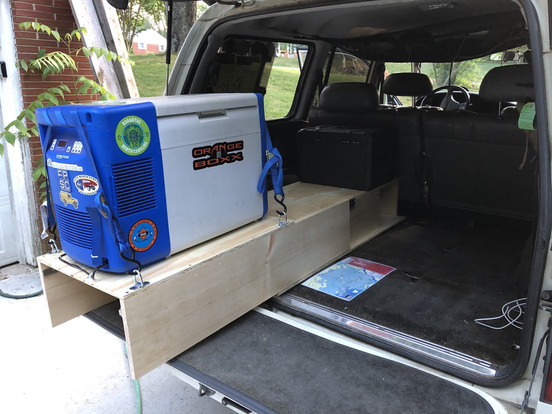

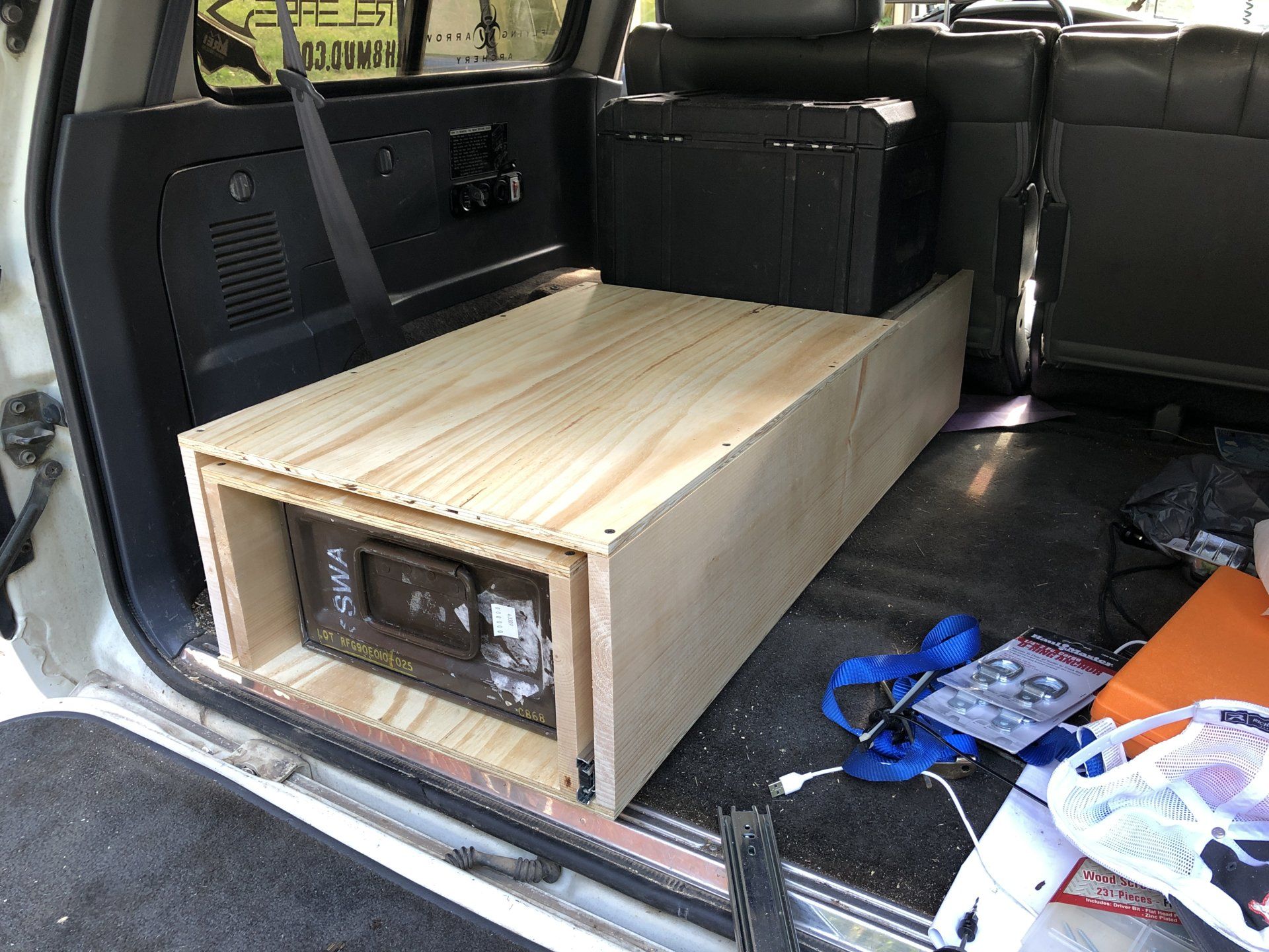

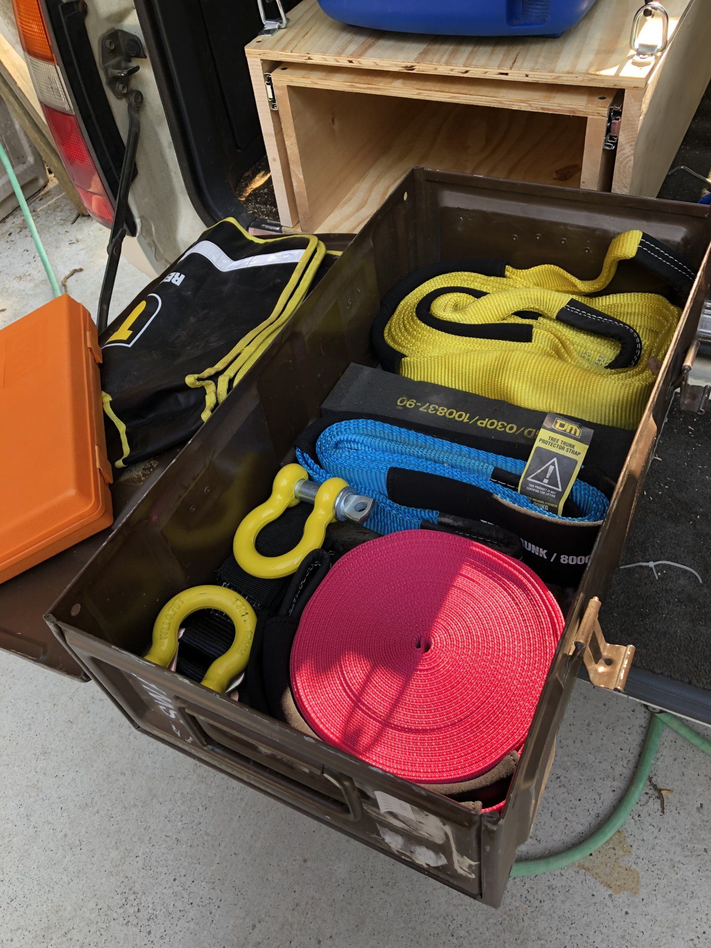

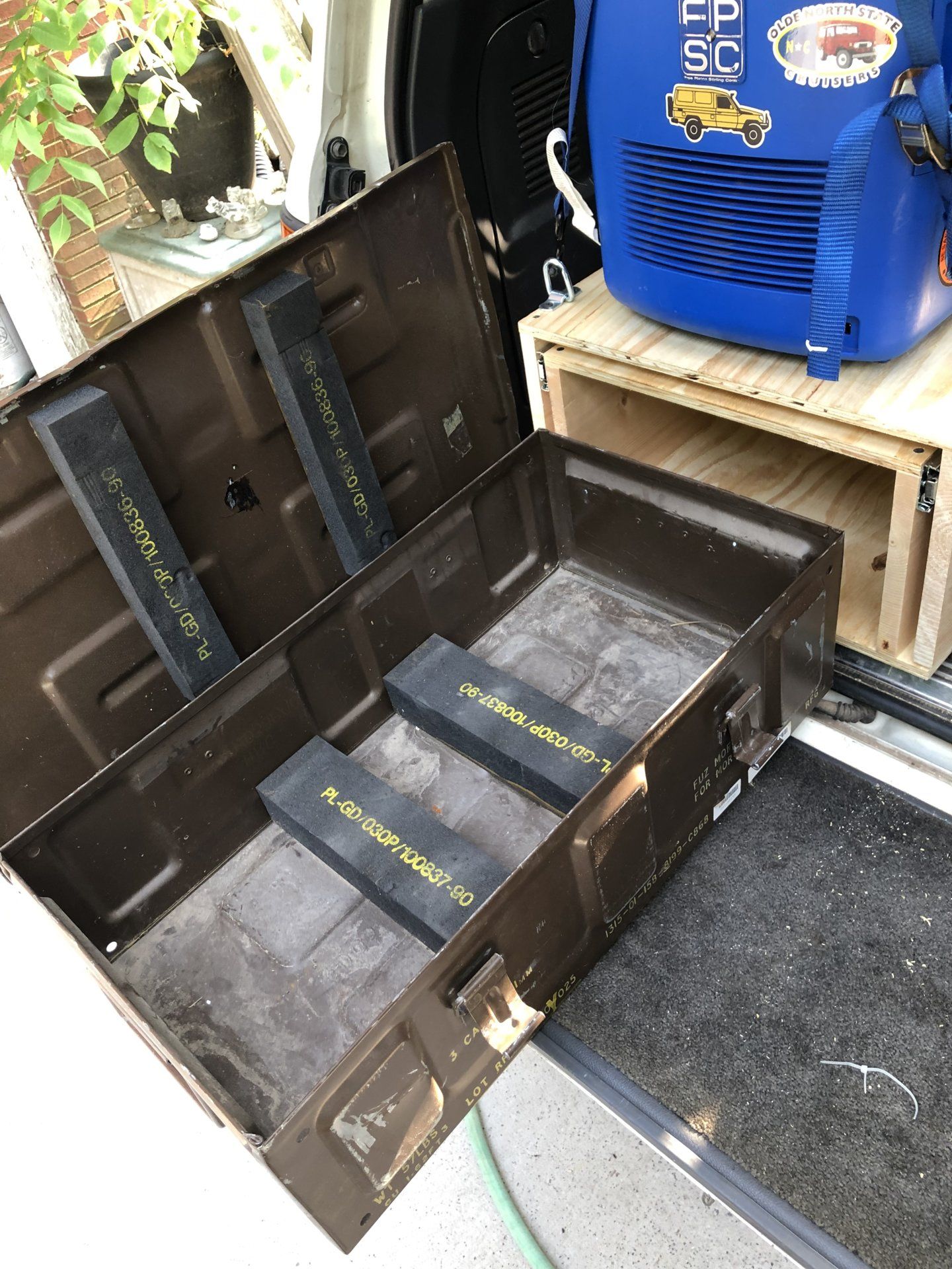

Almost hate to post after seeing Dave’s work but here was a little Sunday project. Still need to mount to the floor and tweak it some but relatively happy. Tired of having multiple bags and boxes holding all my junk.
That's backwards from most sliders we see, wherein the top slides out and the inside stays put! Very cool man.
Thanks man. definitely a work in progress and I'm sure it'll be adjusted and or changed several times. I wanted to keep it small if that makes sense but the primary purpose for me was to "stash" the recovery gear and be able to get the fridge out easily. I'm going to add another set or slides. yeah they're 100lb slides but another pair would be more gooder. ;)

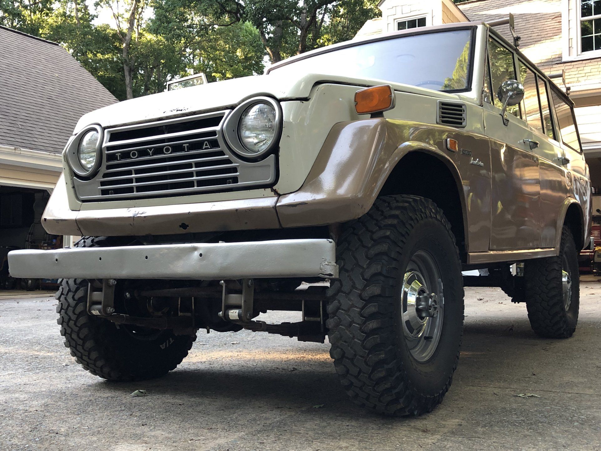

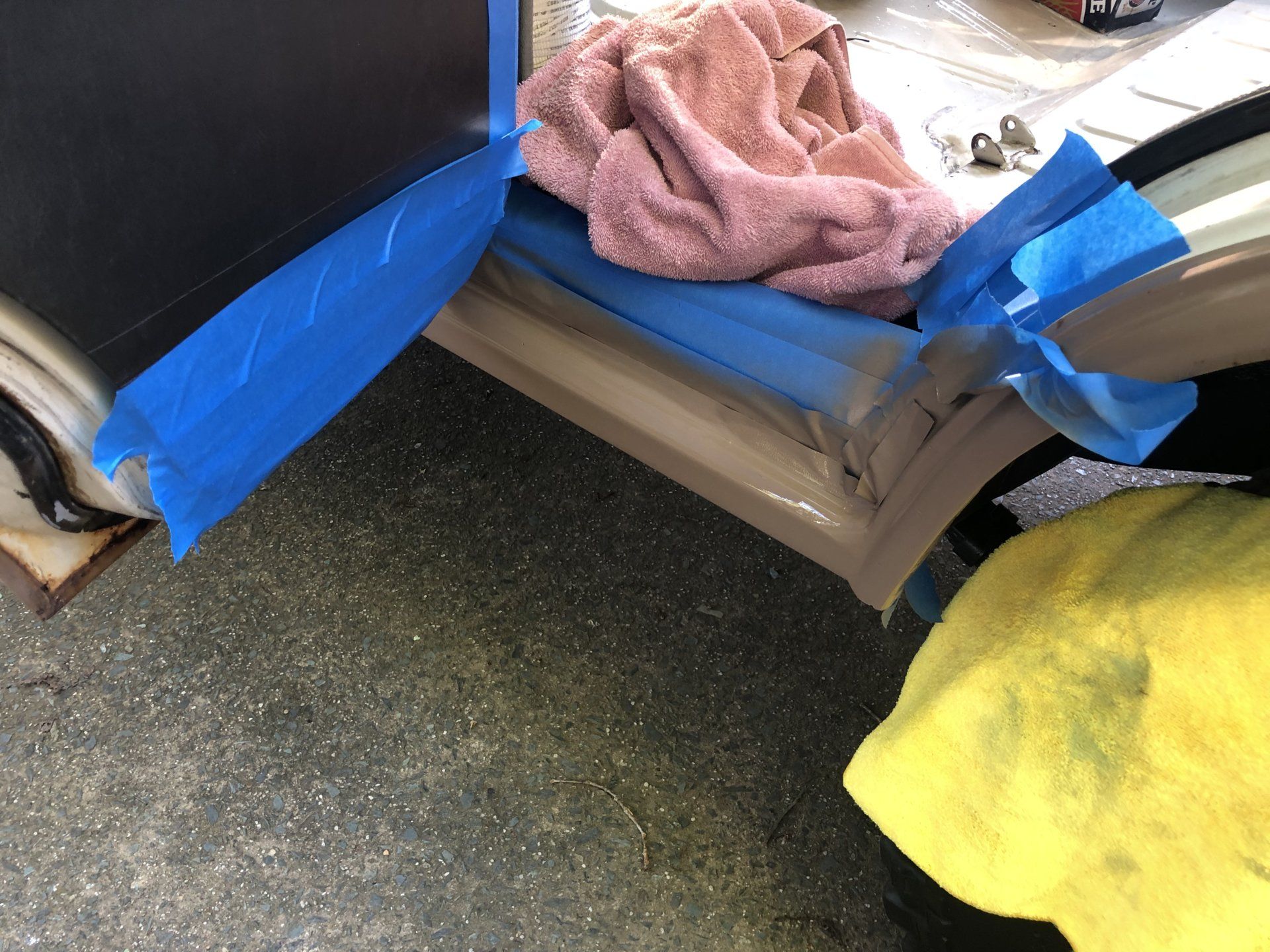

Bucky update: I blended color matched rattle cans from the local paint store to cover my patch work. Driver’s side is as done as it’s going to be. Working on passenger side next. What’s fun about a project like this is that the truck was so bad that even my piss poor body work is a huge improvement over what It used to look like. My goal is to not pull a single dent, only patch what is absolutely necessary and paint only the areas that I patch. The old paint just has too much character to cover up the scars. Nathan is in love with this rotten old pig by the way.
Did you just bring a piece that you cut off with paint still on it to the paint store to have it color matched?
I want to do this With my 40. Just color match the patches until I can repaint the whole thing at a later time.
I took off the gas filler door and had them to match it. Match is just okay. Not great. Good enough for this truck though. The easiest piece to pull off of a 40 for paint match is a kick vent.

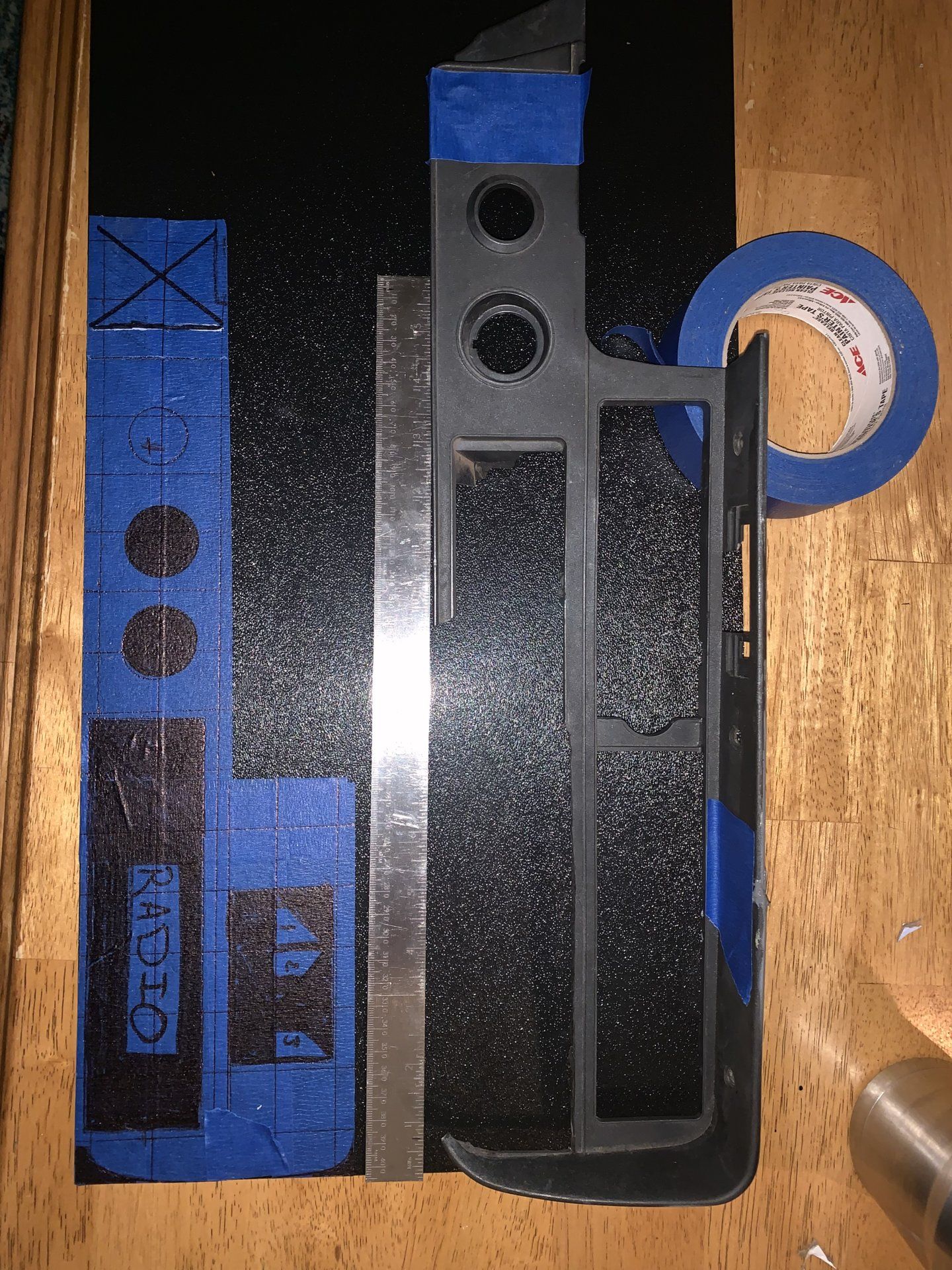

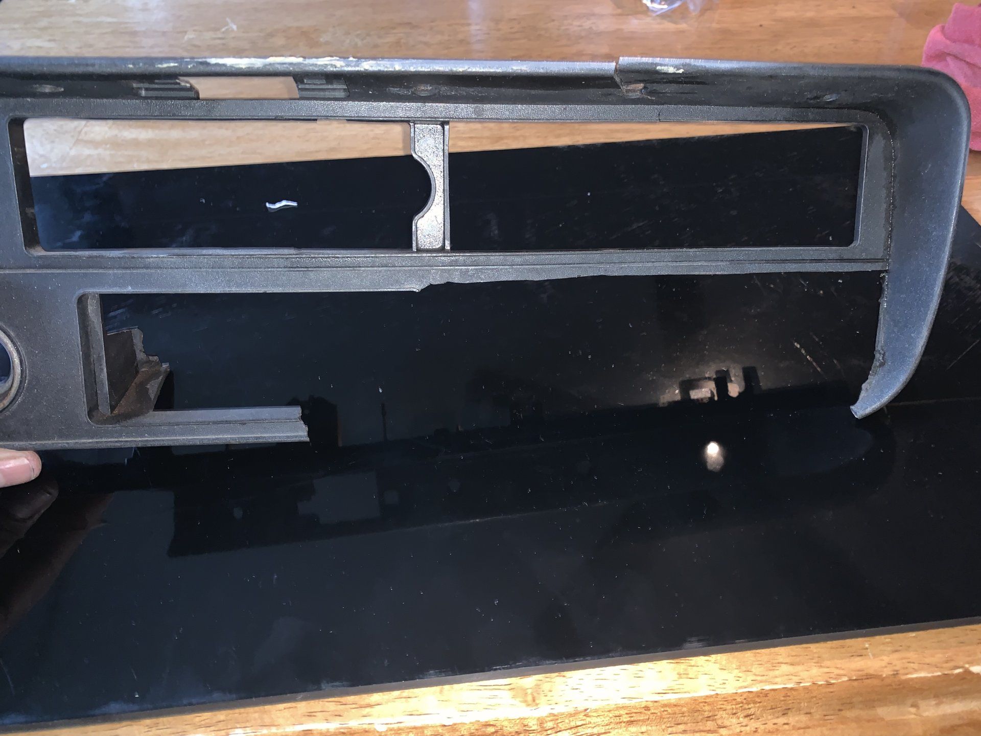

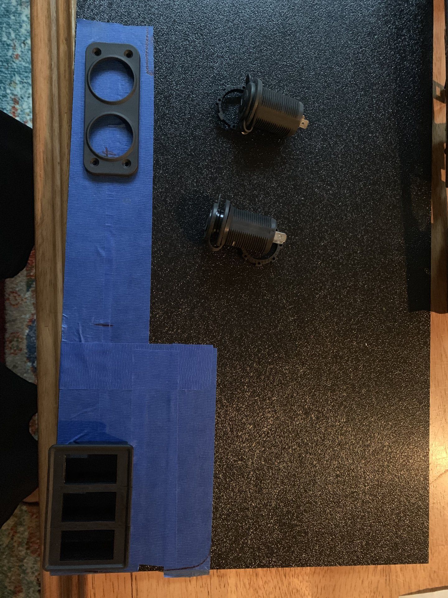

The center of the dash on my first gen is broken. I have one that is not broken but decided to make this one work.
I want to install 2 power points.
3 switches for the ARB lockers and compressor
Then I remembered I bought a $25 radio at Walmart when I first bought the truck and decided to try to fit in as well
This is the final layout.
I still need to cut it and glue the two pieces together but it will have to wait a few days until after my surgery tomorrow.
I am using a 24”x 12”x 1/4” thick piece of ABS plastic
I ordered it off amazon for $7.
I am going to try to use PVC glue to glue them together. If that doesn’t work I will use JB weld or liquid nail. Then spray bomb it if needed.
I ordered the 1/4” thickness so it will hopefully reinforce the stock piece which are super flimsy.
That’s why I am testing it on this one since it’s already broken.

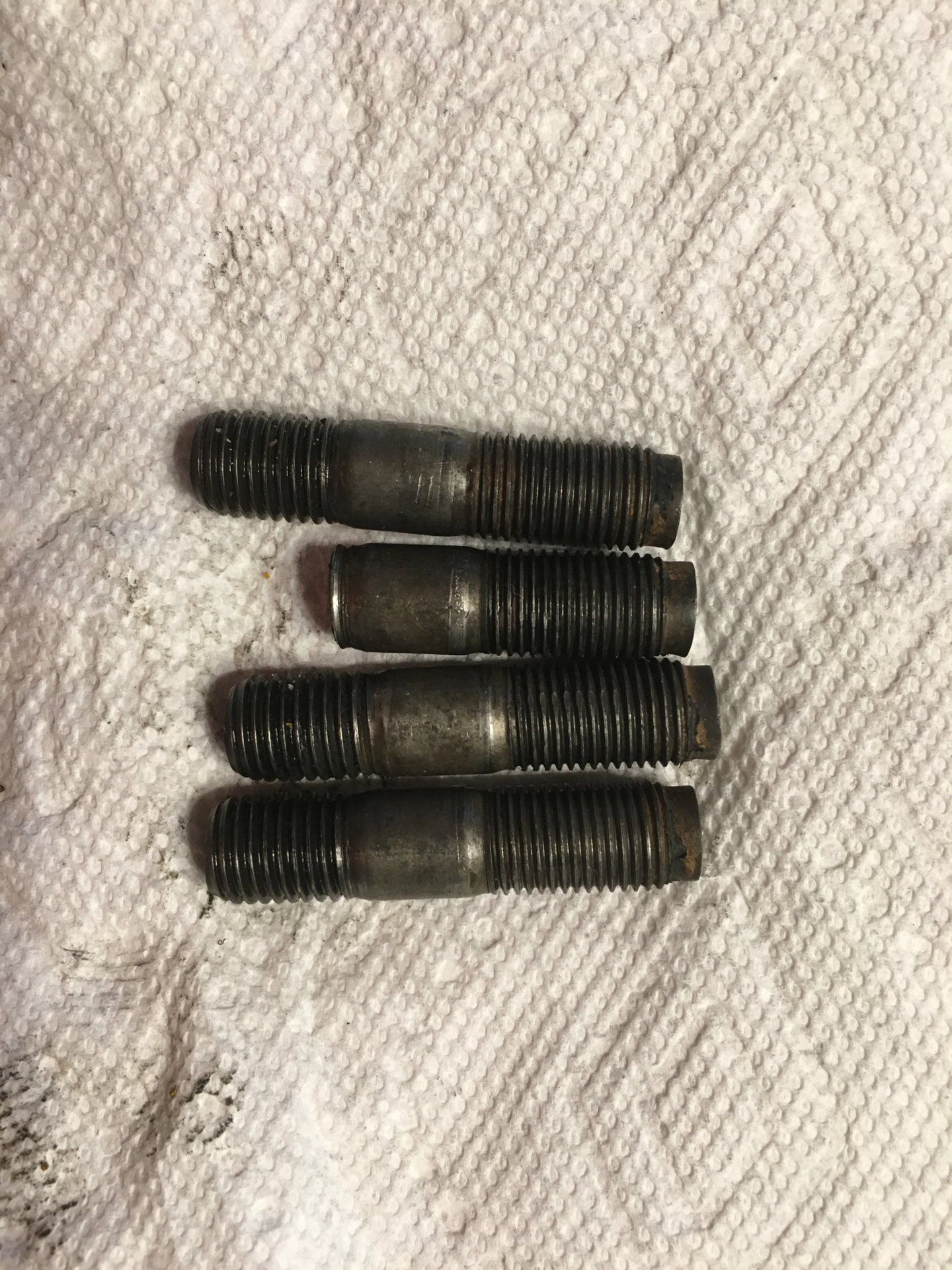

These are the lower knuckle studs on the passenger side. I was finishing up a knuckle rebuild. Guess where the other part of that stud is?
2012136
I'm just glad this didn't happen on trail.
