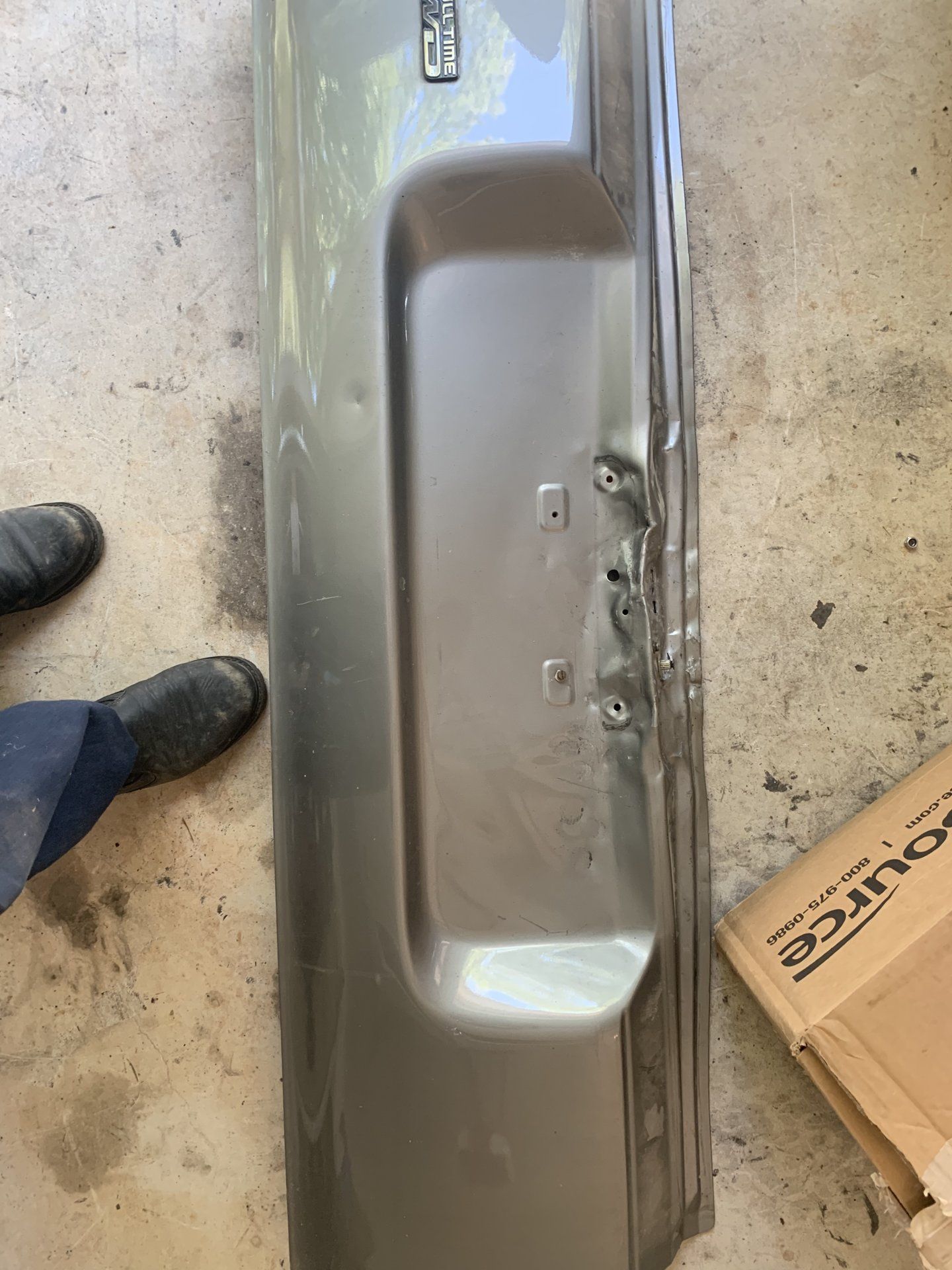

Some people call it trail marks. This was product of my stupidity. But it is fixed and painted. I don't take credit for the paint. Just installed and adjusted the door.
