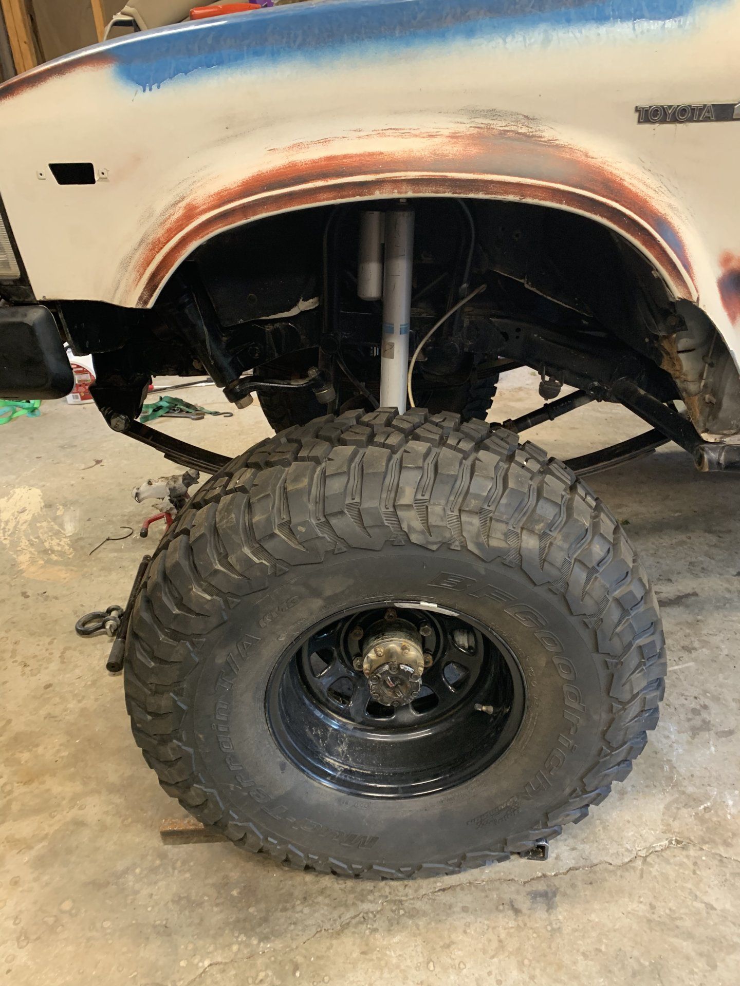

Hard to tell in the picture but managed to install the new 5” springs in the front. The new springs gained me 5” on top of the 2.5” lift that brand new old man emu springs.
She is going to be pretty tall but I needed to gain at least 3” to keep the 35” tires from rubbing the cab.
The rear springs will have to wait a while.

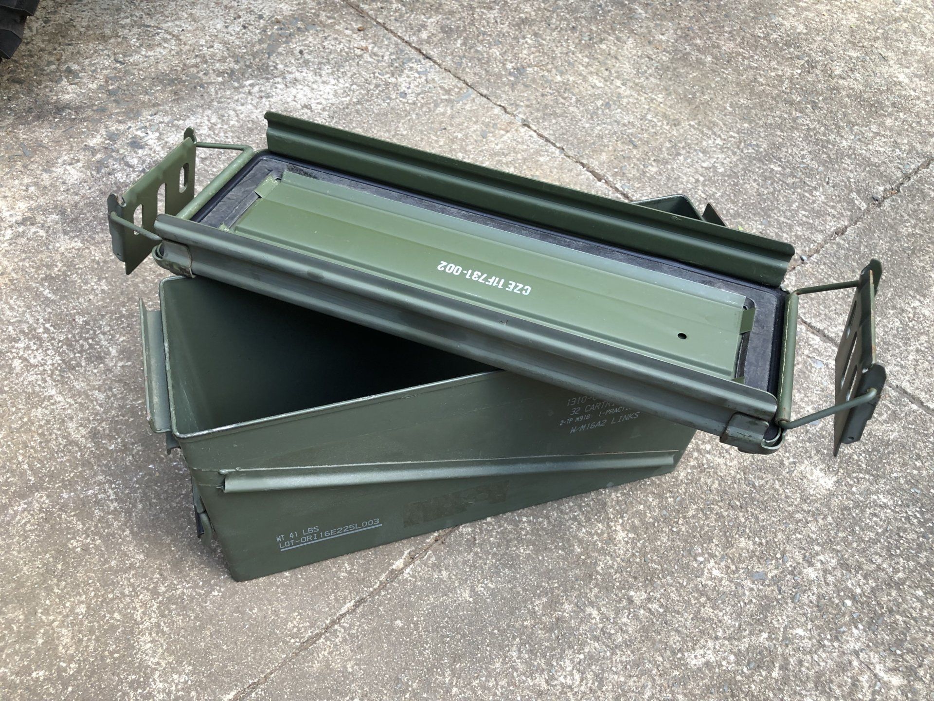

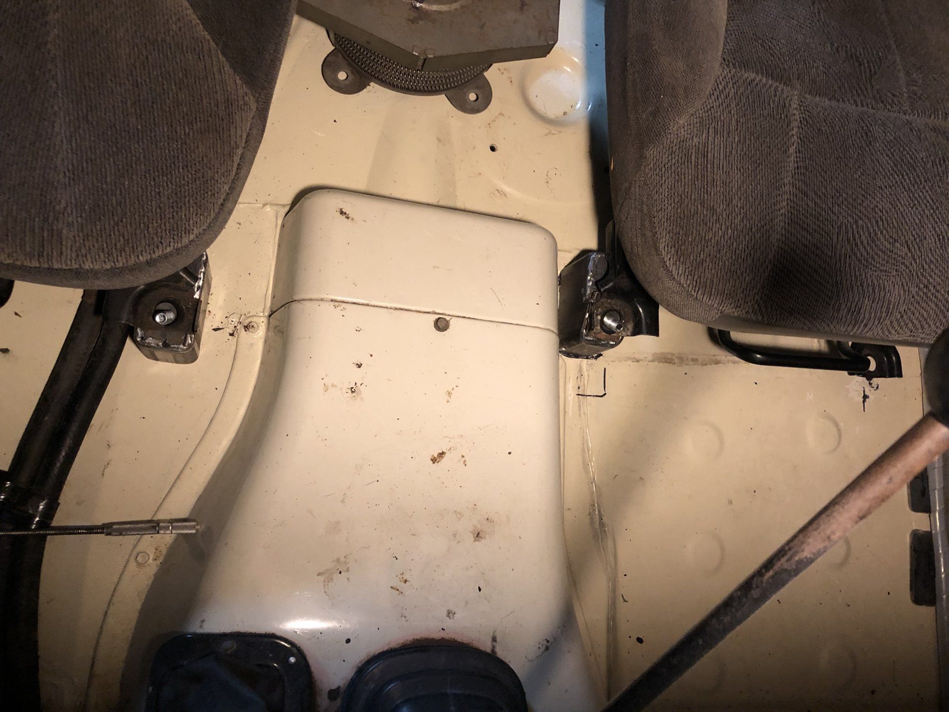

Bucky update: Chevy Trailblazer seats installed with brackets I fabbed up. The seats have integrated belts and are super comfortable. New mats cut from a 4x8x1/4 sheet of work mat from Home Depot. Relocated rear heater. Fabbed a console mount for a modified ammo can console.

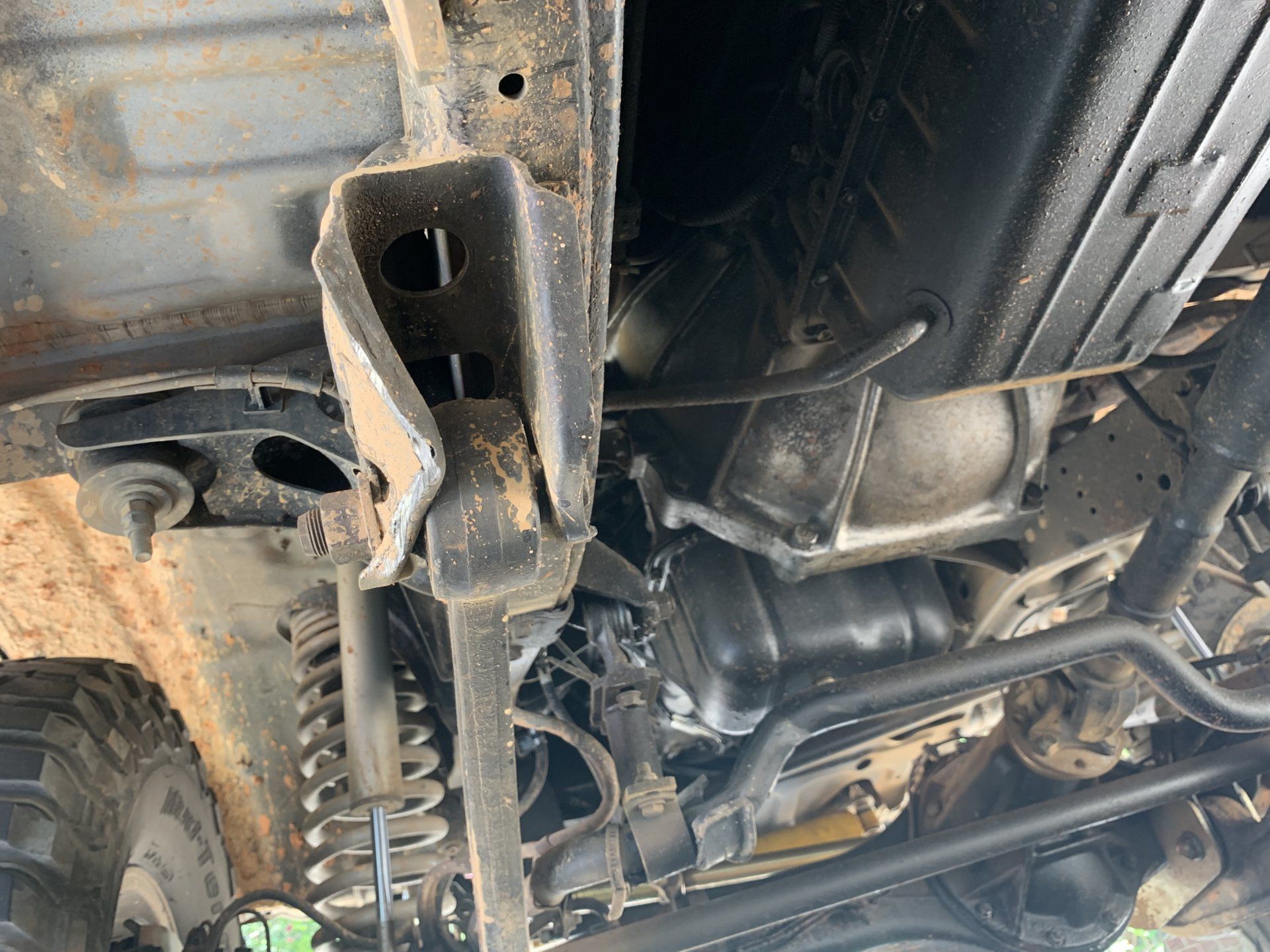

Anyone have any idea how I’d go about fixing this? I smashed it on a rock and Uwharrie and it stops the control arm from moving down at all. Not experienced with metal stuff and it’s pretty thick so can’t be hammered out. Any help would be awesome
thats gonna be tough. I actually believe that part may be available from toyota but thats a cut and weld RnR situation.
Id try and pull the control arm and use a 6' landscaping pry bar or similar to massage back into position. Caution not to distort the other side. Heat may be of benefit. I have seen other builds cut that out and replace with trapezoid of like shape (usually to move the hole an inch or 3 forward) Ill see if I cant find a pic. Maybe try Redlines tale of two cruisers thread; pretty sure they made their own plates, but again a cut and weld issue.

That’s what I figured. I’m gonna try and pry it back into place but if that doesn’t work I have a couple buddies with welders so I guess that’s my only other option.
Some day I’ll 3 link it. As a broke 18 year old that however is not an option at the moment haha
Mine look a lot worse. But hey, they still move as needed, so I haven't done anything yet.
Heat and bend like @jfz80 said. That should get it out enough that the control arm can move again. Don't concern yourself with making it perfect.

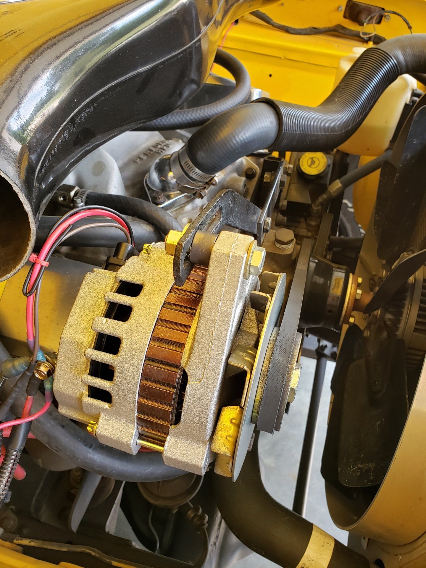

Not worthy of its own thread but there may be a few folks that are currently running a GM charging system or one day wish to convert.
Here is the back story.
When I did the original engine swap on the 40 the alternator I went with was a high output (140 Amp) 10si unit. "10si" is a family of alternators introduced in the 1969 corvette and installed in a majority of early model GMs. They never came as 140 Amp units but several aftermarket makers filled the need. Issue .... it did great and lasted almost 20 years but it produced a fair amount of electric noise and the output at idle was poor.
Last week the old 10si finally died and while a rebuild wouldn't be a big deal I thought it a nice excuse to perform an upgrade.
Goal: Convert 10si charging system to CS130 charging system.
With the advent of more car accessories GM needed a better alternator. One that could produce cleaner electricity, had better cooling, better total output, and better output at low RPM's. What replaced the 10si is the CS130 (and later the CS144).
The unit is smaller but if you grab the correct part # the bracket bolt pattern is the same. Here are the details:
Part number: AC Delco 334-2355A (One application is a 1990 Buick LaSabre 3.8 liter).
Maximum output = 105 Amps
Output at 2000 RPM (Alternator RPM, not engine RPM) = 68 Amps. :bounce:
So, Job one .... head to the store and let the young one watch the awesome conveyor belts:

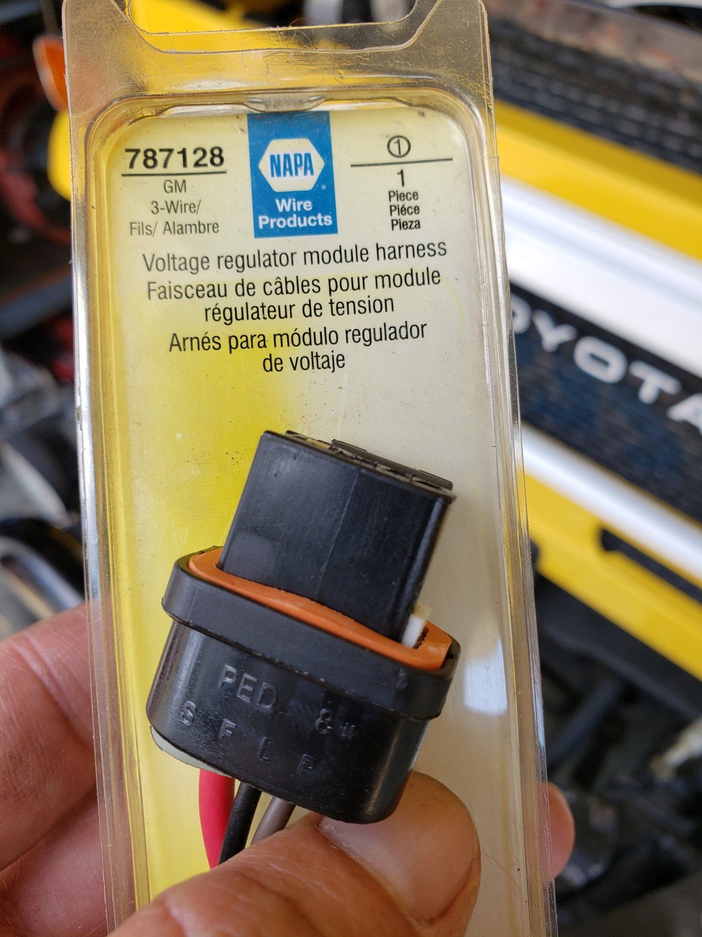

While you are there you will also want to pick up the connector that will allow you to make an easy connection from the alternator into your harness. Here is the part number:

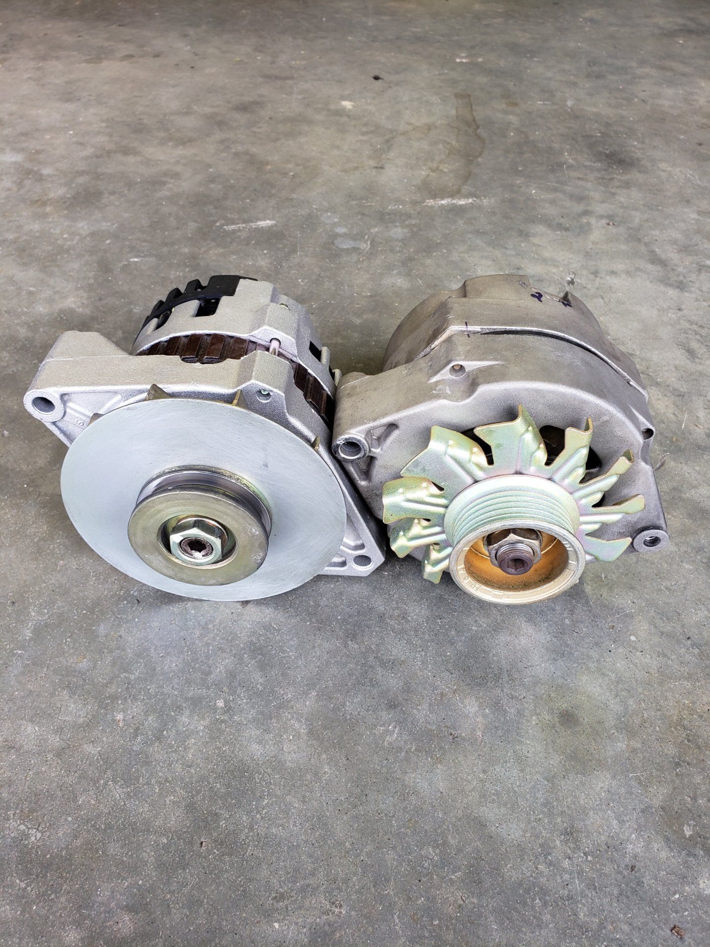

Because of my old school V-belt setup I needed to swap pulleys.
CS130 on the left, 10si on the Right:
After bolt up and changing from old style to new style connector:

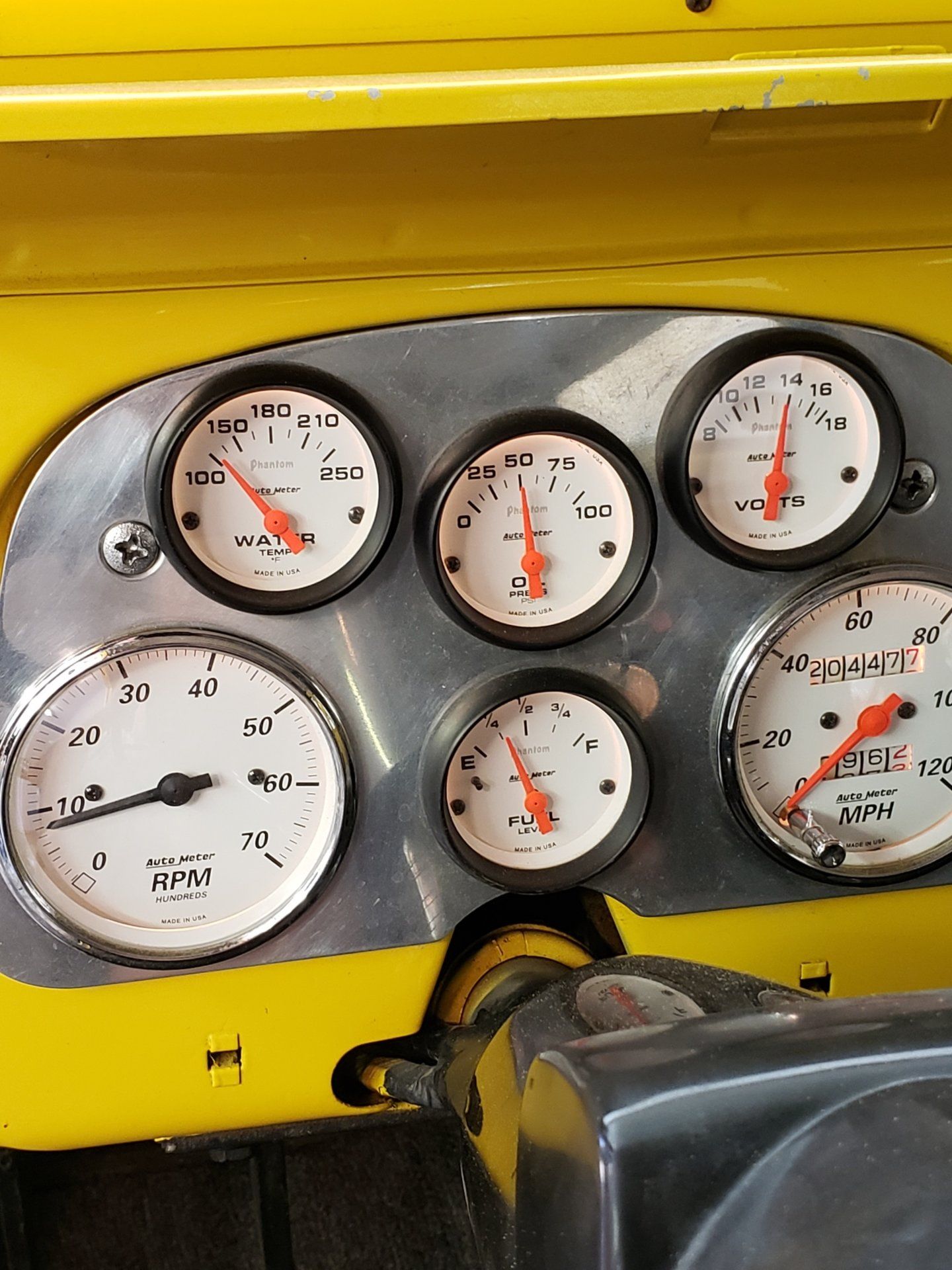

And for the best part ... Engine idling at 800 RPM, turn on the lights, and the voltmeter didn't budge.

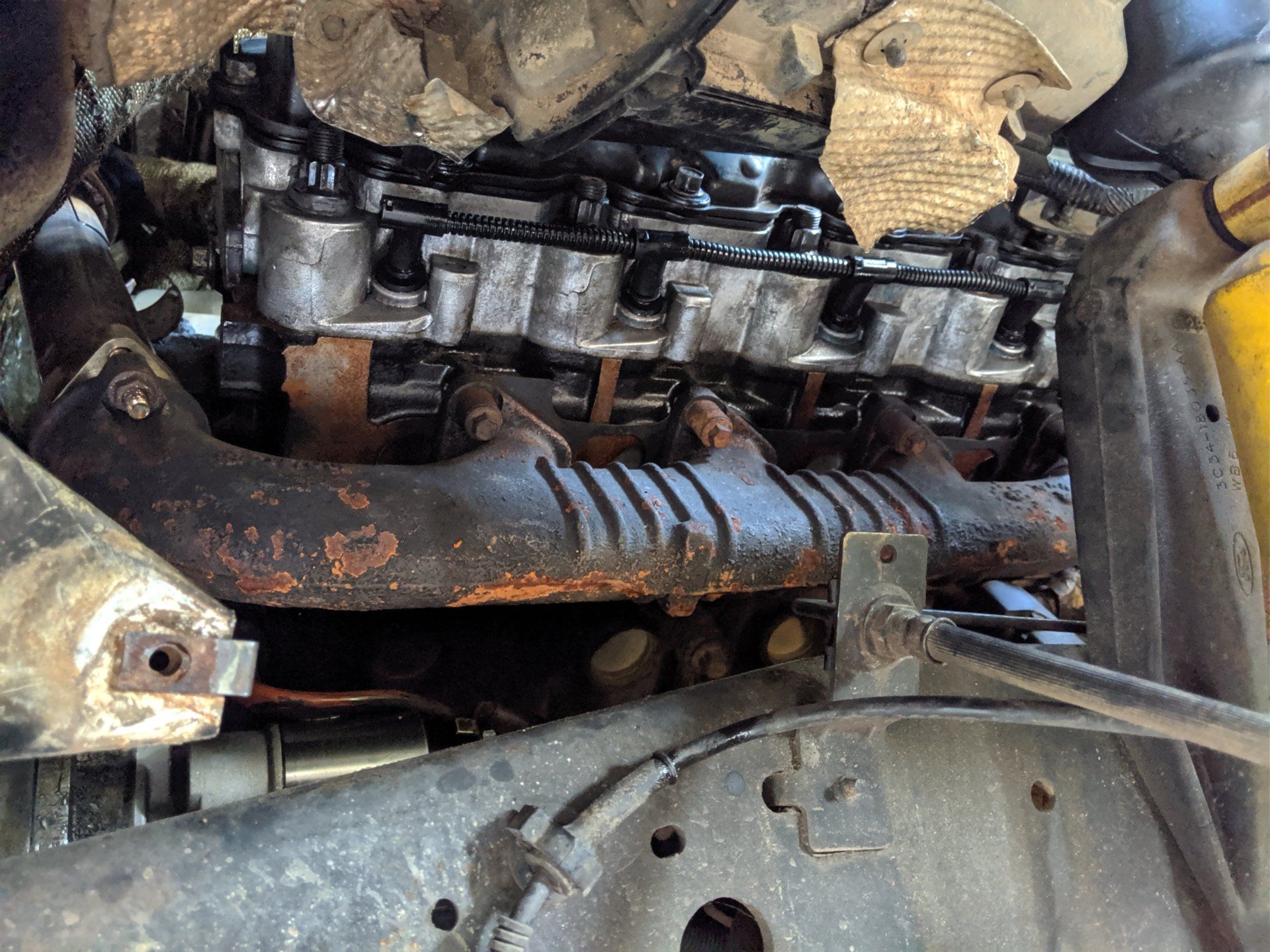

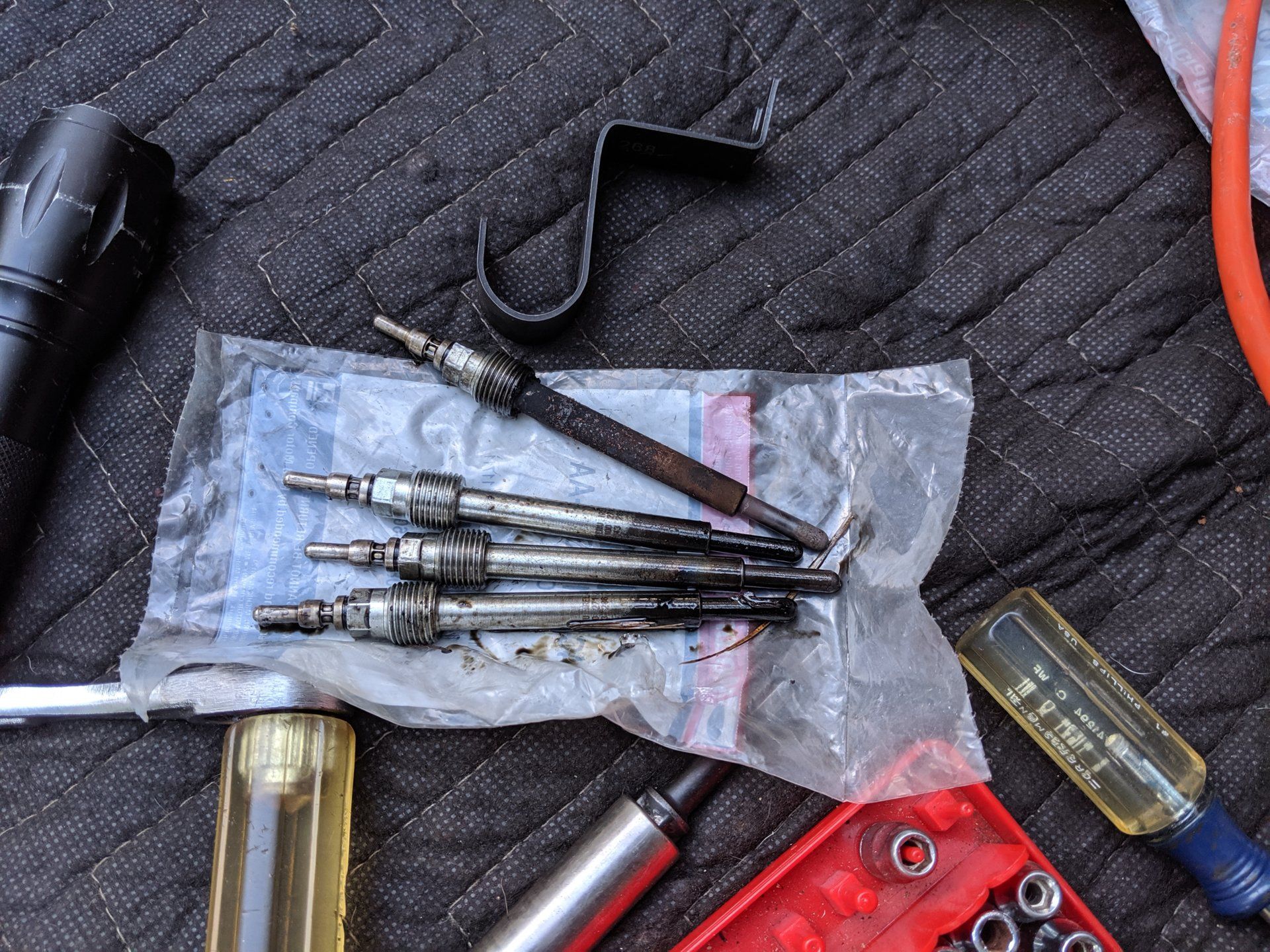

Ferd got new glow plugs today in hopes of easier cold weather starting, to help preserve this new starter.
Not too bad of a job. Ford manuals say to go in through the top, but I found it easier to remove the inner fender skirts.
As evidenced by the three wet glow plugs, these three were not working. The remaining five glow plugs looked normal, as the fourth in the pic.
Test start this evening produced a somewhat quicker start with less smoke, but the real test will be this fall/winter.
Here you can see the glow plug boots at the bottom of the passenger side aluminum rocker cover.
Here are the four plugs from the passenger side.
