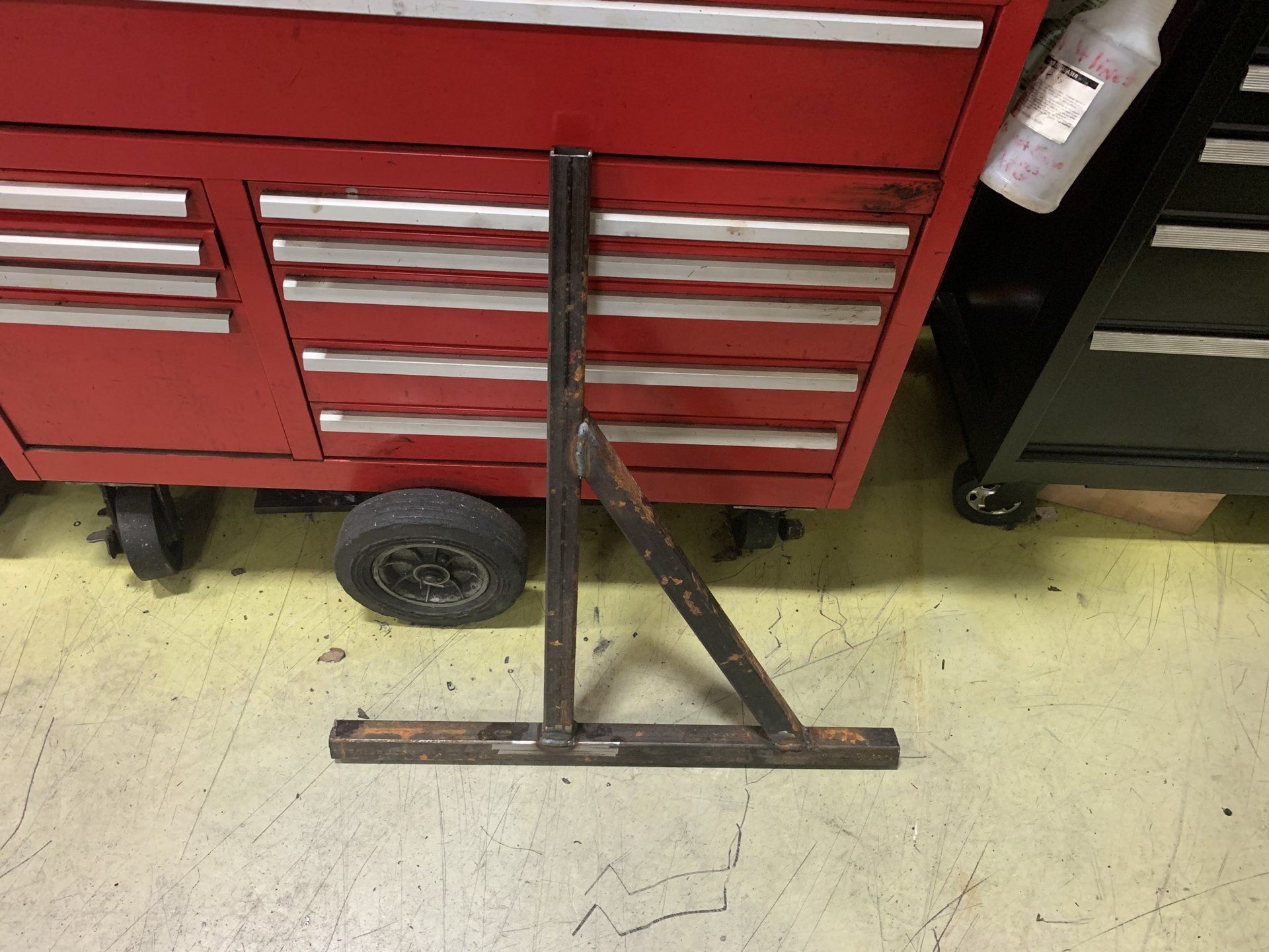

Found some scrap metal and got to do some welding, gonna see if I cant get it together while I still got the stuff here at work to use.

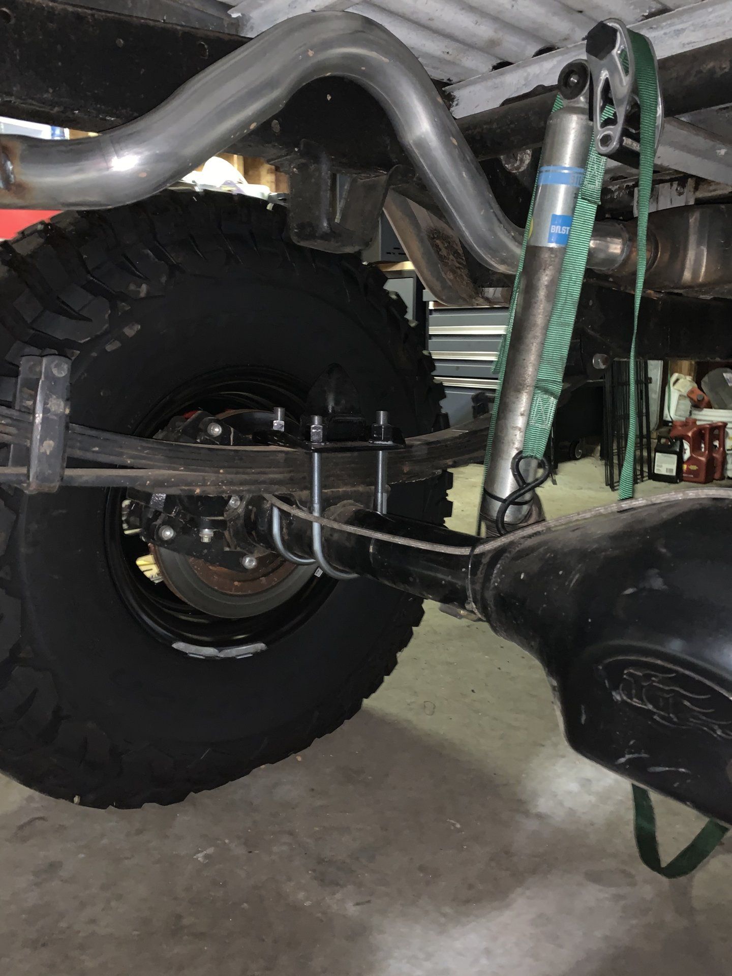

Took longer than I expected. Finally did the u bolt flip on the little truck. The OME U bolts didn’t quite fit the new axle housings.
Had to modify the bump stops and weld them on to the plate.
Now I have to go over to Johnny’s to weld up the new rear shock mounts. My welder ain’t going to cut it.
Much more clearance now. 12” under the pumpkin 15” to the axle and no more bolts hanging down.
