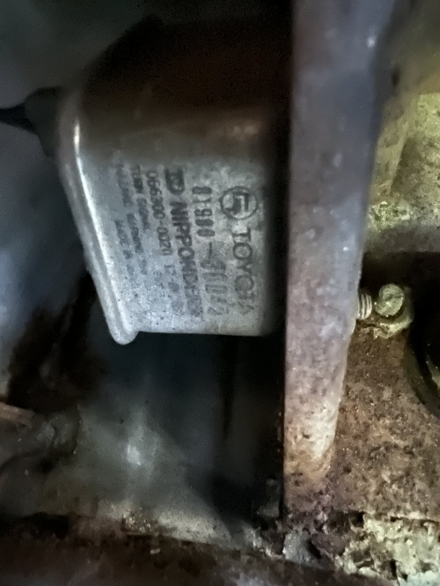

as I understand it, the 12 volts passes through the hazards to the fuse box (but only when the hazards are OFF0 then to the turn signal lever, then to the flasher relay (it’s a silver 2X3‘’ box bolted on a support beam to the left of your clutch pedal) then to the lights. So check for voltage down the line. As other people have mentioned, any poor grounding issue in the light fixtures or bad bulbs will cause failure.
I attached a photo of my blinker relay.
