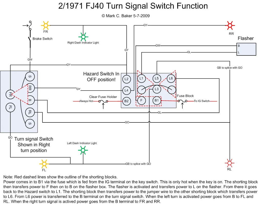

Get one of those test light probes and check if you got power to the socket - a VOM will also work. Your wiring diagram will be very helpful. Power to the other side means the brake light switch is working to me.
There is a wire from the brake light switch into the turn signal switch. 72 believe has a plug versus individual wires. Pull the plug for the turn signal switch. Figure which wire is coming from brake switch and verify it showing 12 volts when the brake pedal is pushed down. If it has 12 volts problem in the switch.
One working and one not could be a bad ground or a bad bulb, but both out makes me think circuit. Check to be sure the switch on the pedal is making contact.
Brake and turn signal share the same element in the lamp. The brake light switch circuit runs thru the turn signal switch so it can interrupt the brake light signal on the side the turn signal in turned on.

Right, but the brake light switch works on these years by interrupting the ground, does it not? That occurs separately from the flasher for the turn signals, which interrupts the positive. I could be totally wrong here, and these changed some years, I think.
Ground. Bet it's the ground. It's always the ground.
The brake light switch sends twelve volts positive to the turn signal switch. The element in the lamp give a twelve volts positive from the turn signal switch. Same element in the lamp for brake and turn signal. Ground is provided thru the tail light housing. Bad ground would effect both brake and turn signal the same way.

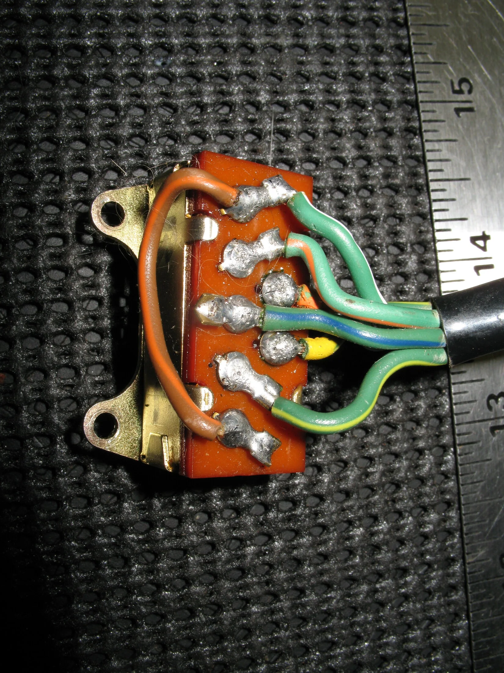

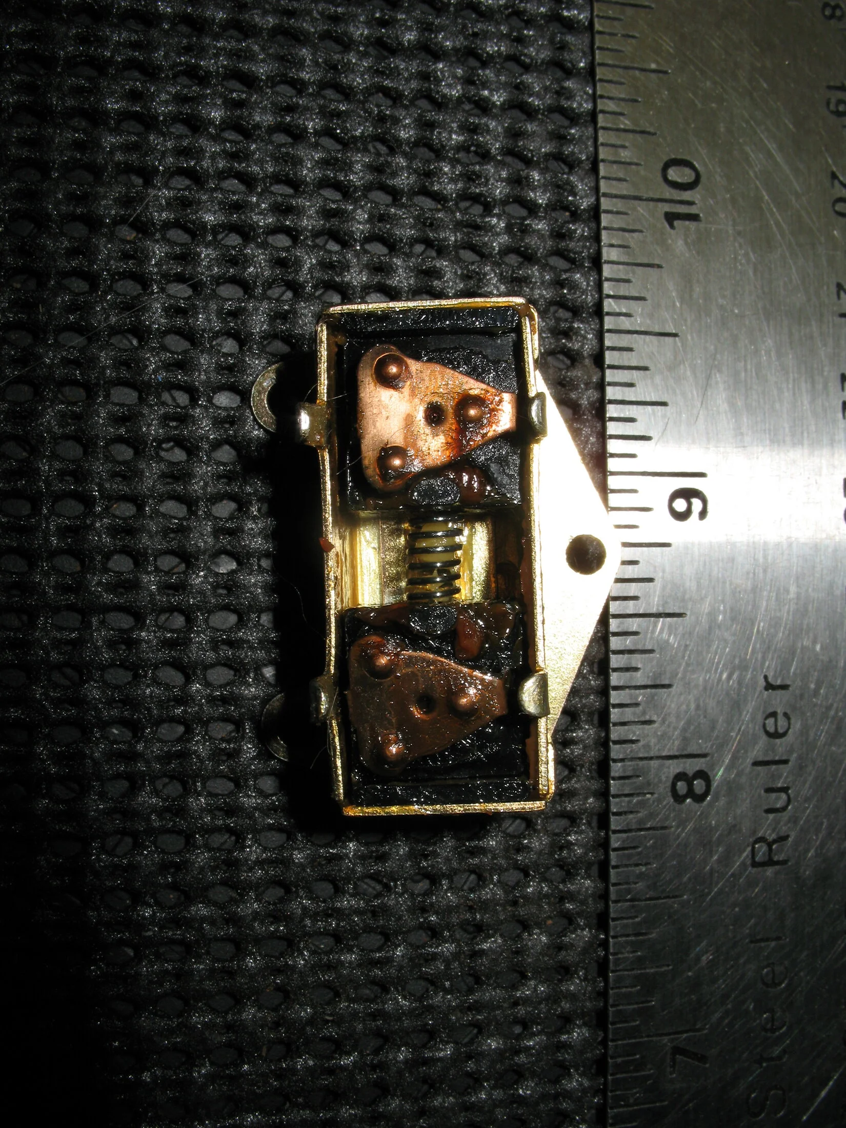

@MeanGene25 Do your hazard lights work correctly? I recently had the same brake light issue. And also, my hazard lights weren't working. The fix for me was removing the hazard switch and cleaning contacts, as well as replacing the hazard switch fuse. Brake lights are tied into turn signal switch and hazard switch.
On a 1971-1973 the brake signal from the brake switch does NOT go through any Hazard switch contacts. It only goes through the turn signal switch.
I agree that the issue will be found in the turn switch. These are easy to take apart, clean and re-lube.
Note the Brown/Orange jumper wire is what allows the brake signal to go to BOTH rear lights.

The other thing I had happen was a fuse kept blowing and I would lose my horn, brake lights, and hazard light functionality. This one took a long time to figure out checking horns, grounds, voltages, and wiring! The problem ended up being my hazard light switch. All lights go through that switch, and even though the switch looked great externally, there was some corrosion inside. I had to disassemble the switch by cutting the clear insulating sleave, and prying the metal tabs open. Once inside, the green corrosion was obvious. I cleaned everything and reassembled with dielectric grease. Never had a problem since.
