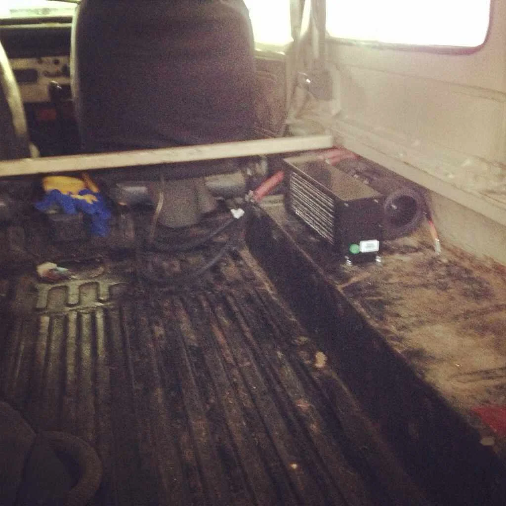

Here is what I did. Only works 'ok' right now. Need to work on plumbing so I get more flow to the rear heater. More work to come. ....

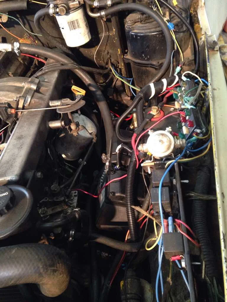

And today I also installed an engine heater webasto. It is frigging awesome. It isn't terribly cold out right now but it warned the truck to the point of no go plugs needed this am and instant heat. Sweet!

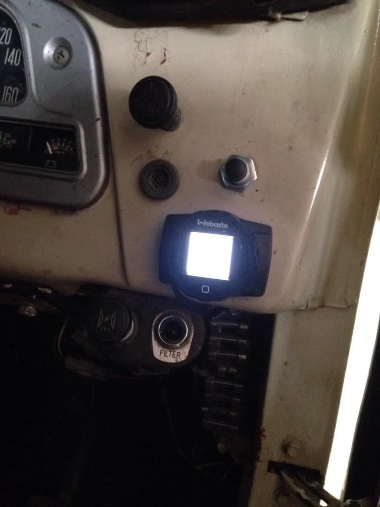

Came with a pretty slick timer. I've got my week programmed in for work to have it preheat before I get up and before I jump in at the end of the day.

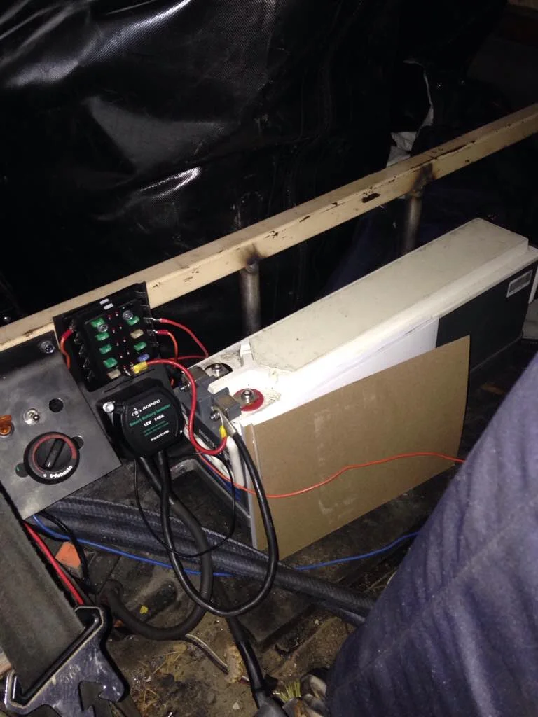

I also installed and auxiliary battery. This is a telecom 115Ah agm deep cycle. It is connect through an isolator so that when the engine isn't charging it dis connects and saves the starting batteries. This battery will be used to run my
Fridge and webastos.

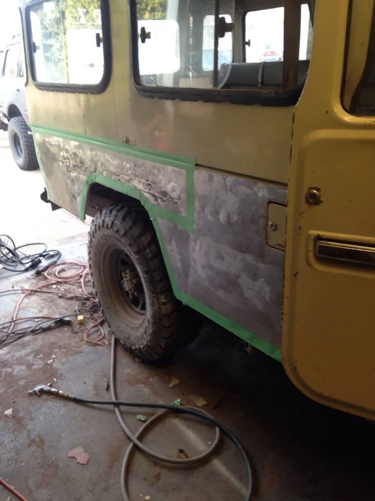

Quarter stripped and needing patches.

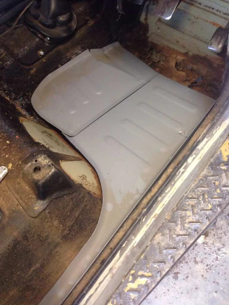

Floor pan panels

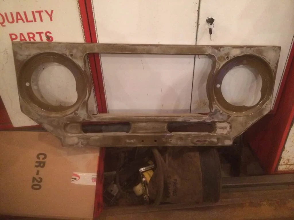

New northern bib
