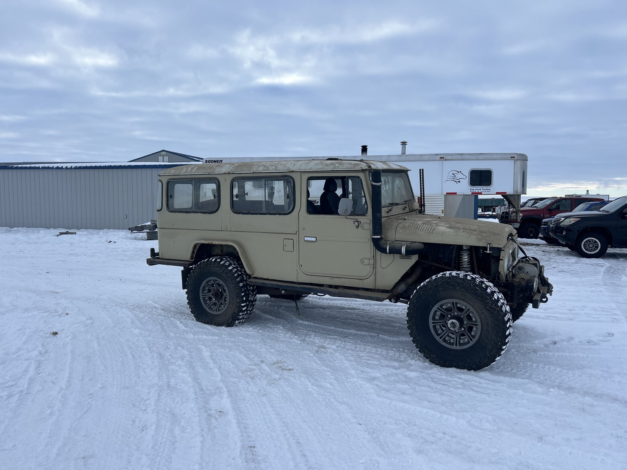

Troopy is back on the road and driving the streets of Calgary and the surrounding area... Over the last 3.9 years we:

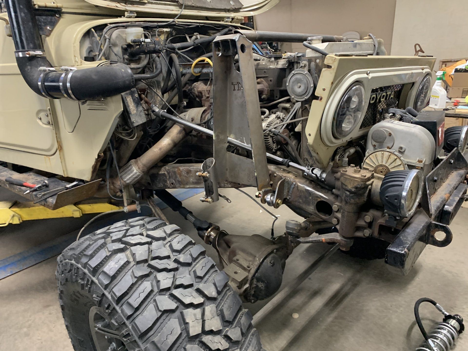

  • Mounted front fenders. I'm pleased with some adjustable mounts I built that are welded to the shock towers. These let me move the fenders in and out 3" with one 3/8" bolt and they seem rock solids so far. Bonus points for easy removal for service work on the engine. In 20 mins I could have the entire front clip forward of the firewall removed on this thing. That will be a nice feature in the future. Also, to pull them for hard-core crawling in Moab or other places is a cinch.

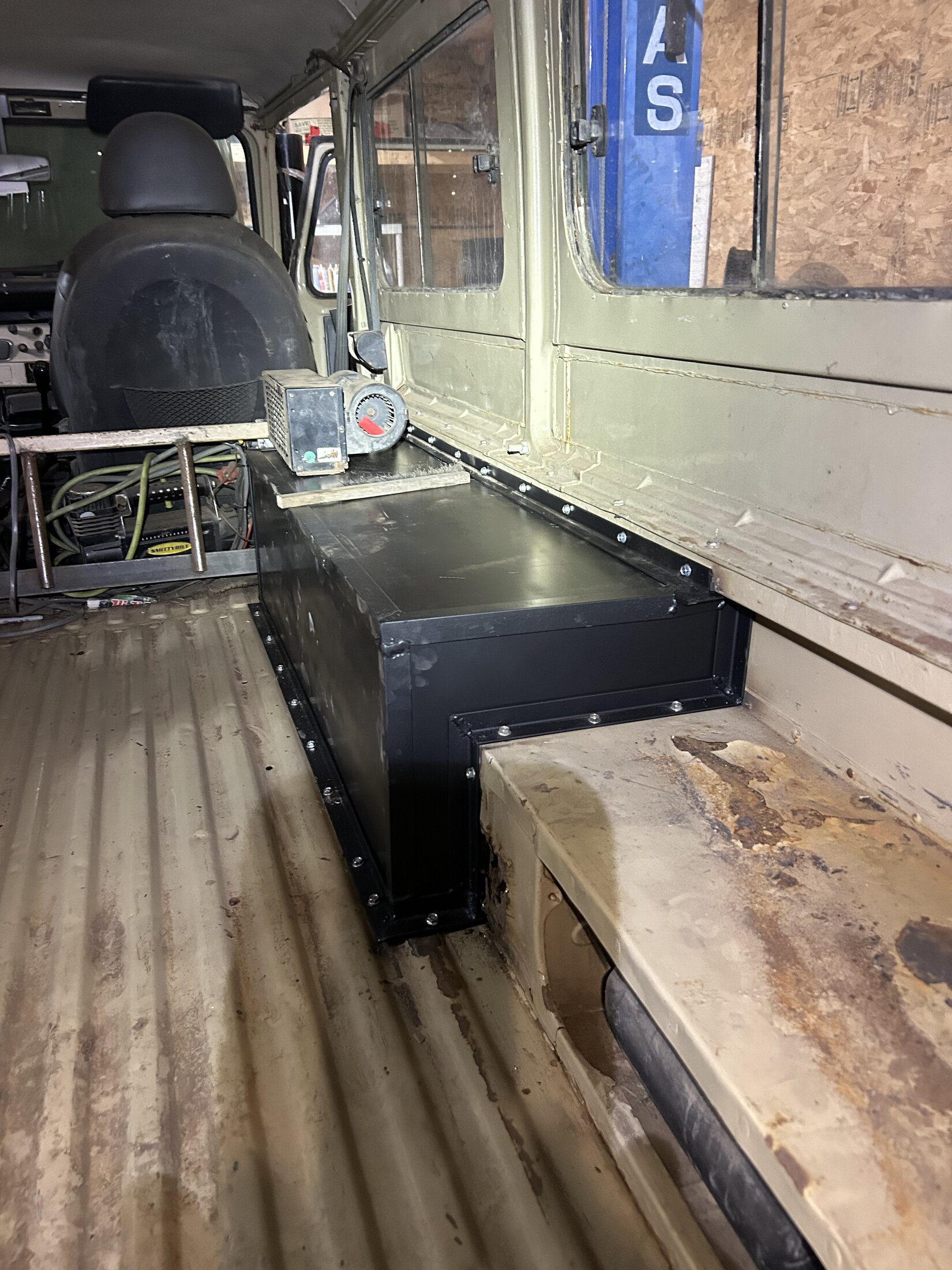

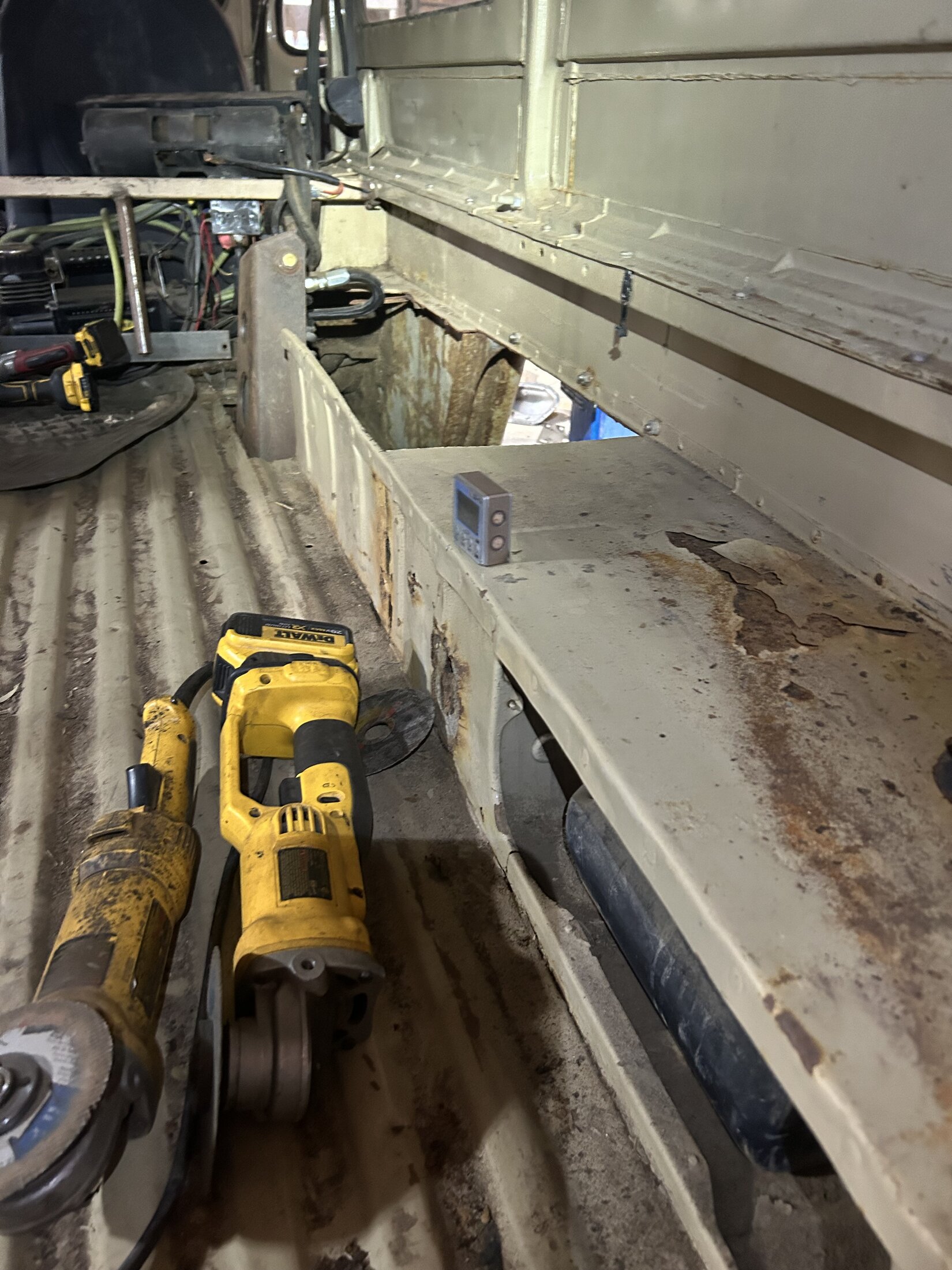

  • Reworked rear wheel tubs. With the rear shock towers now poking well into the rear cargo area, some modifications to the rear wheel wells were required. We built large steel boxes with angle iron and skinned them in 16 gauge to contain the towers and the tire area. I made these as high as the roofline split to the tub so that in the future, if I go to 40" tires, I won't need to change them again. These are teck screwed in but likely with being rivnuts the next time they come out for a little better seal. All seams are sealed and weather-stripped to keep out the weather. I still need to add a cross-bar support for the rear towers that will pass through these, but that is coming.... someday.

Front fenders on wide mode... but not the widest.
The Strut material we used for mounts. One slides in the other....
Fenders are on!
