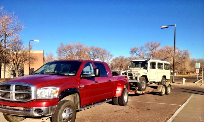

Snuck down to New Mexico to snag this little gem. Engine is all but shot but body isn't to bad! A dream truck of mine and a cool project!

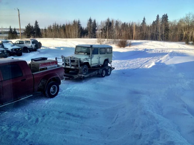

It hates it here:
