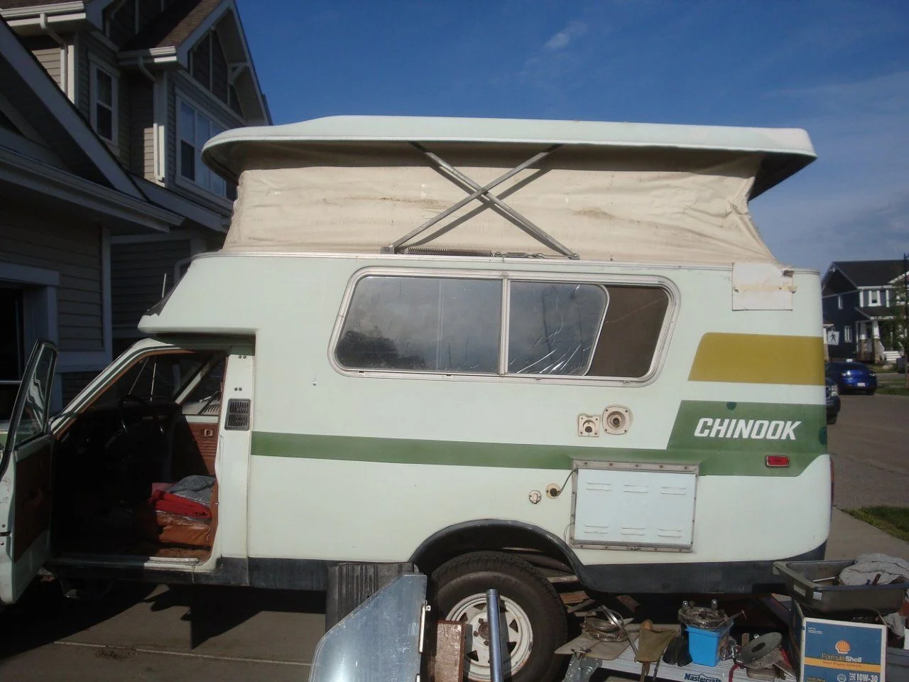

This may be new to some of you, but some already knew. Two months ago I bought a 1977 Toyota Chinook off a guy (a great guy, I found out) here on Mud. And due to our schedules I could not take possession until this past weekend. My brother and I flew down to Portland on Saturday morning and were back in Edmonton Monday evening. It was a very long three days but it drove the 1000 miles with no issues.
More to follow after I've recovered from the trip.

I've been pining for a Chinook for quite some time now. I guess ever since I saw the infamous brown "Nolan's" Chinook. It just seems to be an awesome platform for a 4WD camper. If you are not aware, the Chinooks did not come in 4WD so many people will take the shell off the back and place it on a newer Toyota 4WD. I thought it would be sweet to take one of these shells and put it on a 75. In fact, I think that you could make it a bolt-on/bolt-off affair with the removable 75 top. So, I've been keeping my eye out for some cheap Chinook shells thinking that maybe if there was a good deal I would pick one up. I've seen a few but never pulled the trigger because buying the shell would only be the first step and then I would have to buy more and store more and find space to work on the project.
However, I was lucky enough to just be going through the "New Posts" on Mud and found this in the camper classifieds. It didn't take me long to decide it was for me. And the reason it is "the one" is because this Chinook is already a 4x4.
The story has it that back in the day, when Toyota did not make a 4x4 pickup truck, you could take your truck into a shop and get it converted into a 4x4 and that is what happened to this one. The conversion was done by a company called Low Manufacturing.
It drove well for the 1000 mile trip so I think it is mechanically sound. The Engine seems strong and didn't really have an issue except to keep it from overheating but it was a really hot weekend. The drivetrain seems ok, but there is a strange vibration type noises at 65 mph so I'll have to look into that so I can go at least 110kmh. The drivetrain is very different from my cruisers too. I think I read somewhere that the front axle is a Dana of some sort and I found it odd that it has CV joints and not Birfields. The Tcase is also set back a lot! it is like mid-truck, but it does have a massive skid plate.

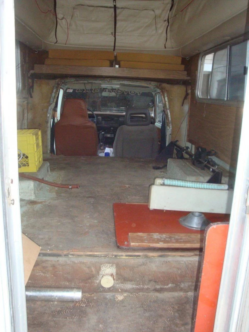

The interior was gutted by the previous owner as his plans were to rebuild it but he did not get to that. My plans are similar in that I don't think I am going to make too many mods to the engine or drivetrain yet. I will fix up the camper portion and make sure everything is running well and safe and use it for a while as is. Depending on how well I like it and how well it performs based on my needs, I will move on from there. If it works out well, I may very well be putting a Chinook shell onto a 75 some day.
The body is in great shape and the canvas as well. The previous owner, Gus, is a super guy and went above and beyond to make sure that the rig was ready to go for me. My hats off to him.
I think it won't take too much to get this back on the road. ... or trail.

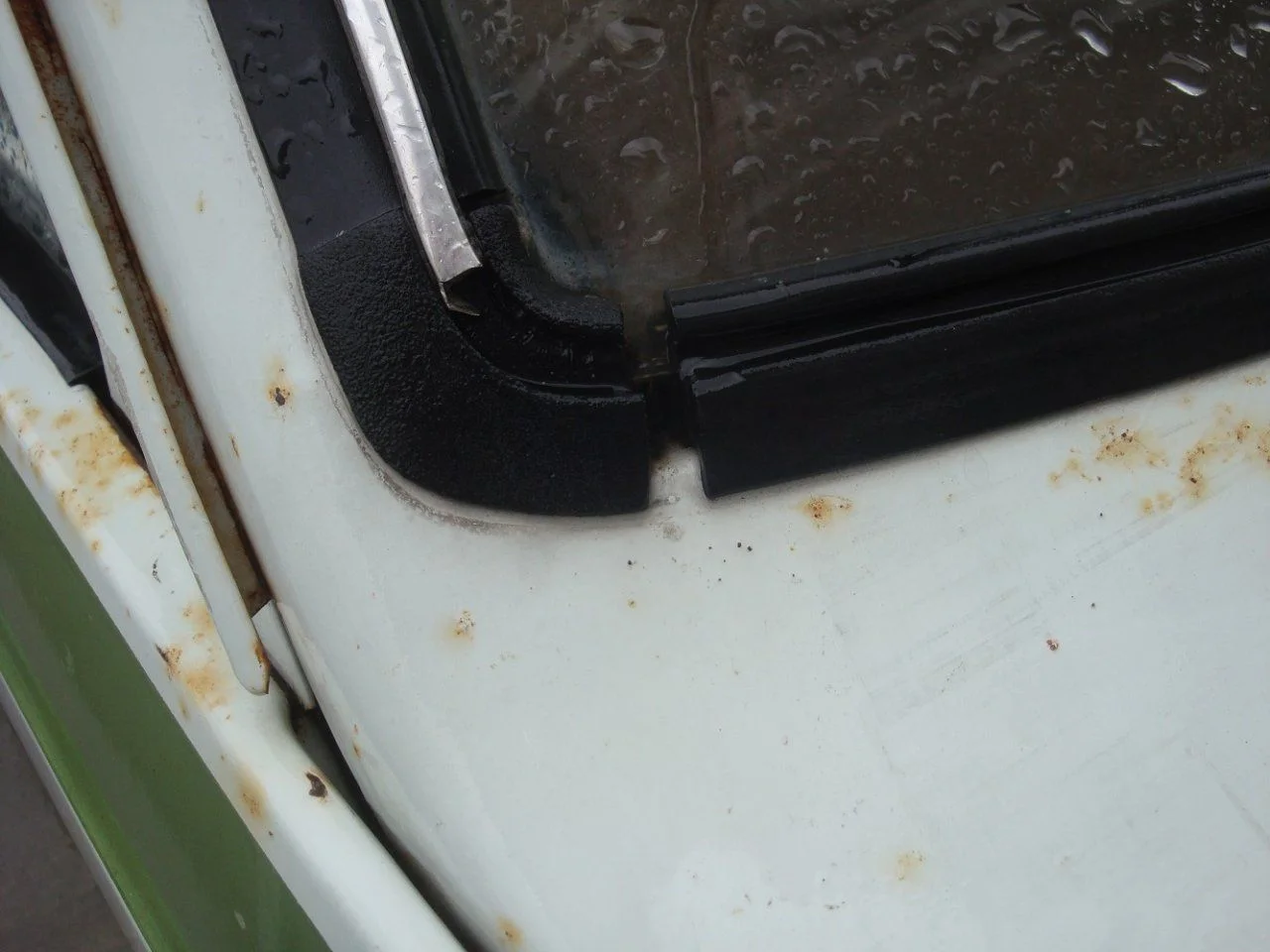

Somehow water is leaking in and down the door frame. on the passenger side you can actually watch it running down the door and dripping onto the floor. Good thing there are rust holes there to let it drain otherwise it would be a swimming pool! There were remnants of shag carpeting in here so I am guessing that that acted as a perfect sponge to sop up all the water and keep the floors wet and rusty for many years.
There is a gap on the windshield rubber seal on the bottom of each side and I wonder if that is the point of water infiltration, but the area doesn't look like it has been rusting so I'm not sure. But then again, if the water drains that freely, it may dry up quick enough to not allow it to rust. Either way, it will have to be addressed.

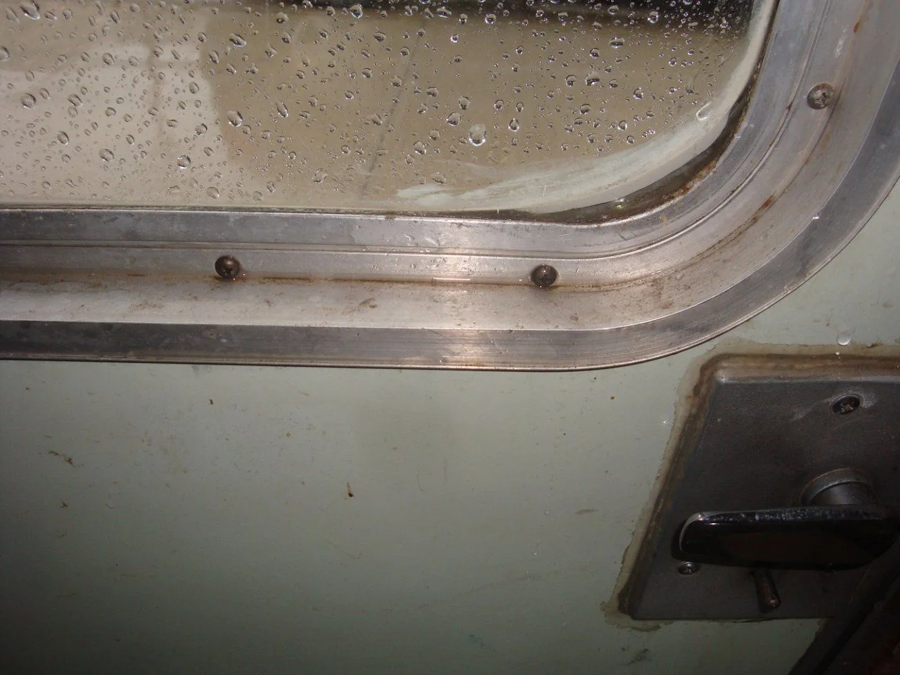

And of course there were also some other leaks on the inside of the camper as well. The largest being above the cab in the bunk area.
The others are around the door, which is almost expected
and the lights which are pretty minor and shouldn't be too much of an issue to fix.

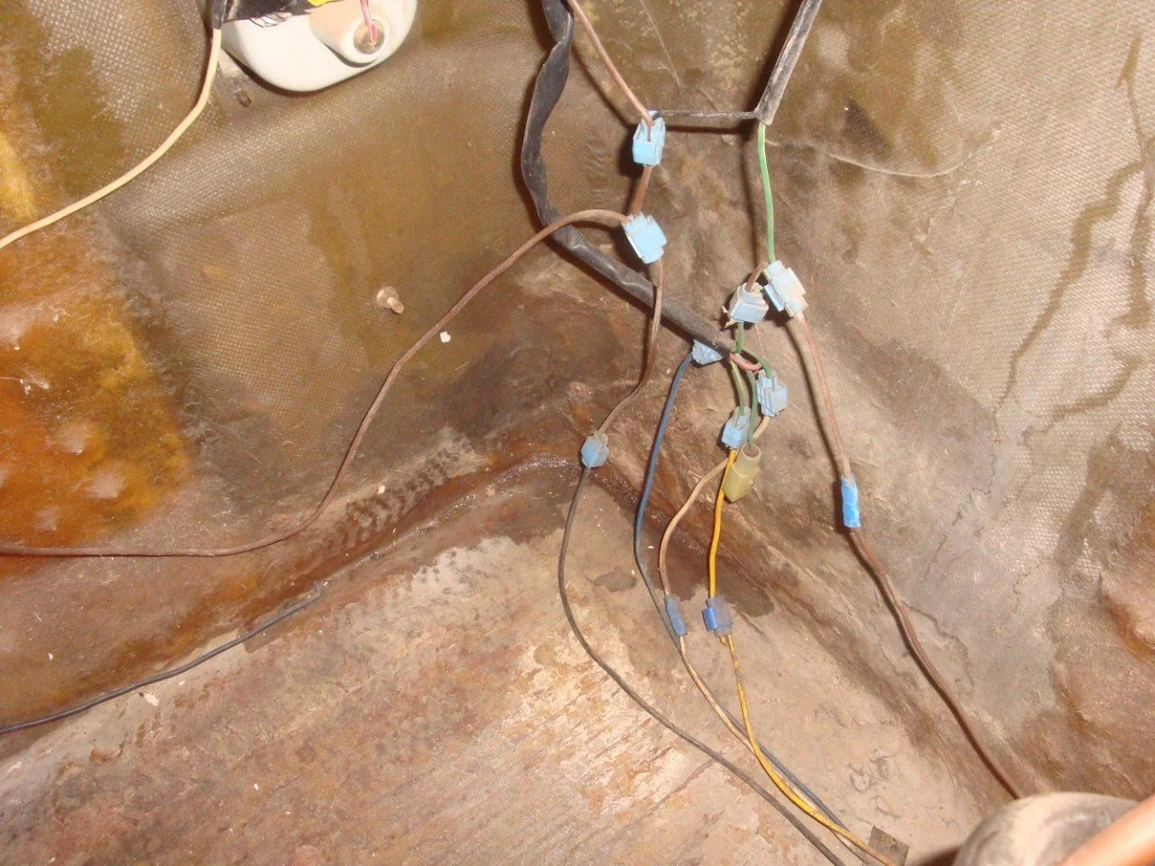

I don't know what's going on with the headlights! I have everything apart.
All the other lights work but the headlights do not. I have power at the fuses but then there seems to be no power going to the switch for the headlights. I just noticed this morning this "box" coming from the fuse box and think perhaps this may be my issue. I guess I will take it off and see what it is.

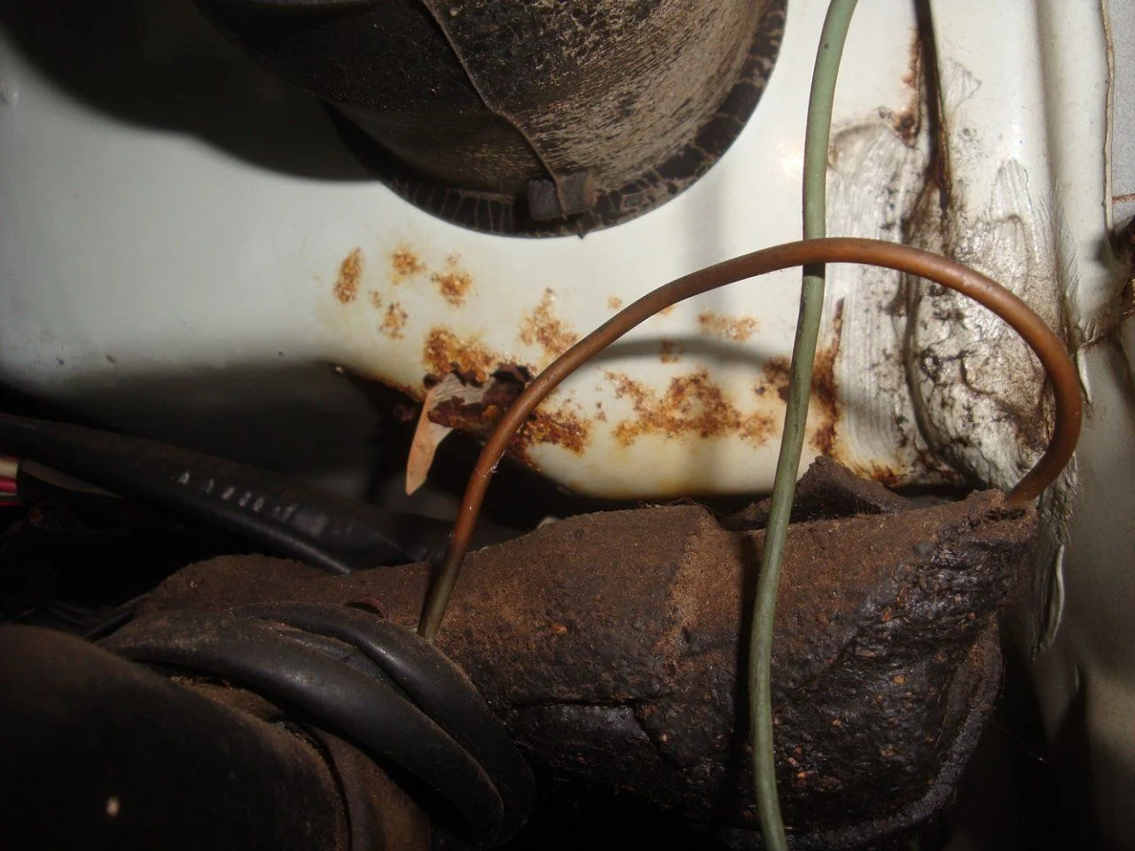

Thanks for the advice cruiserpilot. Unfortunately, there is no cowl vent panel to remove. When I thought about fixing up that surface rust I thought I would just paint the hood and cowl vent cover as well, but it is not a cover, it is one piece.
I did notice this rust hole on the passenger side above the AC, but as you can see in the pic, it is bone dry so I guess it is not the culprit.

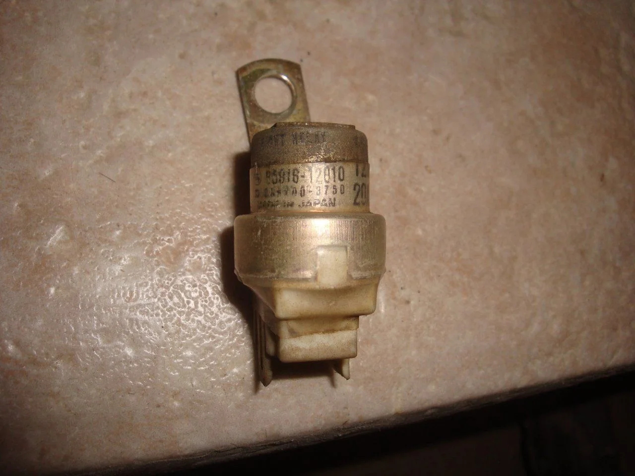

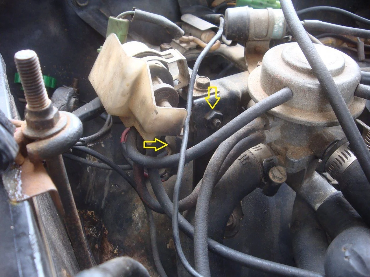

OK. Headlight issue solved. It was a bad connection in the headlight relay. I thought that there might be some relay or something else in the circuit, but I'm no electrical expert so I didn't know what to look for or where to look. I ended up hotwiring the lights directly to the battery and luckily after I did that, when I turned on the headlights I could hear a clicking under the hood. After I found out where it was coming from, I wiggled it and the headlights work!
Removed it and cleaned the connections and if need be I will replace it.
Talk about hard to get at though.
The arrow pointing the right shows where the relay is. The arrow pointing down shows the captured nut. The bolt is inside and I could barely get a 10mm stubby in there. I guess the whole thing is supposed to come off to accesss the relay.

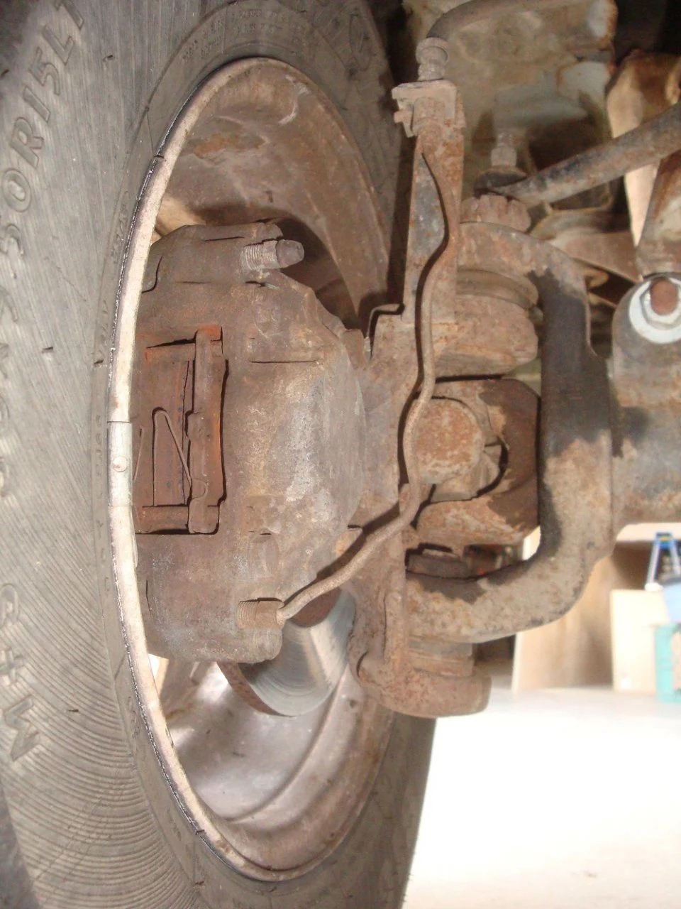

I hope that I don't have to do anything to the driveline just yet, as I have no idea what the driveline is or how to determine the parts necessary.

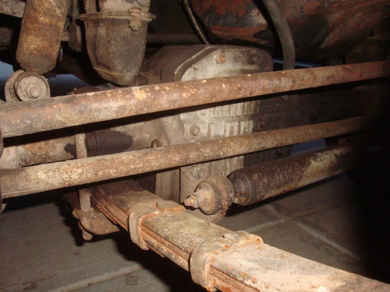

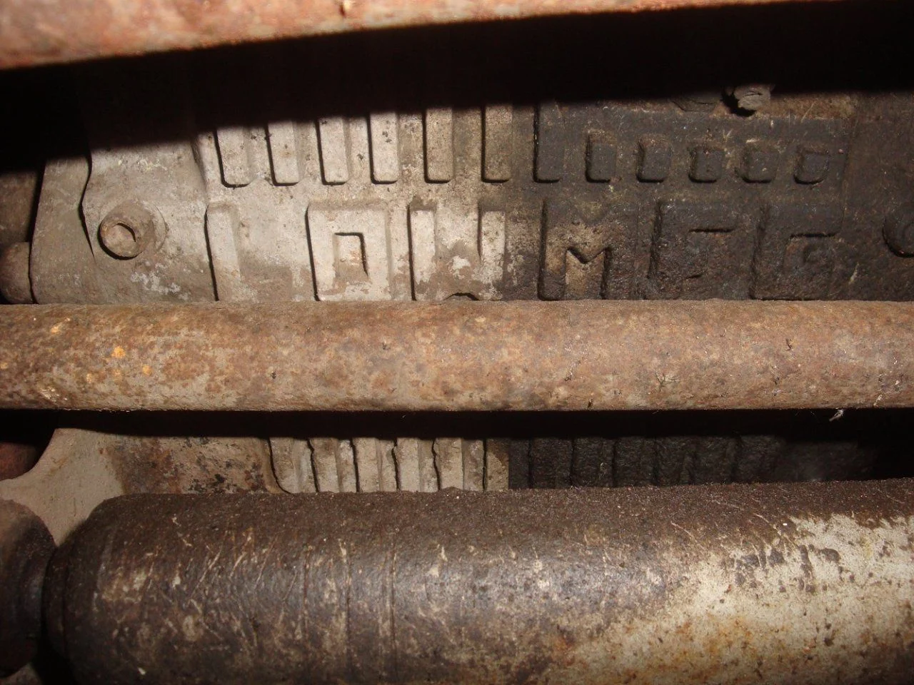

Here are some more pics of that front diff. From what little I can find out, Low Mfg was big into converting mainly Datsuns into 4x4's in the 70s.
It appears that the /t-case may be a Dana20 or if very rare, a combination of a Dana 20 and 300. The front axle they say is a Dana 30 or may at least house Dana 30 innards. Who knows for sure.
