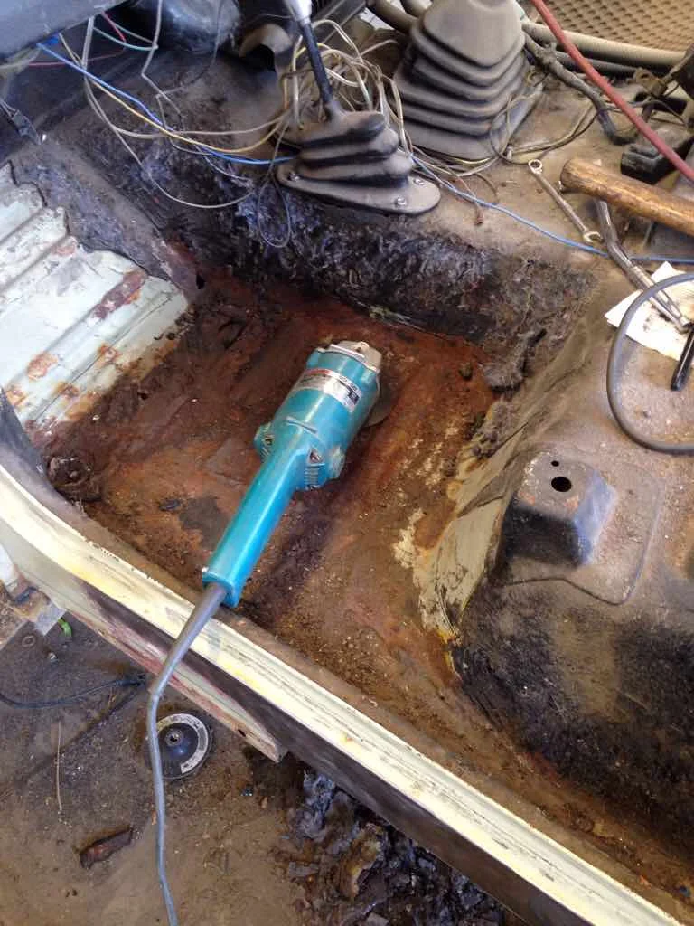

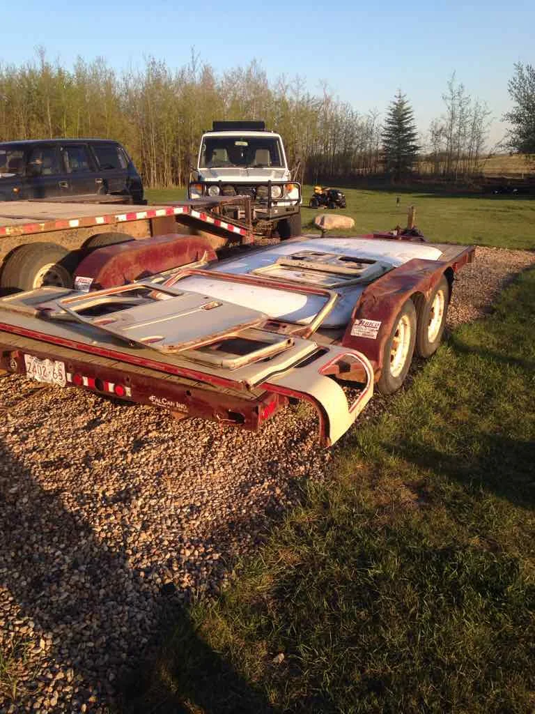

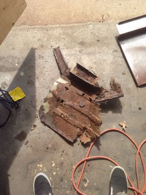

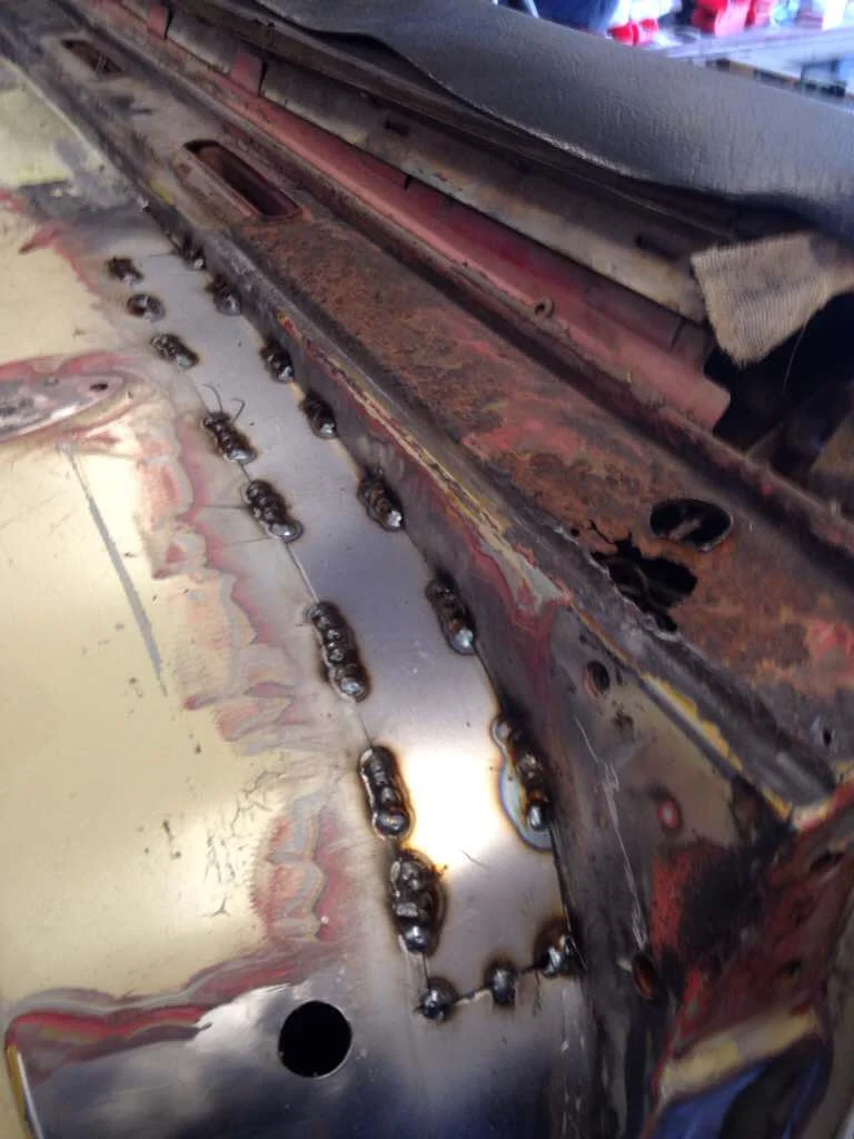

The old original floor pan... For sale... 1 beer.

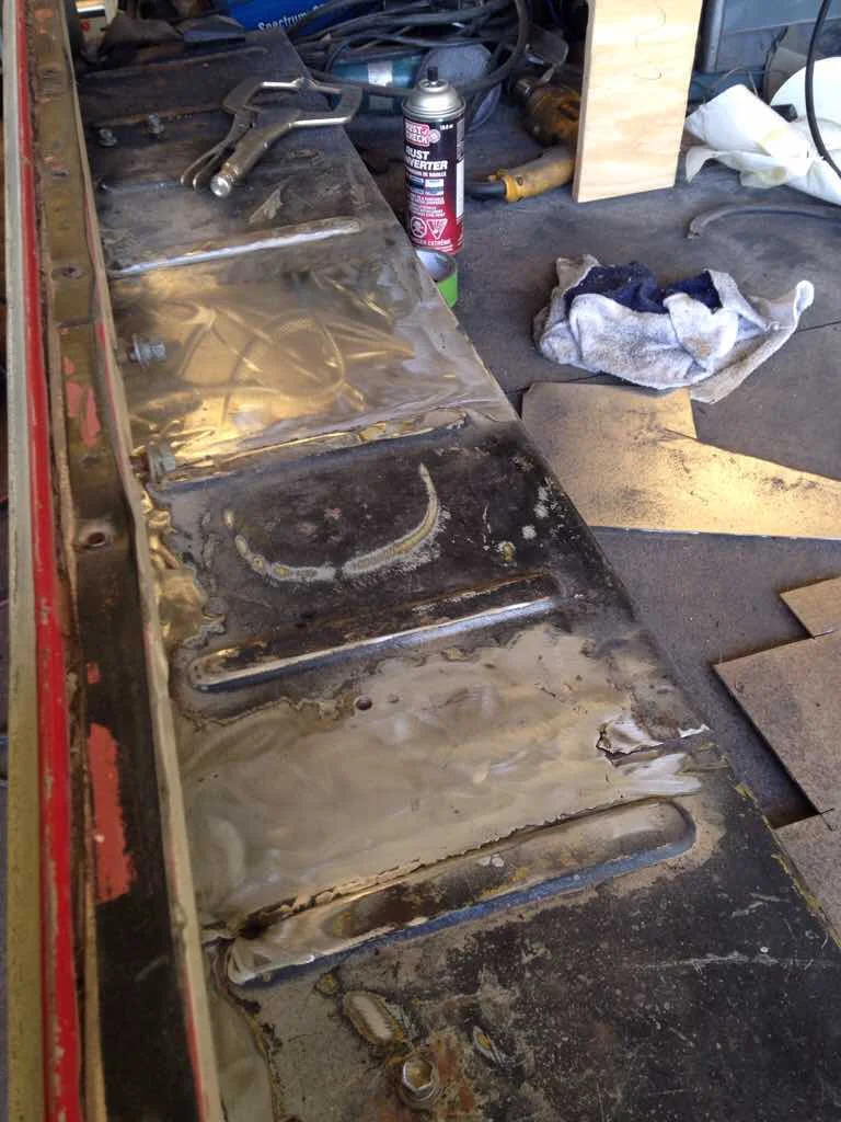

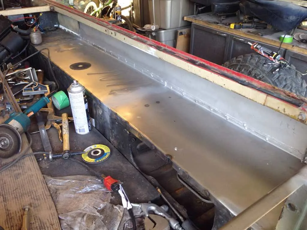

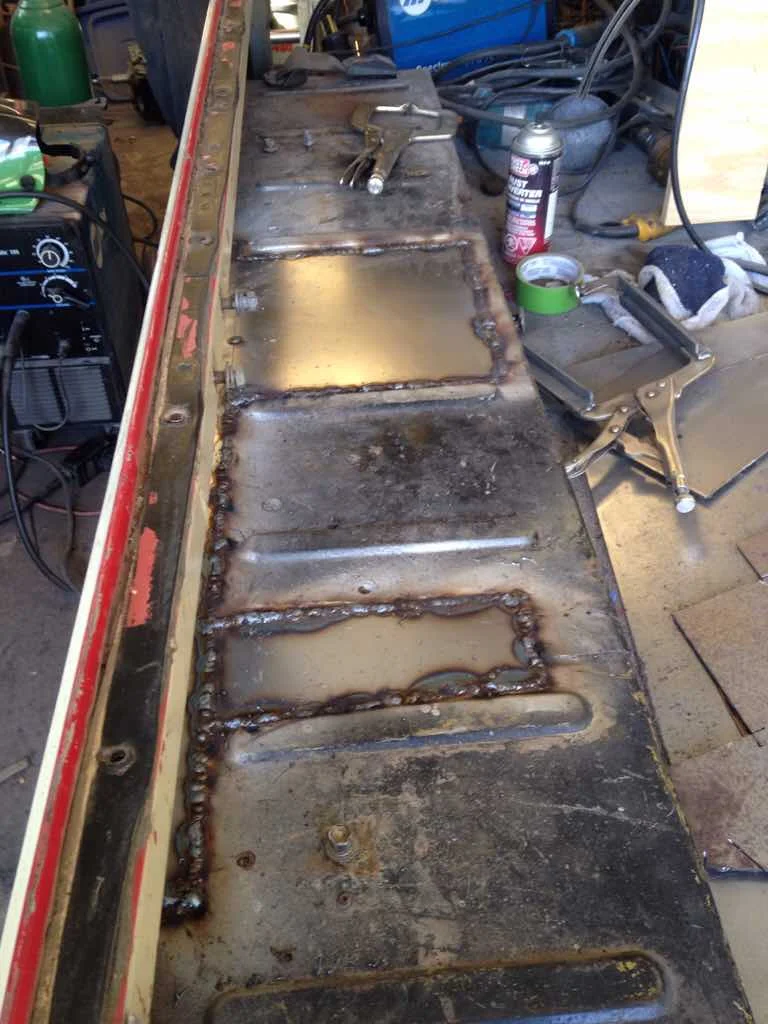

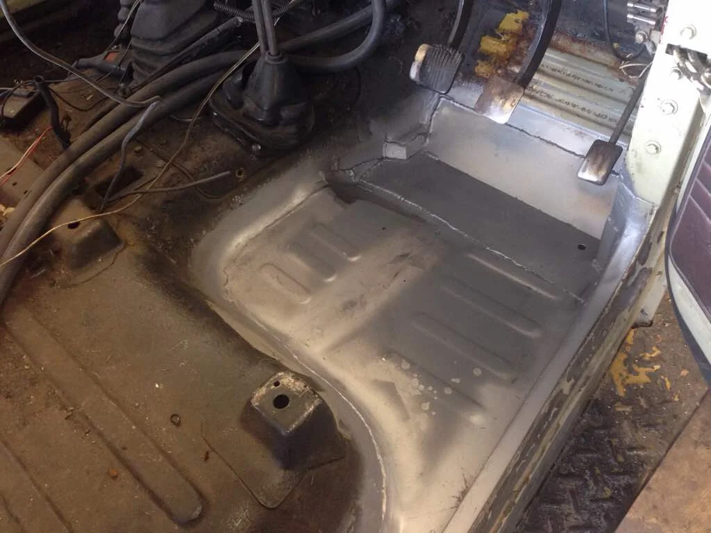

Welded out
So excited
Like a boss

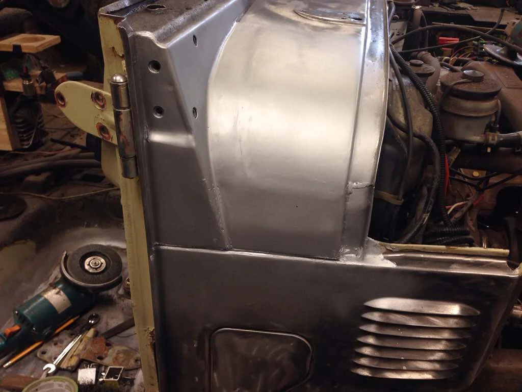

Look mom no more tape to seal the wheel well

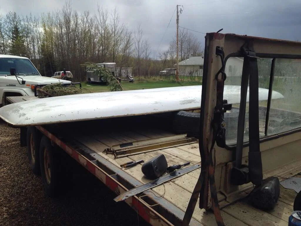

At this point char and I took headed over to rid Paul of all the removable stuff. The plan is to strip all this stuff sand blast repair and prep for paint.

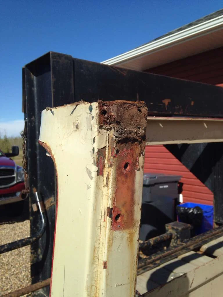

Today I started on the roof.... It looks like it will really suck....

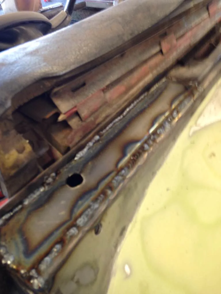

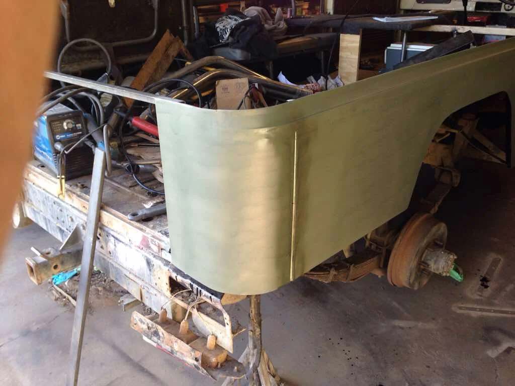

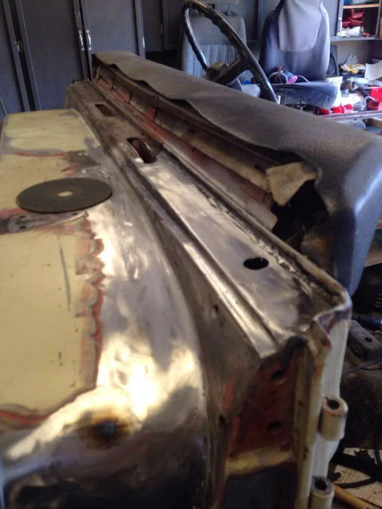

Paul also patched up the cowl in typical Paul fashion.

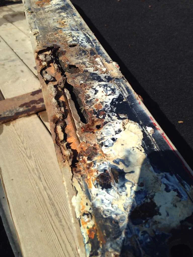

Roof drip edges look rough on the bottom. Good news is the gasket is salvageable. But I'll need to fab almost all new drip rails. So that outta be interesting. They are riveted to the fibreglass in 673 places.....
Kits are available but not all that s*** hot from the reading I've done
Hmm. Unsolicited Advice. Get a certain spot weld drilling fiend to tackle your 673 problems while you tackle his 1. Win-win. :)
Kits are available but not all that **** hot from the reading I've done
3 beers, zip disc, punch, hammer. Done, looks more daunting than it is.

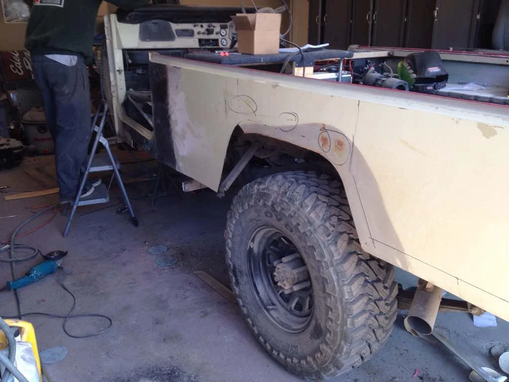

Well much more work today. I managed to sneak to the park and help Paul. It was nice to get back into the groove of body work. It's been a while
Paul had this patch made up. I just welded it in

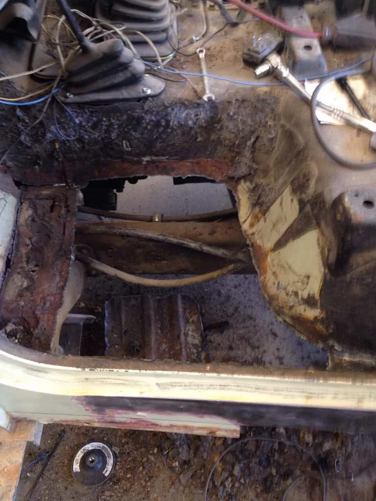

I am glad that i didn't have to floor pans . How bad was the support unerneath near the body mounts?

Supports are toast, kinked up new ones on the brake....next one goes on a rotisserie, this old body don't bend like it used to!

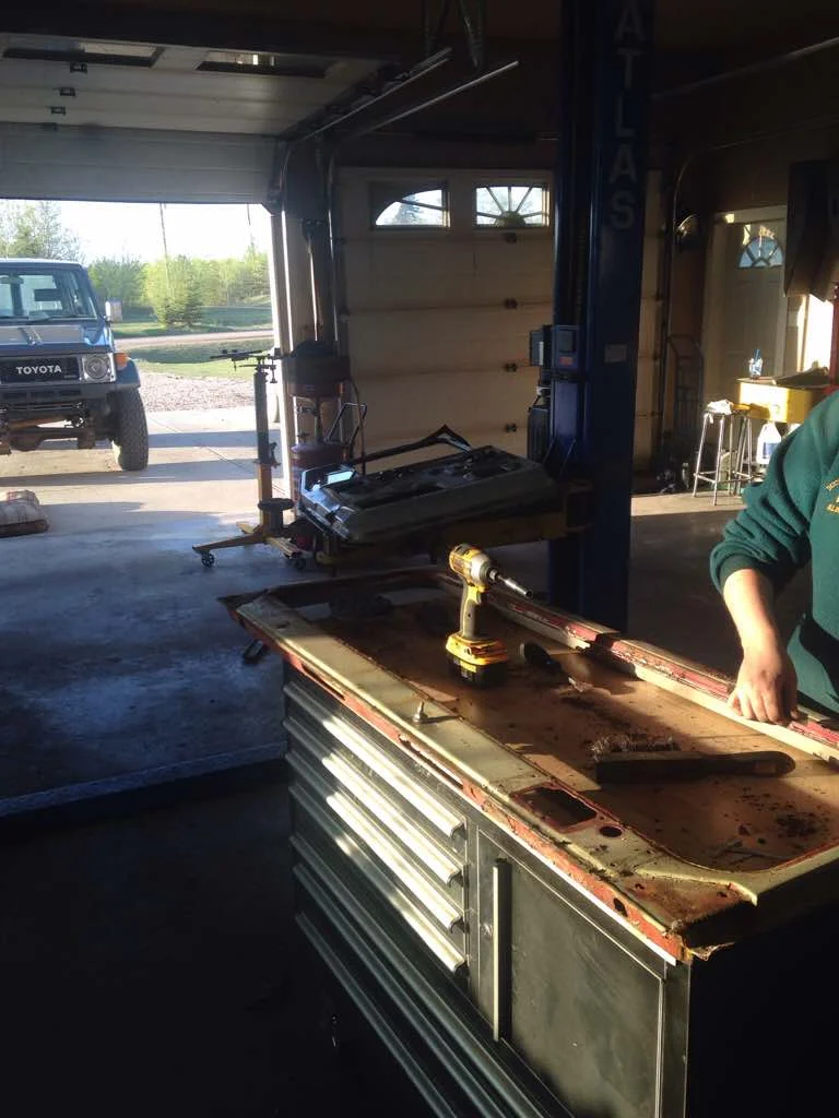

Drip rails are off. Now to see if pauls break can bend up some patches for it. Then to strip 19lbs of silicone off them. This previous owner is obsessed with silicone!
