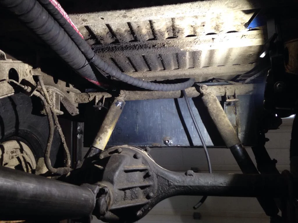

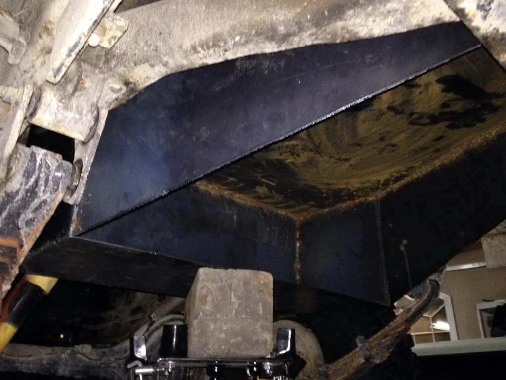

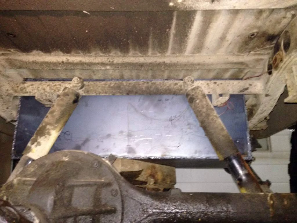

Did some more on the tank. Two baffles cut and welded in. Last
Panel welded in. Test fit it prior to all that. It is a tight fit but fits. Couldn't be any larger anywhere.
Have to fix a few leaks on it. Then weld flanges for senders. Then filler access. The filler is the toughest part. I'm thinking I'll try and use the stock fill and pipe it back to the tank. That will leave me with about 5 foot of 2" hose feeding into the tank. Any thoughts? Or do I bite the bullet and install a new filler? If like to keep the original but don't want the tank to be a pain to fill.

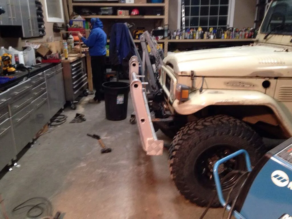

A few more things done

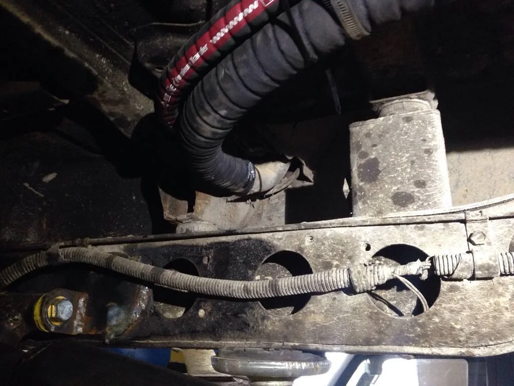

I went to work more on the tank on Thursday but ran out of mig gas for Charlas welder. So went onto tackling a few other little electrical gremlins.
The tail lights weren't working. No power to the socket. After seeing the rear harness this was no surprise. Two added trailer sockets and splices all over. I cleaned it up some but didn't get it back to factory. Lights work anyway.
Then Friday I
Picked up wire and mig
Mix and went to work.

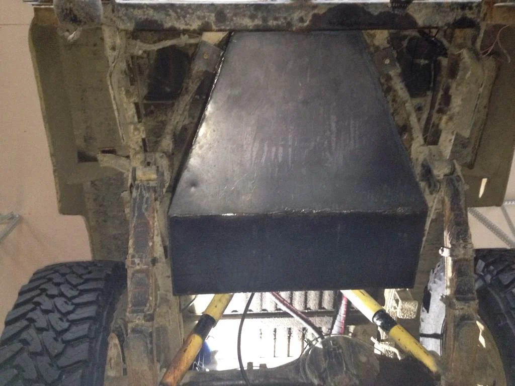

Finished it this am and mounted this afternoon.
We just got back from its first fill. Since I used the original fill neck and have 5' of hose leading to the tank I was worried about how it would fill. I stuck the nozzle in and let it fill.
Clicked off at 143l. Squeezed in another 7 for the full 150 I was aiming for. So far I can't see any leaks. I'm still driving off the Jerry cans but will plumb the tank tonight with my new electric pusher pump and dual cheapo filters. There is some
Metal bits and fabrication dirt in this thing so I need to be extra careful. I left a magnet in there though too grab the stuff it can.
150L! If you get 17L/100K that's a pretty decent range, almost 900km! plus the 2 gerry cans in the back of course

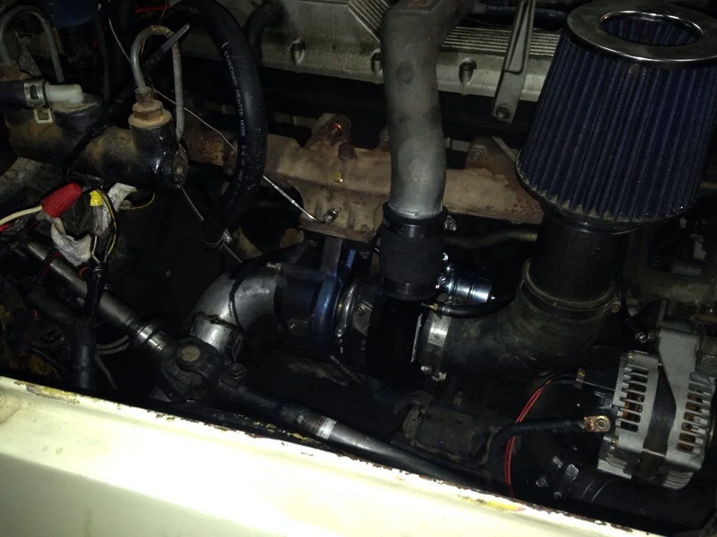

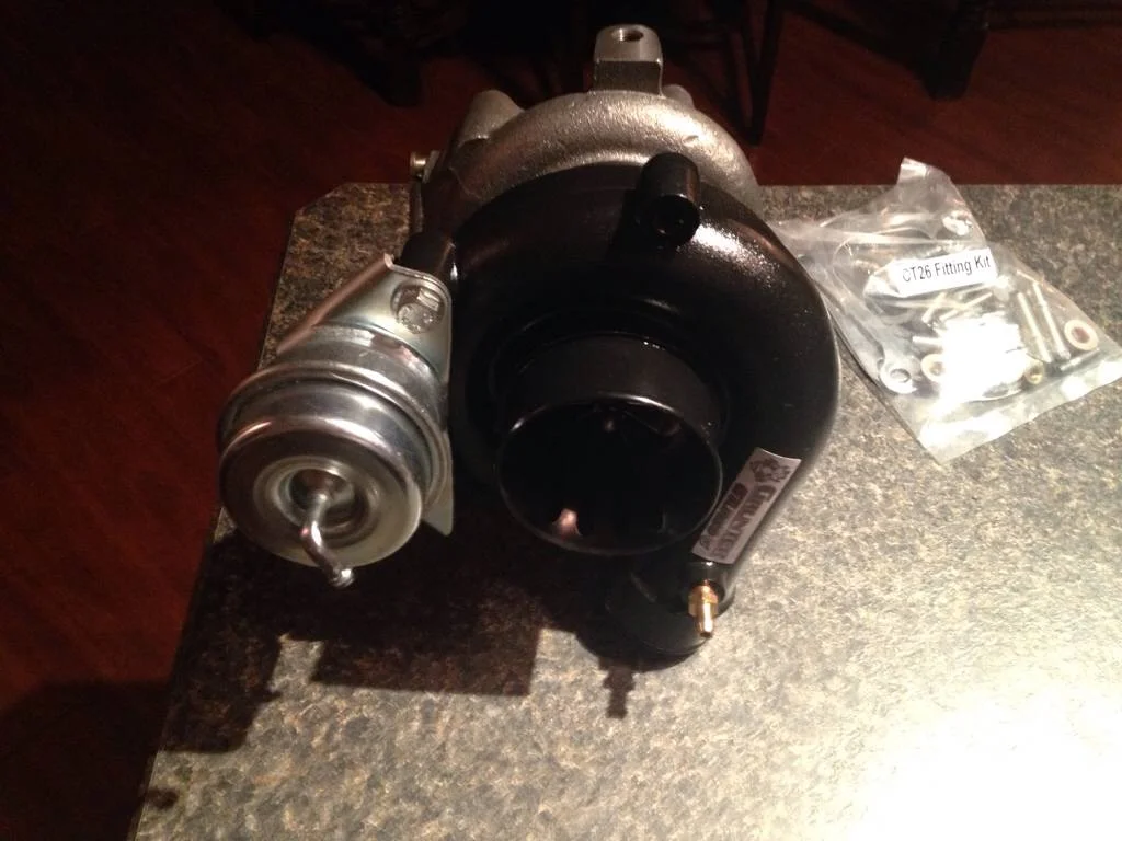

Disaster has struck... My turbo has died. Nothing to dramatic but certainly needs a rebuild and maybe a full replacement. Thread in diesel section. Pretty bummed as this thing was really nice to drive.... and of course it happens the night before the club meeting after not being able to drive a cruiser to a meeting for a year.....
If you want I can tow you into town behind the 71 now that I have a pintle.
So long story short. I wrecked my turbo. I bought a new one. It works great too.
So new turbo is in and turbo ing just fine.

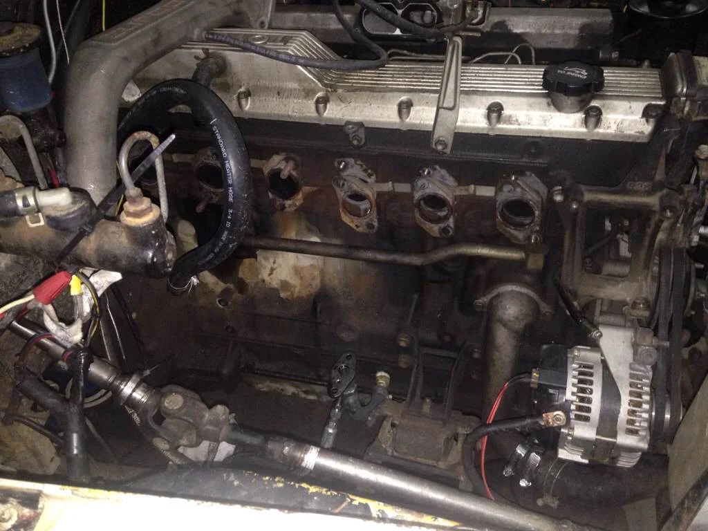

Tomorrow I head to deans to pull glow plugs and injectors from an hzj80 I intend to buy the motor out of. I have a sticky injector and will try these others while I get mine tested.
