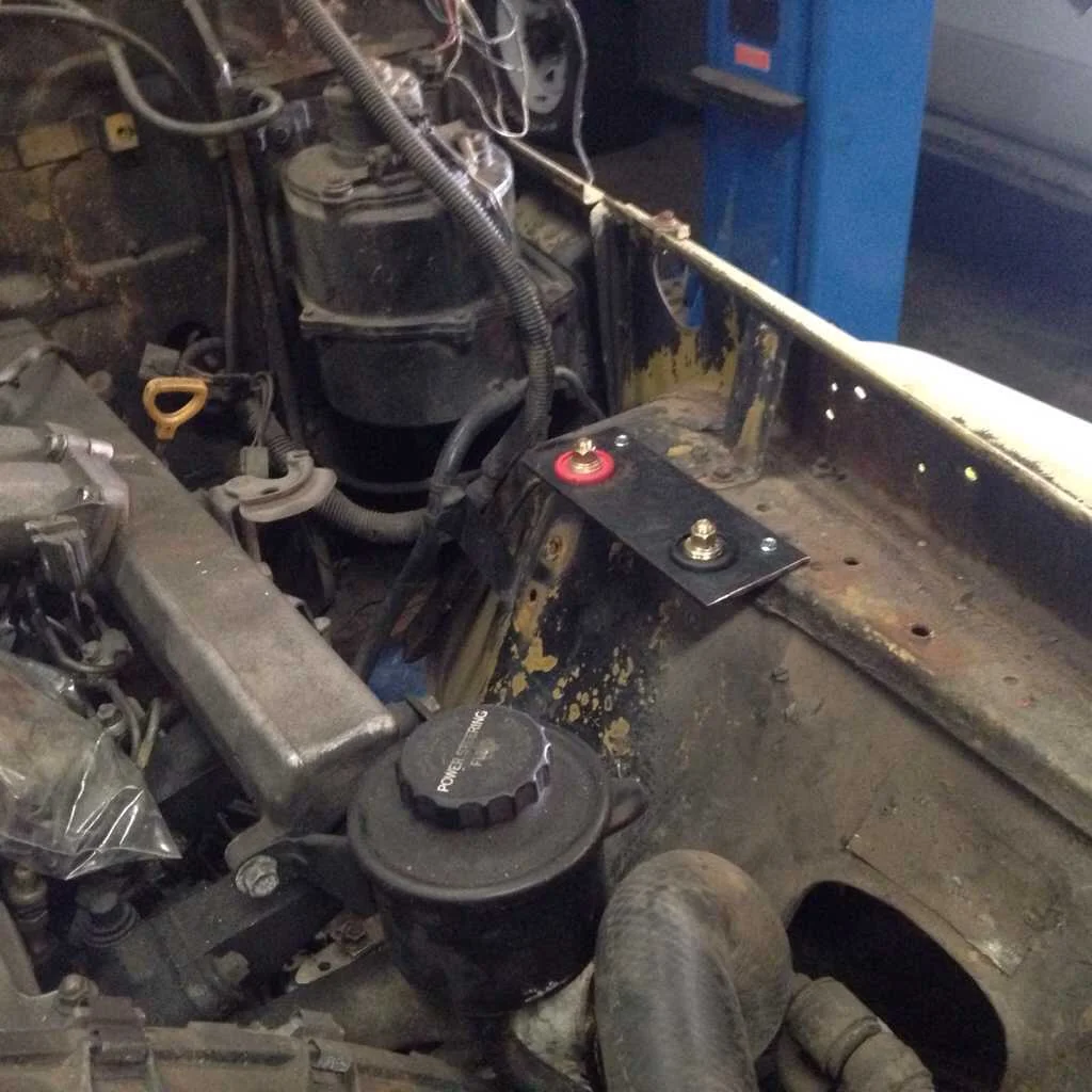

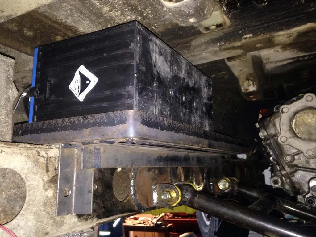

Well the rad I thought I had is no good... Byron is sending one south sometime soon. Tinkered more on the battery support and remote termiNals tonight. Also may have figured out an air filter but it's a monster Donaldson type.

Remote terminals

Broke my cordless drill chuck while drilling frame for batter tray. Have to figure something with that too I guess.

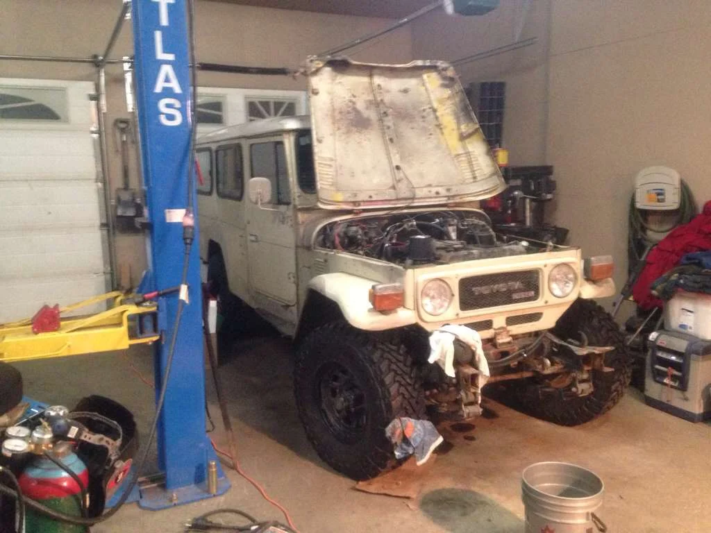

At chars parents a few days and brought down troopy to tinker on. Have a few things planned

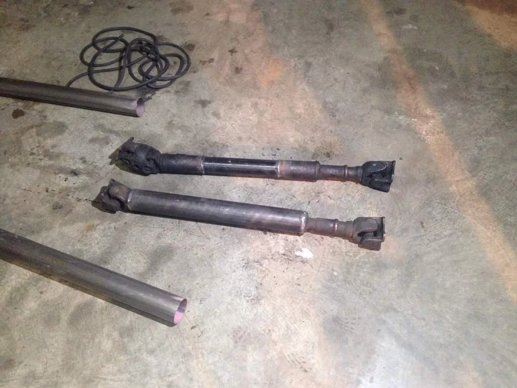

Drive shafts built

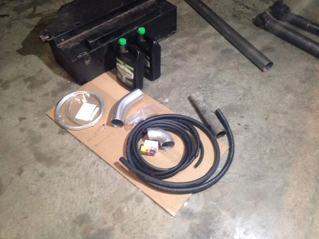

Hoses and fittings bought

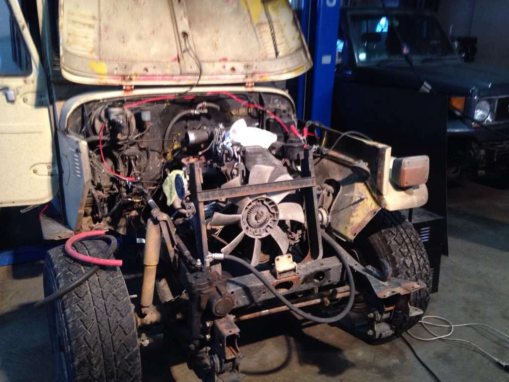

Rad mounted

Rads in

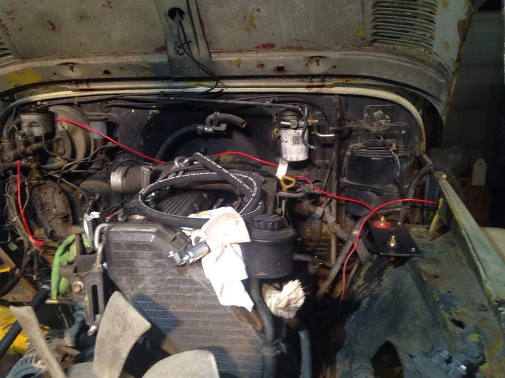

Wiring started.

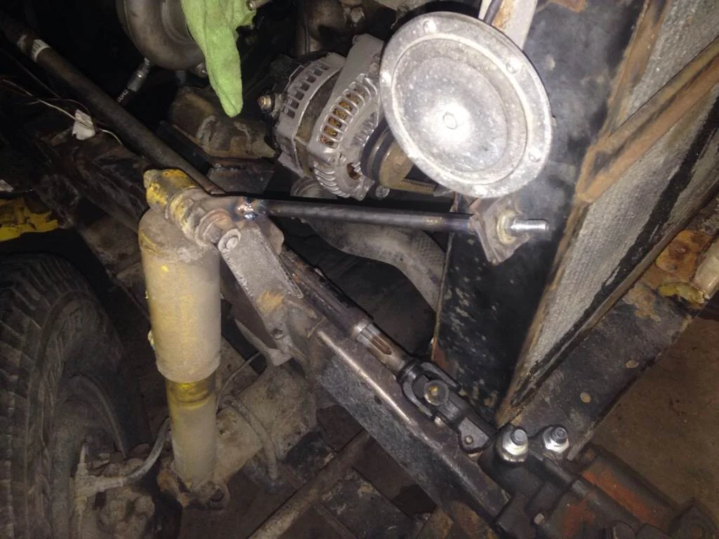

Well troopy had come along ways over the holidays. Thanks to help from ratpuke and the French connection I was driving it in 2014. I also was able to wheel it on New Year's Day. This wasn't without event though.
Early on the steering let go on a dodge connection. We tie strap and ratchet strapped it together and continued for the day with 'herding cats' Steering. On the trail troopy worked great. The turbo hz makes great power and is still in need of more tuning but is great overall. I rented some tires that were better than the stickers and that sure helped.

Fixed dodgy steering

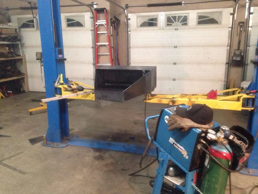

Started fuel tank

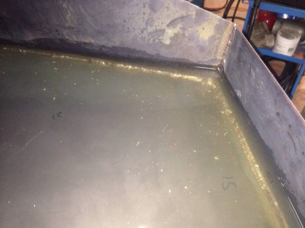

The tank should be complete and installed this week. I removed the tank gauge and draw pipe from the original tank and will transplant them into the new one. It just so happened they are exactly the right size as well so that was a nice piece of luck.
Welding the tank has been fun. Water testing the welds as I can. So far I've had 4 repairs. But after all is said and done it isn't leaking anymore. I still need to cut a few baffles and weld them in. Then weld my final panel.

Ya the big focus now is the tank. Once it's in ill be able to seal up the floor better. And work on more permanent solutions to wiring and all the other good stuff. The laundry list is big though.

Did you build a drain into your tank? Are you going to pressure test with air as well?

Ya tank will have a drain and ill do a light air pressure test. That's the plan anyways
